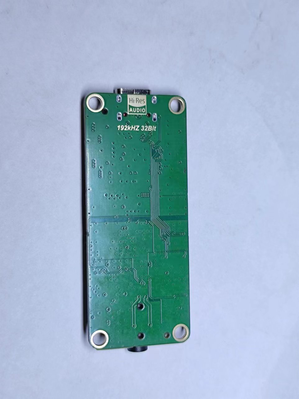

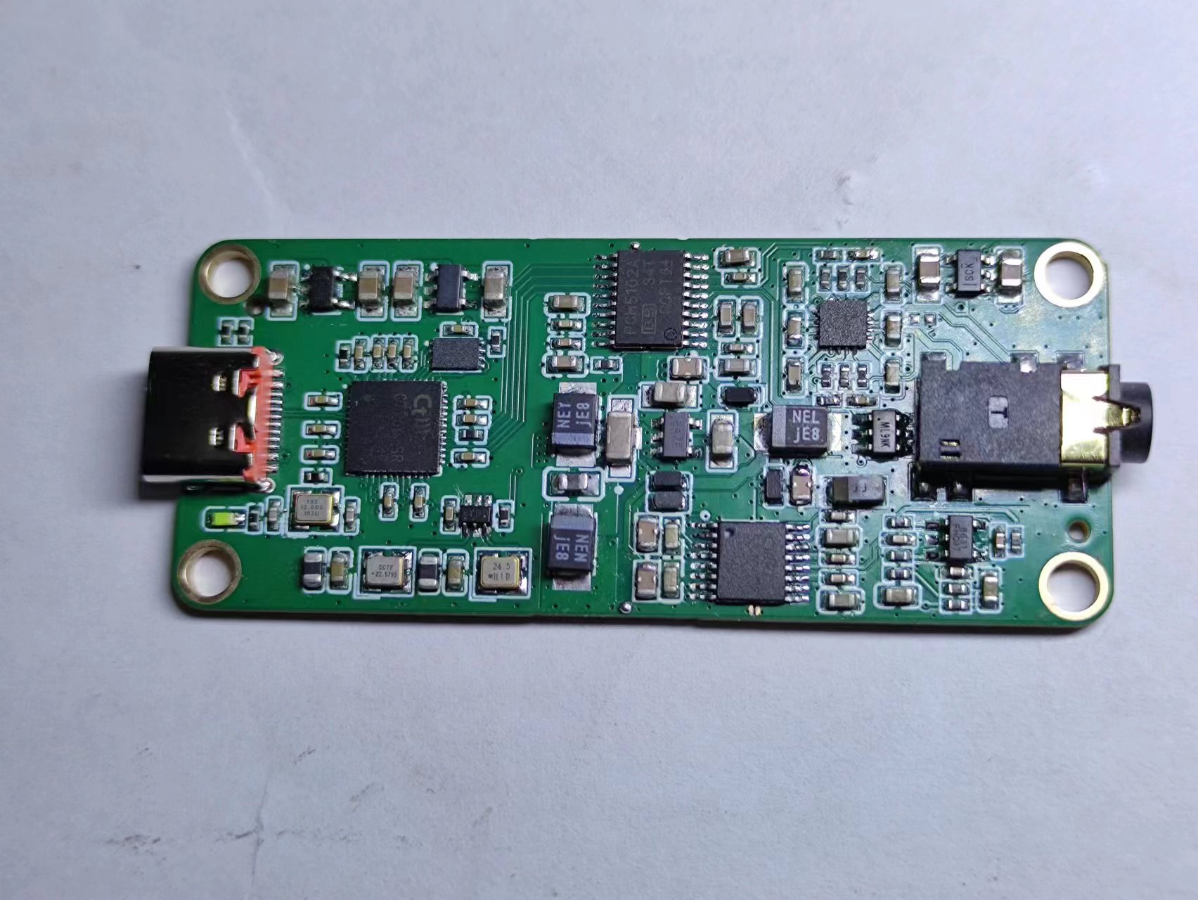

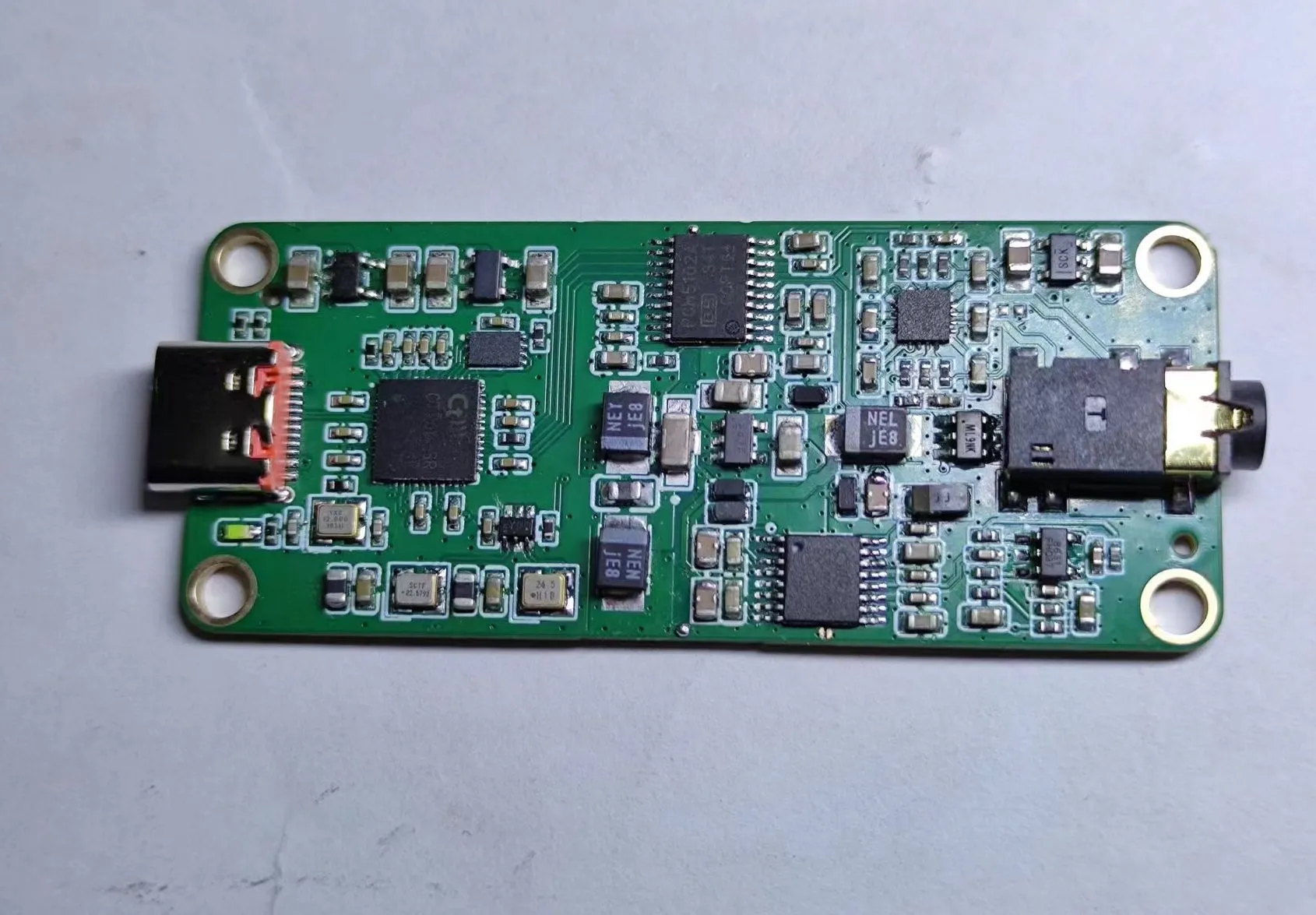

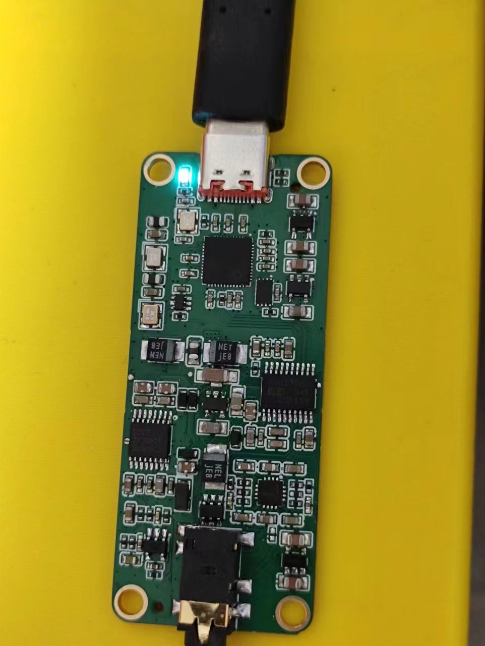

CT7601SR USB sound card
The CT7601 decoding chip + PCM5102A DAC + CS5340 ADC + LPA4722 headphone amplifier + SGM2549D headphone switching IC provide
192kHz 32-bit dual-channel output
and 192kHz 24-bit input with
150mW drive power.
It supports both CTIA and OMTP standard headphones.
My ears only detected a very loud sound; more key parameters haven't been tested with professional equipment yet. I'll test them when I have time.
The CT7601 requires firmware flashing; the flashing method and software are in the attached compressed file.
CT7601 Interface Data and Firmware.zip
PDF_CT7601SR USB Sound Card.zip
Altium_CT7601SR USB sound card.zip
PADS_CT7601SR USB sound card.zip
BOM_CT7601SR USB sound card.xlsx

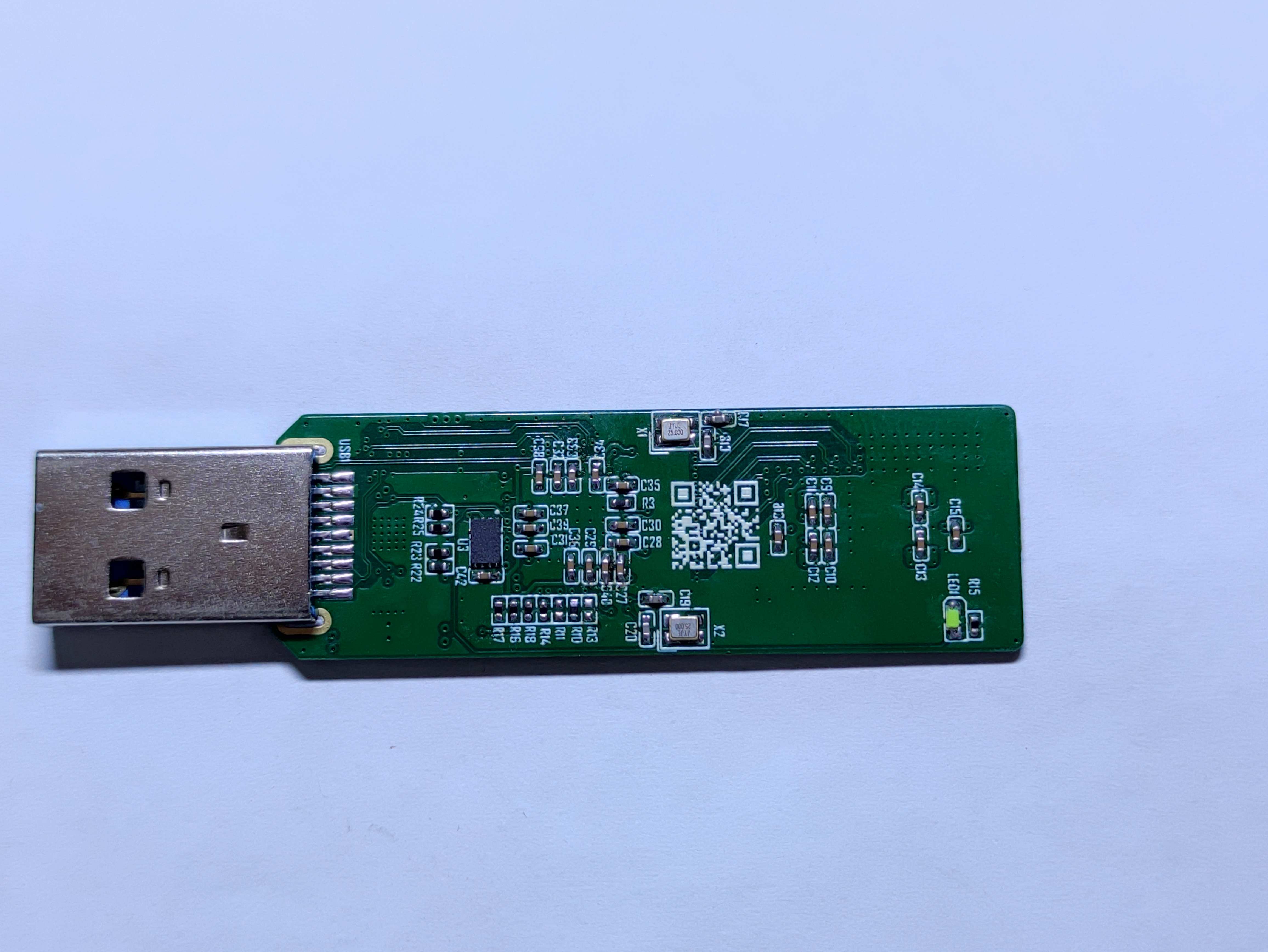

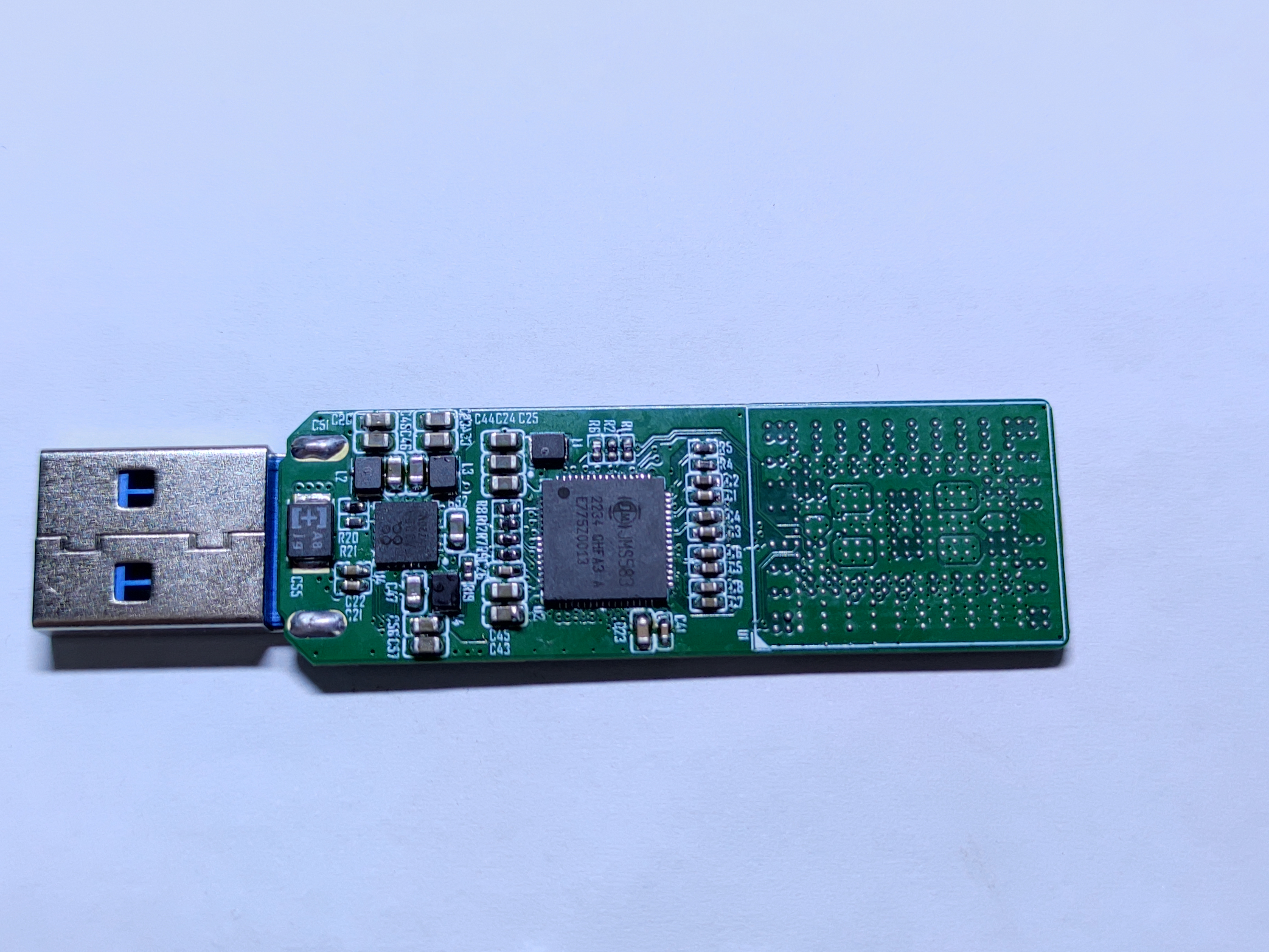

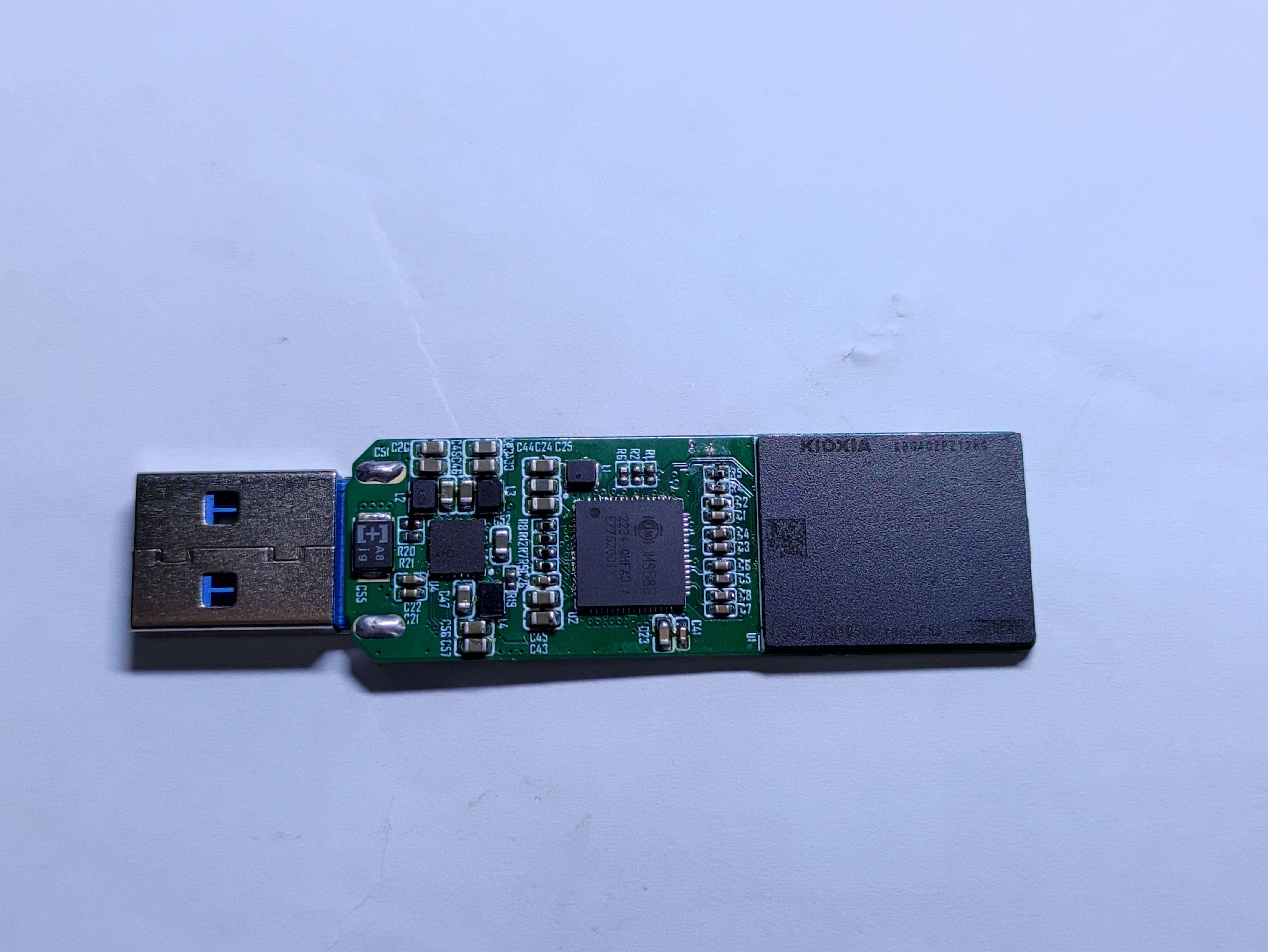

BGA291 High-speed USB flash drive
10Gbps high-speed USB flash drive based on JMS583 bridge chip
The controller is a JMS583 bridge chip, with USB 10G-PCIE3.0 x2 ports. Paired with BGA291 SSD NAND flash memory, its performance surpasses many USB flash drive solutions.
It is compatible with most NAND flash memory chips with 3.3V, 1.8V, and 1.2V three-way power supply, such as Kioxia BG3 and BG4, Samsung PM971, PM991, and Hynix BC501.
Note that Samsung PM971 and PM991 require an additional X1 crystal oscillator; PM971 works fine in testing, PM991 is untested
and incompatible with the most powerful BC711, which requires four power supplies with completely different voltages.
The firmware flashing tool is attached; it allows modification of names and power-saving settings.
Both the NAND flash memory and controller generate significant heat, requiring an aluminum casing with thermal pads. Testing showed that a 2mm pad on one side and a 1mm pad on the other side is just right for pressing
the casing firmly.
JMS583.zip
PDF_BGA291 High-Speed ​​USB Flash Drive.zip
Altium_BGA291 high-speed USB flash drive.zip
PADS_BGA291 High-Speed ​​USB Flash Drive.zip
BOM_BGA291 High-Speed ​​USB Flash Drive.xlsx

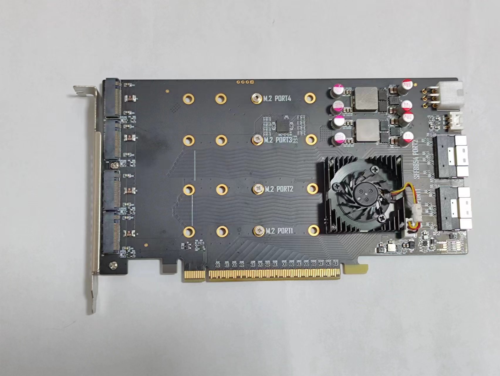

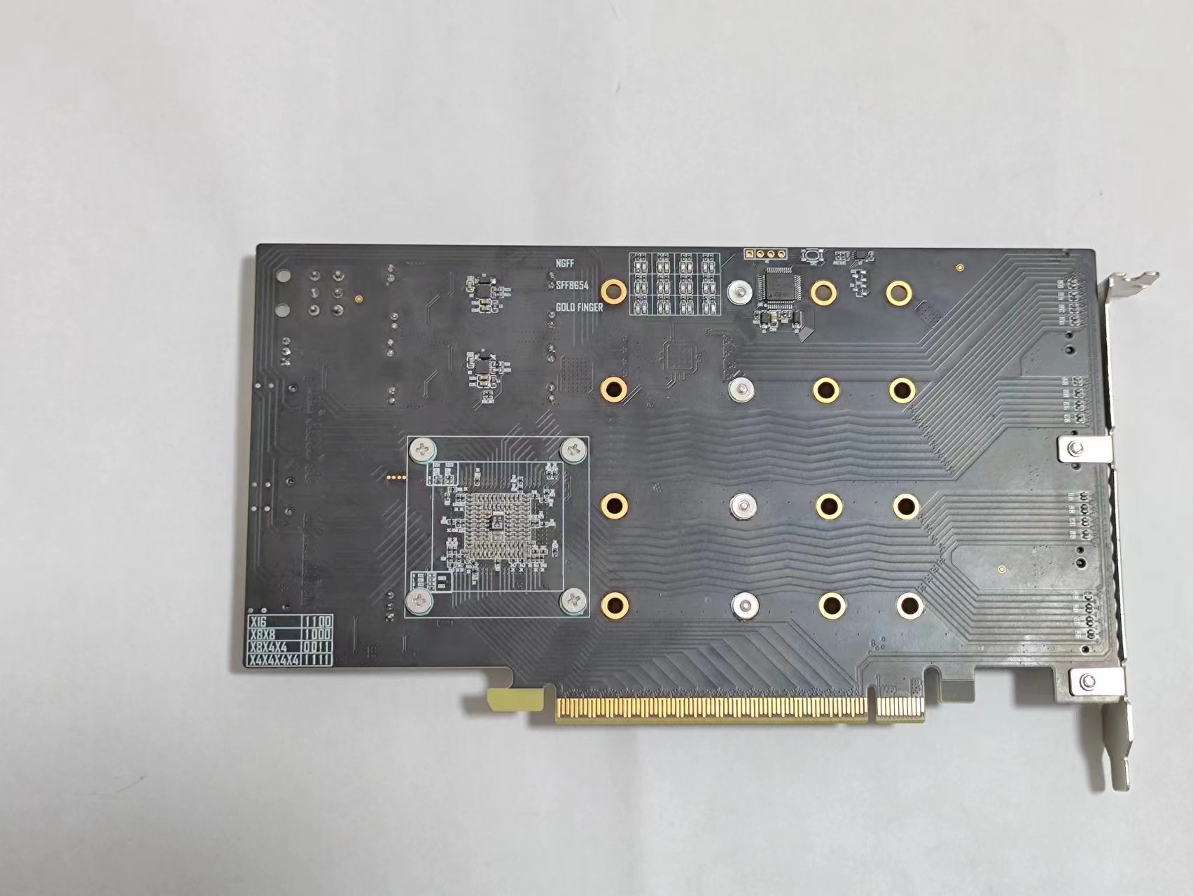

PEX8748 PCIe Expansion Card
This PCIe expansion card, based on the PEX8748 PCIe switch, incorporates an MCU to resolve the issue where the PEX card, when used with certain SSDs, could only negotiate PCIe Gen1, and can also display the working status in real time.
This PCIe expansion card, based on the PEX8748 PCIe switch, expands from a single PCIe x16 slot to provide four M.2 interfaces and two SFF-8654 8i interfaces
. Modified from this project, some changes have been made
, including a shorter overall layout and
the addition of an MCU to address the issue of some SSDs only negotiating PCIe Gen1 when used with the PEX8748
. The MCU can read the status, connection speed, and width of each interface, displaying this information in real-time via LEDs (see video).
Impedance stacking is explained in the PCB file.
The attached bin file contains the MCU's program; STM32 cube programmer is recommended. I/O
shield and
heatsink connections are also provided.
x264.mp4
pex8748.bin
PDF_PEX8748 PCIE Expansion Card.zip
Altium_PEX8748 PCIe Expansion Card.zip
PADS_PEX8748 PCIe Expansion Card.zip
BOM_PEX8748 PCIe Expansion Card.xlsx
