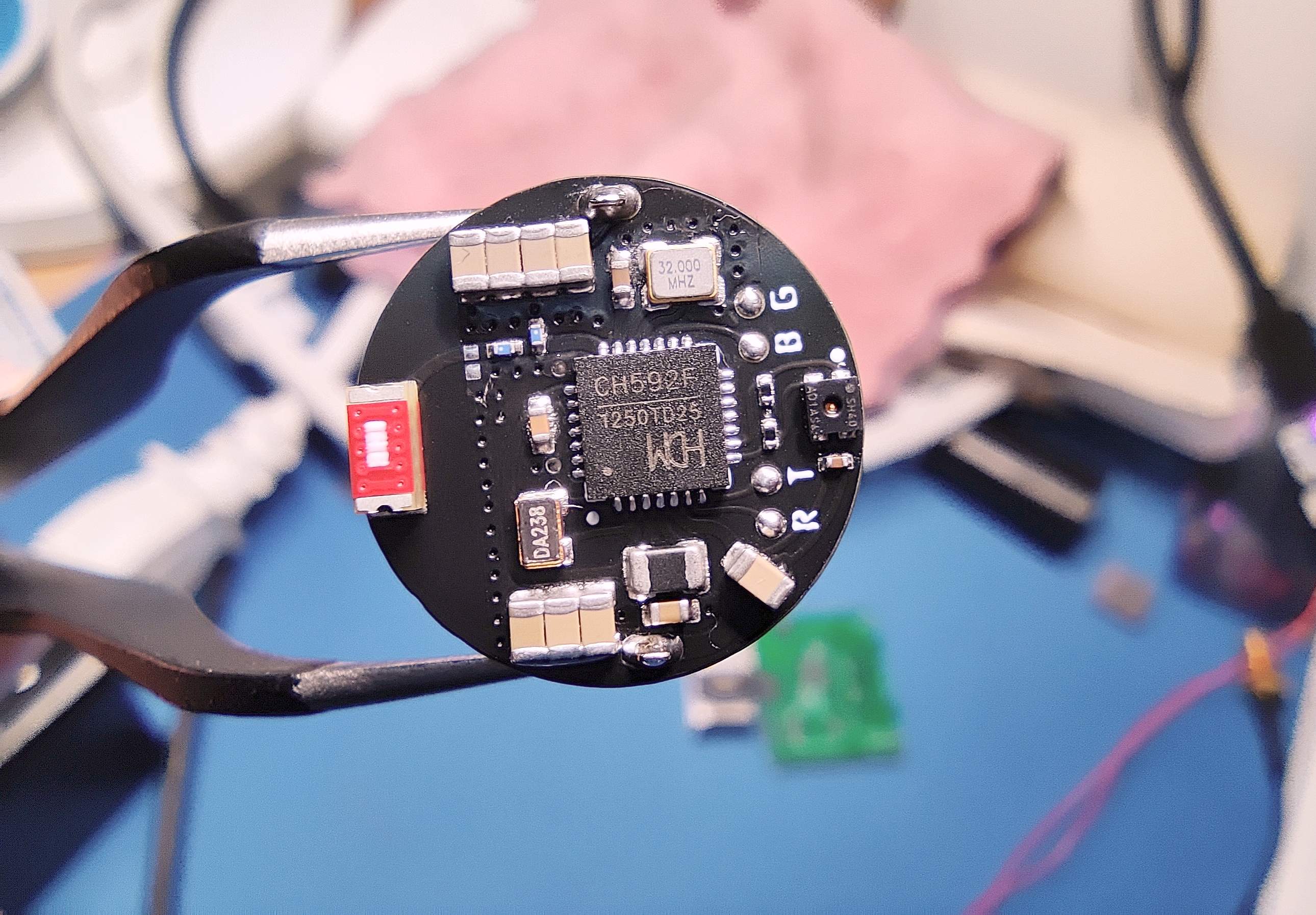

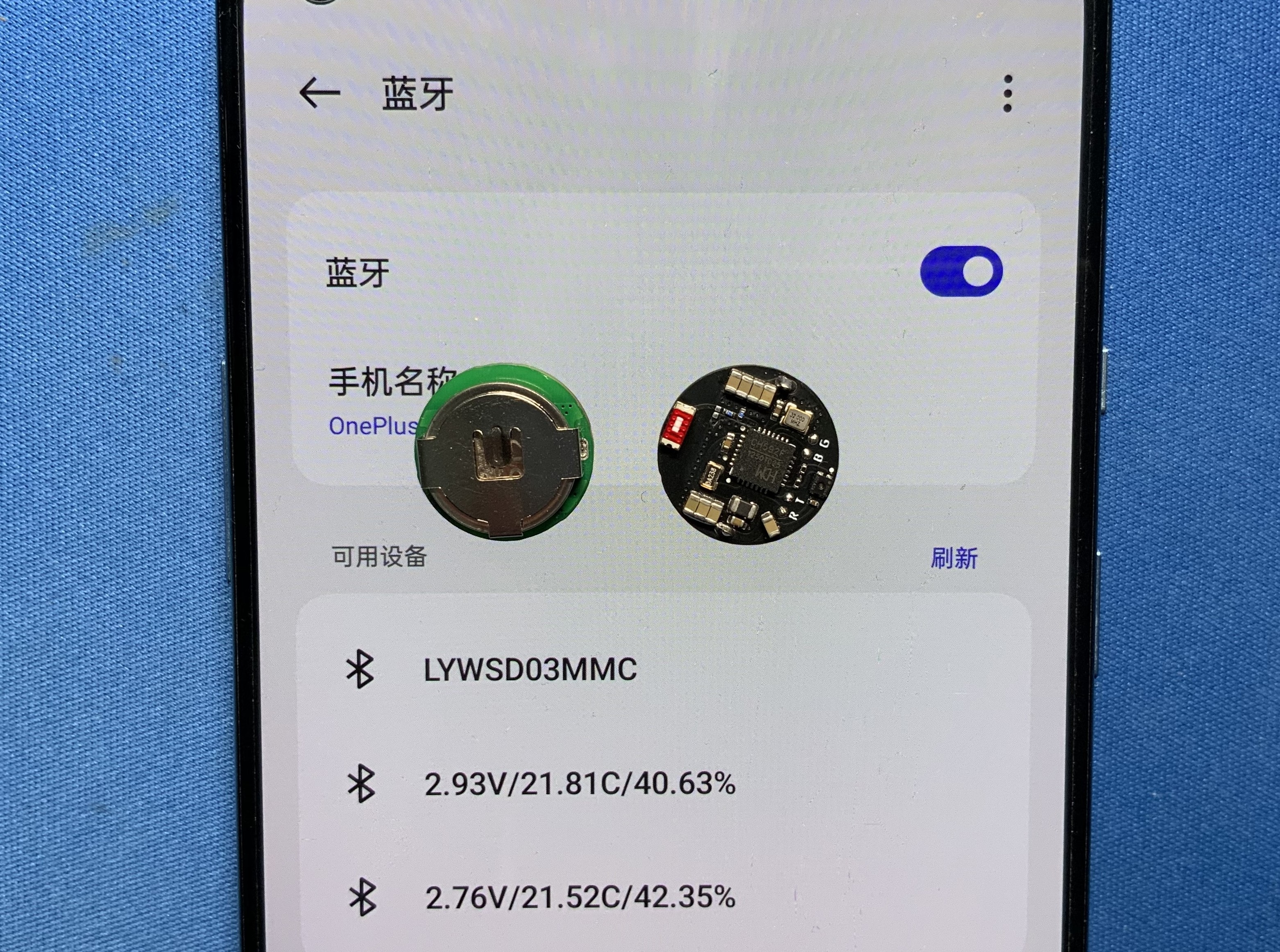

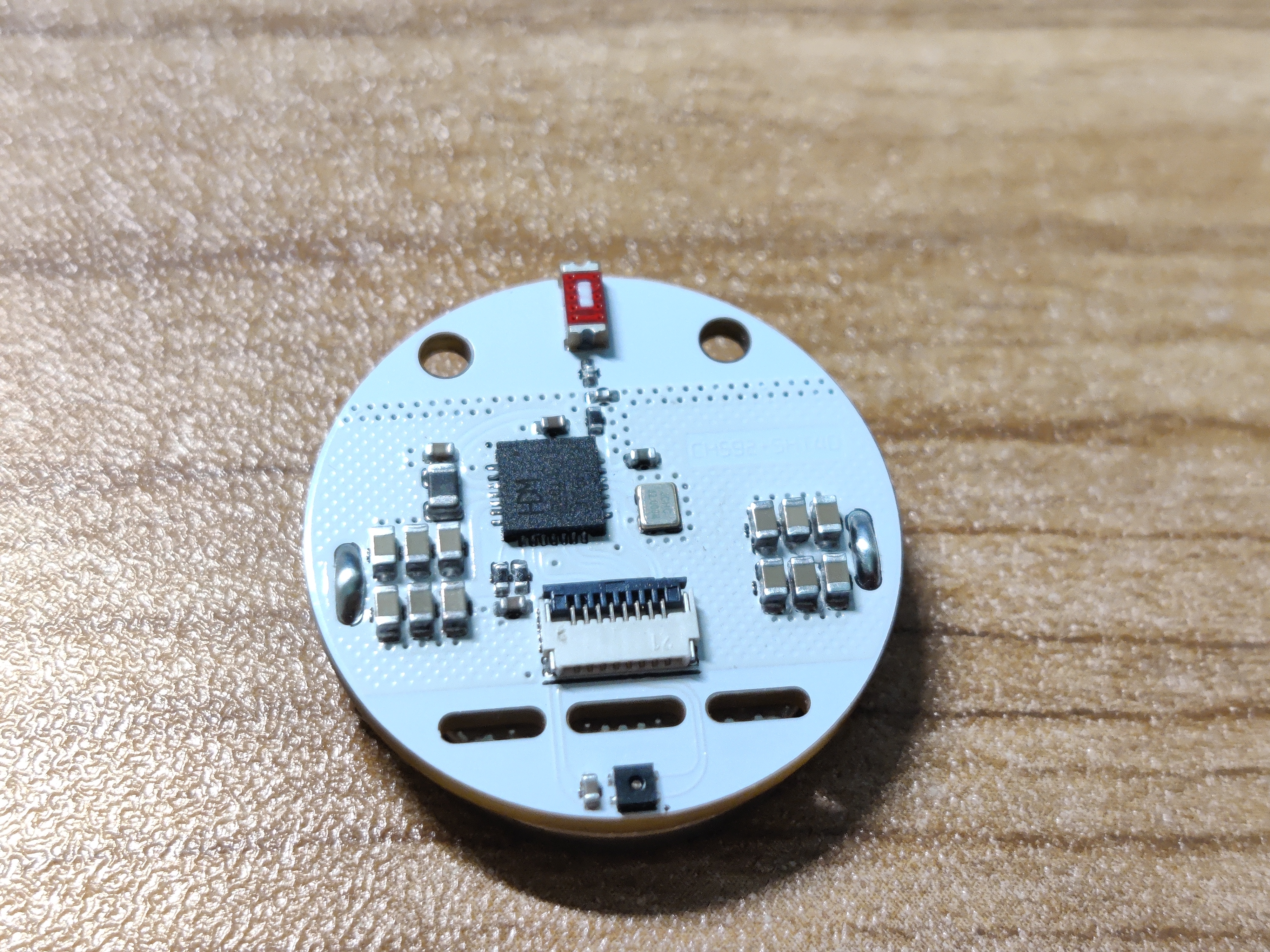

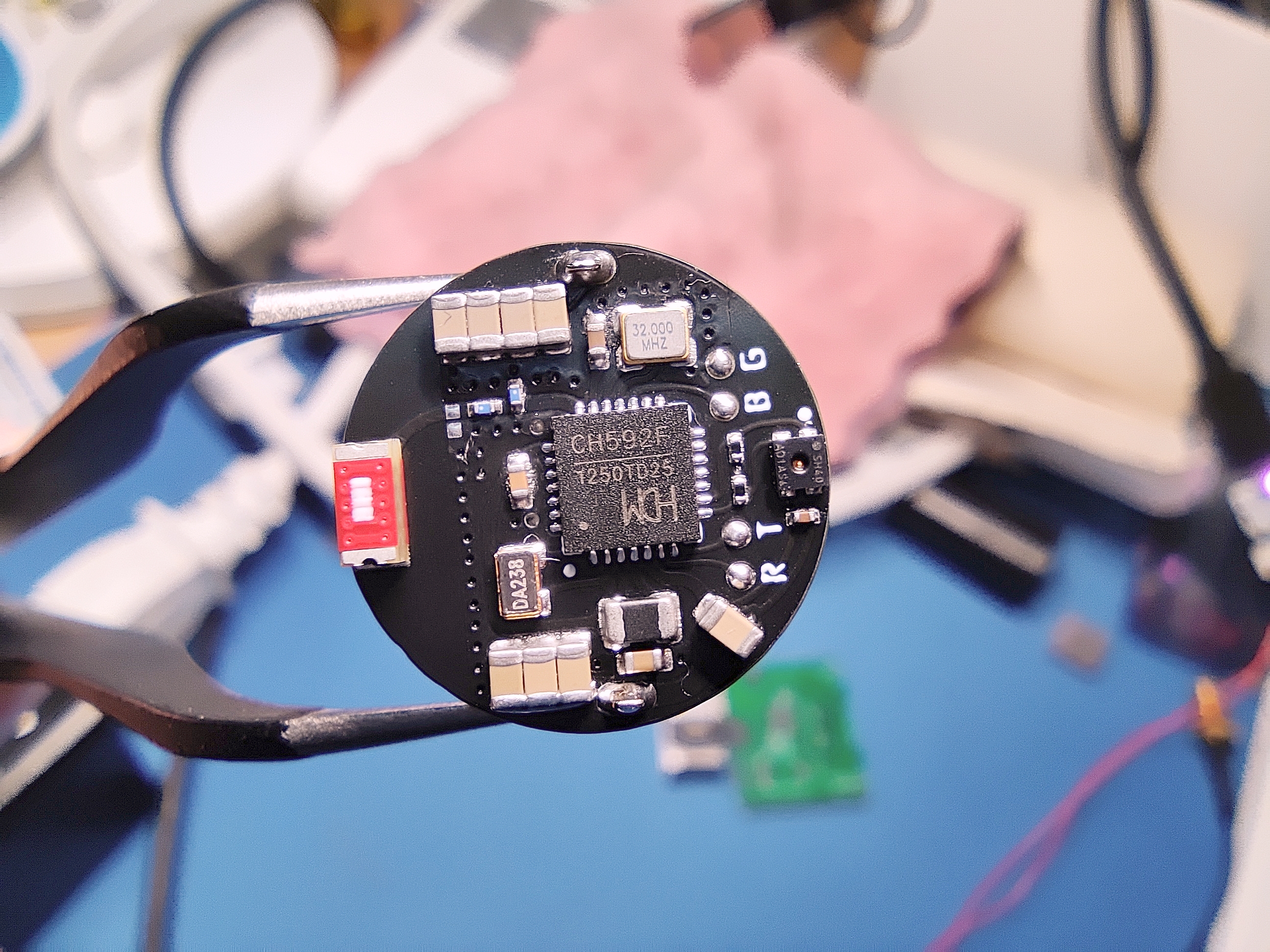

Project Overview:
This is a Bluetooth thermo-hygrometer based on the Qinheng CH592F chip, powered by a CR1220/CR1225 coin cell battery, and using an SHT40 temperature and humidity sensor. Its features include ultra-low power consumption, with an average current of only 8.7uA, and a theoretical operating time of 6 months using a 40mAh coin cell battery. It is suitable for smart home temperature and humidity monitoring.
CH592 Introduction to
SHT40 Introduction to
Burning Tutorial
Burning Video Tutorial: https://www.bilibili.com/video/BV1na4y1D7rT/
Burning Tool: https://www.cnblogs.com/gscw/p/16034836.html
Code and firmware are attached below.

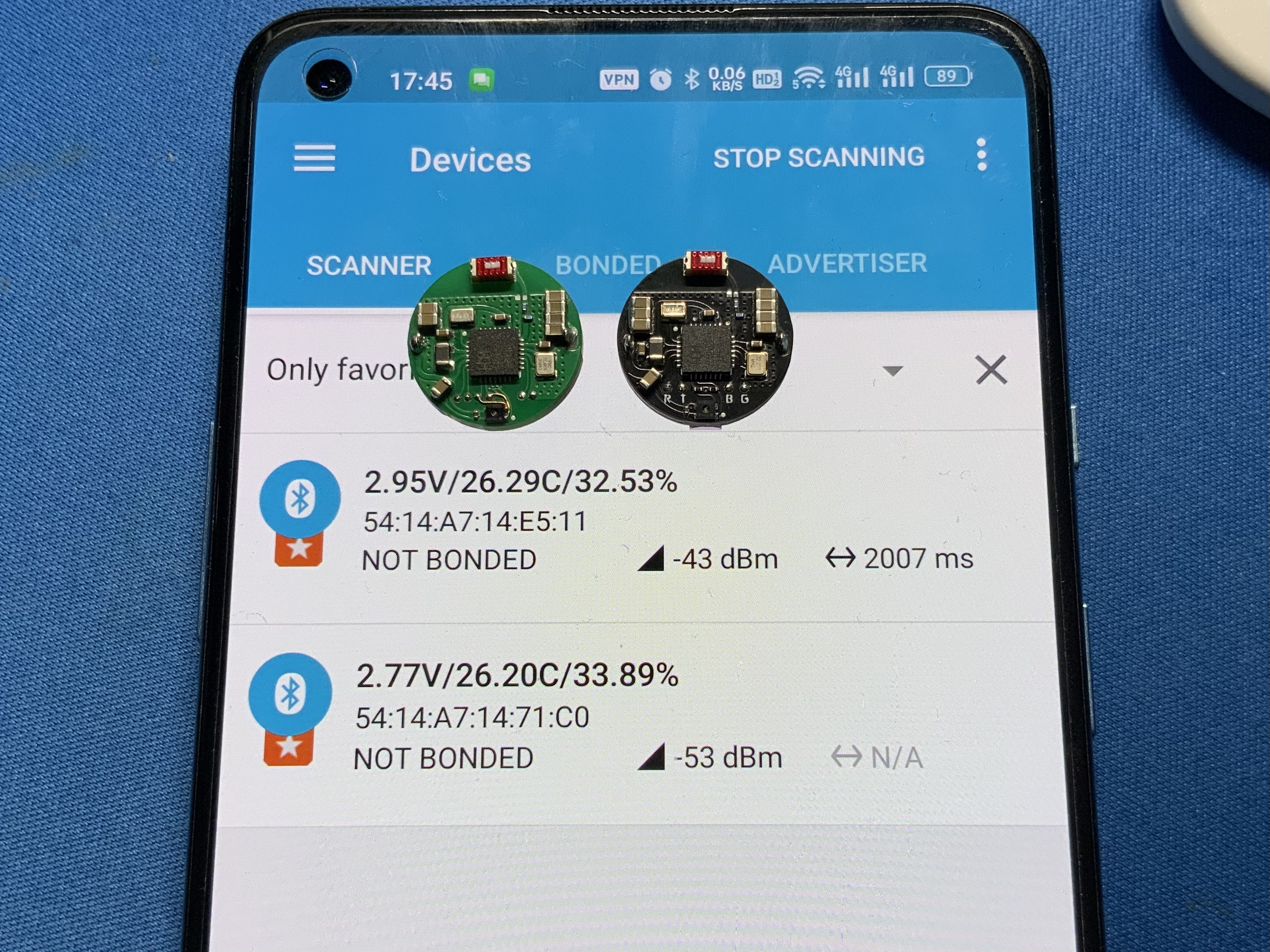

Actual Usage Time
: Used Nanfu Chuanying CR1220 button battery.
Started working on 2023-10-30 -> Stopped working on 2024-05-20, actual working time approximately 202 days.
CR2032 battery not yet tested.

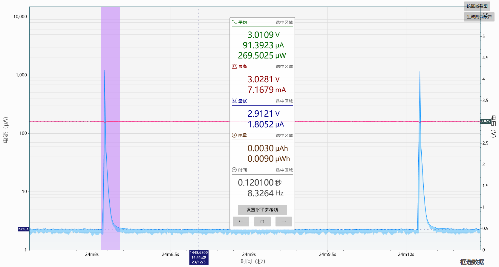

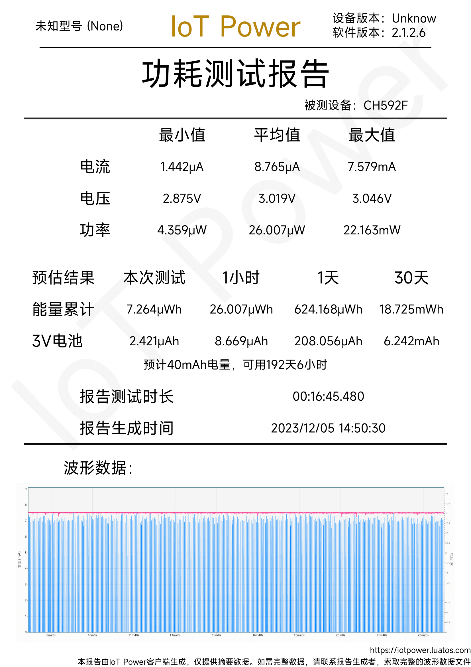

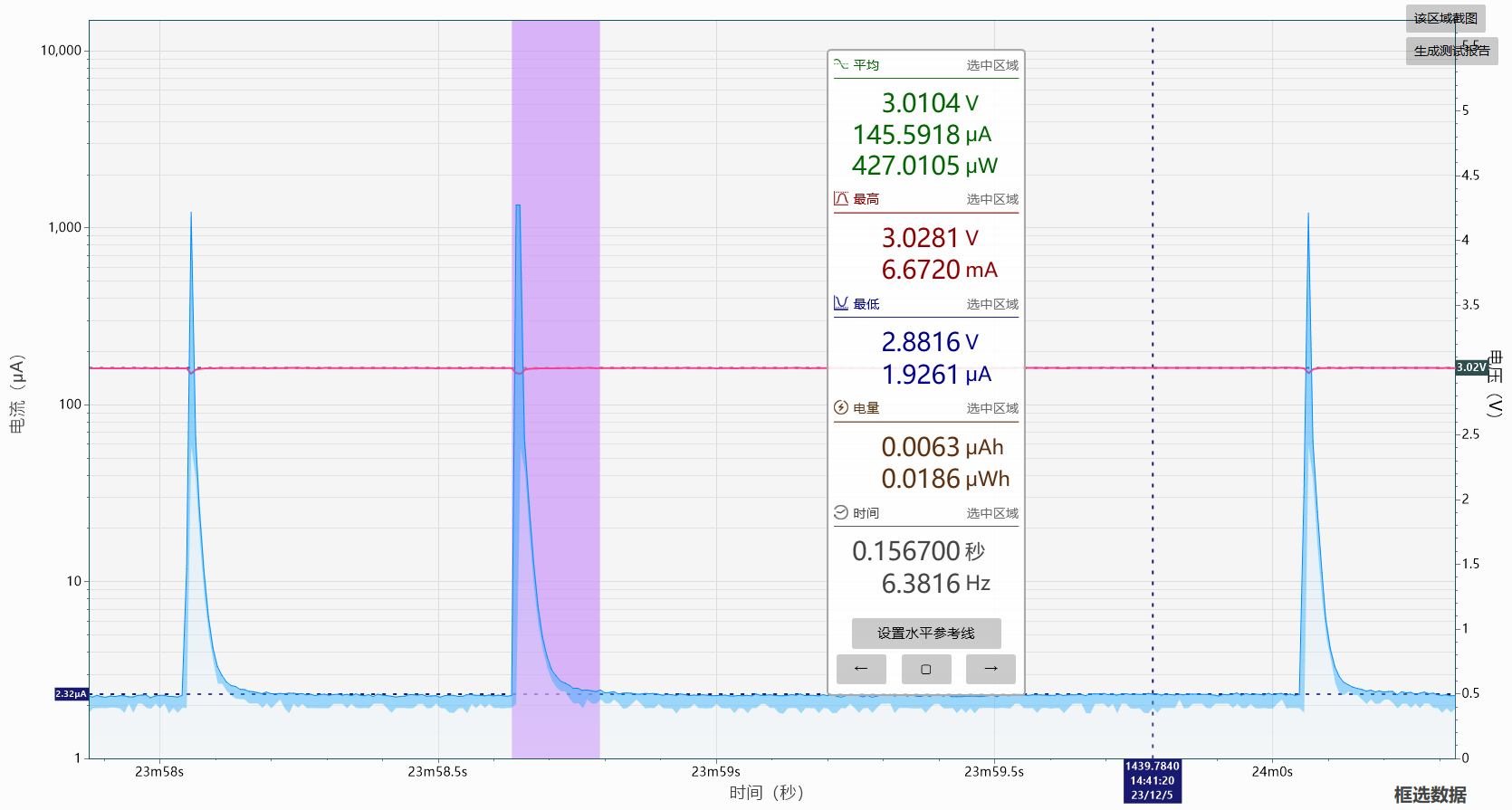

Power Consumption Test
: Test Conditions:
2-second interval broadcast, 20-second interval measurement of battery voltage, temperature, and humidity.
DC-DC enabled, using external 32768Hz crystal
oscillator. Transmit power set to 0 dBm.
SHT40 set to low precision mode.
IoT Power Consumption Test Report:
During broadcast:
Voltage. During temperature and humidity measurement:

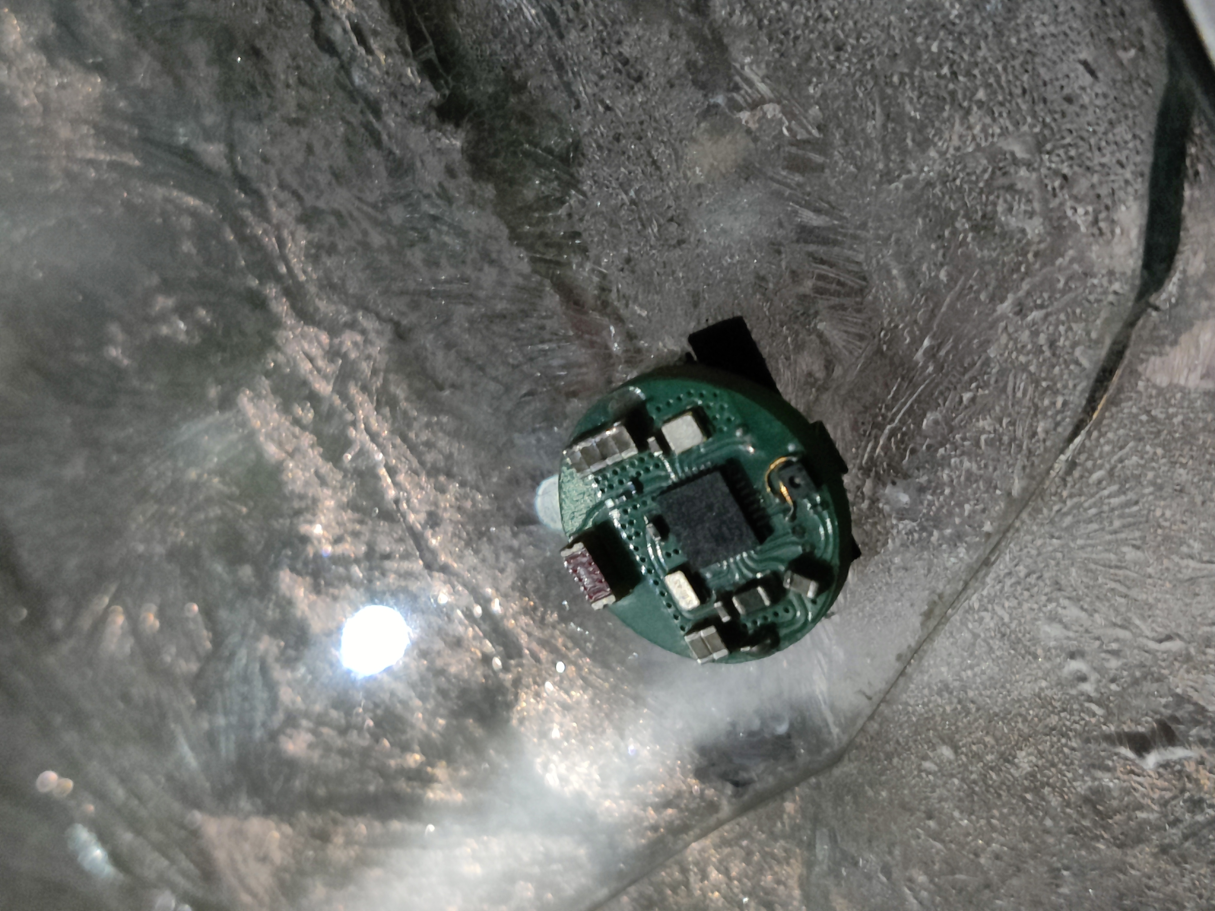

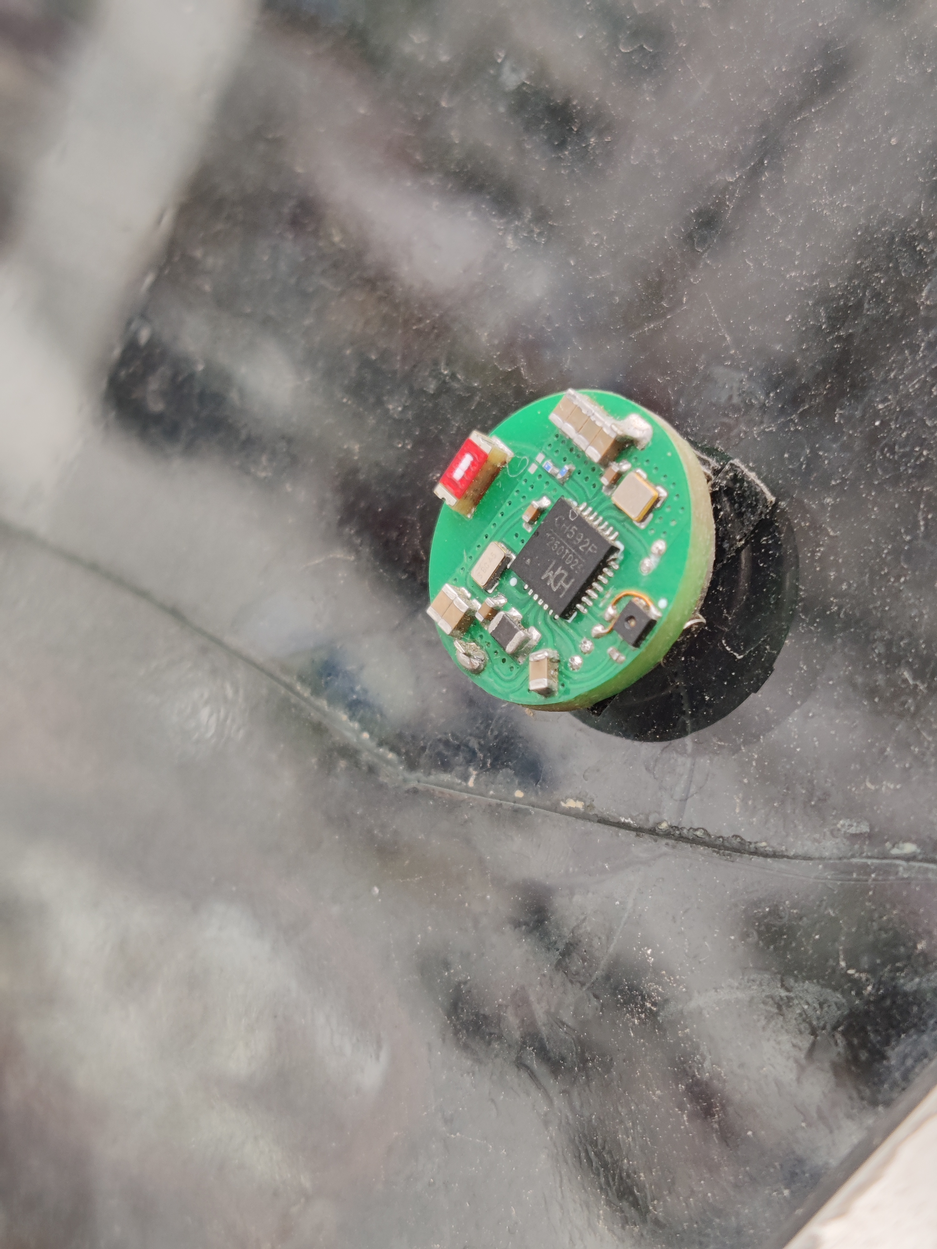

Actual photo
: Attached to an icy window outdoors. Working:
