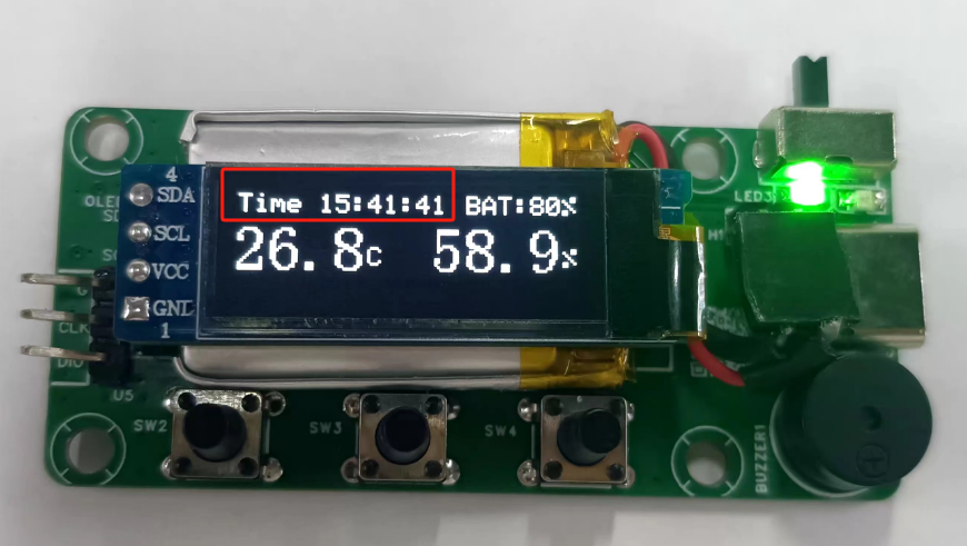

* 1. Project Function Introduction
Design an indoor thermometer and hygrometer with a time function;
support OLED display (128X32);

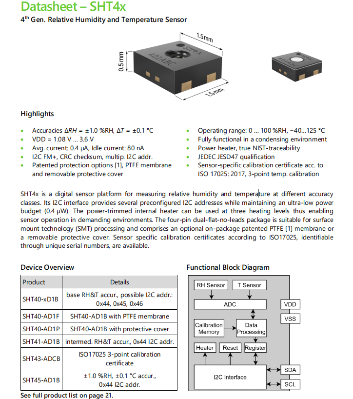

support SHT40 temperature and humidity acquisition;
support clock display and setting;
support alarm clock display and setting;
support buzzer response;
equipped with a lithium battery and support charging function;
support low battery reminder;
support LED charging indicator.

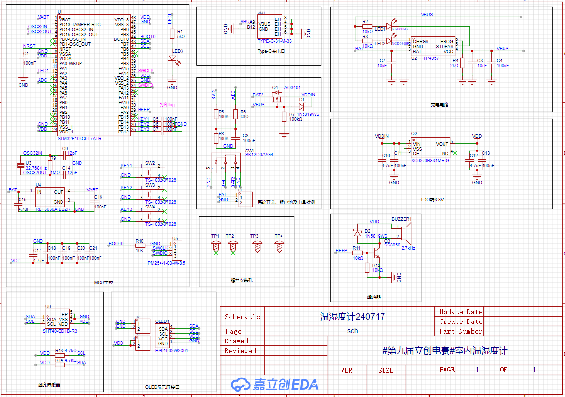

*4. Hardware Part
This project has simple functions and uses LCSC EDA for design. The overall design is as follows, and each part will be introduced in detail later.
Main Control
Circuit The main control circuit uses STM32F103C6. The reason for choosing this chip is as follows:
STM32F103C6 is a mainstream enhanced ARM Cortex-M3 microcontroller (MCU). The following is a detailed summary of its characteristics and parameters:
Core parameters:
32-bit RISC core, based on ARM Cortex-M3 architecture.
Maximum operating frequency up to 72 MHz.
Performance of 1.25 DMIPS/MHz (Dhrystone 2.1) with zero-wait memory access.
Memory:
High-speed embedded memory, including 32 KB Flash memory and 6 KB SRAM memory.
Peripherals and Interfaces:
Two 12-bit ADCs (Analog-to-Digital Converters) for analog signal acquisition.
Three 16-bit general-purpose timers plus one PWM timer for precise timing and motor control applications.
Abundant communication interfaces, including up to two I²C, SPI, three USARTs, one USB, and one CAN interface for easy communication with external devices.
Power Supply and Temperature:
Supply voltage range of 2.0 to 3.6 V.
Operating temperature range of -40 to +85 °C, extended temperature range of -40 to +105 °C.
Energy Saving and Security:
Provides a comprehensive set of energy-saving modes suitable for low-power application designs.
Hardware encryption and access control functions protect system security.
Package and Pinout:
Available in different package types from 36 pins to 64 pins to meet different application requirements.
Other features:
Supports multi-channel PWM output, which can be used for controlling devices such as LEDs and motors.
Interrupt and DMA functions enable efficient data transmission and processing.
Internal clock and reset circuits are integrated to provide stable clock signals and reset functions.
The STM32F103C6 is widely used in motor drives, application control, medical and handheld devices, PC and gaming peripherals, GPS platforms, industrial applications, and many other fields due to its high performance, rich peripheral interfaces, and flexible configuration options. The

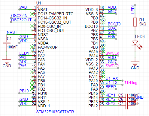

pin assignment and minimum system of this main controller are shown in the figure below:
To make the RTC more accurate, an external crystal oscillator is used.
For time-loss retention, VBAT is separately brought out and powered by a reference voltage chip.

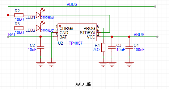

The charging circuit
uses the TP4057. The reason for choosing this chip is as follows:
The TP4057 is a constant current/constant voltage linear charger chip designed for single-cell lithium-ion batteries. The following is a detailed summary of the characteristics of the TP4057:
Package and pinout:
Common package types are SOT23-6 or SOT23-6L.
It has fewer external components, making it very suitable for portable products.
Charging Characteristics:
The charging voltage is fixed at 4.24V (or labeled 4.2V).
The charging current can be set via an external resistor, with a maximum charging current of 500mA or 600mA (depending on the version).
It uses C/10 charging termination, meaning the chip automatically ends the charging process when the charging current drops to 1/10 of the set value.
Temperature and Power Management:
It features intelligent thermal regulation, automatically reducing the charging current under high-power operation or high ambient temperature conditions to limit chip temperature.
When the input voltage is disconnected, the TP4057 enters sleep mode, and the battery leakage current drops below 1uA (or labeled 3uA, depending on the status).
In standby mode, the chip's quiescent current drops to 25uA or 40uA (depending on the version and status).
Protection and Safety Features:
Based on a special internal MOSFET architecture and reverse charging protection circuit, no external sense resistor or isolation diode is required.
Features include battery temperature monitoring, undervoltage lockout, and automatic recharge.
When the ambient temperature is too high, thermal feedback can adjust the charging current to reduce the chip temperature.
Status Indicators:
Features two open-drain status indicator outputs: CHRG (charging status indicator) and STDBY (battery charging complete indicator). CHRG is pulled low when the charger is charging; STDBY is pulled low when charging is complete.
Applications:
Suitable for portable devices such as mobile phones, PDAs, MP3/MP4 players, Bluetooth headsets, GPS devices, charging docks, digital cameras, and mini speakers.
Other Features:
Can directly charge single-cell lithium-ion batteries from a USB port.
Preset charging voltage accuracy reaches ±1%.
Supports two-lamp mode for clearer charging status.
In summary, the TP4057 is a powerful, safe, and reliable lithium-ion battery charger chip widely used in various portable electronic devices.

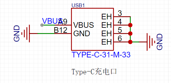

Charging via a TYPE-C interface is shown in the design diagram below.

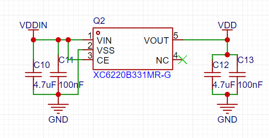

Power Conversion Design
: Due to the unstable power supply voltage of lithium batteries, an LDO is used for conversion. The system requires 3.3V. Therefore, the XC6220B331MR-G was chosen. Details are as follows:
The XC6220B331MR-G is a power management integrated circuit (PMIC) manufactured by Torex Semiconductor, specifically a low-dropout linear regulator (LDO). The following are the detailed parameters and characteristics of the XC6220B331MR-G:
Basic Parameters:
Manufacturer: Torex Semiconductor;
Product Model: XC6220B331MR-G
RoHS Status: Compliant with RoHS 2011/65/EU (6 substances)
Lead Free: Pb-free
Product Status: Available for sale (Lifecycle Status: In production)
Electrical Characteristics:
Regulator Type: Positive, Fixed
Output Voltage (Fixed): 3.3V
Maximum Input Voltage: 6V
Maximum Output Current: 1A
Voltage Drop (Max): 0.655V @ 1A
Quiescent Current (Iq): 18 µA
Supply Current (Max): 108 µA
PSRR (Power Supply Rejection Ratio): 50dB @ 1kHz
Protection and Control Characteristics:
Control Characteristics: Enable
Protection Functions: Overcurrent, Over-temperature
Operating Environment:
Operating Temperature: -40°C ~ 85°C
Mounting Type: Surface Mount
Package and Dimensions:
Package/Case: SOT-25-5 (SC-74A, SOT-753)
Supplier Device Package: SOT-25
Other:
RoHS compliant, lead-free and environmentally friendly
packaging method is tape and reel The XC6220B331MR-G is a stable, well-protected 3.3V fixed output voltage low-dropout linear regulator

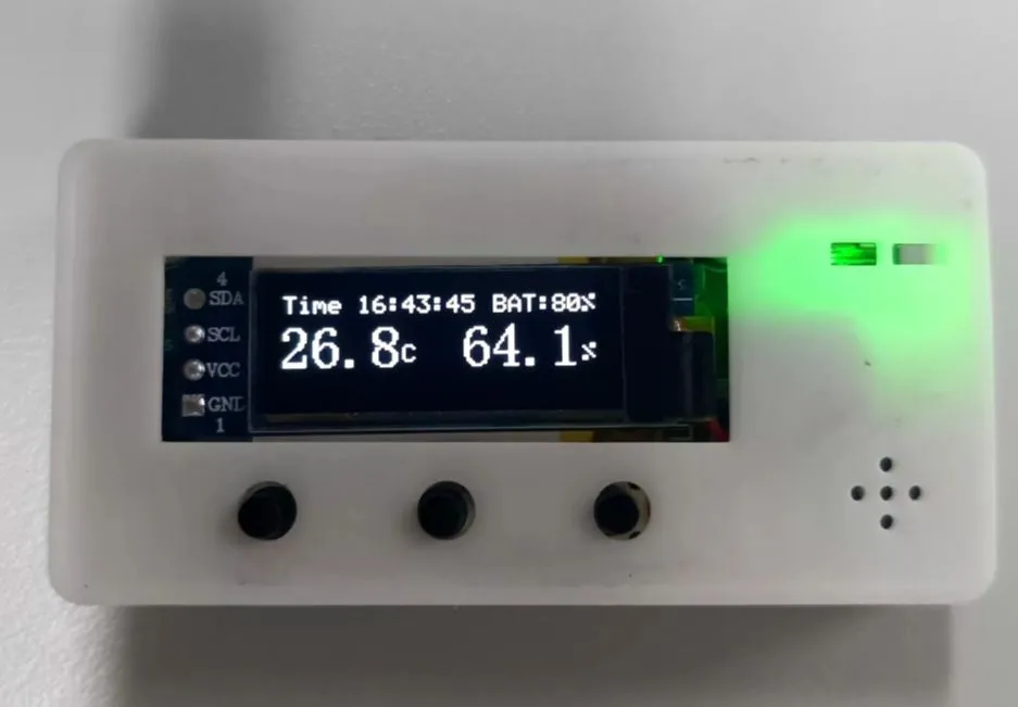

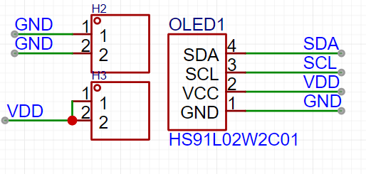

This uses a 0.91C monochrome LCD screen with the following performance characteristics:
The HS91L02W2C01 is a 0.91-inch OLED display from the HS (Hansheng) brand. The following are detailed parameters and features of the HS91L02W2C01:
Product Overview:
The HS91L02W2C01 is an OLED display using the I2C communication protocol, featuring a 4-pin black background and white backlight.
It is primarily suitable for various electronic devices requiring display functions, providing clear and delicate display effects.

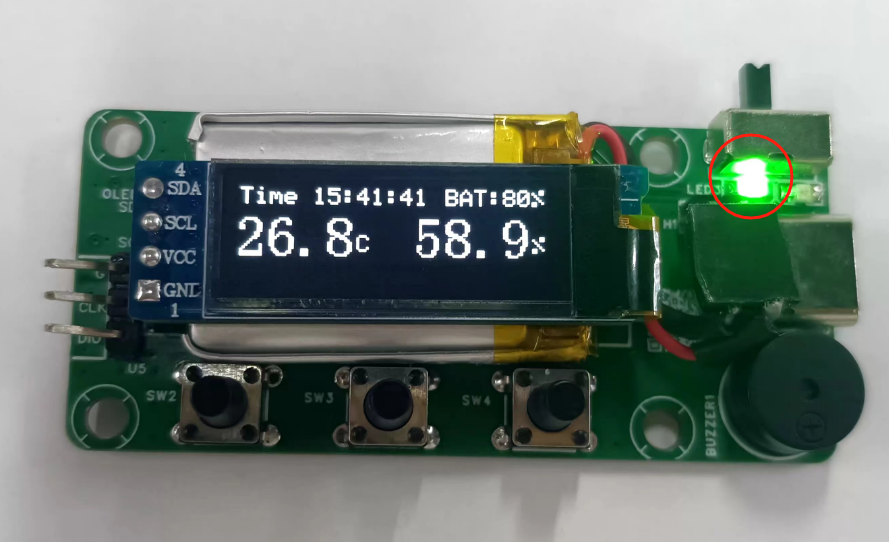

The interface is very simple, and the design is as follows:

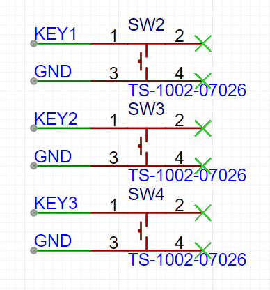

Button design:
Physical buttons are used here, and anti-shake is required. The design is as follows . Other circuits
include:

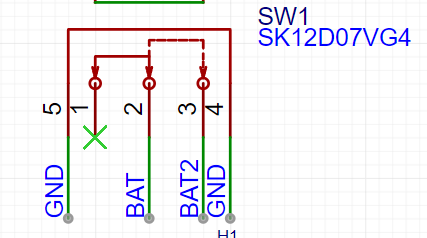

Switch; Charging port;

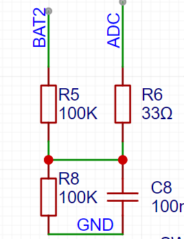

Lithium battery power acquisition:

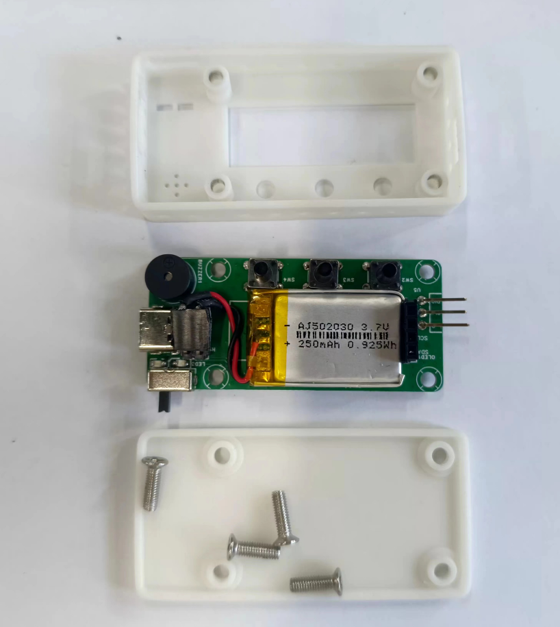

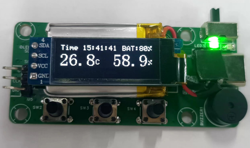

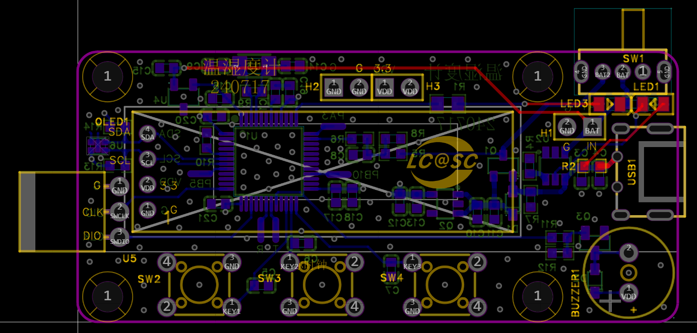

PCB design
: LCSC EDA is used for the design. Due to the small size of the board, batteries need to be installed.
The following issues need attention:
1- Component avoidance
2- Interface distribution
3- Installation design
. The overall design and routing are as follows.
A 4-layer board design is used here.

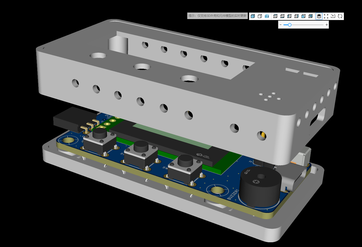

3D shell design:
1- Reasonable height design
2- Accurate opening position
3- Reasonable screw size selection
4- Appropriate opening size
5- Accurate calculation of component mounting height.
The design is shown in the figure below:

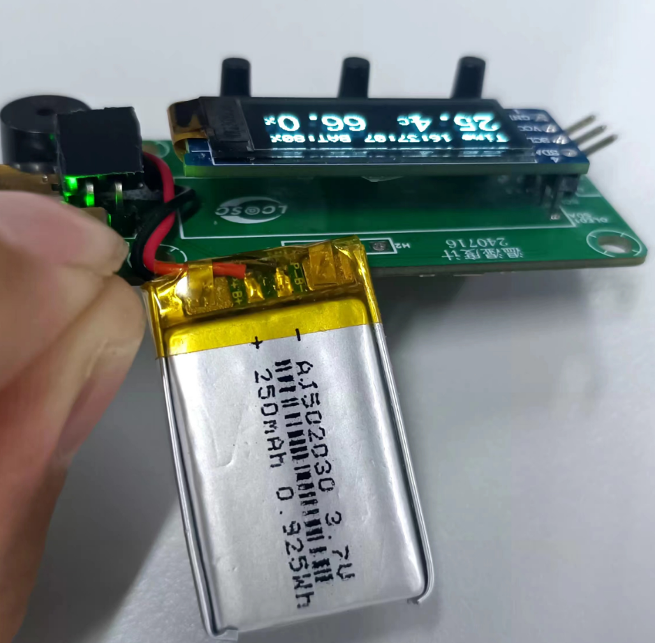

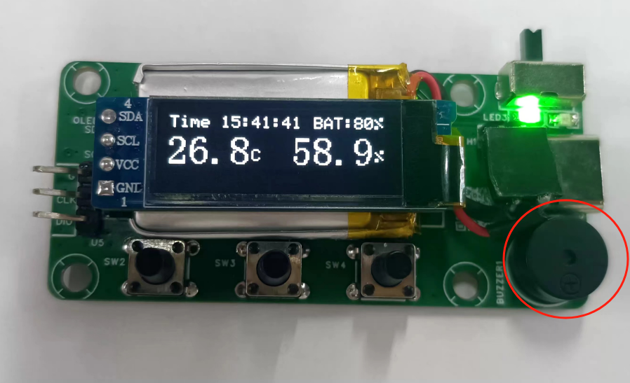

The actual picture is as follows:

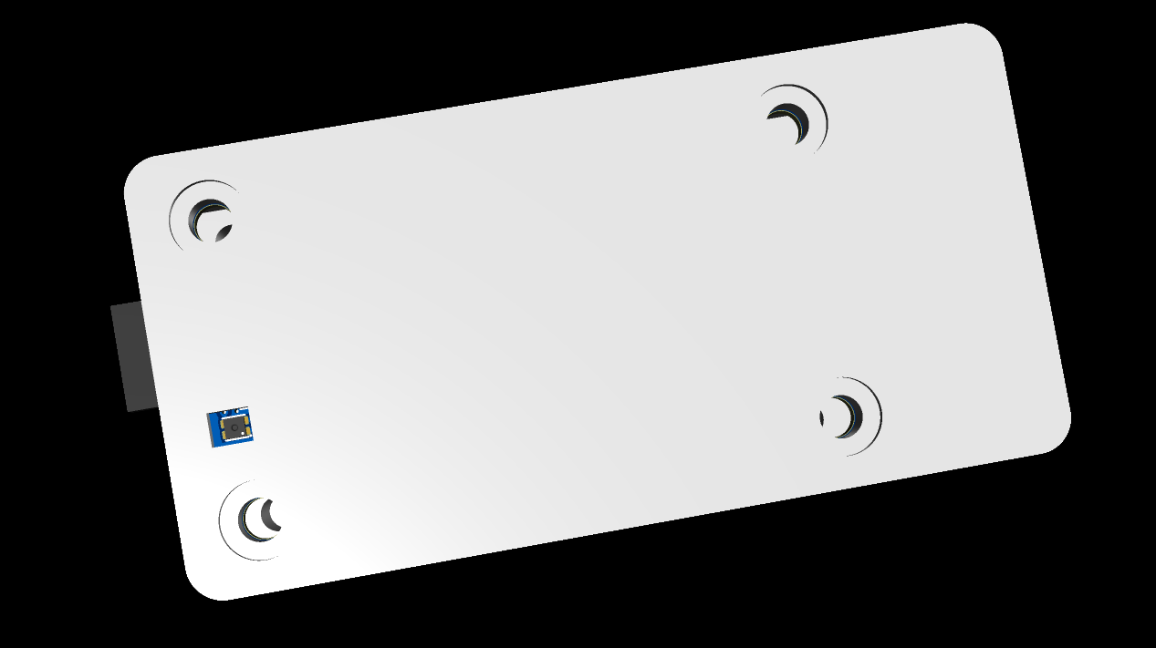

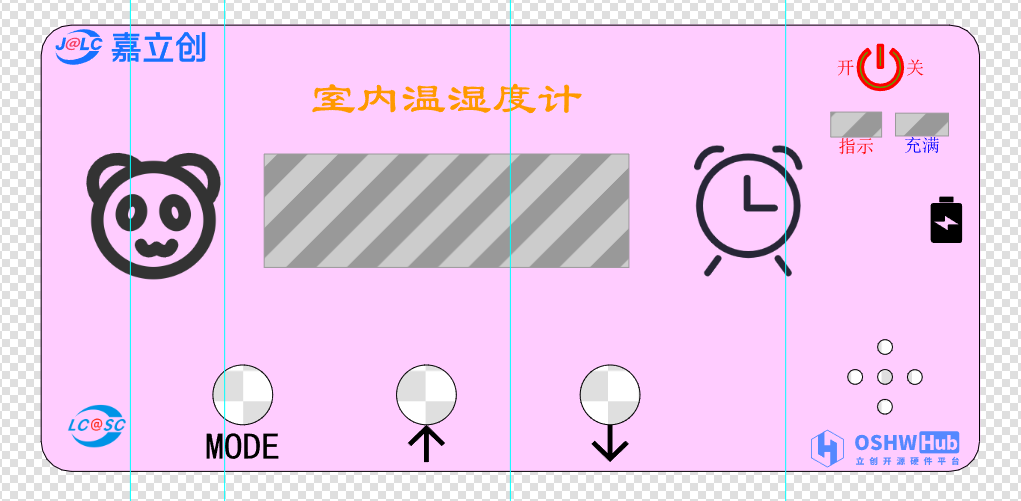

Panel design
: LCSC EDA is used for the design, which is very simple.
1- Accurate hole opening
2- Back adhesive cutout
3- Aesthetic design 4- Appropriate
color scheme. As
an engineer, this is barely usable and is for reference only.
The design effect is as follows .
I didn't have a coupon, so I couldn't make it.

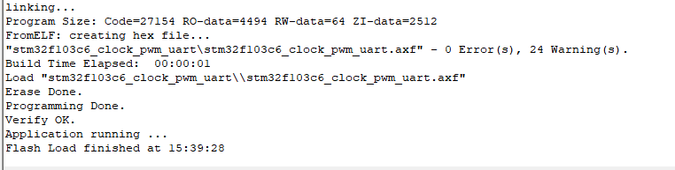

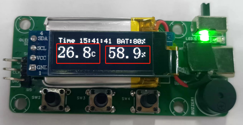

*5. Software part:
The software is developed based on Keil 5 and programmed in C language.
The main components are as follows:
1- The OLED driver
can be written according to the official driver manual.
The effect is as follows:
The main functions involved are as follows:
#define OLED_CMD 0 // Write command #define OLED_DATA 1 // Write data
void OLED_ClearPoint(u8 x,u8 y); void OLED_ColorTurn(u8 i); void OLED_DisplayTurn(u8 i)
; void I2C_Start(void); void I2C_Stop(void); uint8_t I2C_WaitAck(void); void I2C_Ack(void); void I2C_NAck(void); void Send_Byte(u8 dat); u8 Read_Byte(void);
void OLED_WR_Byte(u8 dat,u8 mode);void OLED_DisPlay_On(void);void OLED_DisPlay_Off(void);void OLED_Refresh(void);void OLED_Clear(void);void OLED_DrawPoint(u8 x,u8 y,u8 t);void OLED_DrawLine(u8 x1,u8 y1,u8 x2,u8 y2,u8 mode);//void OLED_DrawCircle(u8 x,u8 y,u8 r);void OLED_ShowChar(u8 x,u8 y,u8 chr,u8 size1,u8 mode);void OLED_ShowChar6x8(u8 x,u8 y,u8 chr,u8 mode);void OLED_ShowString(u8 x,u8 y,u8 *chr,u8 size1,u8 mode); void OLED_ShowNum(u8 x,u8 y,u32 num,u8 len,u8 size1,u8 mode); void OLED_ShowChinese(u8 x,u8 y,u8 num,u8 size1,u8 mode); void OLED_ScrollDisplay(u8 num,u8 space,u8 mode); void OLED_ShowPicture(u8 x,u8 y,u8 sizex,u8 sizey,u8 BMP[],u8 mode); void OLED_Init(void); //void OLED_DrawREC(u8 x,u8 y,u8 w,u8 h);
Due to the limited main control flash, only 8x6 and 24x12 fonts are retained.

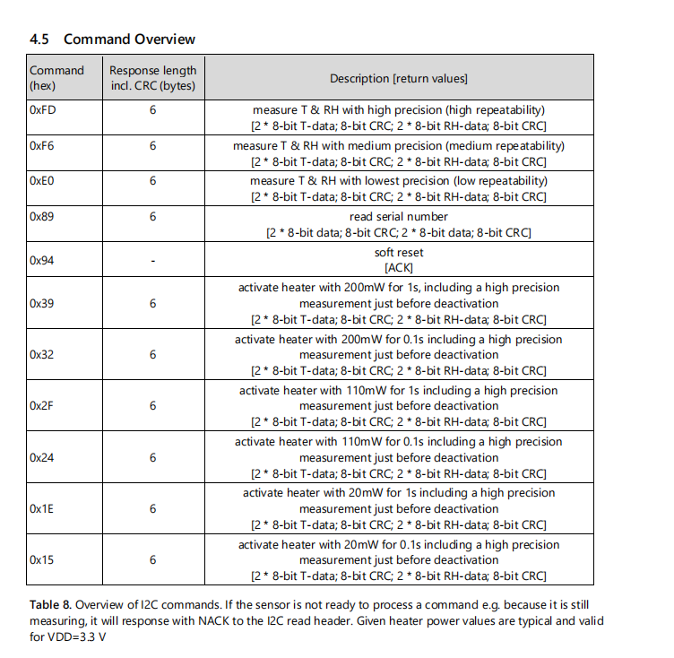

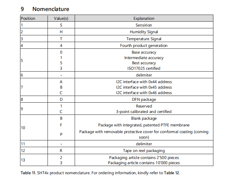

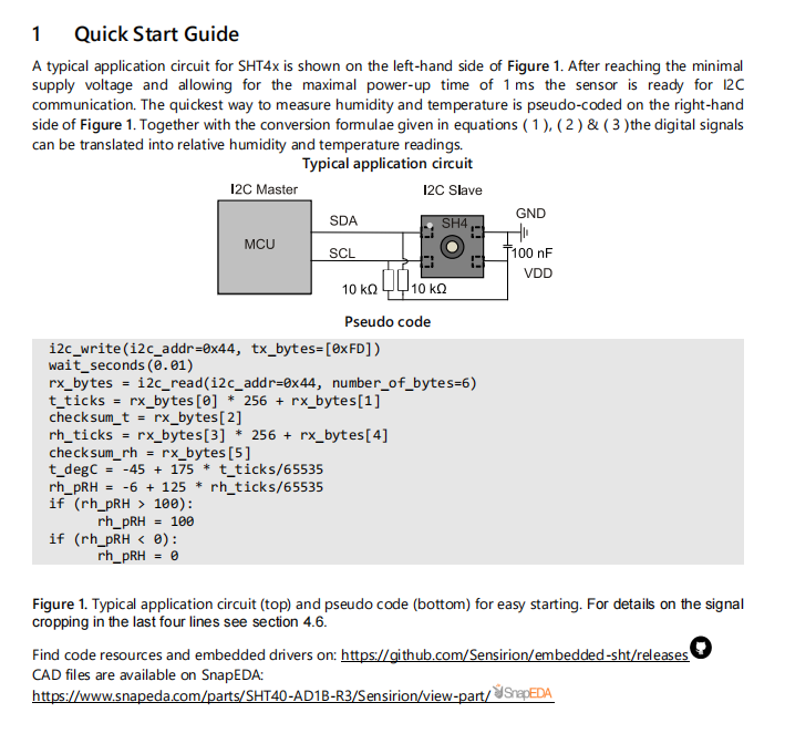

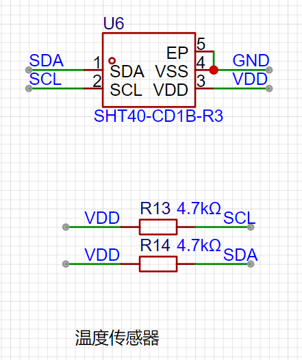

2- The sensor driver
must be written strictly according to the following specifications:
Note that the IIC address and the specific chip model must correspond.

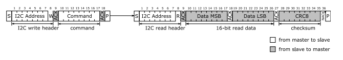

The IIC read/write timing control must strictly follow the following:
Command as follows:
Data read verification:

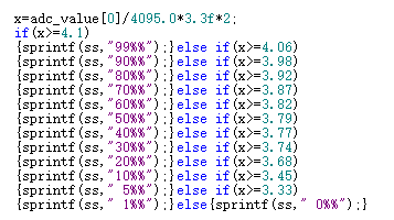

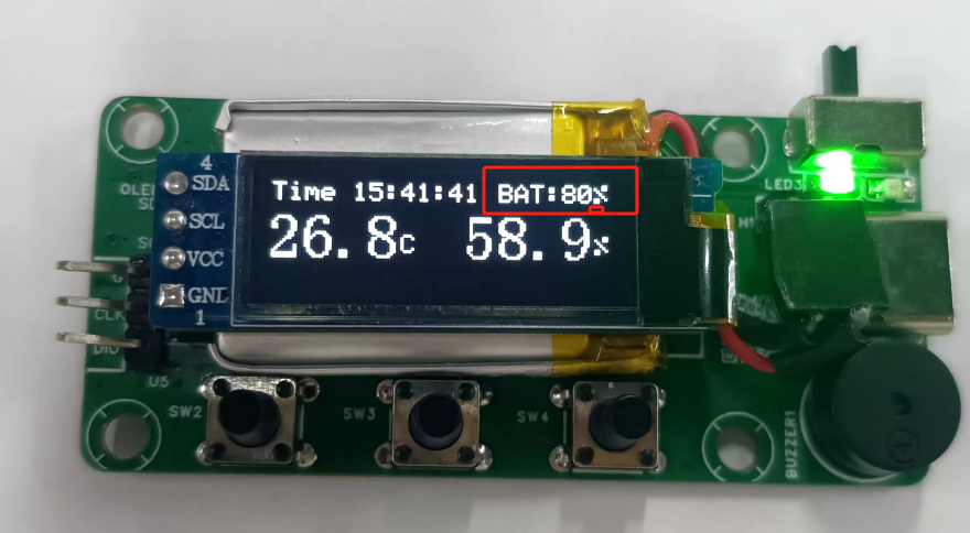

3-Lithium battery power acquisition is
acquired through the chip's ADC.
DMA mode storage.
Timed acquisition, function as follows:
HAL_ADC_Start_DMA(&hadc1,(uint32_t *)(&(adc_value[0])),1);
Acquisition effect:
Here the power has a quantitative standard, found online:
Program implementation as follows:
4-Time setting:
RTC time setting and acquisition. Function as follows:
    HAL_RTC_GetTime(&hrtc,&myTime,RTC_FORMAT_BIN); sprintf(ss,"Time %02d:%02d:%02d",myTime.Hours,myTime.Minutes,myTime.Seconds); OLED_ShowString(0,8,ss,8,1);//6*8
This needs to be saved by power off.

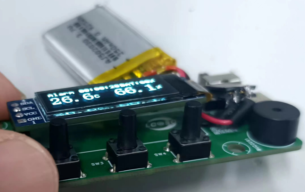

The results are verified as follows:
5- The LED light display
is controlled by PA2, as shown in the figure below.

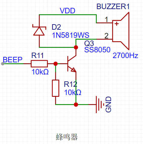

6- The buzzer
is driven by PWM:
HAL_TIM_PWM_Stop(&htim1,TIM_CHANNEL_1);
HAL_TIM_PWM_Start(&htim1,TIM_CHANNEL_1);
Note: If your project involves software development, please upload the corresponding project source code as an attachment. Here you can explain in detail your software flowchart, functional module block diagram, explanation or popularization of relevant algorithms, source code structure, compilation environment setup and configuration, source code compilation method, program burning method, etc. It is recommended to introduce your ideas to others in a graphic and textual format.
