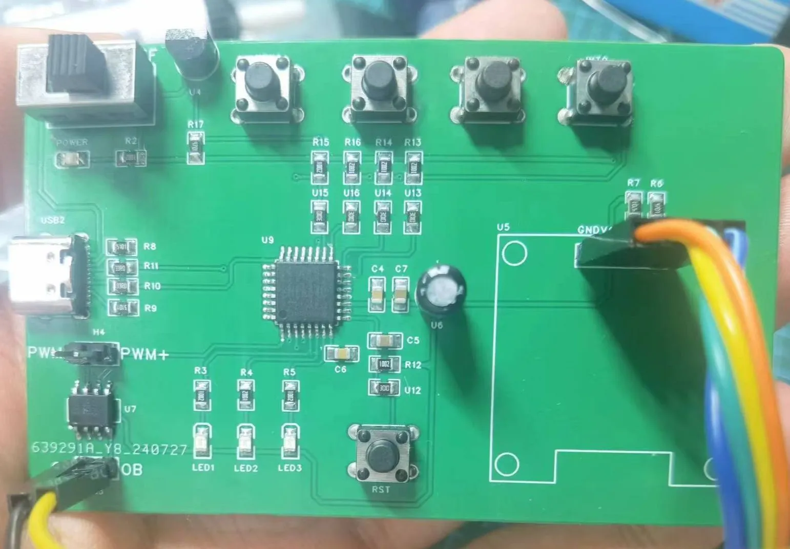

A smart fan using an STC8H8K64U as the main control chip and a DS18B20 as the temperature sensor. The fan measures the current temperature, adjusts the fan speed, and displays the data in real-time on an OLED screen.
III. Design Summary:
PCB design and soldering
; code writing, burning, and debugging.
IV. Design Analysis:
The STC8H8K64U main control chip integrates circuits such as the crystal oscillator, which originally required external design, greatly simplifying the circuit design.
V. Overall Design Block
Diagram: TD
reset --> Sensor acquires temperature --> Displays current temperature and fan speed --> Adjusts fan speed --> Sensor acquires temperature.

; Main Control Circuit
: STC8H8K64U main control chip and its peripheral circuits;
Sensor Interface Circuit :
DS18B20 connection and data acquisition circuit;
Display Circuit:
OLED screen connection and drive
circuit; Fan Control Circuit:
Fan drive and speed control circuit .
