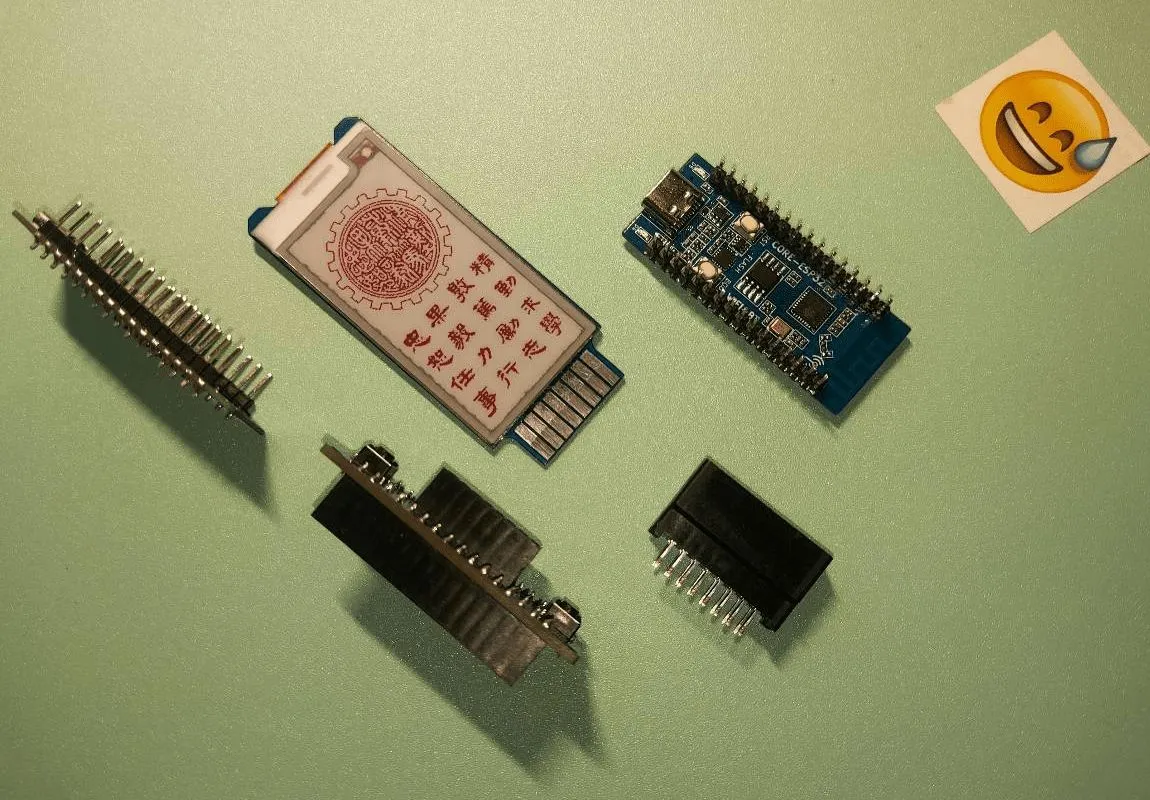

The hardware consists of
a three-color e-ink display with a resolution of 250x122 .
Two types of e-ink displays are available on Xianyu (a Chinese online marketplace):
one uses a UC8151c controller (the one used in this project)
, and the other uses an SSD1675B/SSD1680 controller; a common model is HINK-E0213A22.
To ensure correct display of black, white, red, and yellow colors, please use the driver from my GxEPD2 library: Zxis233/GxEPD2 at Modified_213_Driver.
For the UC8151c controller: `GxEPD2_3C display(GxEPD2_213_my(/*CS=5*/ 7, /*DC=*/4, /*RST=*/5, /*BUSY=*/6));`
For the SSD1675B/SSD1680 controller: `GxEPD2_3C display(GxEPD2_213_Z98c(/*CS=5*/ 7, /*DC=*/4, /*RST=*/5, /*BUSY=*/6));`
For the SSD1675B/SSD1680 controller, the border color setting only takes effect during screen initialization and cannot be changed in subsequent programs. Welcome to discuss the code with me and let's improve together.
For the UC8151c main controller, the bezel color setting is normal.
The purchased screen cable may be 24-pin or 26-pin. If it is the former, please purchase a 24-pin FPC socket for soldering; if it is the latter, you need to apply transparent tape to the back and cut the cable to a narrower width to insert it into the 26-pin FPC socket without it falling out.
It is recommended to use an FPC socket with a rear flip cover for better compatibility.
The driver
board's BOM is consistent with the original project, and the reference numbers and pin definitions have not been changed.
To ensure proper insertion and removal, it is recommended to choose a PCB thickness of 1.2mm.
The HeZhou ESP32-C3 development board
has been tested, and both the standard and simplified versions can be used. If you want to output logs via serial port, the standard version is recommended.
The simplified version can also print logs via serial port, but there is a probability of errors. Method: HeZhou ESP32-C3 simplified version uses serial port to print debugging information | Esing's small station

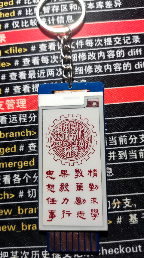

: Zxis233/My213EPD: A 2.13-inch three-color e-ink screen ornament/keychain developed using ESP32C3.
The keychain mode
has a hole pre-drilled at the top of the PCB for threading a lanyard. To avoid damage to the components on the back, it is recommended to seal and protect them with epoxy resin/silicone rubber/conformal coating:
Image Preview

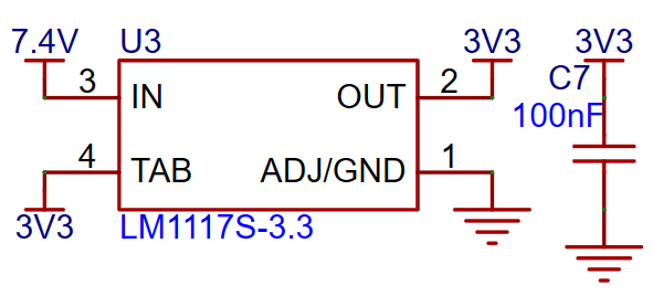

Since all components are powered by 3.3V, and the power supply is two 3.7V 14500 batteries, the 7.4V power supply needs to be stepped down. The LM1117S is selected for step-down, and the power supply and step-down module circuit is as follows.

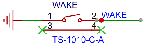

Considering that the chip needs to achieve low-power operation, the RTC needs to be enabled to ensure time accuracy; therefore, an external crystal oscillator is used, and its circuit is as follows
. Simultaneously, a wake-up button is needed to switch the chip from stop mode to run mode.

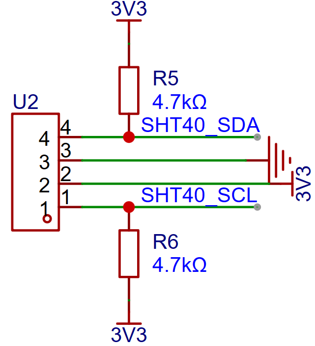

The SHT40 temperature and humidity sensor module circuit uses IIC communication with the MCU, where the SDA and SCL lines need to be connected to pull-up resistors.

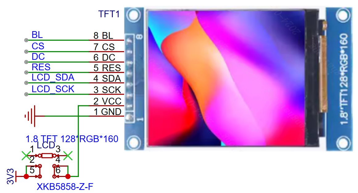

A 1.8-inch TFT screen is used for the LCD, which communicates with the MCU via SPI. The circuit is as
follows: To allow the LCD to turn off in MCU stop mode, I added a latching switch between the power supply and the LCD's VCC pin. However, this was found to be unnecessary, as the screen can be turned on/off by changing the level of the backlight pin (BL). Therefore, the latching switch can be removed. During subsequent debugging, it was found that the LCD screen can still light up without VCC power, but the brightness is dim. Therefore, if the application scenario is at night and the screen brightness is a concern, the latching switch can be retained.

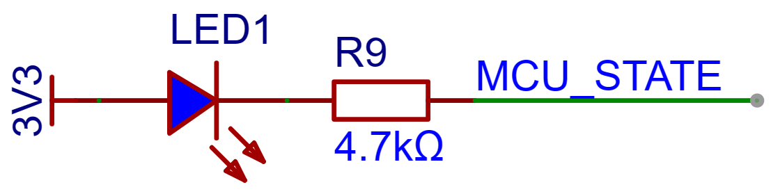

Finally, to test and monitor the MCU's operating status, an LED was added.

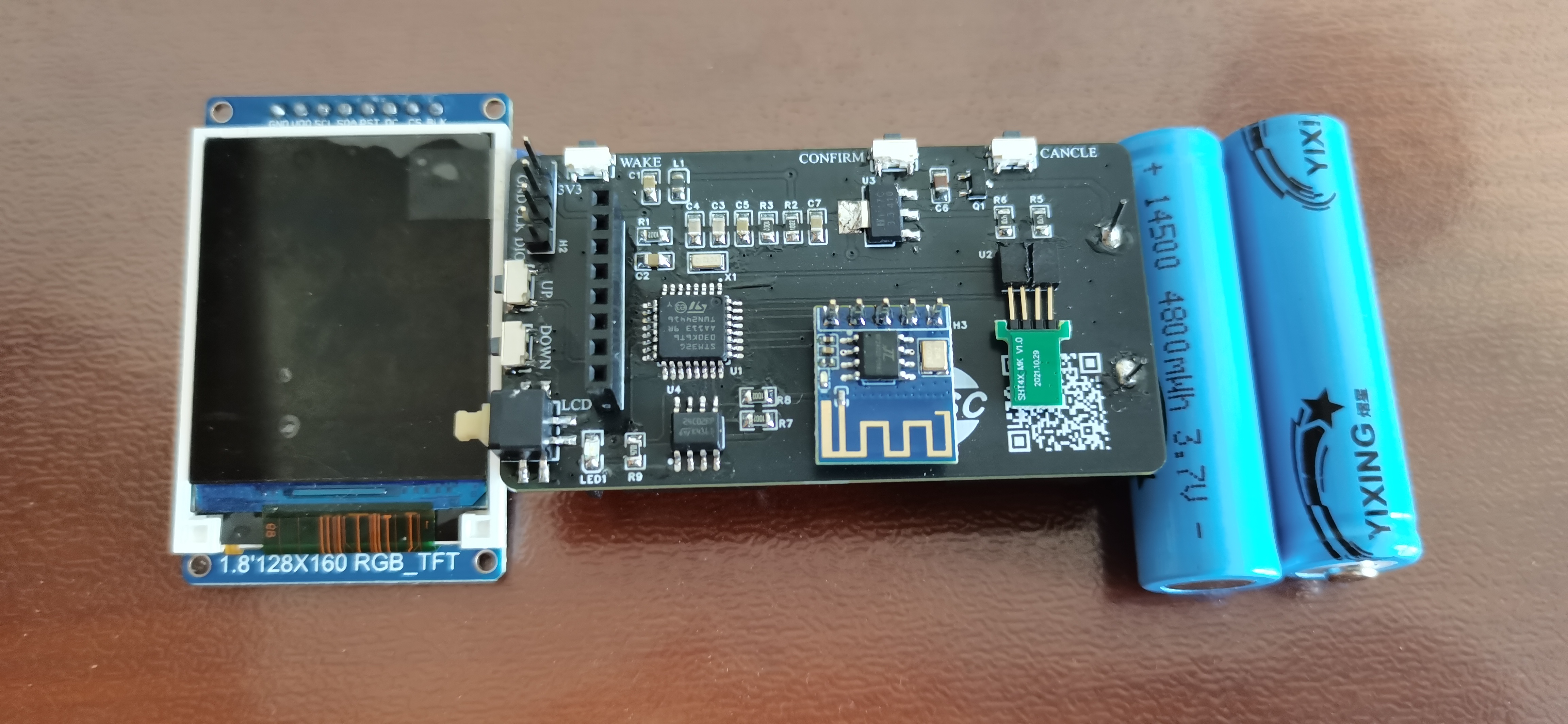

During the PCB design, to reduce electromagnetic interference and the impact of the manufacturing process, the copper plating at the bottom of the crystal oscillator and any sharp-shaped copper areas needed to be removed by setting forbidden areas
. The final circuit board and related components are shown in Figure

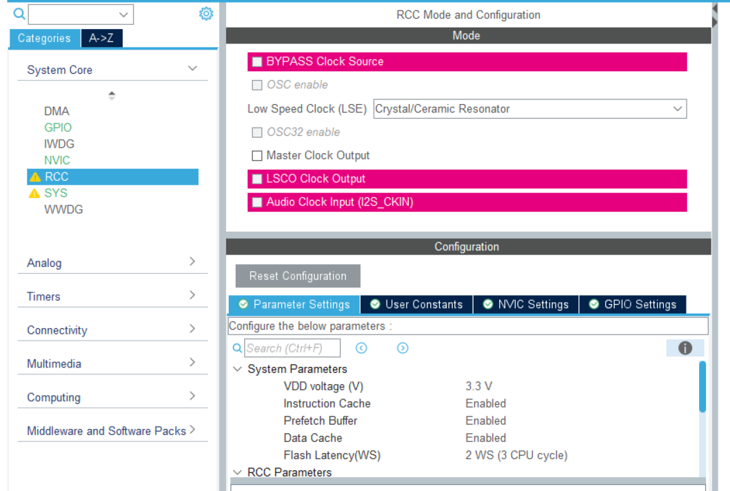

. To ensure the RTC operates normally, the RCC needs to be configured first, and the LSE set to an external crystal oscillator

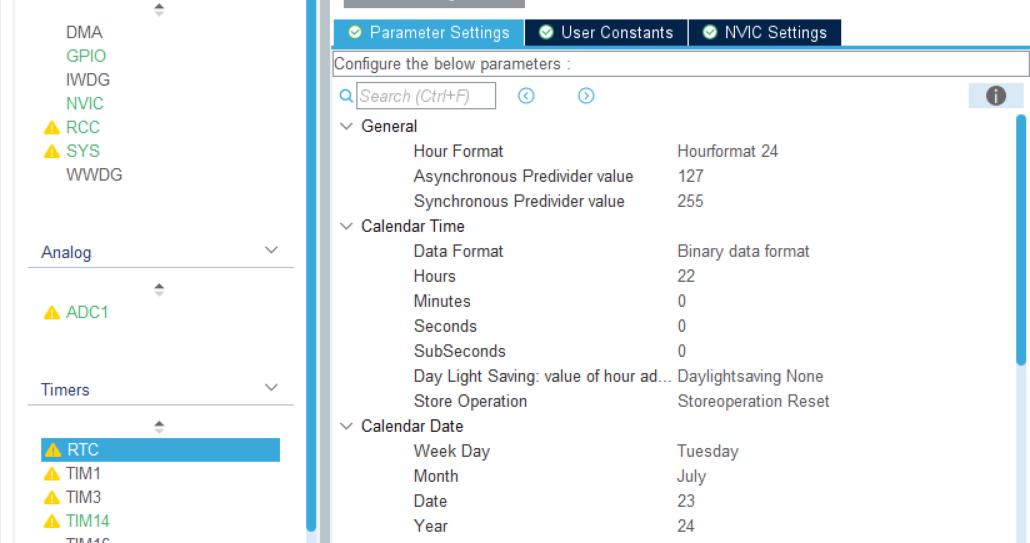

. Next, the RTC needs to be configured, including the time representation method (binary/BCD) and the initial time.

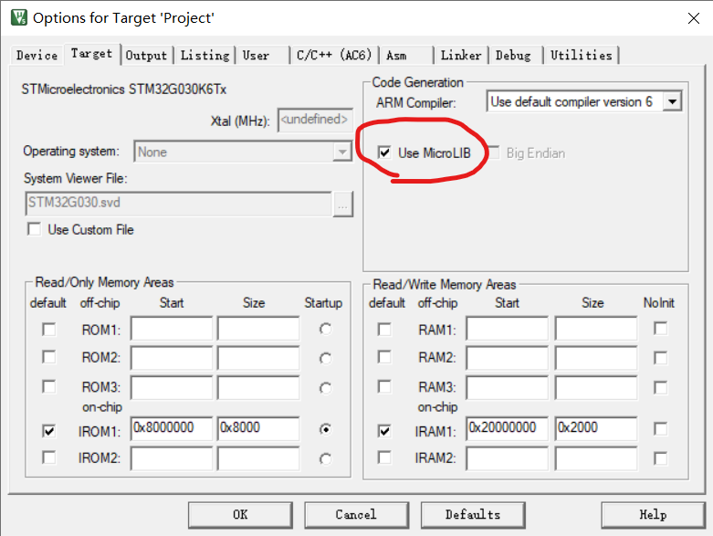

Since Bluetooth is a serial Bluetooth, only the printf function needs to be redefined.
In addition, it is important to note that when using printf, please check "Use MicroLIB" in the magic wand; otherwise, printf will not work.

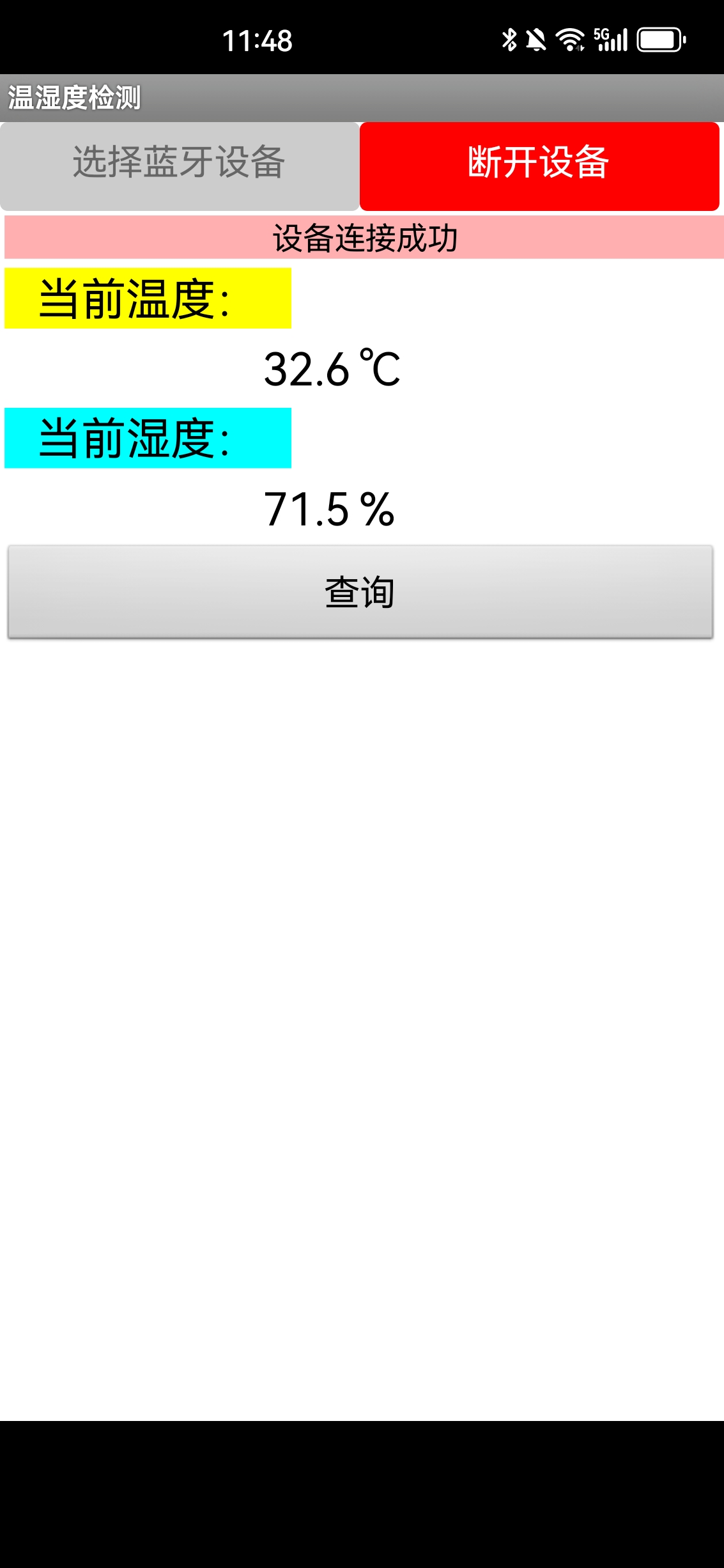

Open the mobile Bluetooth APP
and select the Bluetooth device.
When Bluetooth is successfully connected, the Bluetooth module's connection indicator light will light up, and the data display interface will also show that Bluetooth is connected.
Click the query button to query the current temperature and humidity.
