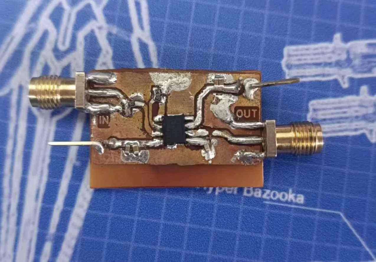

A high-speed amplifier circuit with 10x gain built using AD8099
has been verified. At 100MHz, it can amplify a 100mV peak-to-peak sine wave to approximately 900mV.
Single-sided routing is convenient for manual PCB fabrication.
Note: The SMA interface should be BWSMA-KE-PO01 (searchable on LCSC).
