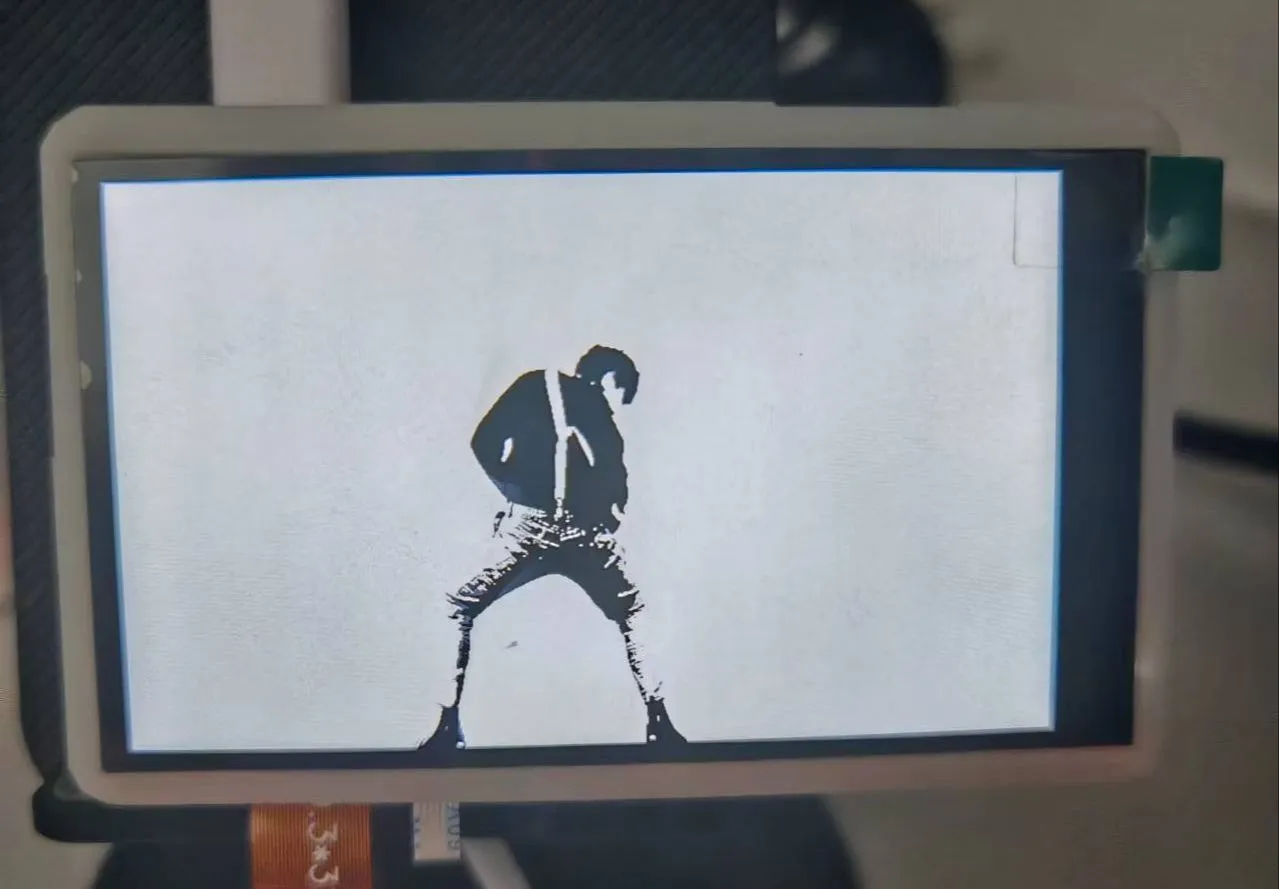

    This project is a small mobile phone project based on the LCSC development board "Taishanpai". The learning content includes: Linux compilation environment setup, SDK compilation, common Linux commands, device tree, screen selection and debugging, screen touch driver, etc.
    The main tasks in this project include designing and soldering a 3.1-inch MIPI screen adapter board, designing and 3D printing the small mobile phone casing. The program currently uses the "default landscape" firmware. After assembly, I will try writing my own program. Based on
    my design of the "3.1 MIPI adapter board" in the training camp, I added "12V PD power supply" and "UART", both of which use Type-C connectors. This increases the distance between the "Taishanpai" and the "adapter board", so the length of the "surface nut post" and "pogo pin" is insufficient and needs to be reselected. At the same time, the casing needs to be redesigned to increase the "thickness" of the phone, and two new "Type-C" interfaces need to be added to the casing.
    Because the length of the pogo pin has a range (before and after spring compression), the length of the surface nut post is determined first, and then the pogo pin is selected. After testing in SW, it was found that the distance between "Taishanpai" and "adapter board" changed from 3mm to 6mm, which is enough to fit the typec socket. Therefore, a 6mm high surface mount nut post was selected on the board, and a 6.5mm high pogo pin was selected on the board (6.5 before compression, 4.5 at the compression limit).

   . This schematic design refers only to the 3.1 MIPI adapter board. Most of the circuitry follows the official tutorial, so the principles will not be explained further; only the general approach will be outlined.
   The wiring sequence of the Taishanpai 3.1 MIPI interface is inconsistent with that of a 3.1-inch screen, so an adapter board is needed to match the wiring sequences.
   Taishanpai itself has a backlight circuit, which is led out through the 3.1 MIPI interface, with a maximum output of 110mA. However, the maximum backlight current that a 3.1-inch MIPI screen can withstand is 25mA. Directly connecting the Taishanpai's backlight circuit to the screen could cause it to overheat or even burn out. Therefore, the 3.1 MIPI adapter board is designed with two backlight paths: one provided by the Taishanpai MIPI connector, and the other by the onboard backlight circuit. These are selected using a 0Ω resistor.
   The 3V3 of the Taishanpai MIPI connector provides power to the onboard backlight circuit, and the PWM signal controls the output voltage of the onboard backlight circuit. TP's I2C is converted to PWM via an I2C-to-PWM chip. Therefore, TP's I2C terminal controls both the touchscreen and the backlight.
   The newly added PD power supply and UART circuit are as follows:
CH224K uses a single resistor configuration; CFG1 is grounded via a 24K resistor, which will induce a 12V voltage.
