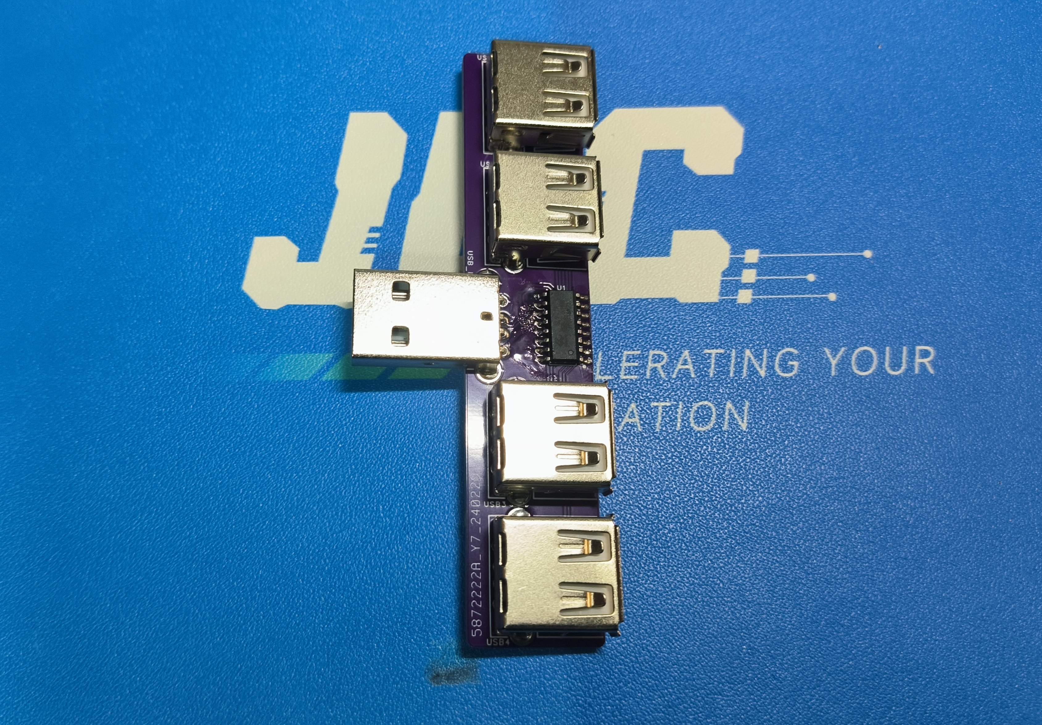

USB 2.0 expansion dock based on SL2.1A
Update Log:
2024.3.7 -- Project Creation
2024.7.6 -- Modification Notes
Preface:
1. Average cost per docking station as low as 2 RMB
2. Maximum speed up to 24MB/s
3. All resistors and capacitors use surface mount 0603 packages (those with poor soldering skills can change to other packages)

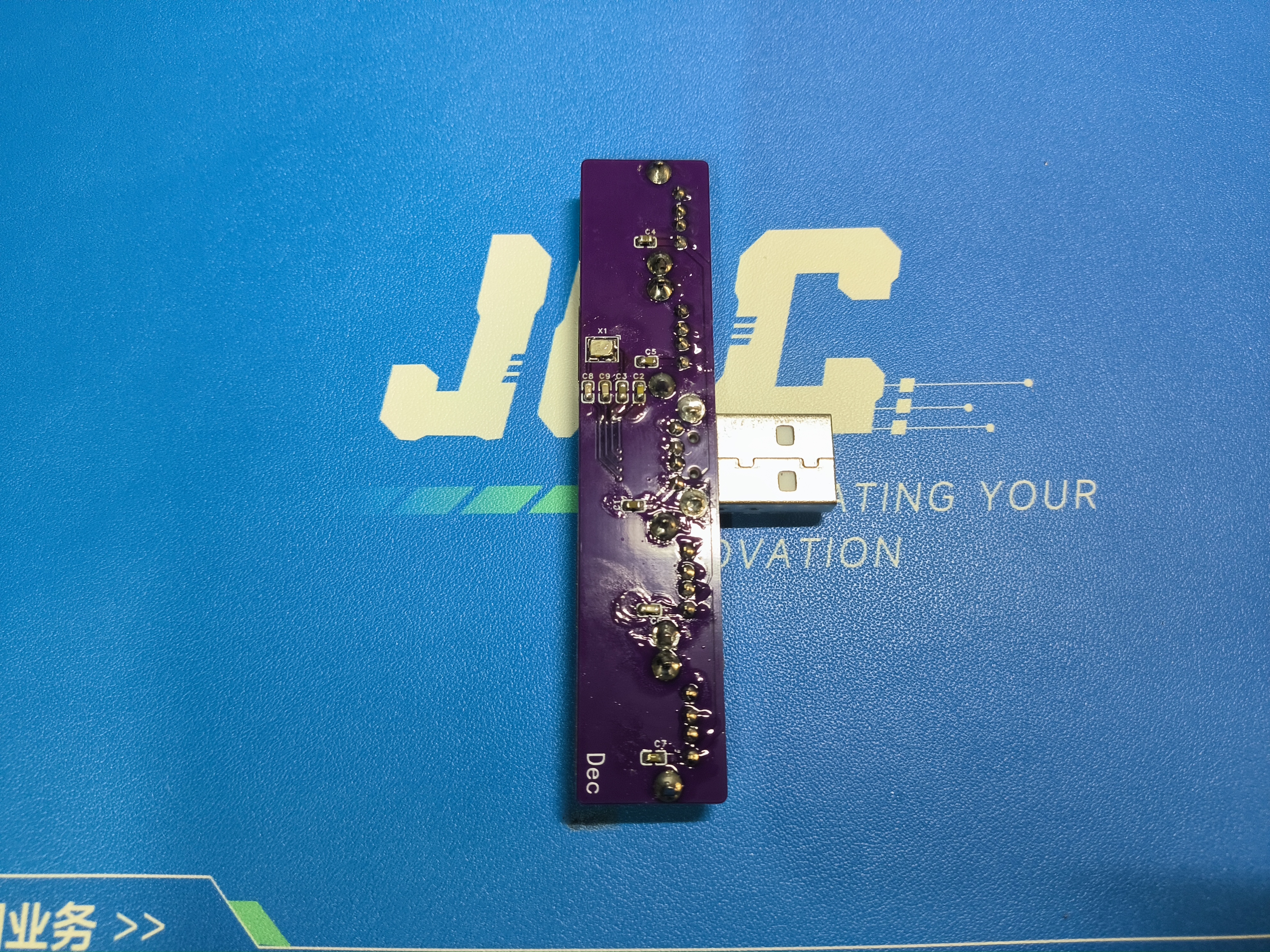

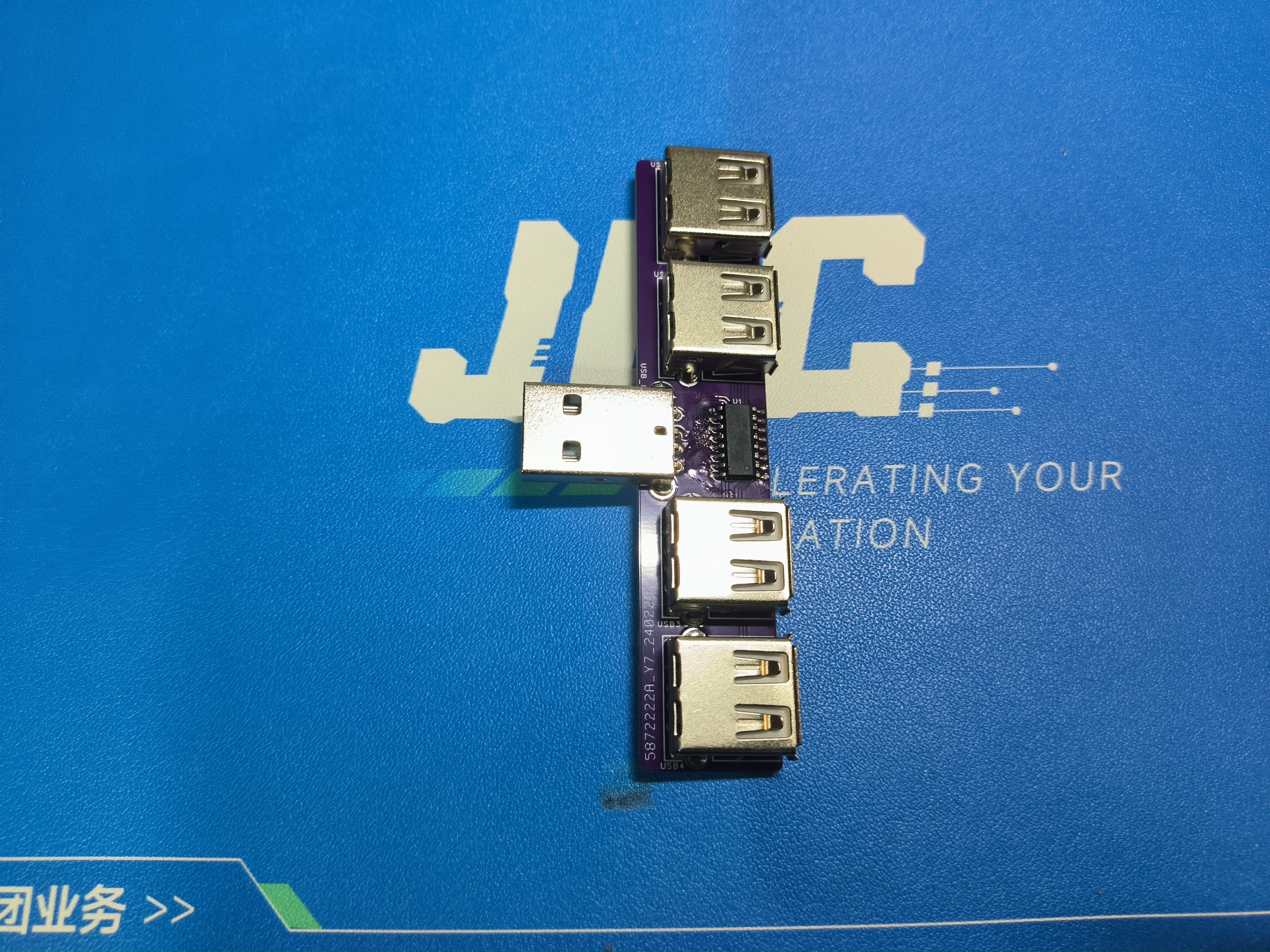

Physical Display
Front:
Back:

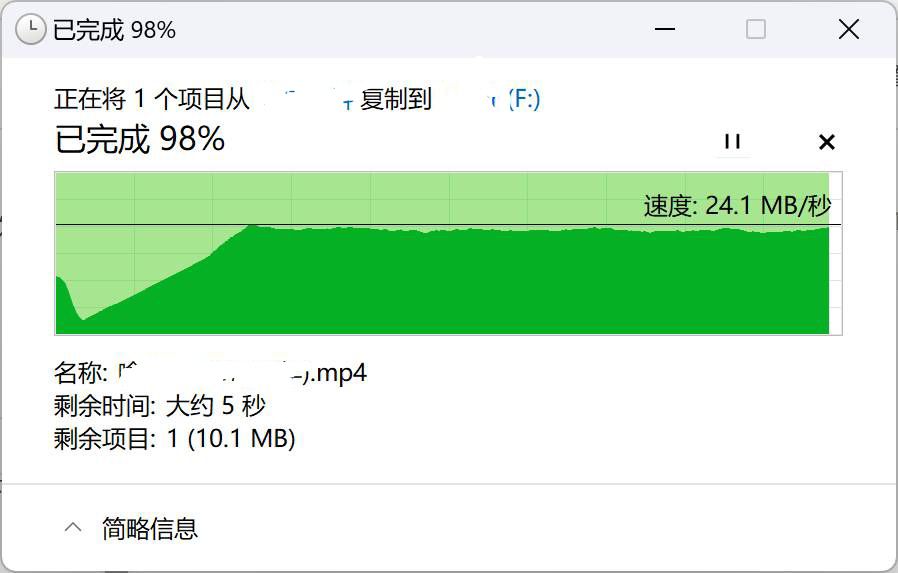

Actual Performance Test:
The test involved connecting a wired mouse and a USB flash drive
. It can be seen that except for a slow initial period, the transfer speed remained around 24MB/s.

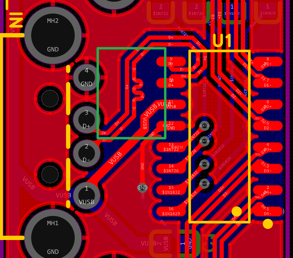

Notes
Here are some basic mistakes I made, hoping everyone can learn from them:
1. The DIN+ and DIN- network labels were reversed when drawing the schematic. The problem was that the computer displayed a warning: "Unrecognized USB device. The previous USB device connected to this computer is not working properly. Windows cannot recognize it."
2. An error in drawing the schematic caused the bypass capacitor between VCC and GND to disconnect the power supply line to VCC, resulting in no power supply to the chip. Those with a multimeter can check this. If you don't have a multimeter, and your mouse has a built-in light, you can check if it's glowing...
3. The D+ and D- data lines are a pair of differential signal lines, which can be drawn using the differential lines provided with LCSC EDA.
If you absolutely cannot draw differential lines in one step, you can first draw differential lines of unequal length, and then use the equal length adjustment function of LCSC EDA.
The green box shows the use of this function.

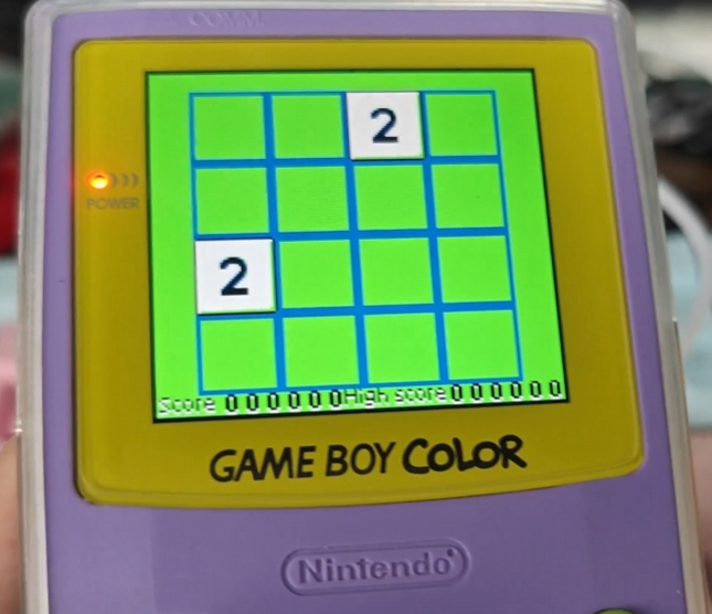

GB game 32KB dual-head flashcart
GB game card 32KB no MBC required, can burn 32KB small games.
GitHub - LovelyA72/GB-Flash-Cart-32K: Easy to build open source 32KB Gameboy Flash cart Flashcart KiCAD Schematic and PCB File
