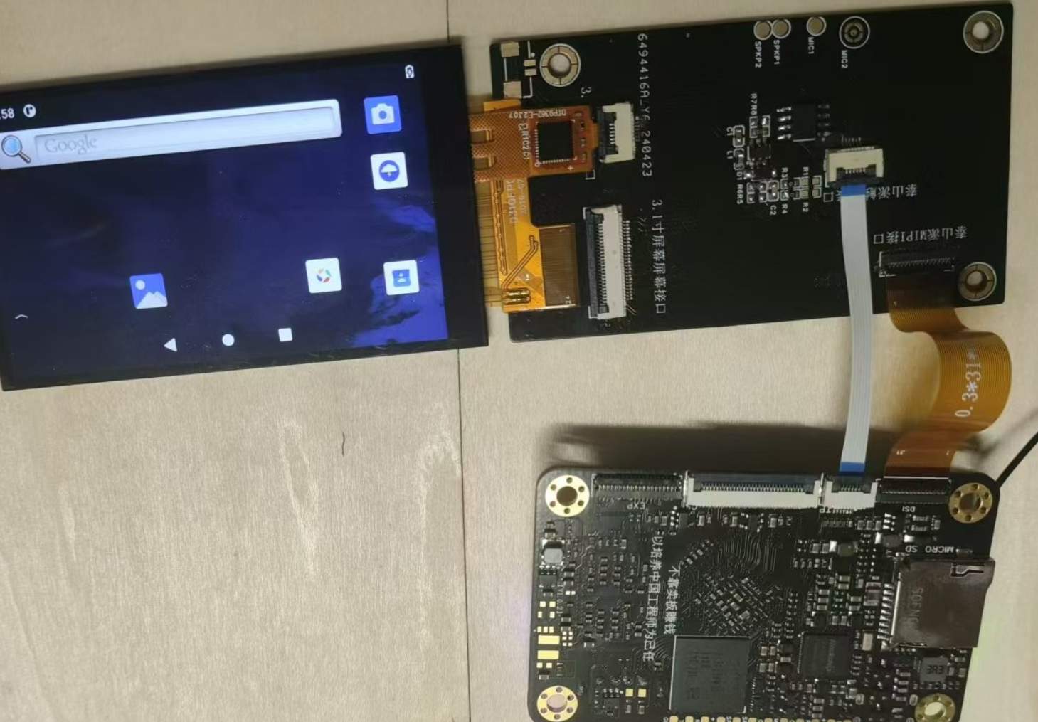

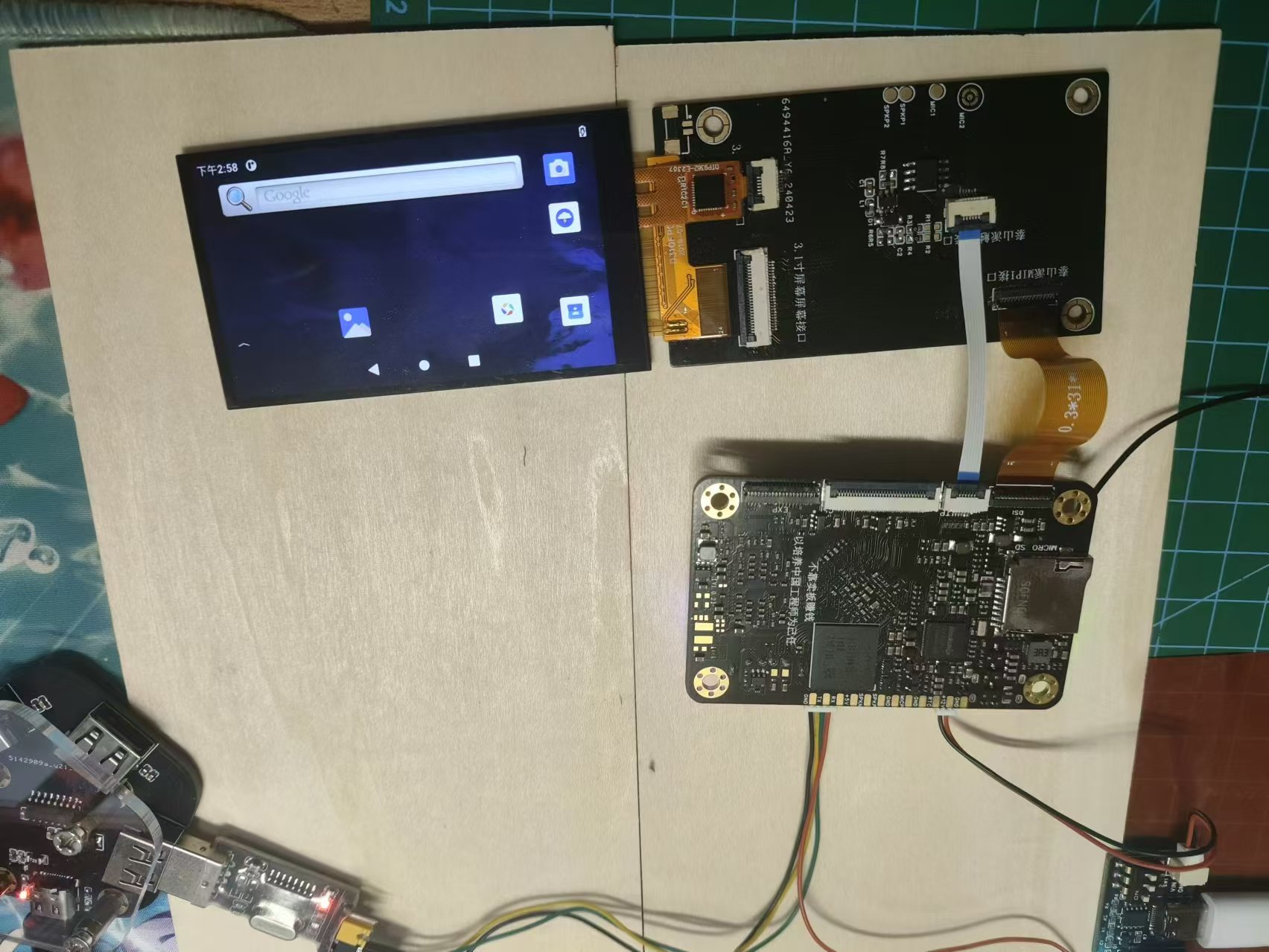

  This lesson will demonstrate how to build a small smartphone using the JLCPCB Taishanpai interface.
  The Taishanpai's MIPI and touchscreen interfaces are connected to the MIPI and touchscreen interfaces on a 3.1-inch screen via an adapter board, with an audio interface also provided.
Figure 1-1 shows the replica result .
  The project uses the PD induction board included with the Taishanpai to provide 9V power to the board. A CH340 module is connected to the UART interface on the Taishanpai to view system operating information.

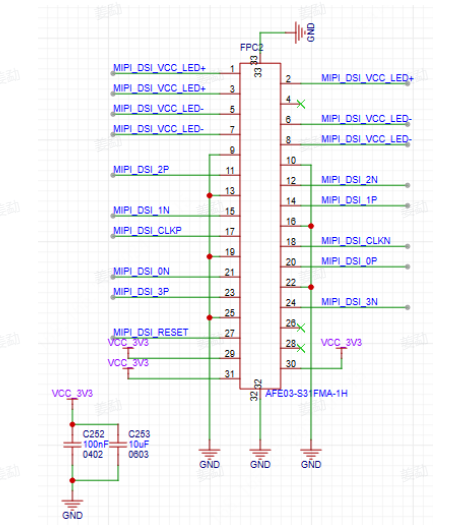

2.1 Power Supply Interface
  The power supply comes from the Taishanpai's MIPI and touchscreen interfaces, and there are two types: MIPI_DSI_VCC_LED+/-, and VCC_3V3 and GND. MIPI_DSI_VCC_LED provides power to the backlight via the MIPI interface, while 3V3 is a universal power supply. We need to power the backlight. The backlight driver circuit on the Taishanpai board has an IOUT value of 0.2V/R, resulting in IOUT = 0.2V/1.8≈110mA. However, this 3.1-inch screen can only support a maximum backlight current of 25mA. Directly connecting it to the screen poses a risk of screen burn-in or overheating. In actual testing, using the Taishanpai backlight power supply resulted in the screen becoming extremely hot. Therefore, we primarily use a 3V3 power supply.
Figure 2-1 shows the Taishanpai MIPI interface,

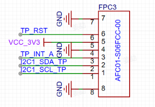

and Figure 2-2 shows the Taishanpai touch interface.

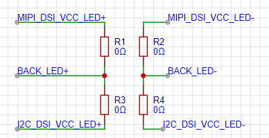

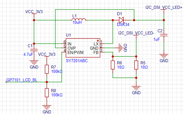

2.2 Backlight Circuit
  The backlight circuit consists of two paths: the first is output from the Taishanpai board (pin name: MIPI_DSI_VCC_LED+/-), and the second is the onboard backlight driver output (pin name: I2C_DSI_VCC_LED+/-). The selection is achieved through four 0-ohm resistors. We default to using the onboard backlight driver power supply, i.e., omitting R1 and R2 and using R3 and R4 (zero-ohm resistors).
Figure 2-3 shows the backlight selection circuit

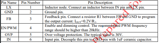

  board. The backlight power supply uses the SY7201 DC-DC boost driver chip, which requires PWM to drive and determine the output voltage. The driver chip's PWM is generated by the GP7101 analog-to-digital converter chip, whose I2C interface is connected to the touchscreen interface's I2C interface, eliminating the need for additional I2C interfaces on the Taishanpai circuit board. The specific principle is as follows:
  L1, D1, and C2 form a BOOST boost circuit, utilizing the inductor's energy storage characteristics for voltage boosting. R5 and R6 are sampling resistors. As seen in the chip datasheet's pin definitions, we can control the chip's output current by adjusting the resistor values. Therefore, a 10-ohm resistor is sufficient to ensure a 20mA output current. We can either place one of these resistors or two 20-ohm resistors in parallel. Drawing multiple resistors in parallel provides redundancy for actual component soldering. Meanwhile, the input pins are designed with pull-up/pull-down resistors. Only one resistor needs to be soldered to pull the pin up or down; in this case, a pull-down resistor is used.
Figure 2-4 Backlight Driver
Circuit;
Figure 2-3 Backlight Adjustment Circuit; Figure 2-5 SY7201ABC Chip Manual Pin Definitions.

  The touchscreen uses the I2C interface, as well as touch reset and touch interrupt trigger pins; these can also be found in sections 1.1.3 and 1.1.4 of the open-source documentation.
