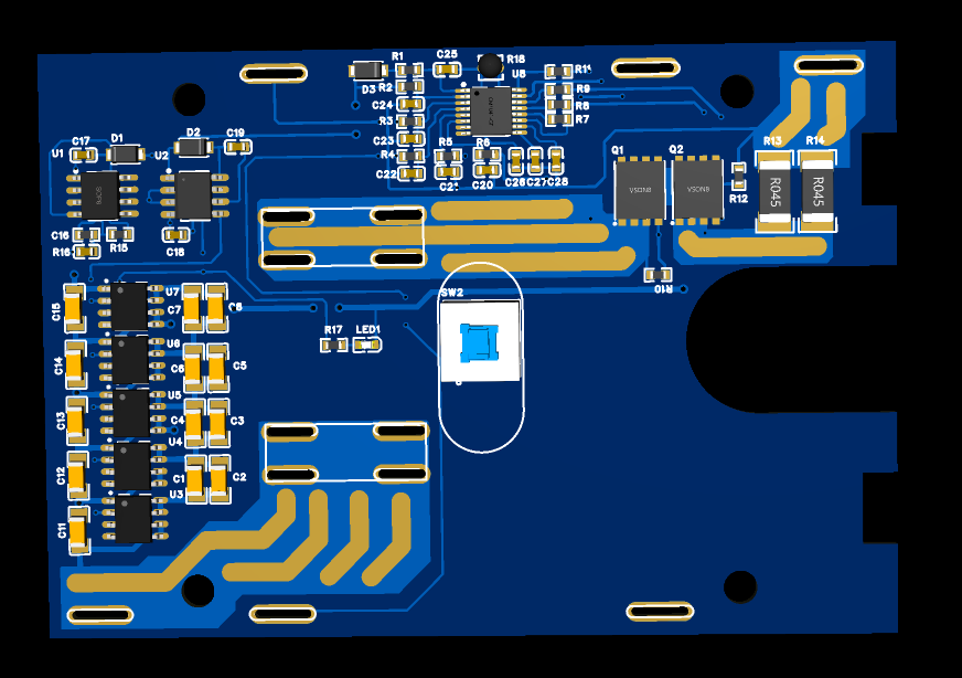

An open-source protection board with active equalization that directly replaces the original battery pack protection board is provided. It is based on capacitor energy transfer.
The main working principle is shown in the diagram: the drive circuit controls the switch to repeatedly switch on and off, allowing capacitors to be repeatedly connected in parallel to adjacent batteries, achieving energy transfer.

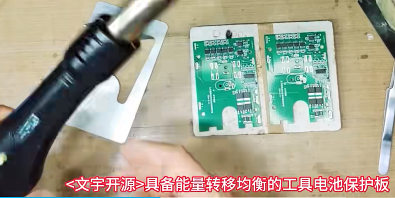

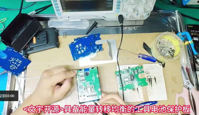

For cost control reasons, voltage detection for individual batteries is not performed here. The entire equalization section is constantly working. If the battery is stored and not used for a long time, it may be completely depleted. Unlike the Makita version, the Dayi battery casing does not have a groove. Therefore, I used the original DC port to install a self-locking switch. When not in use for a long time, pressing the switch will allow you to see the indicator light's status through the original slot. If the indicator light is off, the power is completely cut off. This avoids the problem of over-discharge during long-term storage. Soldering is completed using a hot air gun
with solder paste printed on a paper template
For the parts list, please refer to LCSC Engineering. This is my first time using LCSC EDA to complete a PCB. You can modify it according to your needs. For
