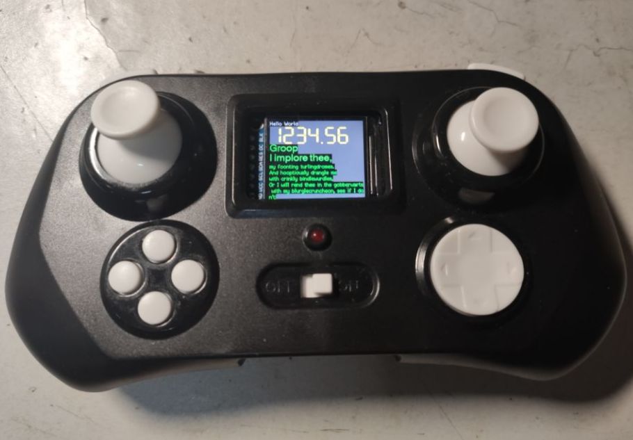

The handle made of ESP32 has four buttons on the left and right sides, and two buttons on the front side of the handle with two joysticks.
Optional lithium battery or AA battery power supply.
Optional 1.3-inch, 240*240 resolution, ST7789 driven display module (7-pin SPI communication).
The IIC interface is reserved for plugging in the 8-pin MPU6050 module purchased on TB.
Integrated CH340 automatic download circuit and lithium battery charge and discharge management circuit.
The shells can be purchased at a fish shop for 8 yuan each (the seller does not include free shipping).
