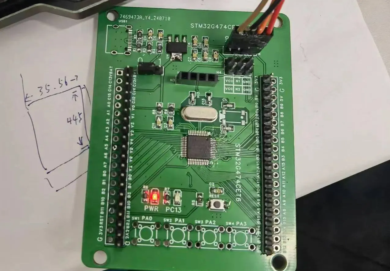

STM32G474CET6 core board
The STM32G474 core board (STM32G474CET6) has been verified and is usable. The diagram isn't perfect, but it's functional. The display screen's VCC and GND pins are connected via jumpers.
When H1 and VCC are shorted, the first pin of the display screen is VCC;
when H2 and GND are shorted, the second pin of the display screen is GND.
