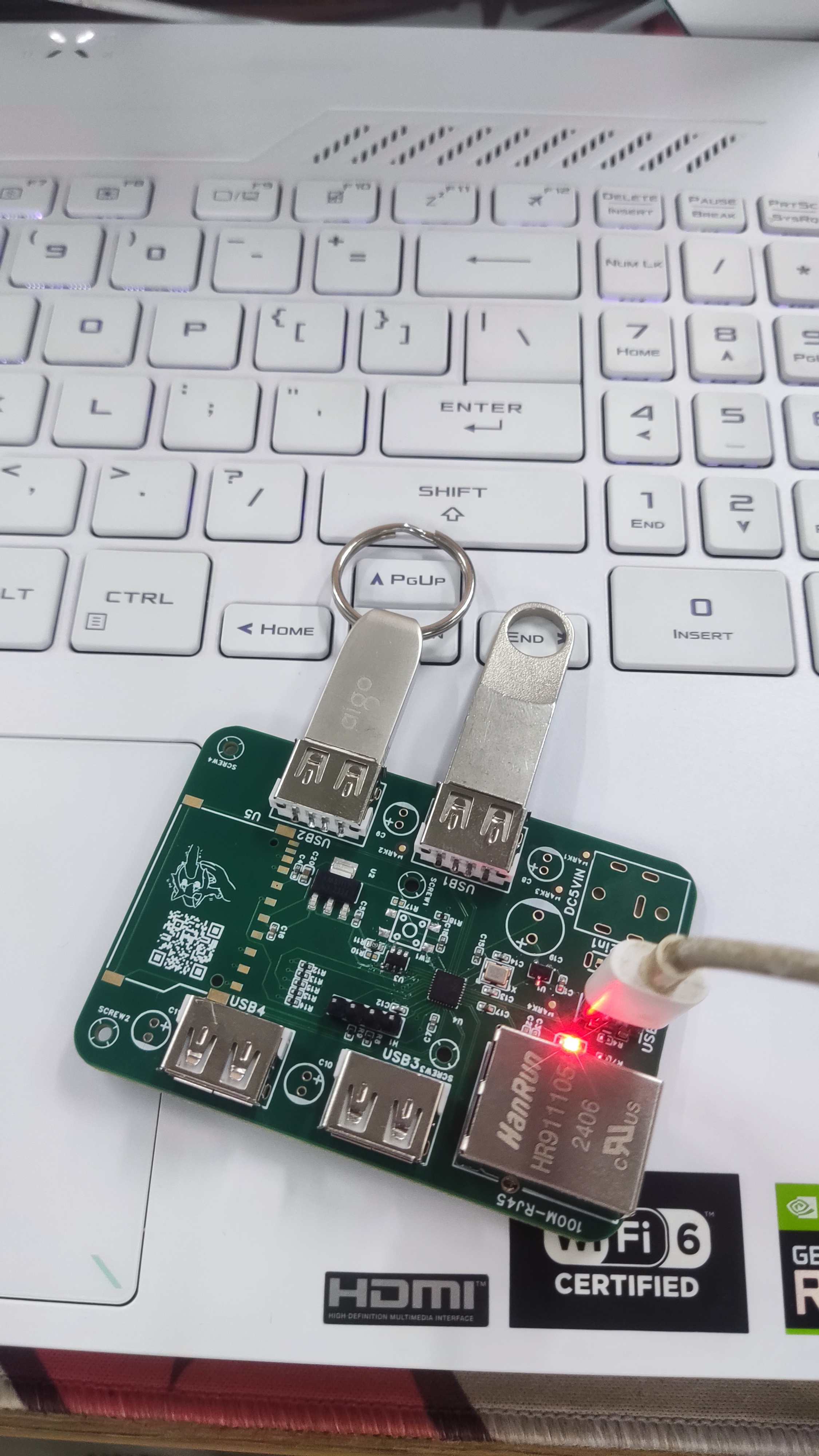

USB 2.0 multi-functional expansion dock based on CH339F

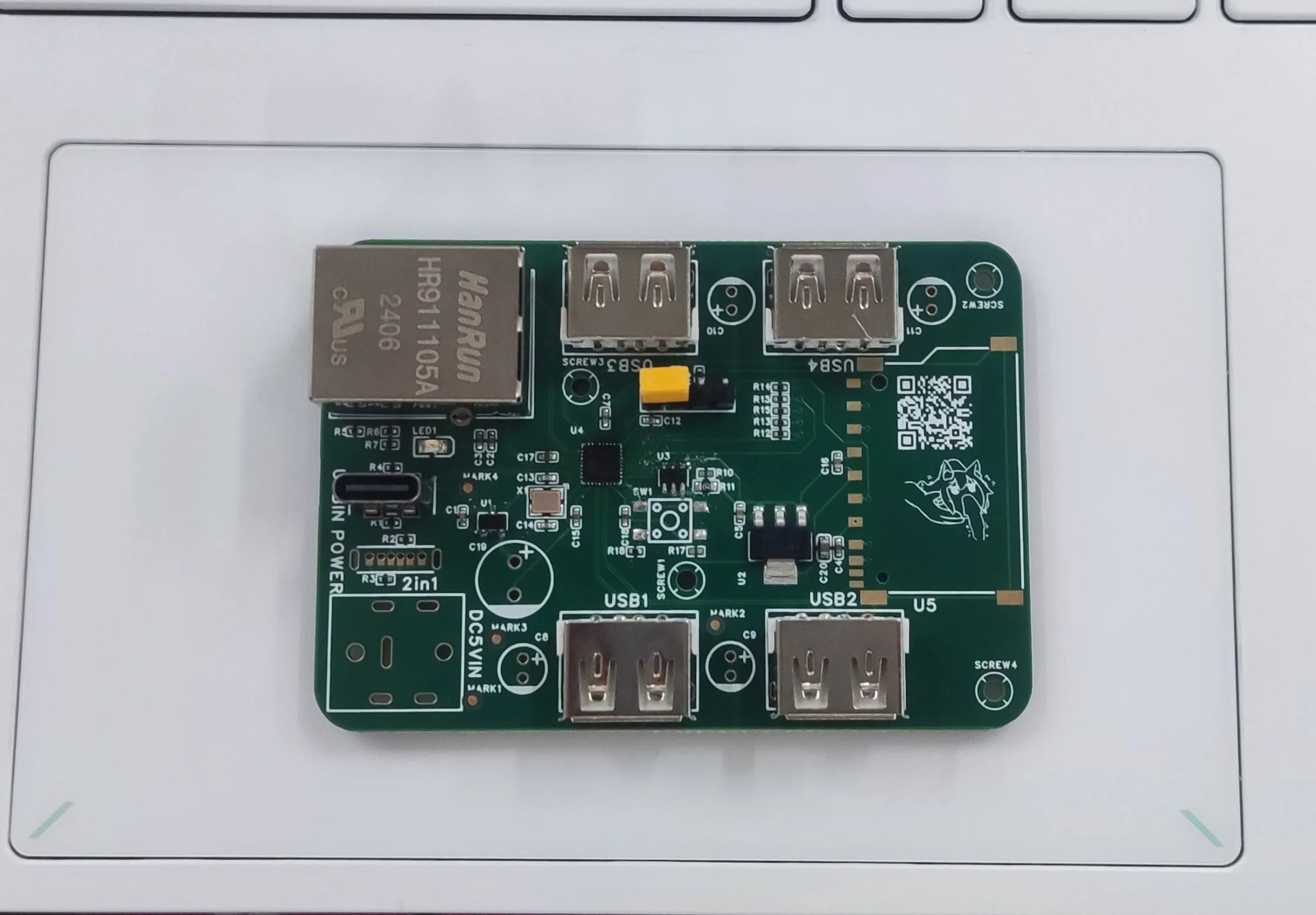

Cost: JLCPCB surface mount resistors and capacitors *5 20, USB female connectors (20+20+80) 17, RJ45 100Mbps connectors 1.2 each, CH213K 0.25*20, CH217K 0.38*20, CH339F 9.5*5 (excluding shipping); totaling approximately 16 per board.

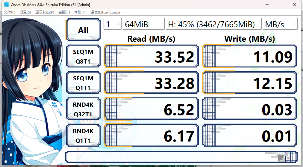

USB 2.0 flash drives test normal.

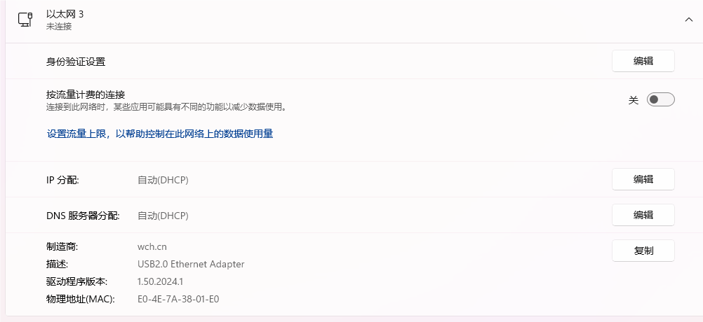

100Mbps Ethernet port recognition normal.

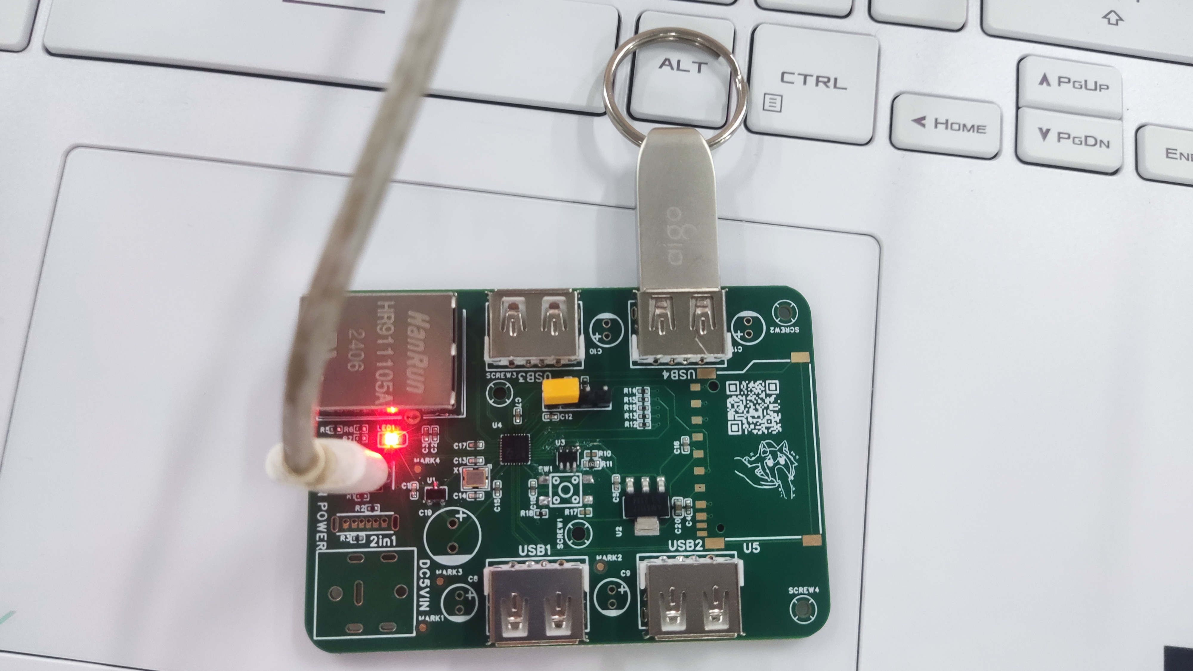

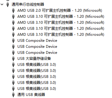

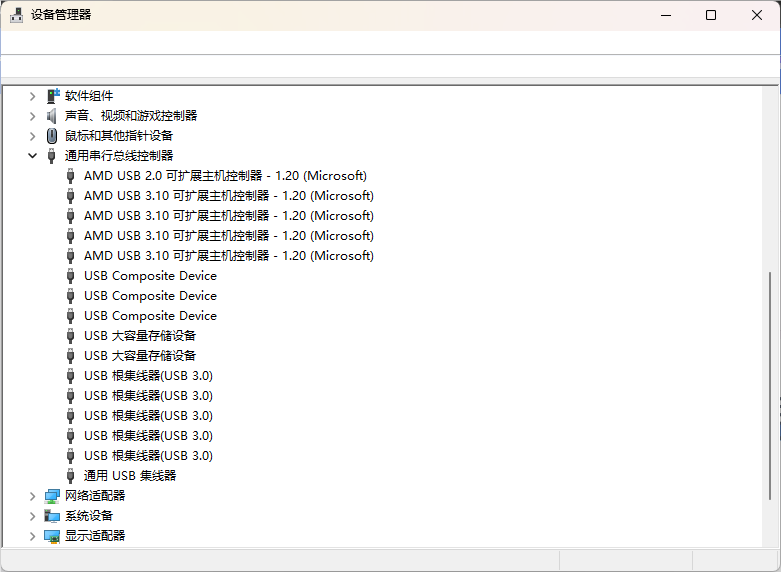

The current problem seems to be that it cannot expand to 4 USB 2.0 ports! (Cause found).
According to the jumper settings in the datasheet, only one flash drive is recognized. The USB isolation extension mode is selected. The default mode cannot recognize USB devices. I don't know if it's due to insufficient power supply or some other reason; the keyboard and mouse are not recognized either. It may be because when the USB device is hot-plugged on the downstream port, the dynamic load may cause the VBUS and 5V voltages to drop momentarily, which may cause LVR low voltage reset, resulting in the entire HUB disconnecting and reconnecting. I'll see how things go after soldering the electrolytic capacitor and SD card slot on.

It's currently renamed to a USB 2.0 isolation module with network port (dogo)
. It's recognized once it's plugged in. The
issue was a sudden drop in power supply voltage, causing the chip to reset upon insertion and preventing recognition. Adding the capacitor later fixed it.
