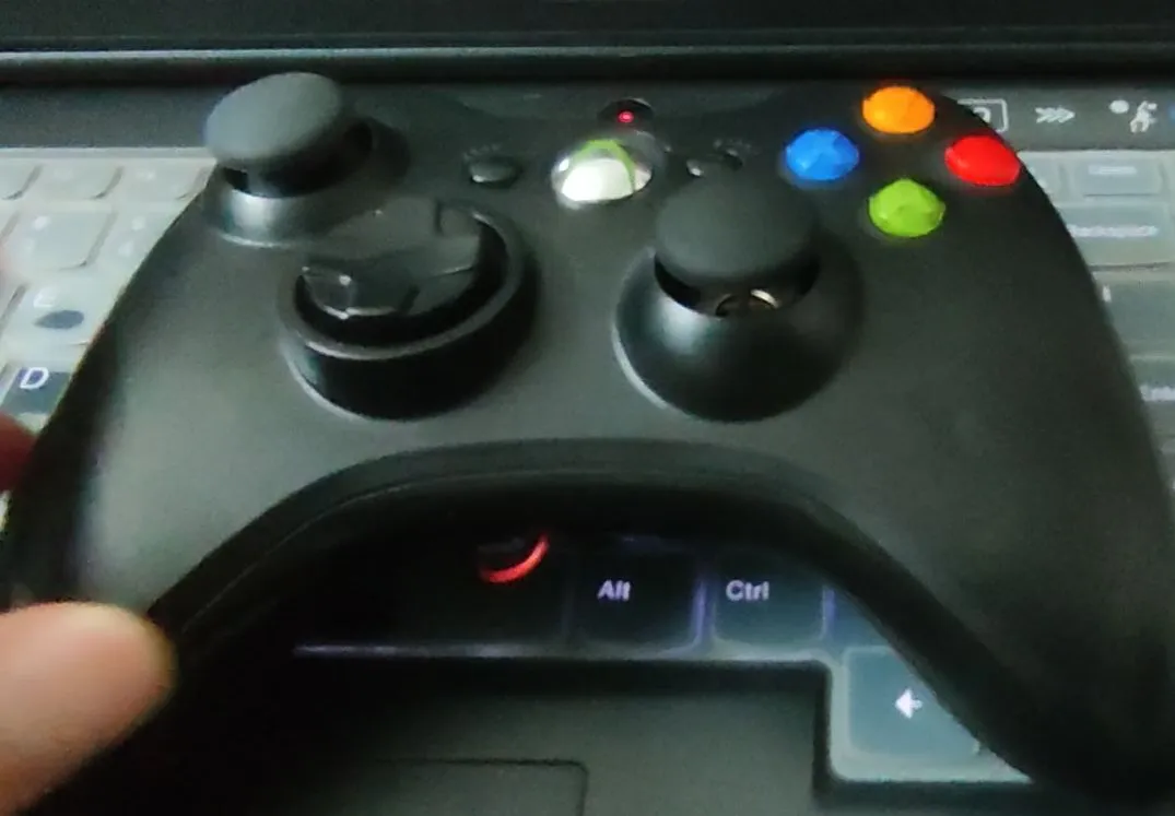

DIY Xbox Switch Pro DualSense Bluetooth Controller
Features: This device
can emulate Xbox Bluetooth controllers, Switch Pro Bluetooth controllers, and DualSense Bluetooth controllers;
all controllers support vibration;
the Switch Pro and DualSense controllers support gyroscope motion control;
except for the Switch Pro controller which lacks linear triggers, the other two have linear triggers;
it supports binding to multiple consoles, with three modes that can be bound to the same console simultaneously, allowing for seamless switching without rebinding;
it allows manual setting of joystick offset and dead zone, and automatic gyroscope calibration;
the normal refresh rate is around 60Hz, with a high-performance mode that can reach 120Hz;
it supports the Windows 10 platform: emulators like Yuzu Cemu Dolphin and Steam can recognize it correctly;
it also supports the Android platform: the DraStic emulator on my Xiaomi 10s can also recognize it correctly;
the chip module is: ESP32-S3-WROOM-1-N8R2;
charging management chip: TP4056 ;
voltage regulator chip: AP2112K-3.3TR
; gyroscope: MPU6050.
Open source address:
https://github.com/qingwa2009/MyBLEGamepad.git
https://gitee.com/qingwa2009/MyBLEGamepad.git
The case was purchased online for around 20 RMB.
