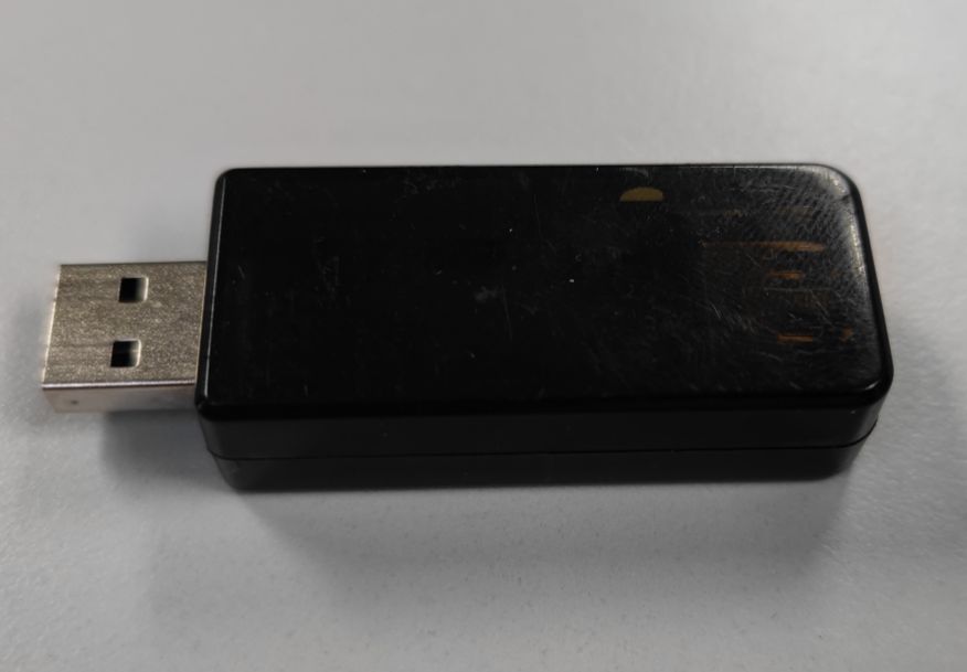

It has been produced and verified
to only support USB2.0 Full Speed ​​and not Low Speed.
The power supply is 0505 module 1W
shell. Use Ruideng's USB ammeter.
If Low Speed ​​is required, just pull down SPU and SPD.
