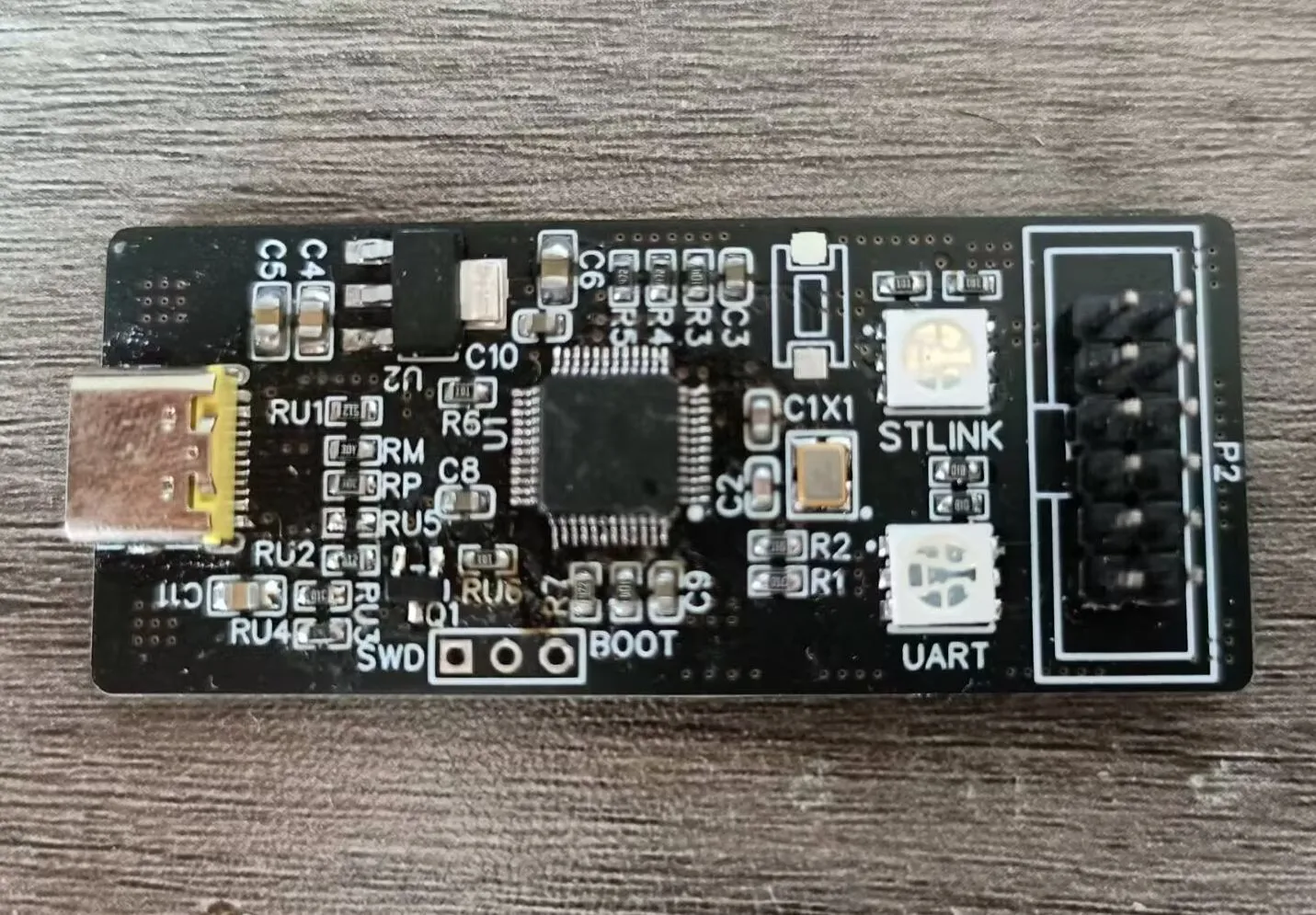

A universal solution for ST-Link v2, v2.1, and DAPLink
has been successfully fabricated and verified.
Design based on ST -Link v2 schematics
uses the STM32F103C8T6
. ST-Link v2.1 and DAPLink use the
STM32F103CBT6. DAPLink can also use the APM32F103CBT6 (tested).
