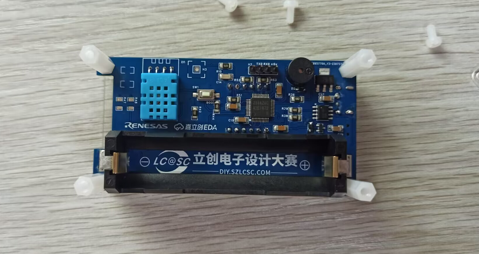

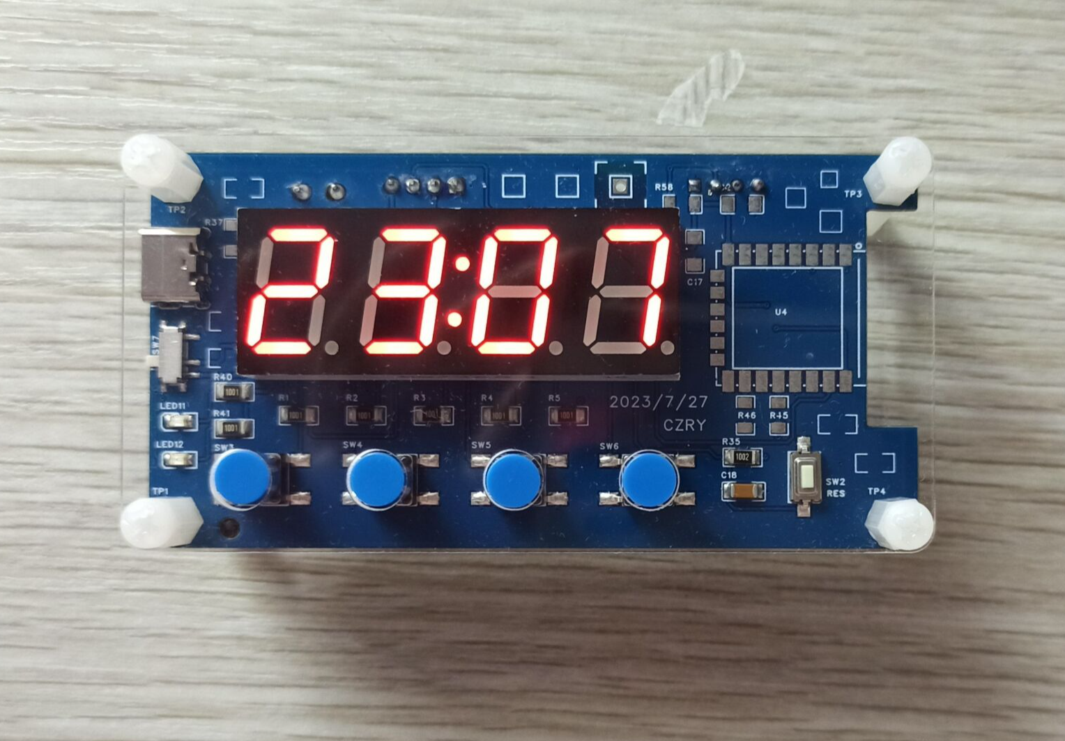

#8th LCSC Electronics Design Contest# Electronic Clock
Project Function Introduction:
1. Uses R7FA2E1A72DFL as the main clock control chip
. 2. Uses a four-digit 0.56mm common cathode LED display to show the time.
3. Collects ambient temperature using a DHT11 temperature and humidity sensor
. 4. Uses four independent buttons for clock setting, temperature and humidity display, and buzzer on/off.
5. Includes a reset button and serial port download circuit for easy downloading and debugging.
6. Uses a passive buzzer for button prompts.
7. Uses an AO3401Ap channel MOSFET and a 1N5819 diode to form a power switching circuit.
8. Uses a TP4056 to charge the battery.
Open source protocol
GPL 3.0.
Hardware:
JLCPCB EDA.
Software:
e2studio
competition logo verification
video demonstration
: https://b23.tv/IpbeC13
