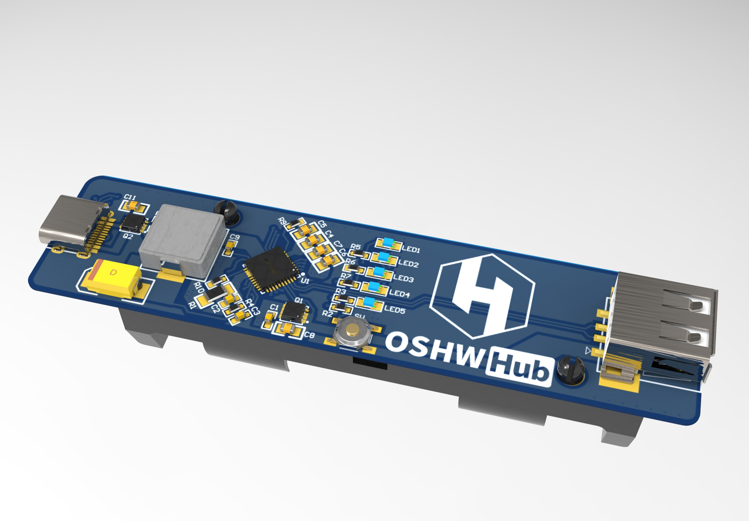

Mini power bank 18650
  • This solution uses Yingjixin IP5328P as the main control design of a Mini mobile power supply.
  • Supports QC2.0, QC3.0, PD2.0, PD3.0 and other fast charging protocols, with a maximum output power of 18W.
  • There are 5 power indicator lights on board, one of which is a fast charge indicator light.
  • The battery core uses a single 18650 lithium battery. It is recommended to use a power 18650 lithium battery. When the power output is 18W, there are certain requirements for the battery's continuous discharge capability.
  • When necessary, this mini mobile power supply can be used to charge 18650 lithium batteries. The maximum charging power is 18W and the charging current does not exceed 5A.
  • The 18650 battery holder uses a patch. I have considered a direct-plug battery holder before, but the direct-plug battery holder has structural interference with USB-A and type-C, so I did not use it.
  • Note: There is currently no proofing test, so we don’t know if it can work properly.
