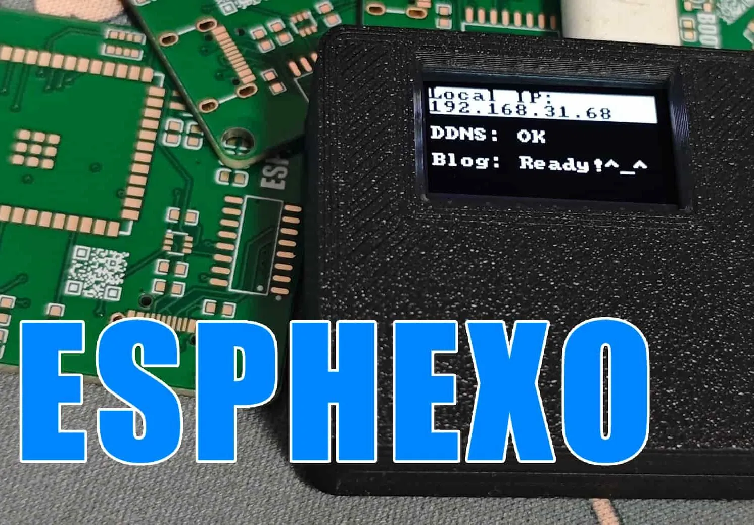

ESPHexo -- Run Hexo blogs on your ESP32
This project allows you to run a Hexo blog on your ESP32 device. It's low-power, portable, supports DDNS, and automatically fetches and updates blog files. The corresponding
software project is: https://github.com/isNineSun/ESPHexo.
Features :
Low power consumption, using ESP32 as the platform, its power consumption is far lower than x86 and most Linux platforms.
Simple deployment; only a limited number of Wi-Fi and username information needs to be filled in the configuration file.
Beautiful and intuitive web configuration interface, allowing direct modification of device configuration without frequent manual modification of configuration files on the SD card.
Supports public DDNS, enabling remote access to your blog website.
Information monitoring screen, providing a clear view of the blog's running status.
