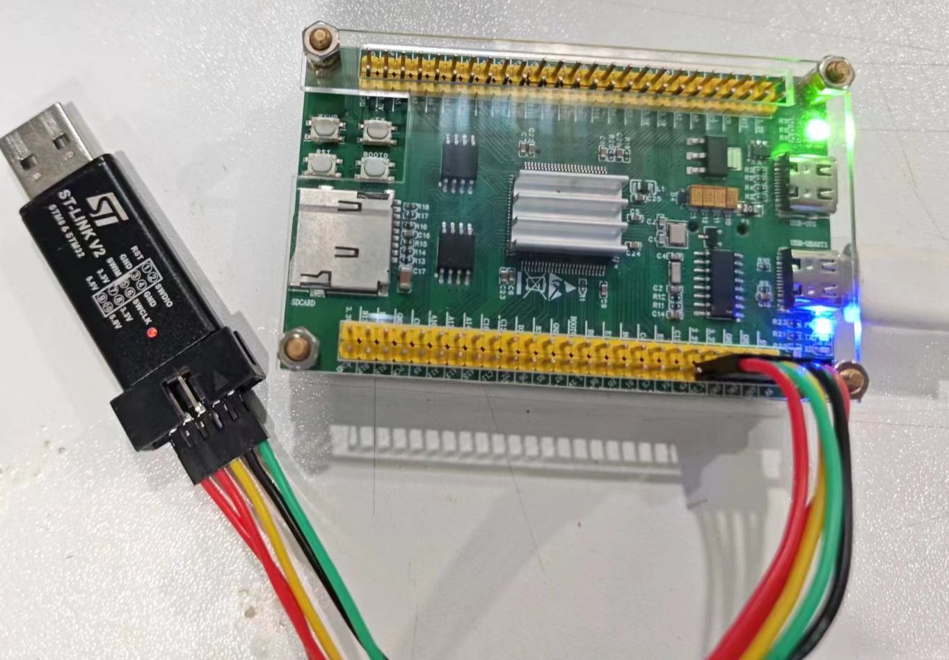

This development board is a reconstruction of misee's STM32H750VB/H7B0VB core board, mainly changing the screen interface to a 16-bit parallel port. The screen
adapter board is not yet finished.
PS: This board is for learning LVGL. I only have a 16-bit parallel port screen and don't want to connect an external module, so I directly drew a development board
project. Project link: stm32h750vbt6: ZERO STM32H750 development board project including boot, app, and download algorithm (gitee.com).

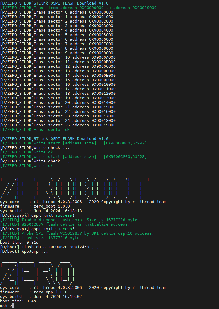

System startup demonstration (serial port 1 output information):
I will add LVGL and more functions to the project later, so stay tuned.
