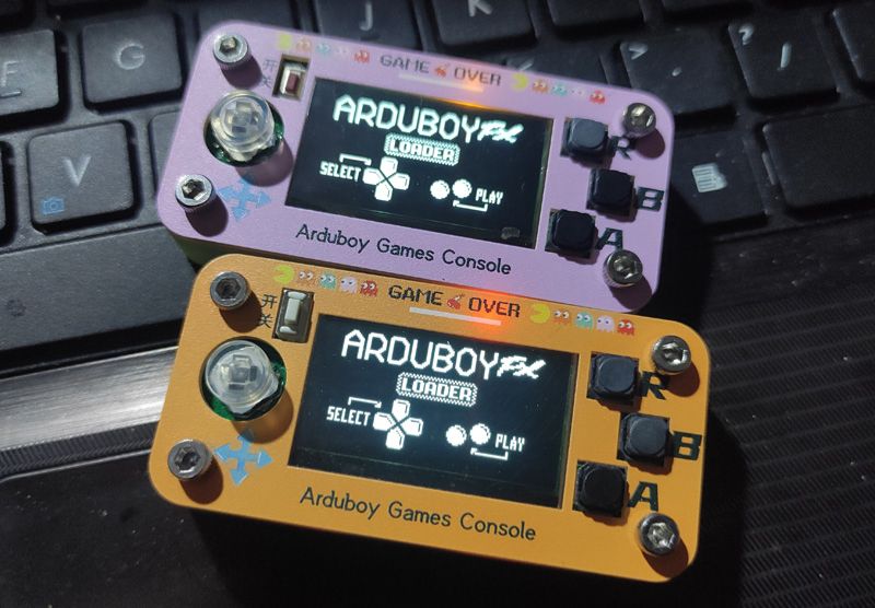

The first Arduboy copy in 2024
This is a clone of the project https://oshwhub.com/15653072438poiu/arduboy-fish-artifact.
The main modification is the power-on/off chip, which is easier to find on Taobao. The chip has been modified to be compatible with both 32U4-AU and MU. Use whichever you prefer!
Only the bottom shell needs to be printed; the top shell uses LCSC panel printing.
For instructions on how to use it, please refer to the original author's project; it's very comprehensive!

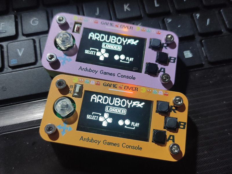

I've already made two. One uses an SSD1306 screen, and you can play it by uploading the original author's game collection—very convenient!
The other one uses a cheaper SH1106 screen, so the game collection doesn't work. You need to download the Arduboy game source code online and compile it yourself. When compiling, select the SH1106 screen to play it normally! This one is a bit more complicated to use, as you need to create your own game collection. I've already compiled over ten games! The attached file is my small collection.
PS: I discovered that Arduboy also supports the SSD1309 screen, and this screen has a large 2.4-inch display. I've decided to design a larger version of Arduboy after the Chinese New Year!
