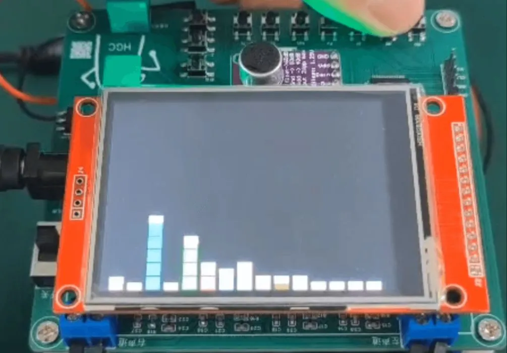

[Mini Project] STM32 Electronic Keyboard and Bluetooth Music Player
This work is a modified version of an open-source project by a master programmer, and some issues remain, as mentioned in the attached "Introduction." However, it is sufficient for a microcontroller course project or learning project. The original

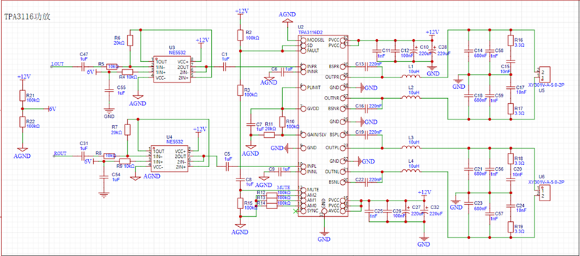

begins with the TPA3116 power amplifier circuit, the core component, which connects to the speakers for sound output.
The power supply section

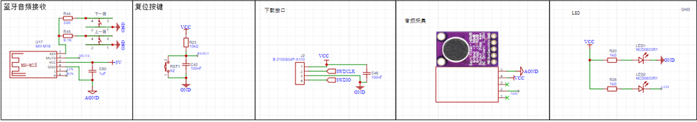

contains some miscellaneous components; these are mainly for connecting to the 32-bit chip.

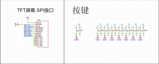

The Bluetooth module, audio acquisition module, and TFT screen can be purchased from Taobao. The Bluetooth module has a built-in song switching function; simply connect it according to the resistor values. The audio module outputs analog signals, which need to be converted using the ADC pin of the 32-bit chip. The TFT uses hardware SPI, so find the correct SPI pin on the 32-bit chip (configure directly using CubeMX).

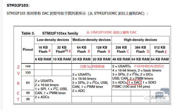

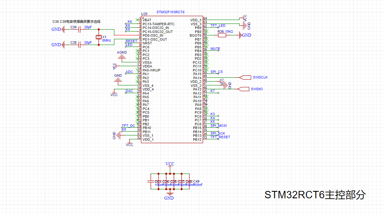

Next is the 32RCT6. The reason for choosing this chip is its fewer pins for easier soldering, and because a DAC function is required. The RCT6 chip was selected based on the table below.
Remember the components you learned before? Connect them to the pins (the pin positions are your choice; details will be explained in the CubeMX configuration
