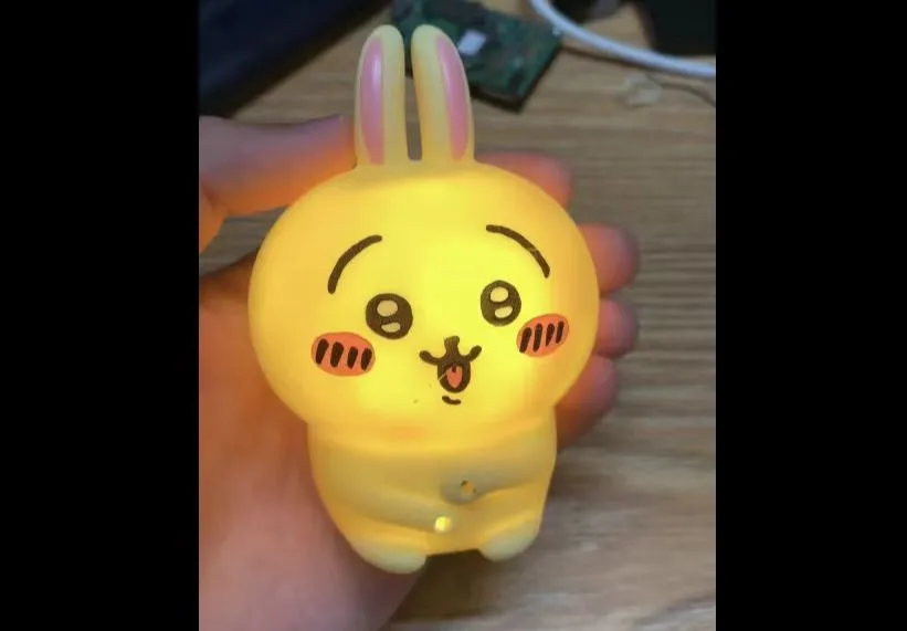

The first-generation version is essentially an expansion board for the HLK_V20. The finished product size can be directly fitted into the same Usachi model, and it includes lights, a vibration motor, and lithium battery charging/discharging circuitry. Important reminder: When making this, if you only have a GD3800 chip on hand and are in a rush, make sure you can purchase this chip before replicating it.
The board has a reserved slot for an STC8/15 microcontroller, allowing for further functionalities by configuring the HLK_V20 and STC microcontroller.
Connect jumpers as needed, or use 0-ohm resistors for connection.
