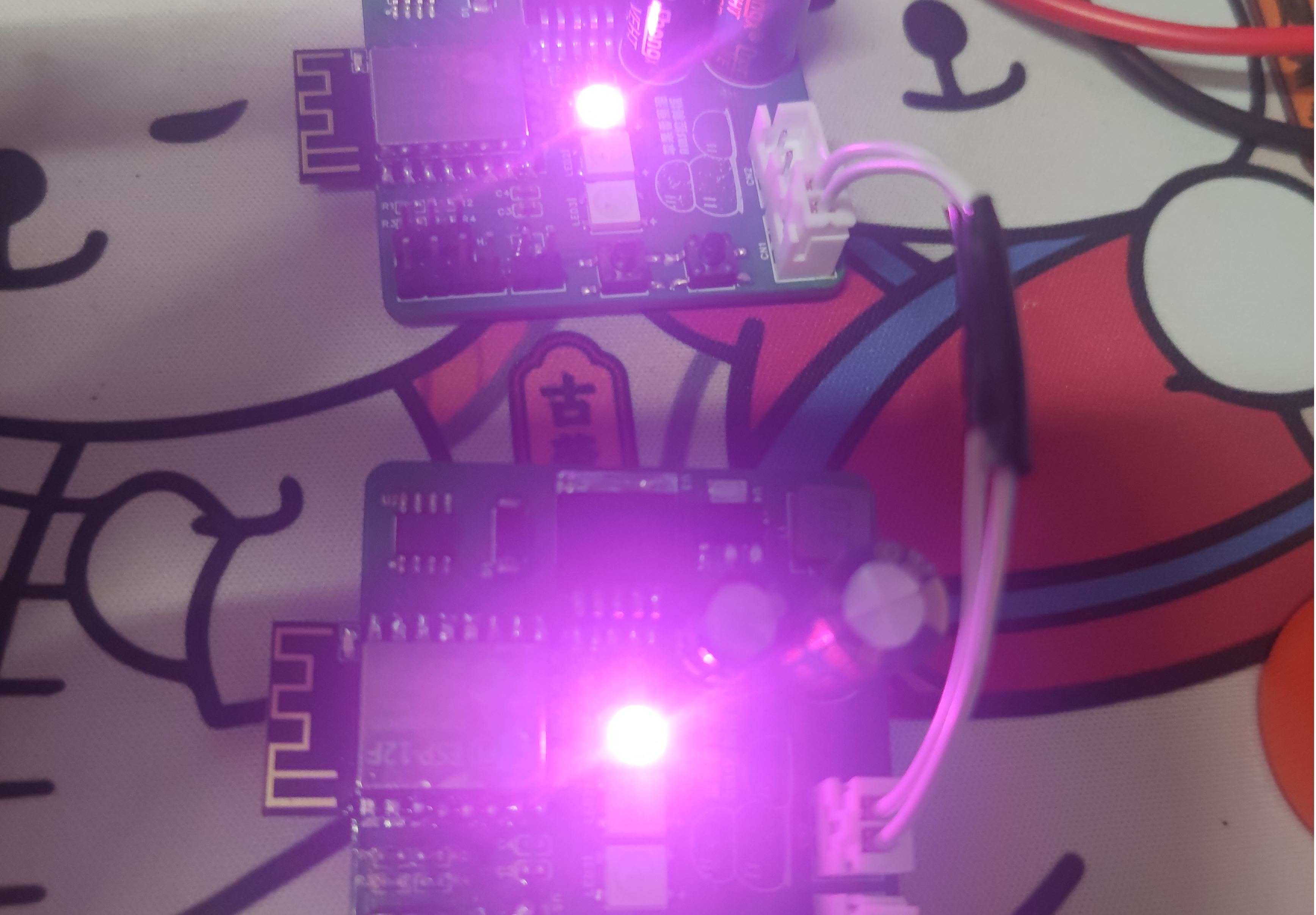

APAMS Control Panel
An updated version is available. Please visit https://oshwhub.com/applenana/ap-ams-control-panel-30 to view
the integrated 5V/3.3V step-down motor control, enabling servo control, motor control, and LED control. Daisy-chain power supply is possible; please
pay attention to the encapsulation!
Quantity
Name
Corresponding Tag
Package
680uF
C1
CAP-TH_BD10.0-P5.00-D1.0-FD
220uF
C2
CAP-TH_BD8.0-P3.50-D0.6-FD
10uF
C3
C0603
100nF(0.1uF)
C4, C5, C6, C7
C0603
xh2.54 socket
CN1, CN2
CONN-TH_2P-P2.50_HX25003-2A
1N5824 SMD Schottky diode
D1
DO-214AC_L4.3-W2.7-LS5.2-RD
4pin header
H1
HDR-TH_4P-P2.54-VM
2pin
H2
HDR-TH_2P-P2.54-VM
3pin
H3
HDR-TH_3P-P2.54-VM-1
33uH
L1
IND-SMD_L7.1-W6.6_MJC-0603T
5050-WS2812B
LED1, LED2, LED3
LED-SMD_4P-L5.0-W5.0-BL_XL-5050RGBC 12
10K
R1
, R2, R3, R4, R6
R0603
300K
R5
R0603
4.5mm SMD Microswitches
SW1, SW2
SW-SMD_4P-L4.5-W4.5-P3.00-LS7.0
esp12f
U1
WIFIM-SMD_ESP-12F-ESP8266MOD
TC118S
U2
SOP-8_L4.9-W3.9-P1.27-LS6.0-BL
17
LM2596S-5.0
U3
TO-263-5_L10.2-W8.9-P1.70-BR
AMS1117-3.3
U4
SOT-223-3_L6.5-W3.4-P2.30-LS7.0-BR
PDF_APAMS Control Panel.zip
Altium_APAMS Control Board.zip
PADS_APAMS Control Board.zip
BOM_APAMS Control Board.xlsx
