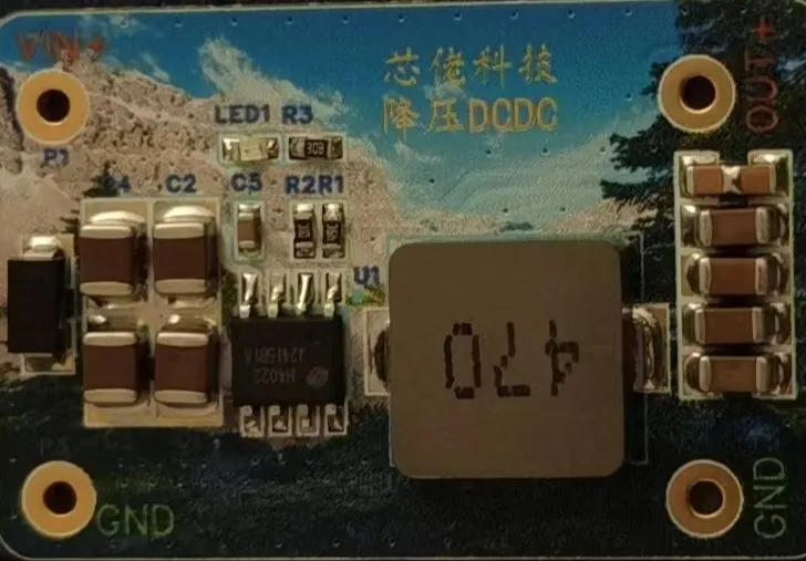

Recommendation: Avoid 4A output as the chip will overheat; the chip temperature reaches 83°C at 3A output.
1. An SS36 Schottky diode is used at the input for reverse connection protection. Its function is to protect the chip from damage if the input power is reversed. The advantage of using a diode is its low price, but the disadvantage is slightly higher power loss.
2. Four 10uF, 35V X5R MLCC capacitors are used for the input. According to the official reference calculation document, the minimum input capacitance is 47uF. Therefore, four 10uF, 35V MLCC capacitors and one 0.1uF, 50V X7R MLCC capacitor are connected in parallel. These five capacitors should be placed close to the VIN pin during PCB layout.
Notes: X7R and X5R capacitors indicate their temperature tolerance; X5R represents -55°C to +85°C, and X7R represents -55°C to +125°C.
3. Inductor selection: Using the official table, input voltage, output voltage, and current were entered. After calculation, a reference inductance of 20.6uH was chosen. However, this value is unavailable, so a 22uH inductor was selected. Shielded inductors are preferable to reduce EMI and improve stability and safety. Since a 22uH inductor was unavailable, a 47uH/3A inductor was used.
4. Output capacitor selection: Four 22uF, 25V X5R capacitors were chosen. The table references 1000uf/16V electrolytic capacitors. Due to the higher equivalent ESR of electrolytic capacitors, four 22uF capacitors and one 0.1uf MLCC capacitor were ultimately selected.
5. The feedback voltage sampling resistor uses 31.6K, and 10k±1% forms the feedback network. These two values ​​are readily available; alternatively, values ​​from the reference table can be used.
6. A red LED is included as a power indicator, and a 4.7K current-limiting resistor is used.

Based on the reference guidelines, the following is my personal layout; please forgive any shortcomings. This prototype uses immersion gold color silkscreen printing.
2.1 Due to the inherent ±1% error of the resistors, the measured output voltage accuracy is ±1%.
2.2 No-load ripple: Due to the limited equipment and lack of a load cell, the measured no-load ripple is 10-20mV. For chips under 1 unit, this is considered a high-performance chip.
24V input, 3A load, official test output ripple. (My board layout differs slightly from the official board layout.)
Ripple at 12V input, 5V output.
