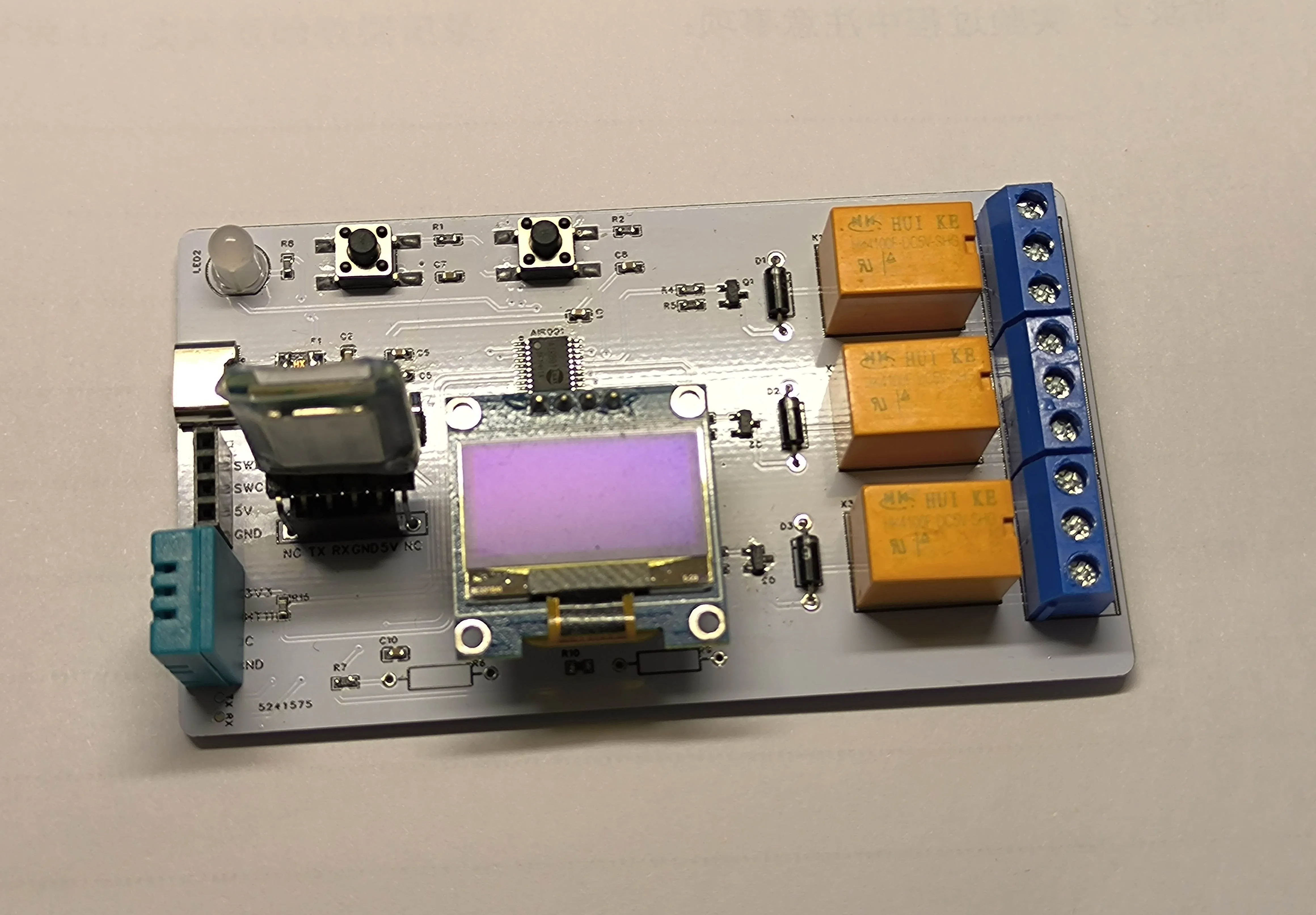

Based on the Hezhou AIR001 data acquisition and control board, it supports one bus-type temperature and humidity sensor, two NTC thermistor temperature measurements, one I2C interface for screen connection, one serial port for downloading and Bluetooth pass-through, a three-color LED and three relay outputs (
tested and working on the board). The temperature and humidity sensor connects to a DHT11, and the resistor positions R6 and R9 can be connected to thermistors or photoresistors for measuring temperature and illuminance. The I2C interface can connect to a screen; it was tested and working with a 0.96-inch OLED. The serial port can connect to a Bluetooth module for pass-through.
The Hezhou Air001 chip supports Arduino and Keil development. Using Arduino library functions to drive the screen consumes a lot of flash memory; a simple "Hello World" program alone uses 91% of the space. For screen use, Keil development is probably the best option, or Arduino development could be modified by removing some unnecessary library functions and
using 0603 capacitors and resistors, with an S8050 transistor driving the relay. The relay can handle a maximum current of 3A.
(Updated 24-6-13: Due to the high resource consumption of OLED screens, it can be replaced with an I2C-supporting atmospheric pressure sensor board, model BMP280. Note the positions of VCC and GND; slight modifications to the schematic are needed. If you purchased a 3.3V power supply, the VCC voltage also needs to be drawn from 3.3V.)
(Note 1: The BMP280 sensor supports temperature, humidity, and air pressure detection, eliminating the need for a DHT11 temperature and humidity module, but the BMP280 consumes more flash resources than the DHT11.)
(Note 2: The image below shows a newly made adapter board for screen pin order compatibility with the BMP280 module.)
(Updated 24-06-15: The host computer displays the data sent via Bluetooth. The serial port connects to the Bluetooth module, using Bluetooth pass-through mode. The host computer selects the Bluetooth port, reads and parses the data, and displays it.)
