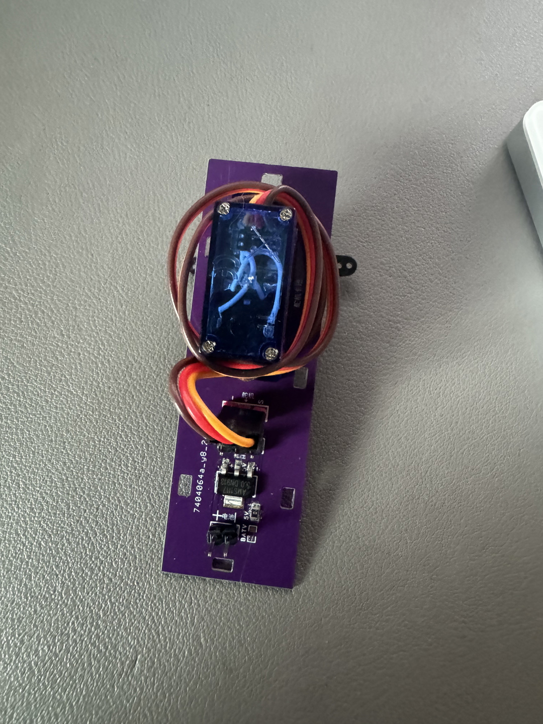

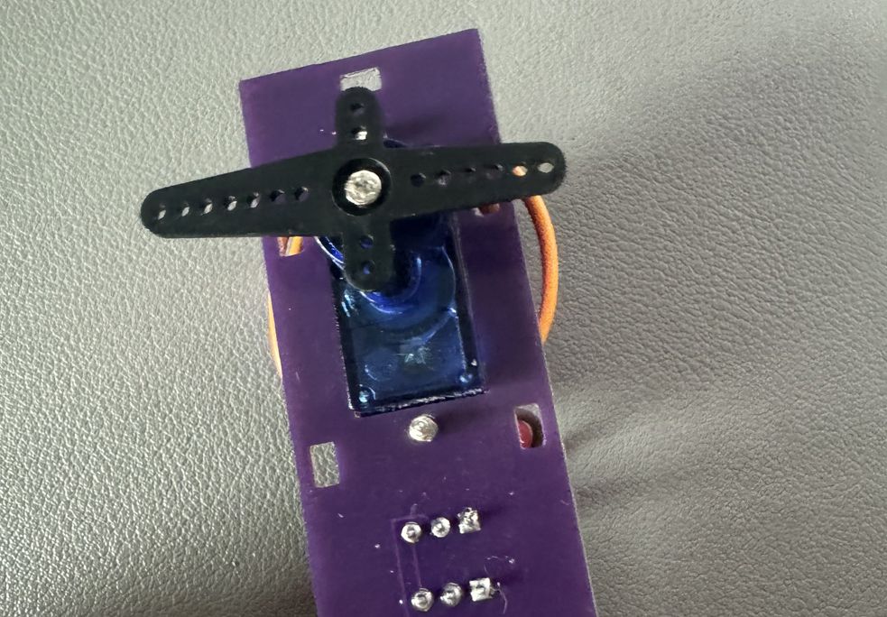

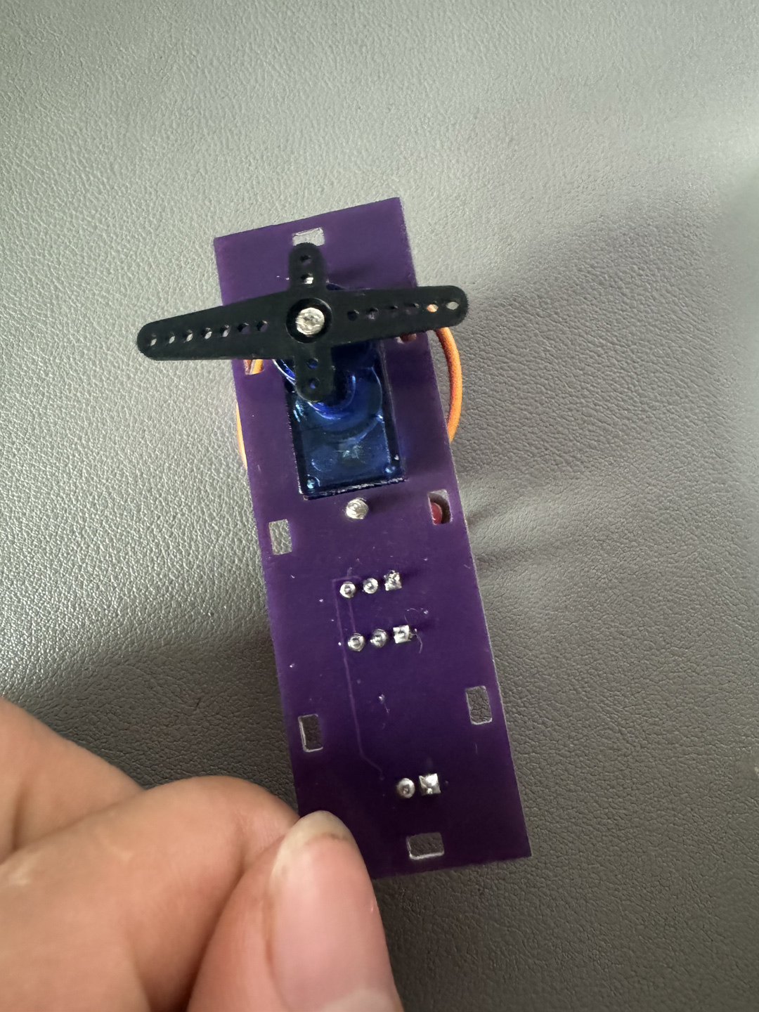

Drone Servo Airdrop Module

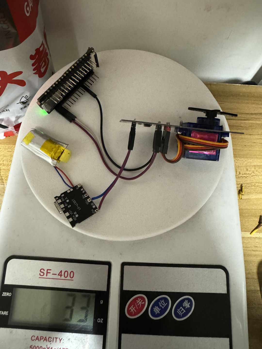

The solution for drone airdrops uses a 4G module for an elegant airdrop; a simple phone call is all it takes to land the drone, which is far more graceful than circling twice in the air. Currently, the module feels too heavy; the servo alone weighs 10 grams, and with the battery and Air780 module, it's still too heavy compared to the 25-gram module sold online. However, a more elegant, lightweight solution without servos has flashed through my mind. Of course, I'll definitely consider it next time.
Luatos servo control reference code (SMS control, the servo will rotate upon receiving any SMS message)
PROJECT = 'kongtou'
VERSION = '0.0.1'
-- sys library is standard
_G.sys = require("sys")
local PWM_ID = 1
-- Define servo control function
local function setServoAngle(pwmId, angle)
-- Convert angle to pulse width (microseconds)
local pulseWidth = (angle * 10) + 500 -- From 500 to 2500 microseconds
-- Convert pulse width to duty cycle
local dutyCycle = (pulseWidth / 20000) * 100
-- Set PWM
pwm.open(pwmId, 50, dutyCycle, 0, 100) -- 50Hz frequency, corresponding to the duty cycle of the angle
end
sys.subscribe("SMS_INC", function(phone,sms)
log.info("sms",phone,sms)
setServoAngle(PWM_ID, 0)
end)
sys.subscribe("CC_IND", function(status, value)
log.info("cc status", status, value)
end)
sys.taskInit(function()
-- pwm.open(PWM_ID, 50, 1500) -- Initial position is 1800 degrees
setServoAngle(PWM_ID, 180)
end)
-- User code has ended---------------------------------------------
-- The ending is always this line
sys.run()
-- Do not add any statements after sys.run()!!!!!

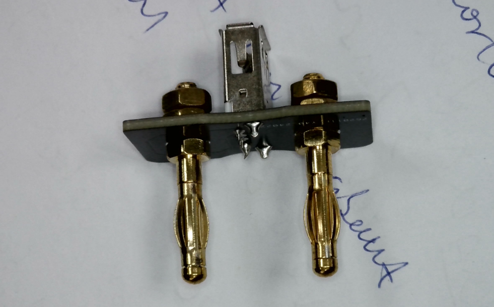

Tmall brand practical gadgets: banana plug to USB adjustable voltage regulator adapter.

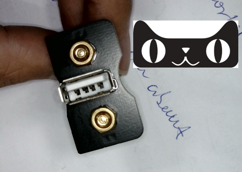

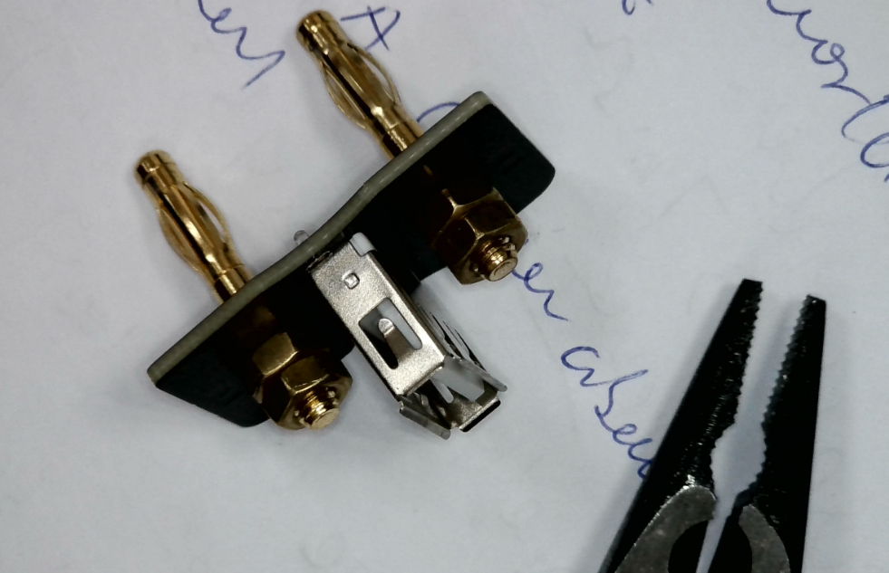

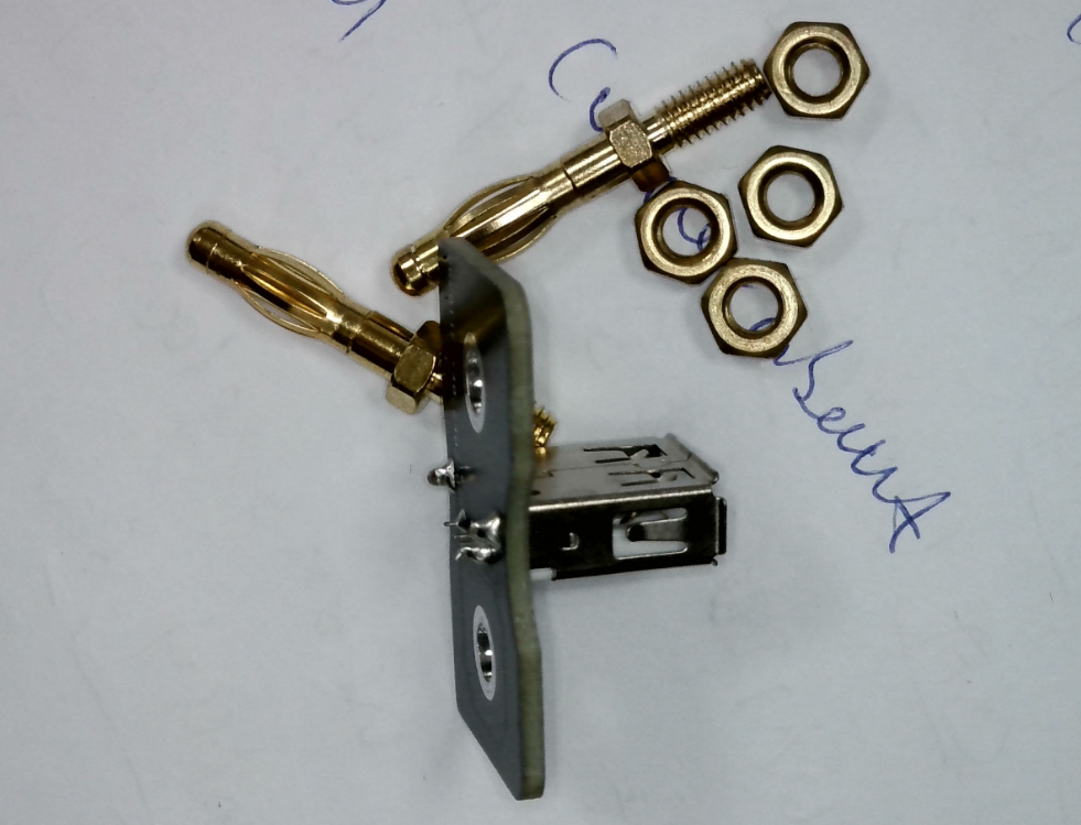

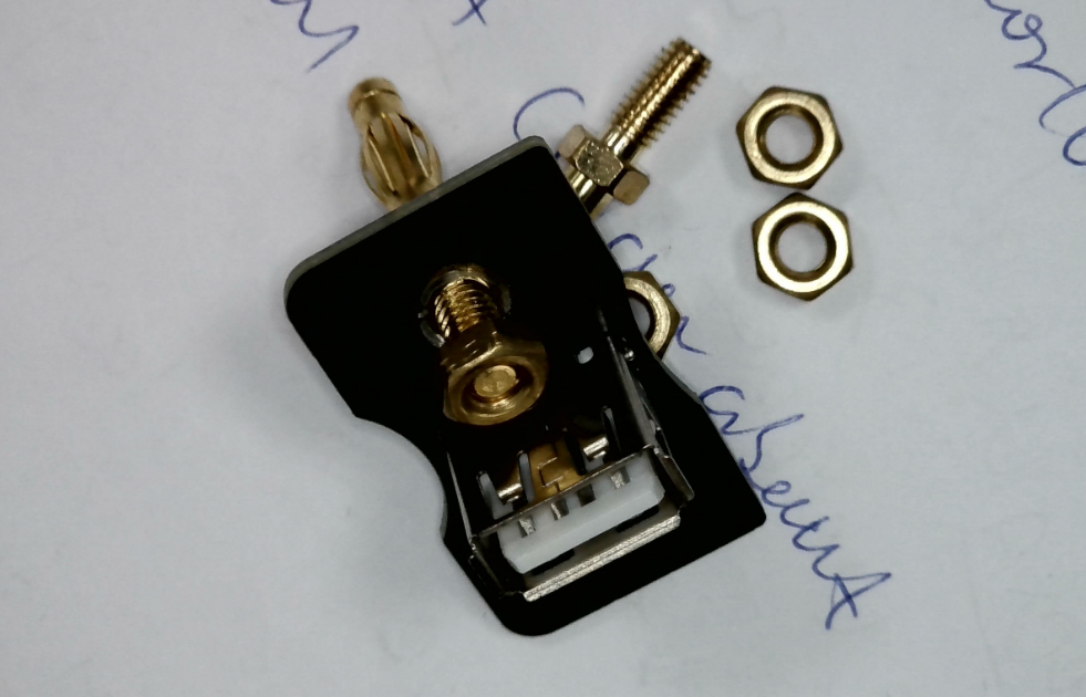

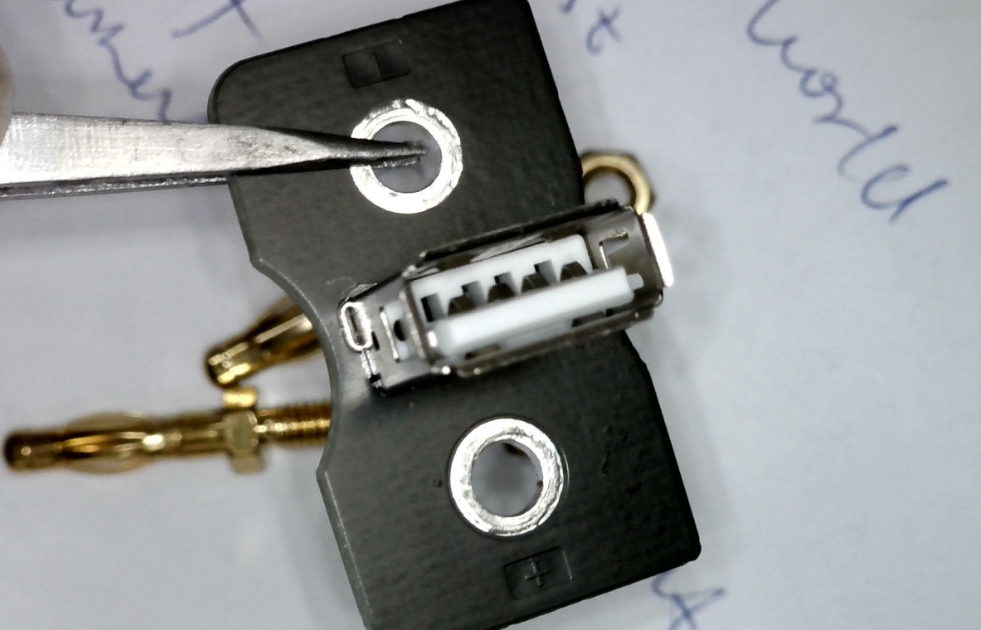

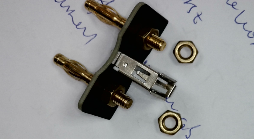

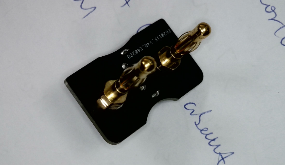

As an electronics engineer, an adjustable regulated power supply is essential, and a USB cable is universal. However, a USB cable cannot be directly connected to an adjustable regulated power supply, so I made a small board with a banana plug to USB adapter, which made wiring much easier.
↓ The golden banana head is made with a lot of investment, hahahahahaha
↓ Soldered USB Type-A female connector
↓ Golden banana pre-assembled
↓ Successfully assembled
↓ Add an extra nut for double the strength
↓ Showing off the golden banana head, hahahahaha
↓ Full view
↓ Instantly transforms into a Tmall store

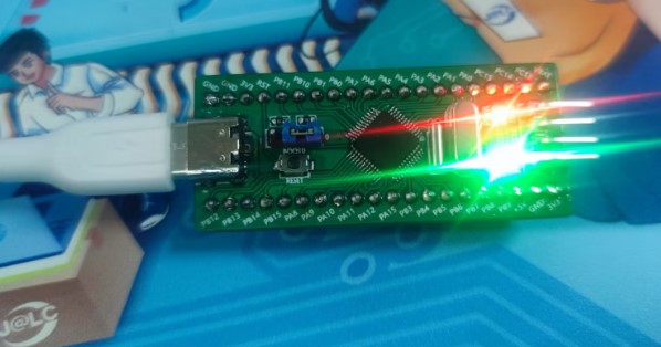

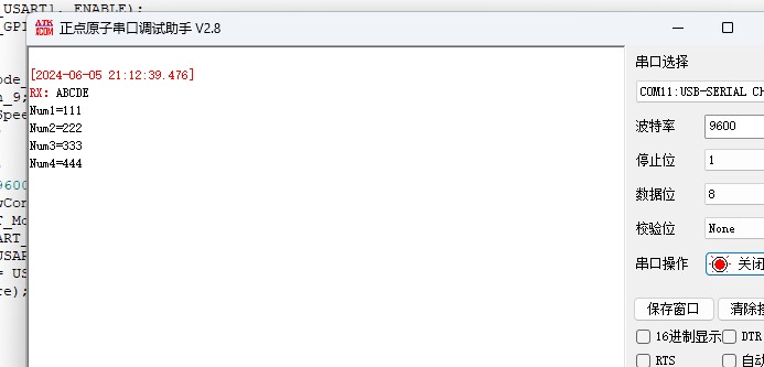

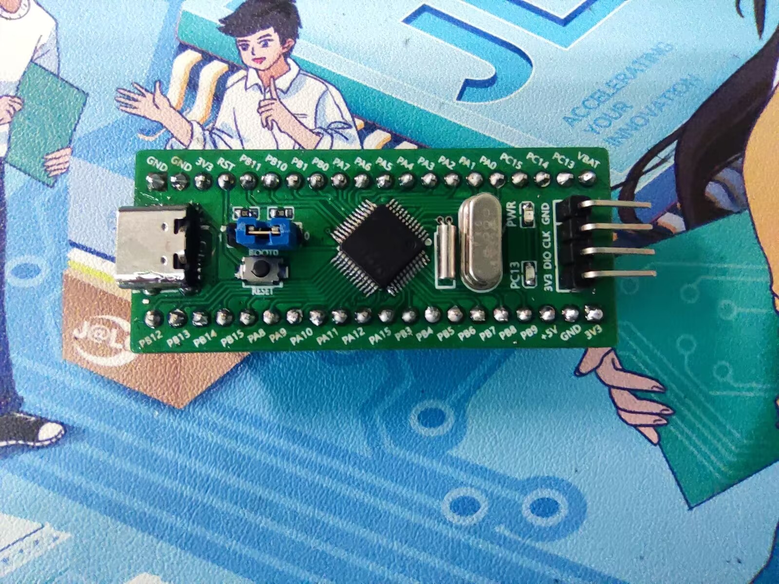

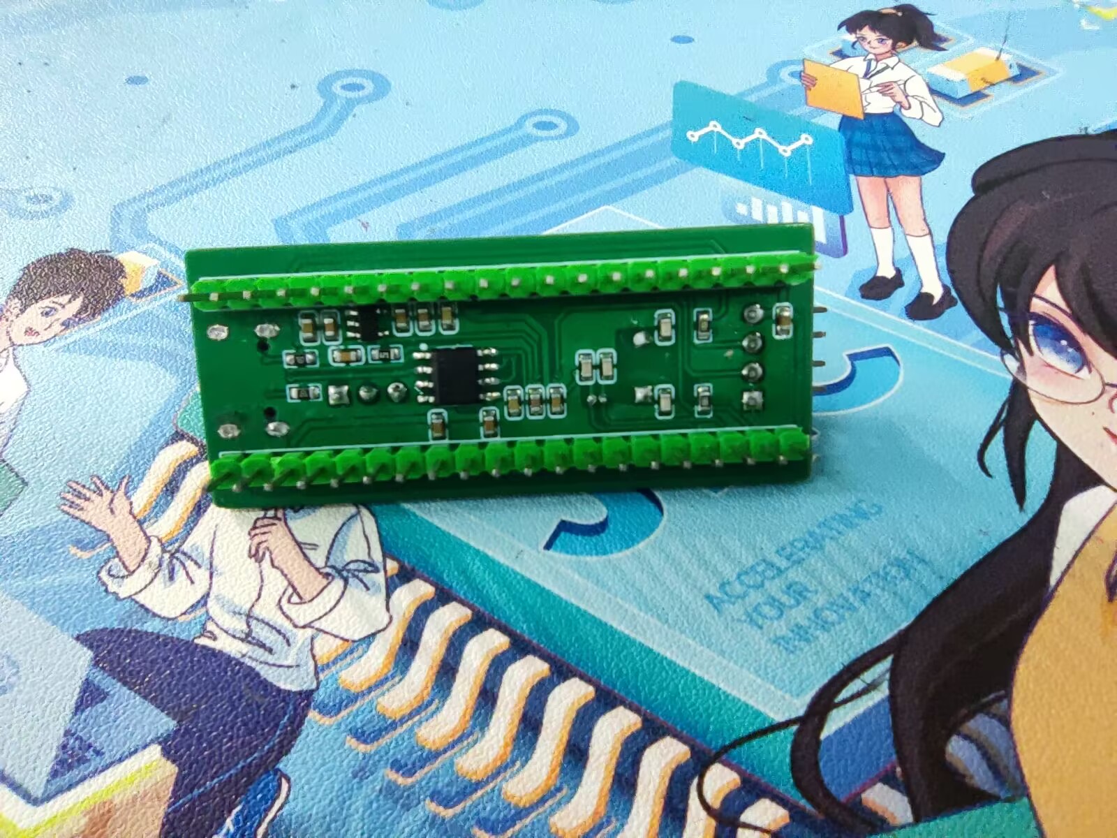

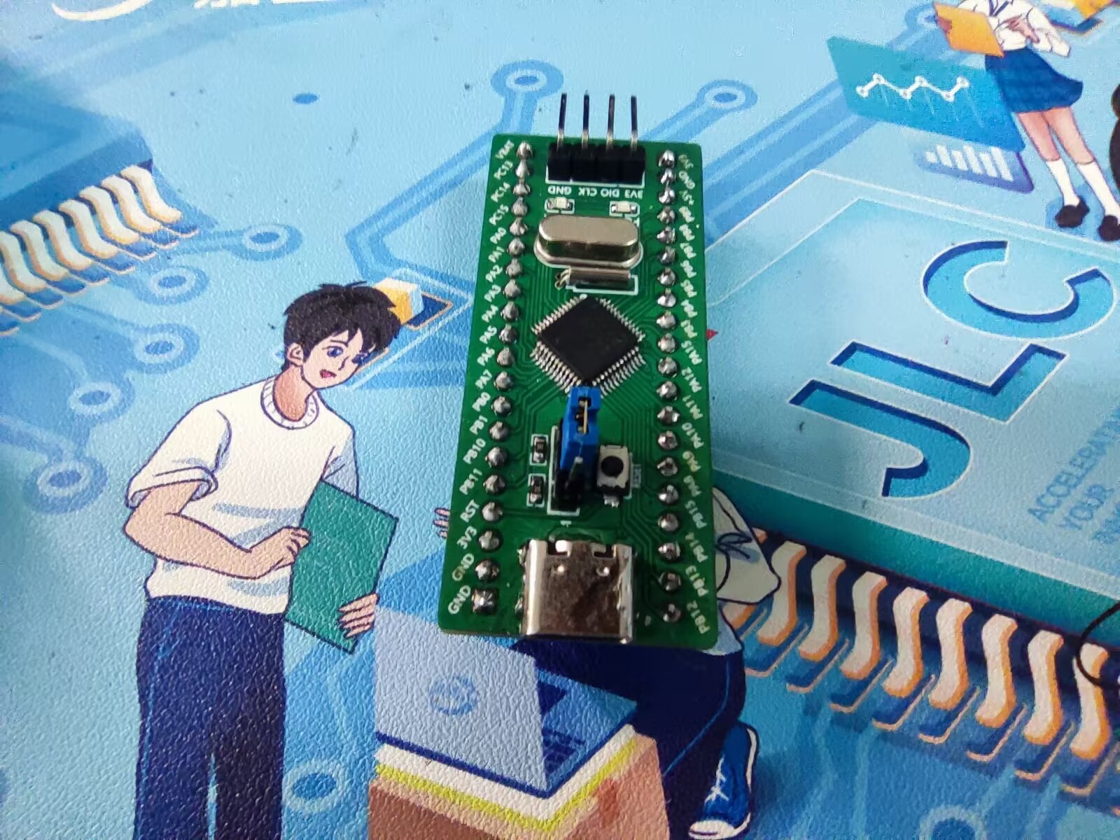

STM32F103C8T6 Development Board
This project utilizes the classic STM32F103C8T6 chip to create a Type-C development board with a serial port chip.
Features:
STM32F1 classic chip, STM32F103C8T6,
a Type C development board with a serial port chip,
appearance
, function testing,
LED lighting,
serial port testing.

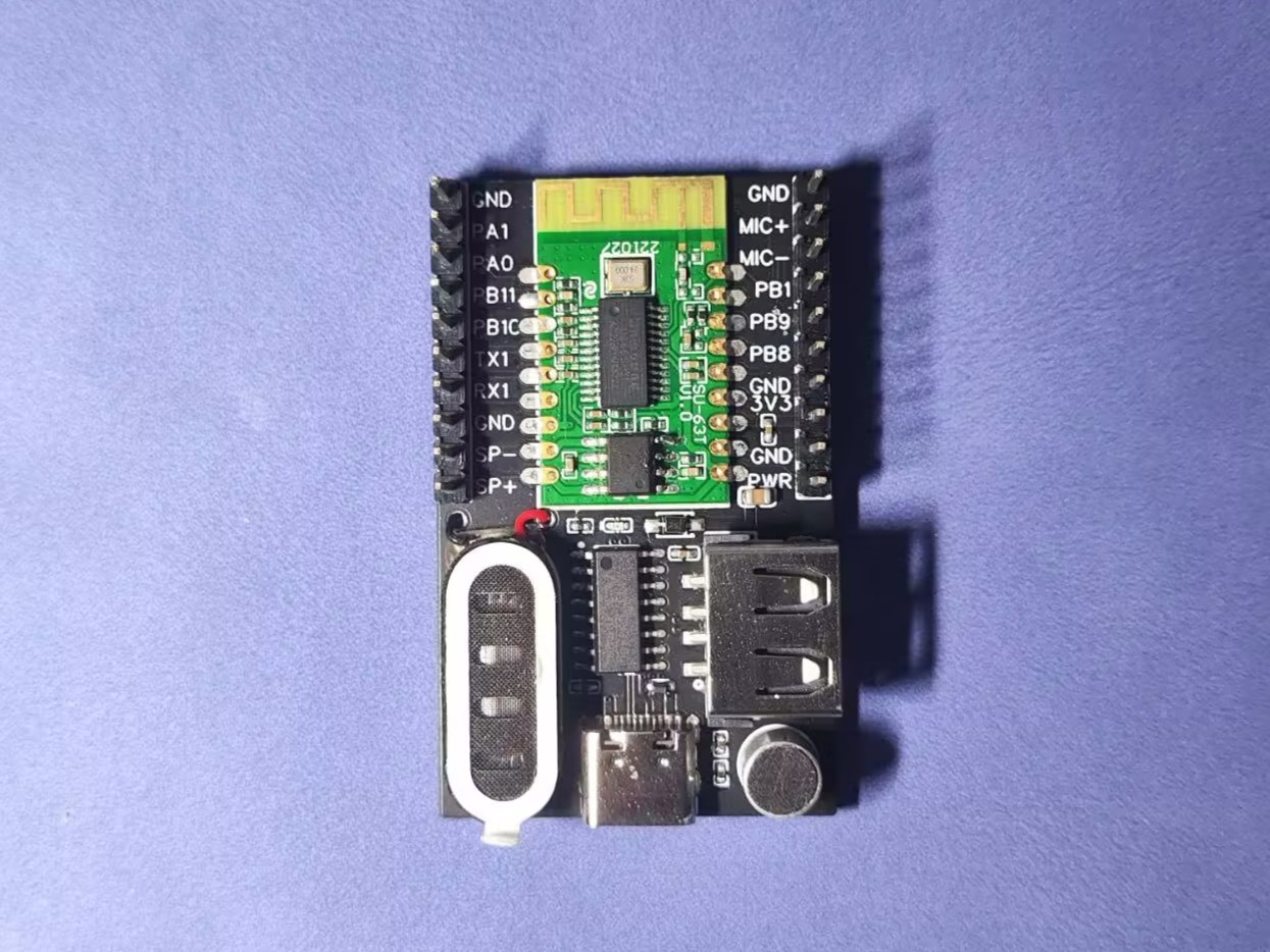

SU-63T Offline Voice Development Board - with Bluetooth
The SU-06T features offline voice control, and its Bluetooth can play music or communicate with the official mini-program to achieve IoT connectivity, but the downloader is relatively expensive.
1. Other offline voice development boards: SU-22T,
SU-03T,
CI-03T.
2. SU-63T physical description
: Includes power indicator, microphone, and speaker. The USB port is for downloading, and the Type-C port is for serial communication. All I/O pins are printed.
3. Download tutorial
will be added later; please see the attachment below.
03. SU-63T Development Kit; Version 2303201108.zip
