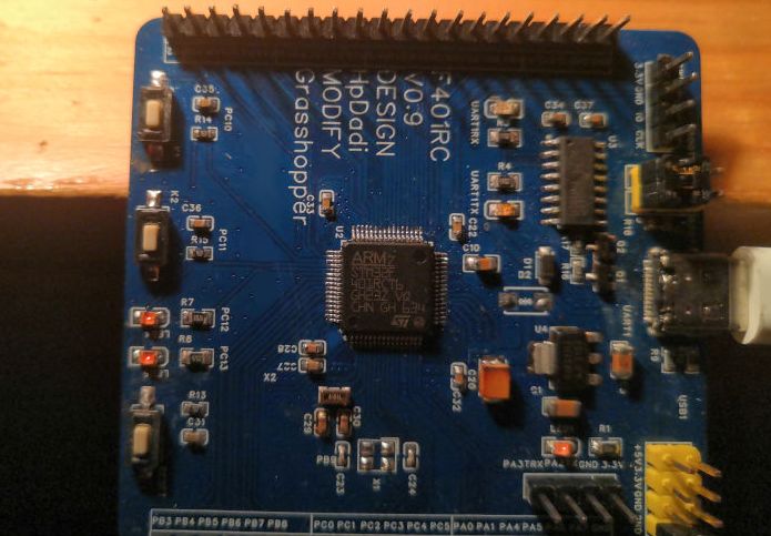

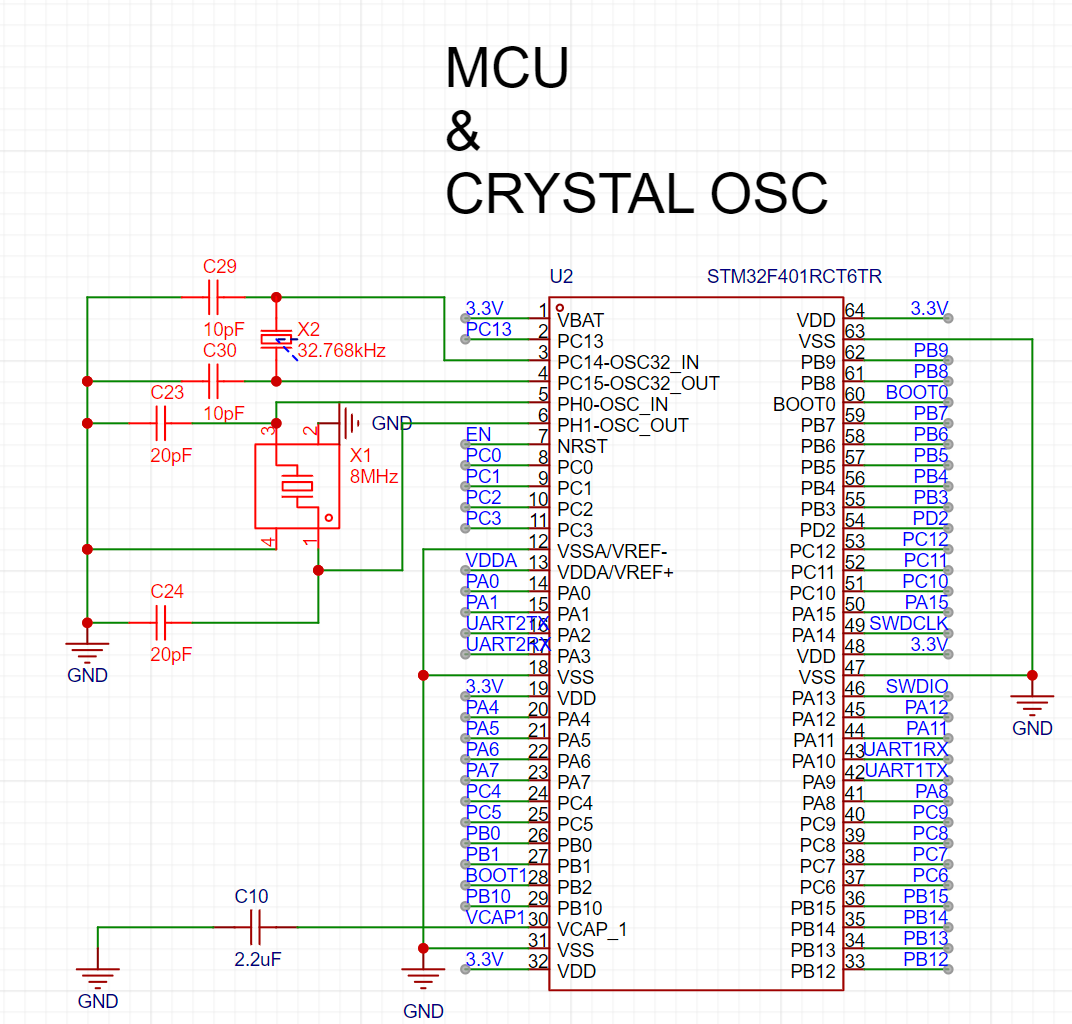

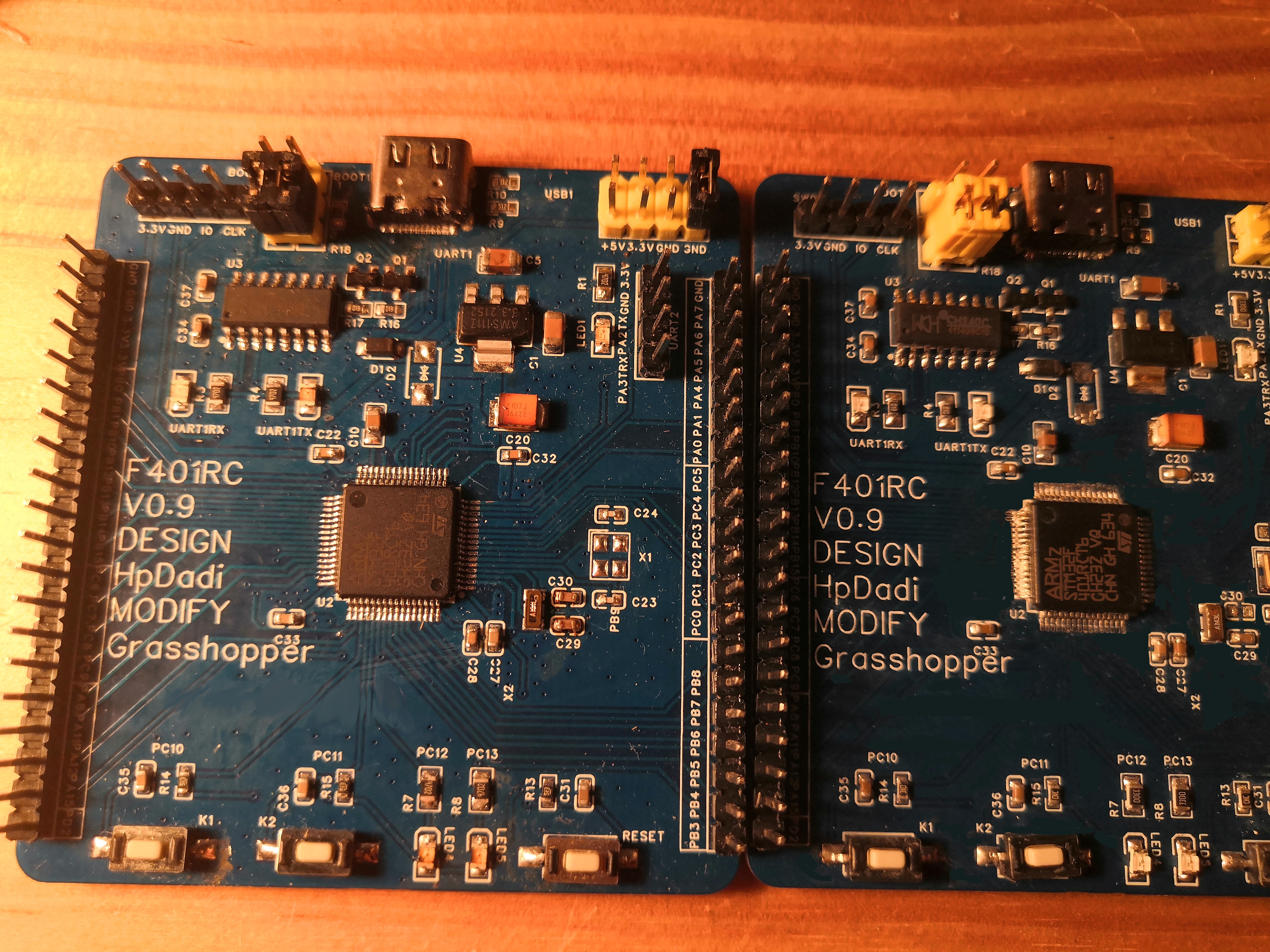

This is a project based on and improved upon the open-source work "STM32F401RCDEV" by author hdpadi. ​​Currently, the CH340C version of this project has been verified.
Physical image/module picture:  Top left and right: Two STM32F401RCT6 development front views (some details have been enhanced).

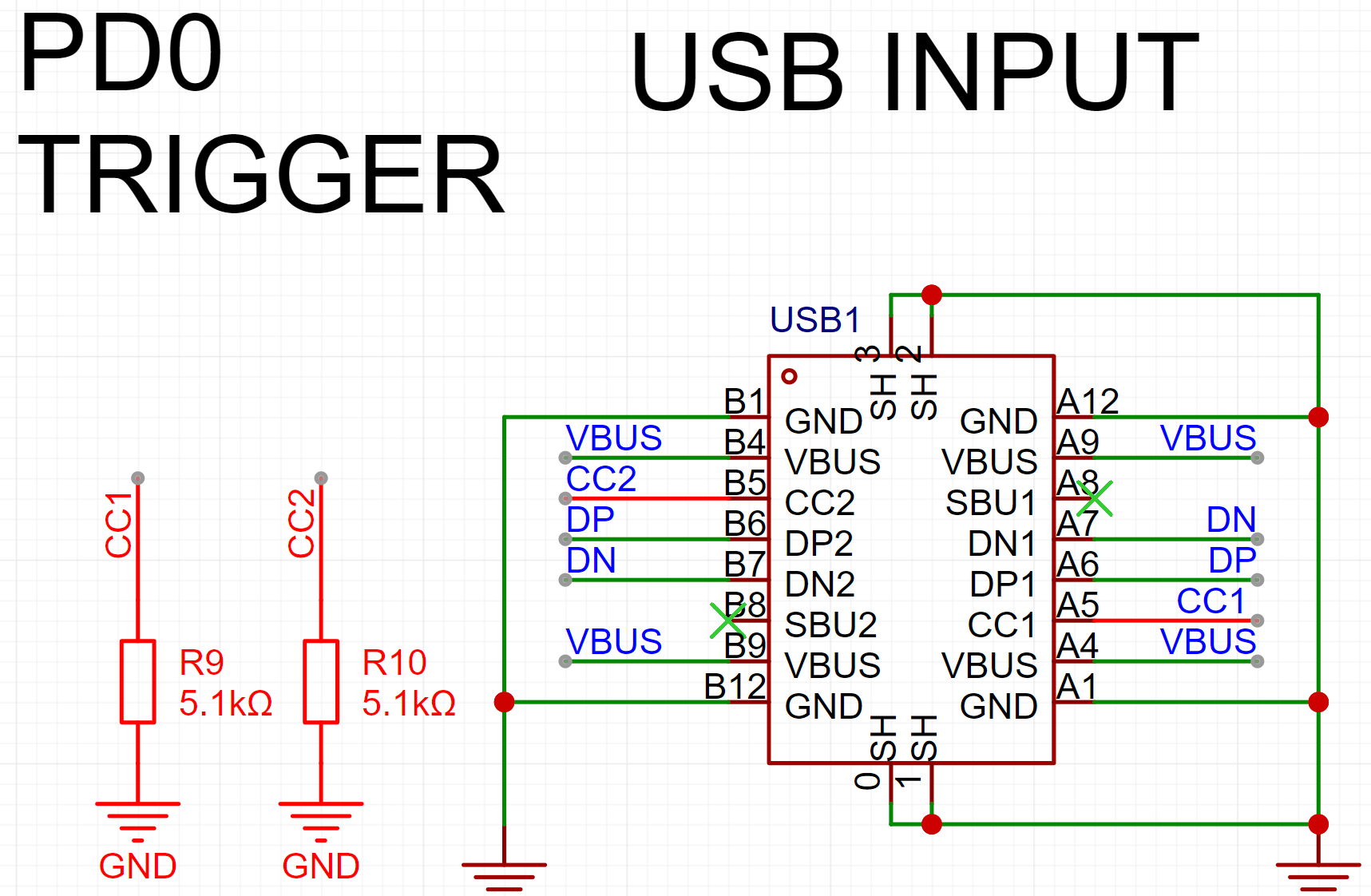

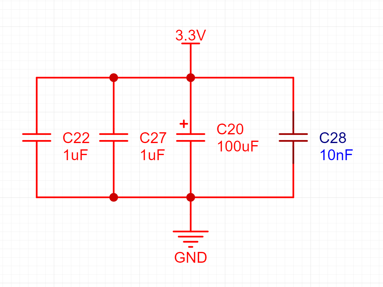

The main design changes to the original include the following: 1. Added a Type-C PD0 trigger function, using a 5.1k resistor to trigger the 5V output, allowing a 5VPD power adapter to power it. 3. Replaced some power capacitors, improving power stability.
However, there may be potential problems and challenges. Therefore, I warmly welcome and look forward to valuable suggestions and advice from open-source community members. If you have any thoughts or questions about this project, please feel free to contact me. Thank you for your attention and support! Let's work together to promote the development and innovation of open-source hardware!
