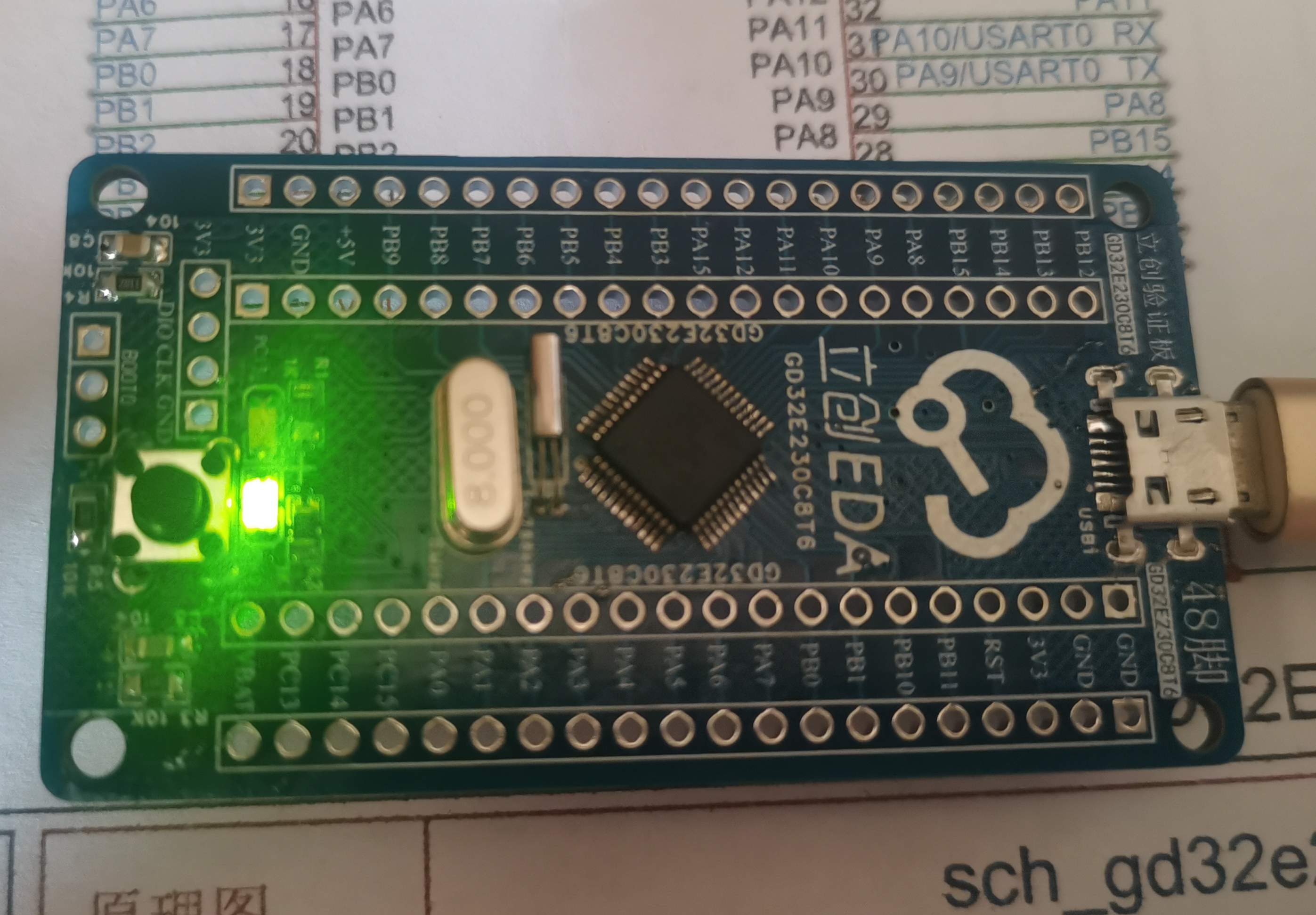

GD32E230 Minimum System (LCSC Team)
This verification version replaced the 16-pin Type-C port with a micro connector based on the difficulty of soldering, changed the reset button from a two-pin to a four-pin one, and repositioned several other ribbon cables. Everything else follows the original routing from the LCSC team. Through several verifications of open-source files from teams and individuals, we found that the team's approach is generally more classic, and with minor adjustments, it can maintain board accuracy and has a higher fault tolerance. Some individual designs (including my previous ones, which are currently being checked and re-released one by one) have particularly poor logic, especially in terms of routing.
