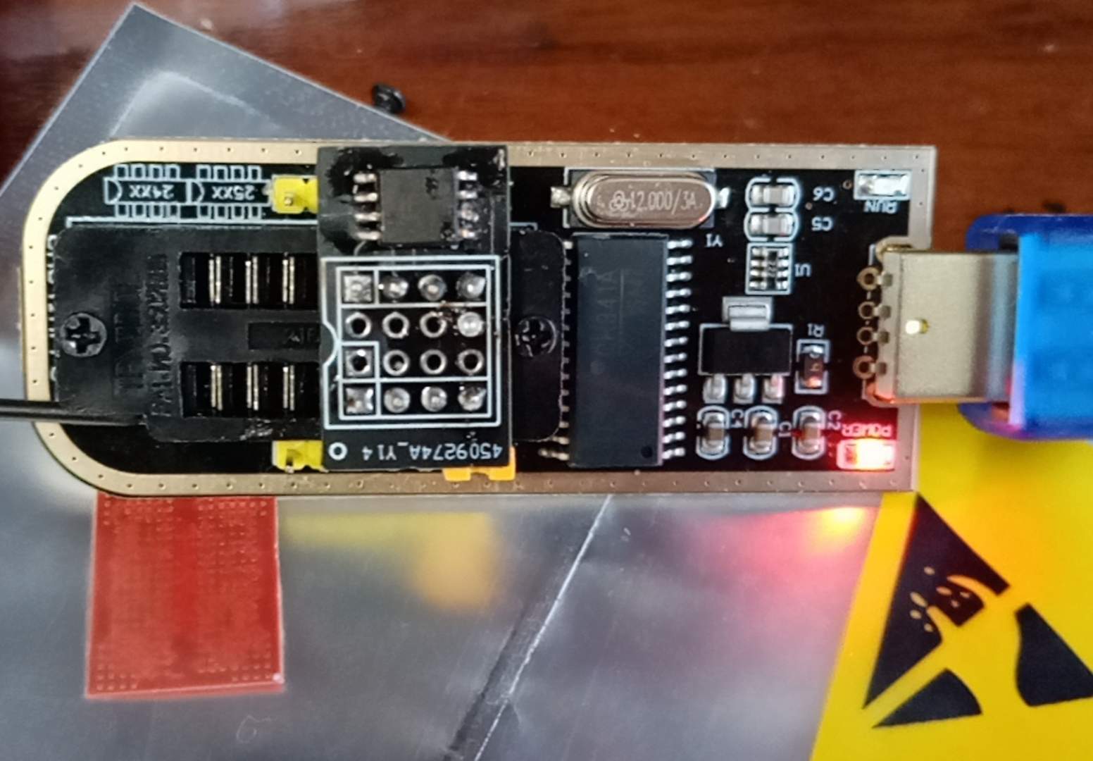

Pluggable bios adapter board
Because ordinary bios can cause damage if you are not careful when plugging and unplugging, and ordinary bios chips can easily break the pins. So I designed a solder-to-pluggable bios chip adapter board.
The project has been verified and available.
ch341a can be recognized normally:
test platform: ASUS p8z68-v lx. Since the heat dissipation vest of the z68 chipset of this motherboard blocks the PCB, it needs to be removed. It will be revised later. The demonstration video is in the project attachment.
