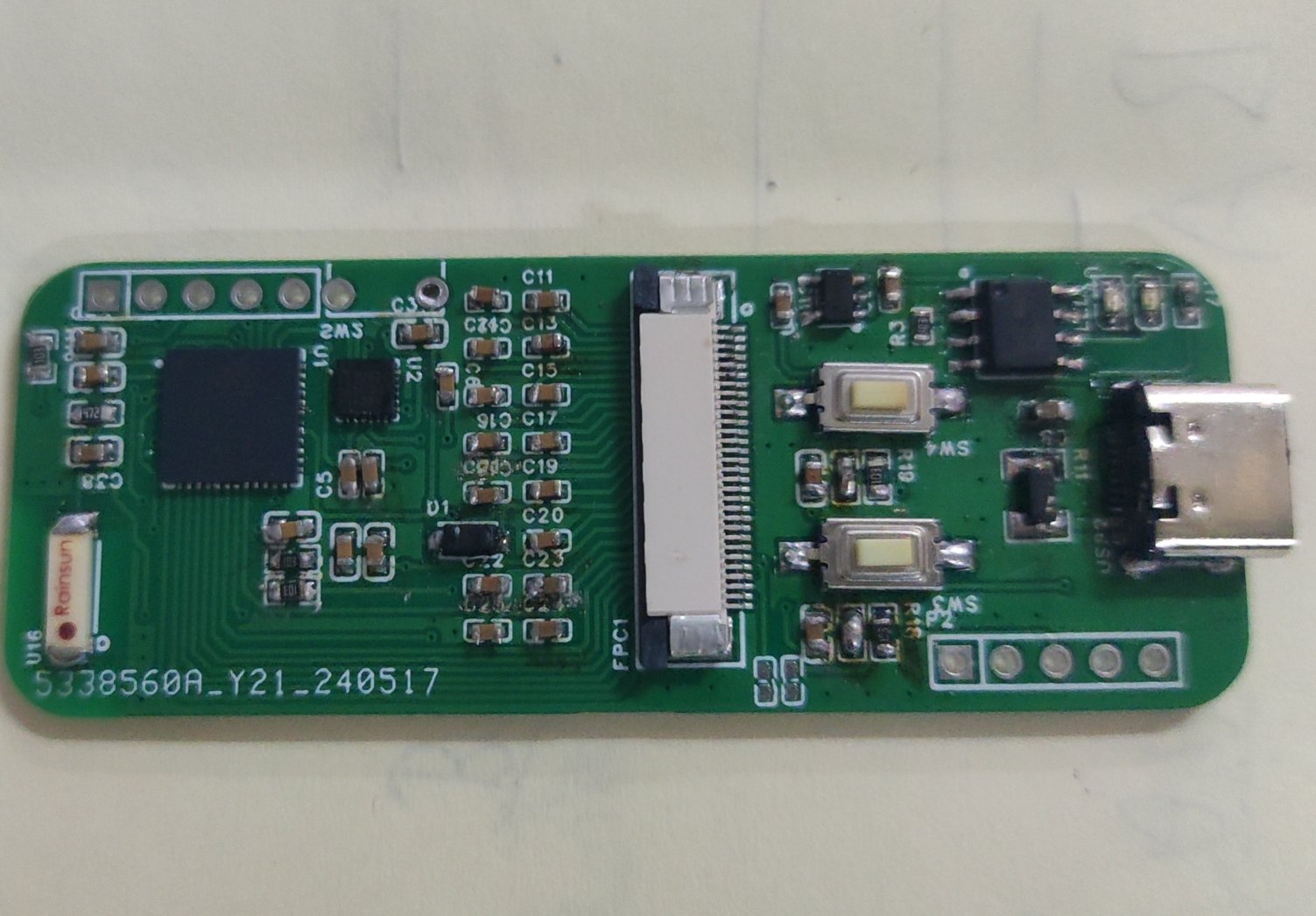

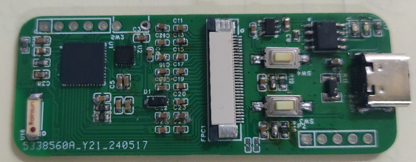

ESP32-PICO-V3 Bluetooth Mouse

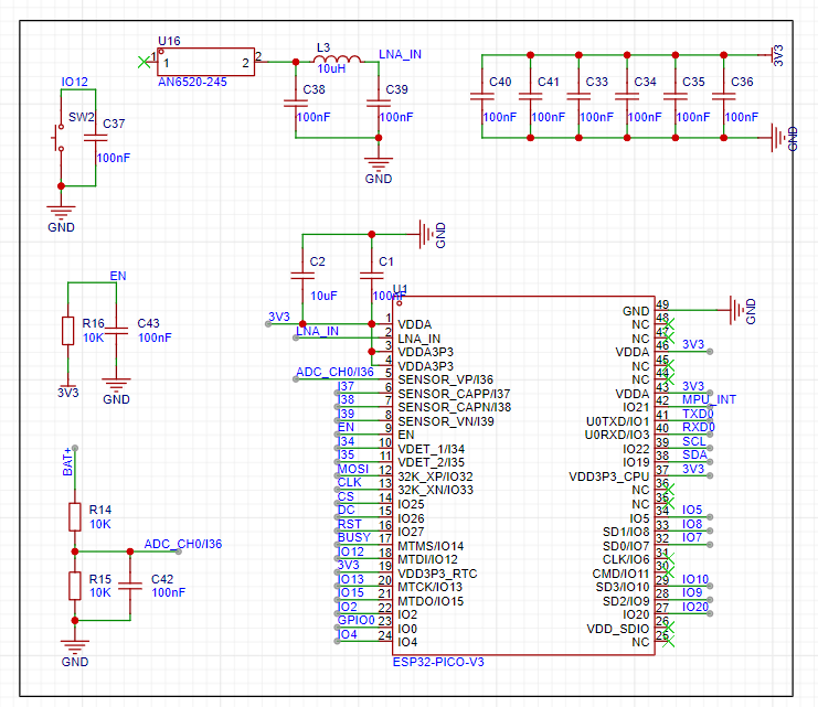

This project utilizes the ESP32 V3 control chip and the MPU6500 as a gyroscope. Buttons are used to act as the left and right mouse buttons, with Bluetooth connectivity handled by the main control chip.
Signals are received via a ceramic antenna, filtered by a π-type filter, and then sent to the ESP32 for data processing.

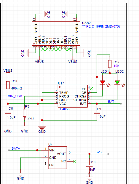

A TP4056 charging management chip charges the lithium battery and stabilizes it at 3.3V to power the circuit.

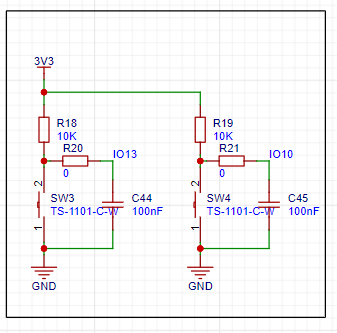

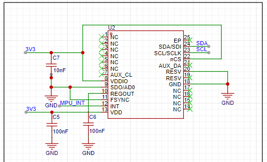

The MPU6500 provides 3-bit attitude sensing, which is then sent to the main control chip for processing. This simulates a mouse pad on a flat surface,
with two touch buttons acting as the left and right mouse buttons.
PDF_ESP32-PICO-V3 Bluetooth Mouse.zip
