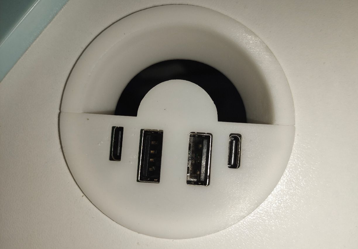

This desktop USB docking station design, based on the SL2.1s chip, is designed for desktops with a 5cm+ round hole. It boasts high space utilization efficiency, featuring dual USB-A and dual USB-C ports, and even allows for cable routing, mimicking the mass-produced "smiley face" cable management box that cannot transmit data.
The project includes two versions: one with only two USB-A ports, which can be directly integrated into commercially available "smiley face" cable management boxes and is relatively easy to solder;
the other, the Pro version, adds two more USB-C ports and includes a specially designed 3D shell (exported using FreeCAD; I'm a 3D novice, please excuse the design). The shell is too thin and may crack during printing; modifications are recommended.
Testing showed that both versions, regardless of whether they have USB-A or USB-C ports, can achieve near-full USB 2.0 performance.
M1.2*10 screws are used.
A USB wireless mouse and keyboard terminal storage box is included in the file; this is a personal design and can be used as needed.
