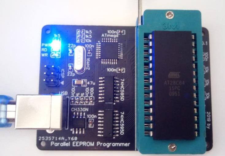

ATmega EEPROM Programmer
Parallel EEPROM Programmer for 28C64B and 28C256 featuring:
  • GUI-based front-end written in Python,
  • possibility to access the programmer via a serial monitor,
  • hardware SPI at 8 MHz to control address bus via shift registers,
  • utilizing the fast page write mode of the EEPROM,
  • 1 Mbps serial interface via USB,
  • binary data transmission.
Windows users may need to install a driver: http://www.wch.cn/download/CH341SER_ZIP.html. This is not necessary for linux users.
