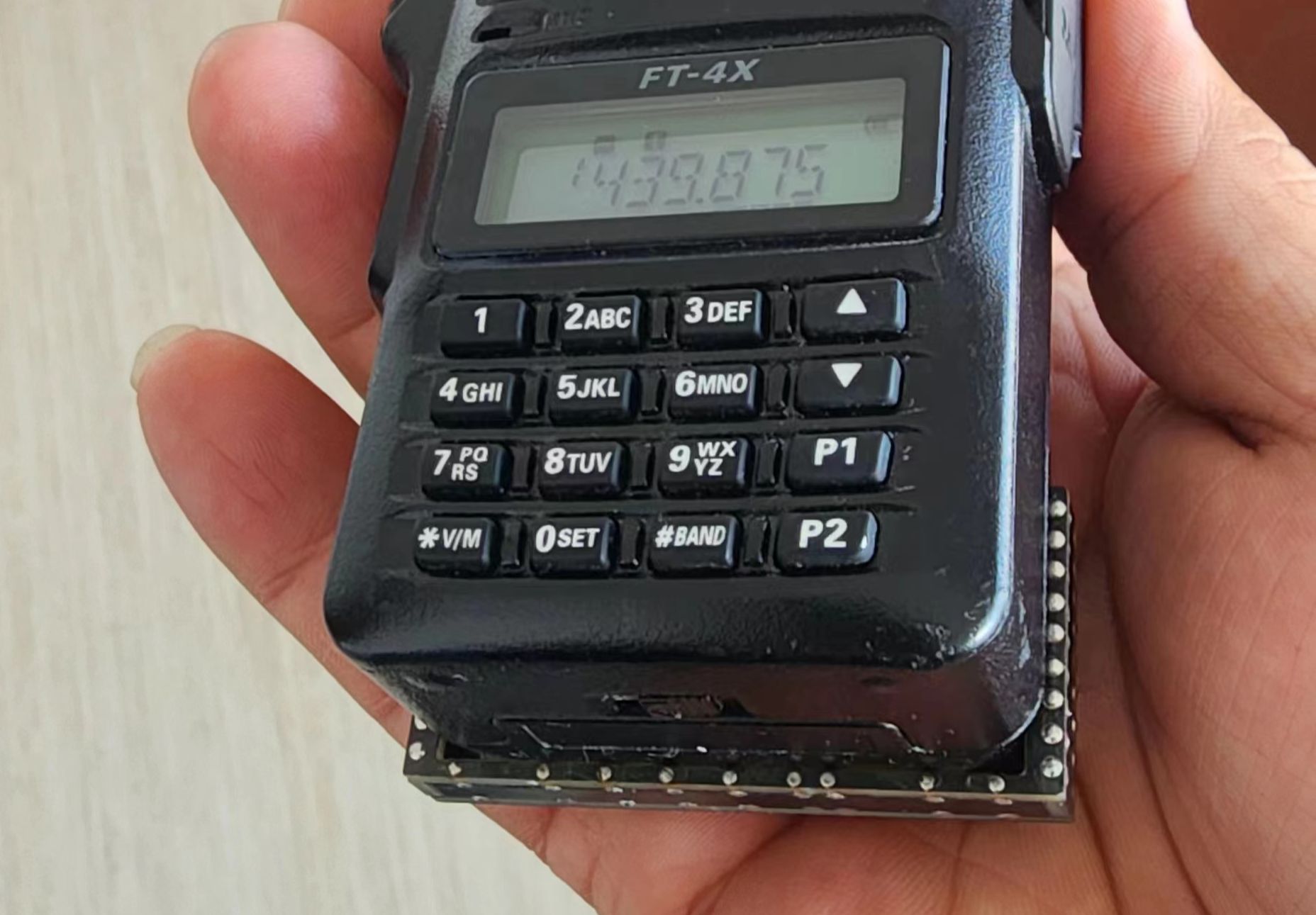

The CH224K was used to trick the 12V of the Type-C port into powering the module. This is a Yaesu FT-4XR walkie-talkie charger, using the schematic of the Baofeng UV-5R charging dock.
The basic principle is to use a 12V source (either Type-C or DC) to power an 8.4V charging management chip, which then charges the walkie-talkie's two 4.2V*2=8.4V lithium batteries.

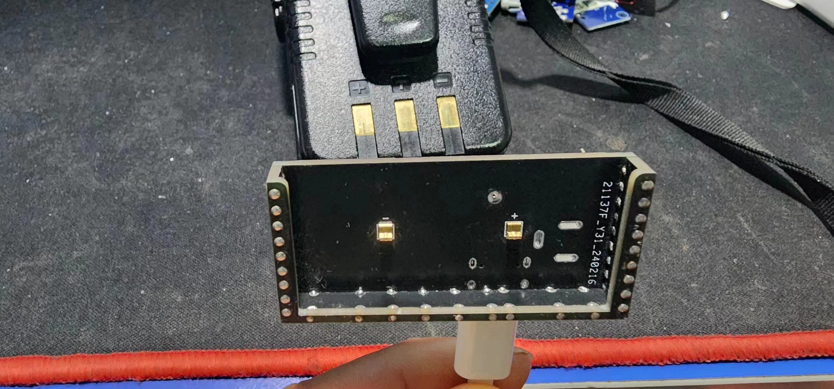

Improvements could be made by changing the spacing of the surrounding solder pads and replacing the surrounding PCB connector posts with 2.54mm pitch pin headers
, which would make soldering much easier. The assembly is quite complicated.
The spring contacts use antenna connectors, purchased from LCSC (BAT WIRELESS) BW0039BG-L3.0W2.0H1.5) https://item.szlcsc.com/2970169.html.

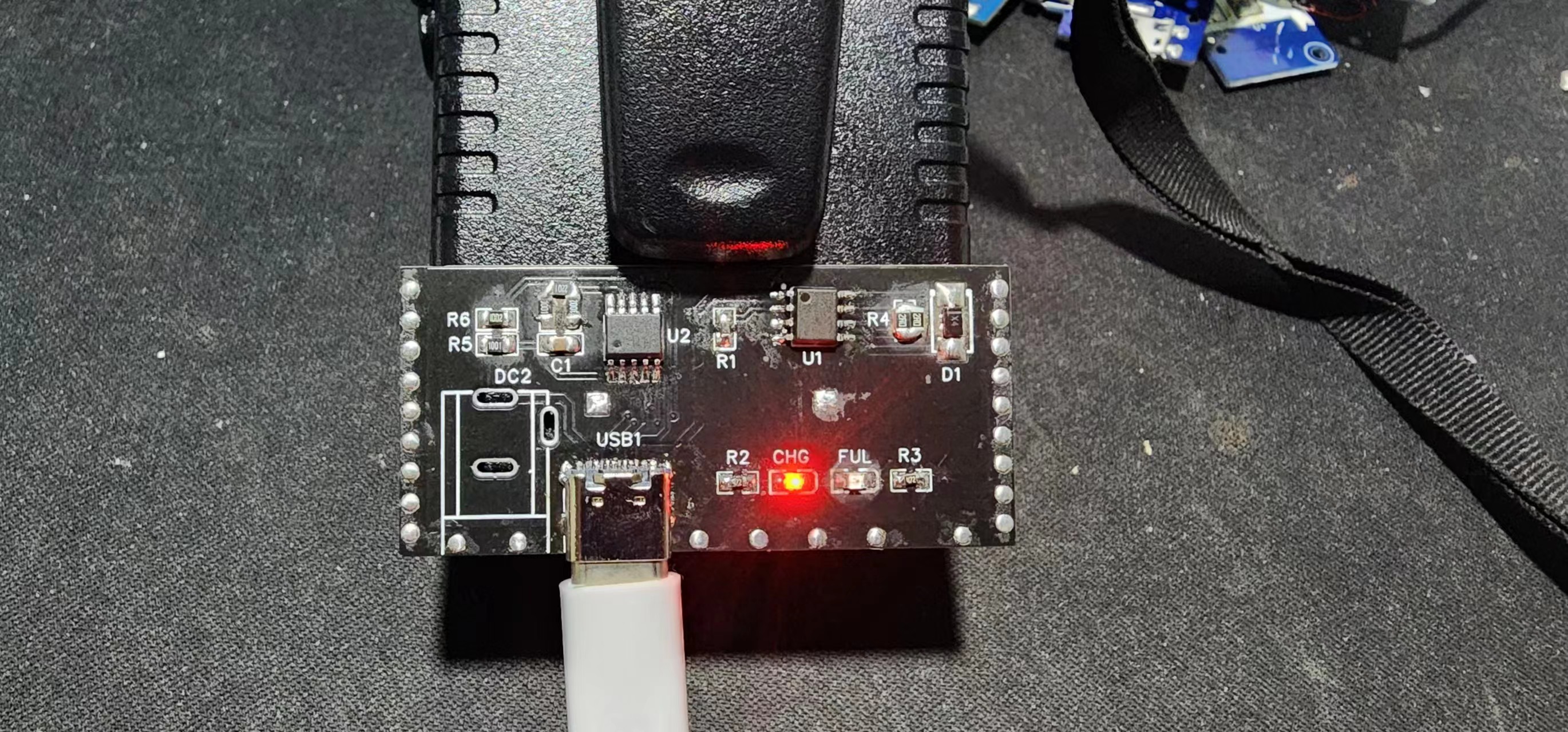

The soldering is complete; only

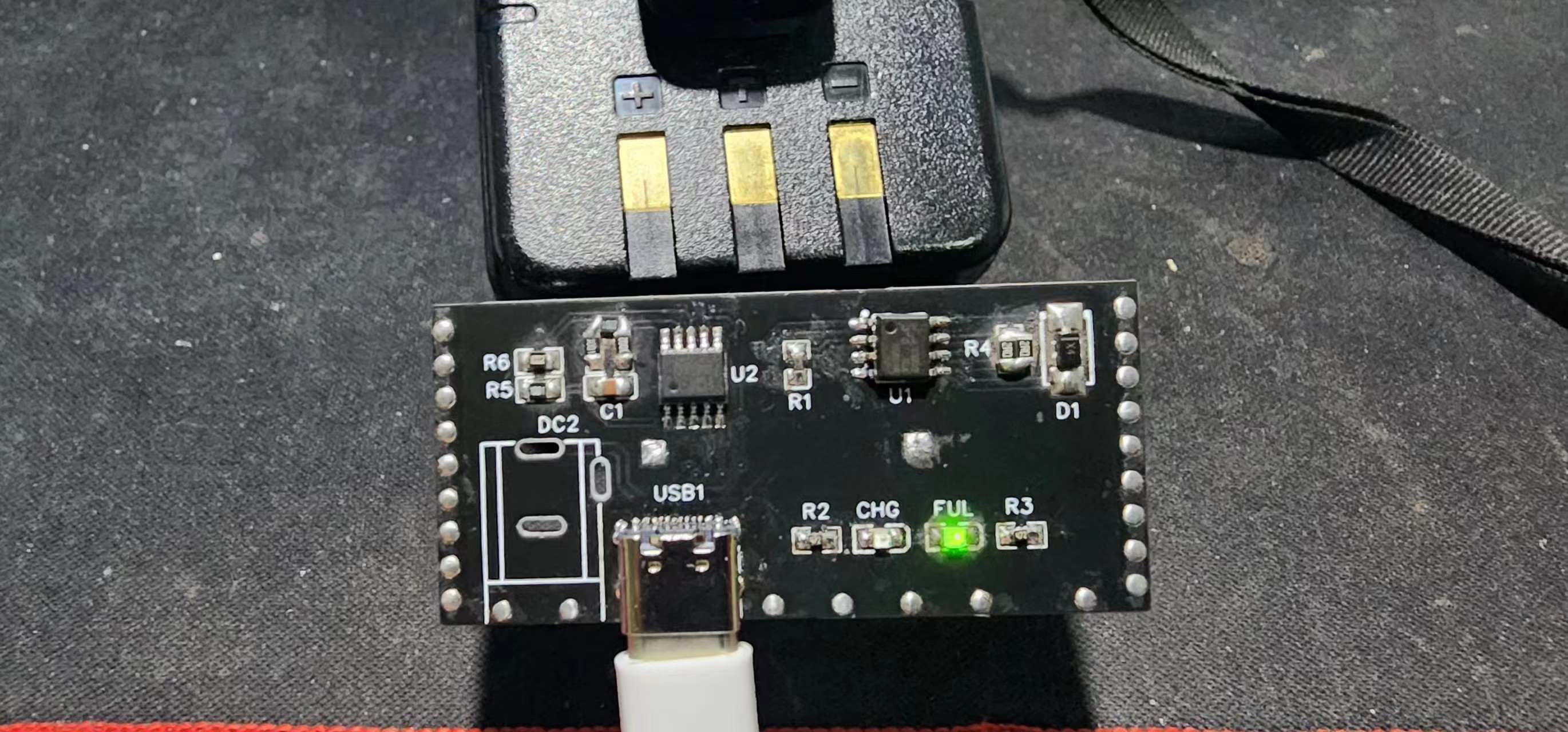

the Type-C contacts are used to extract 12V. The DC connector is not soldered as it's too bulky.
A green light indicates a fully charged battery,
while a red light indicates charging.
