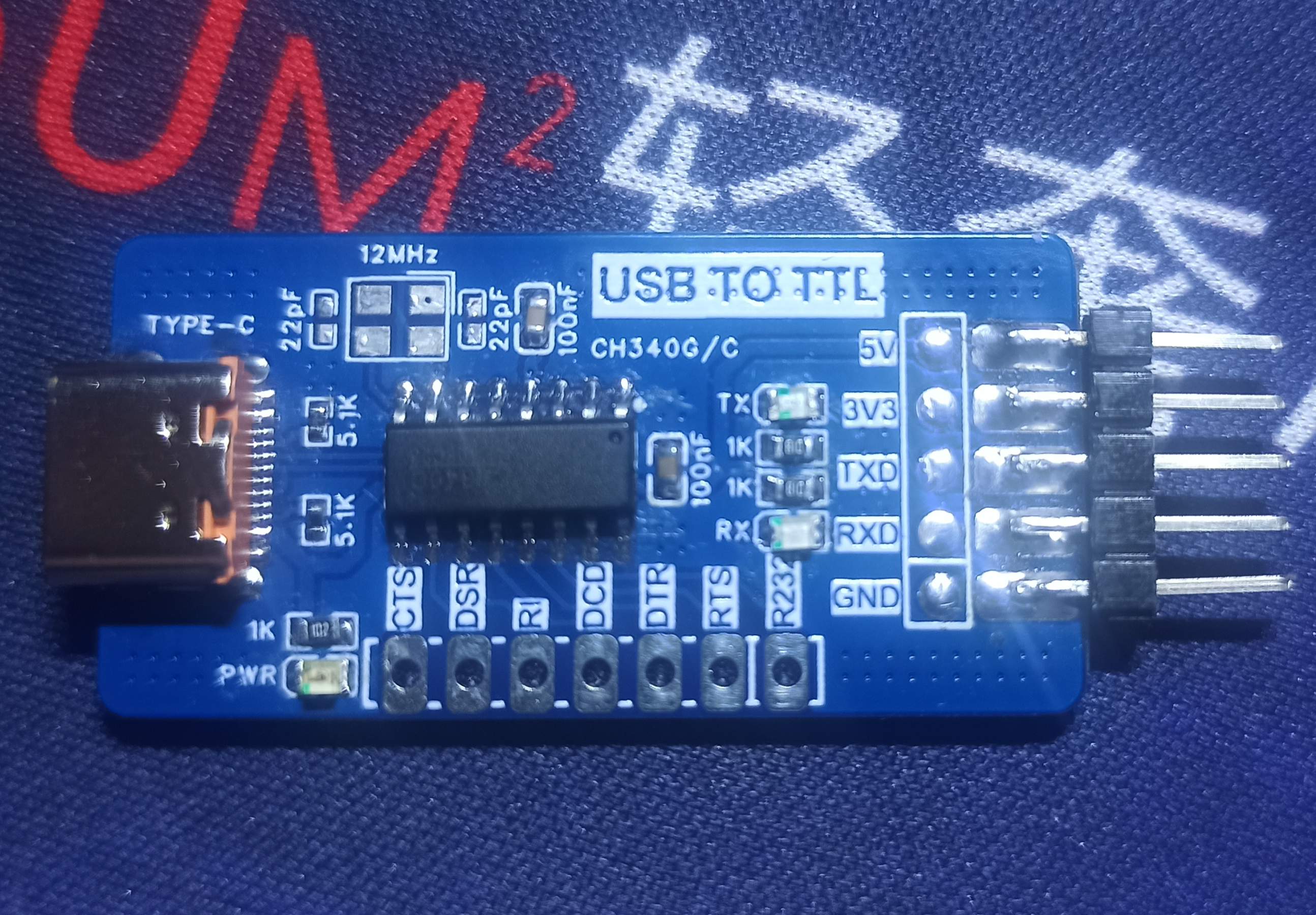

[DIY] USB to TTL converter
USB to TTL communication module
PDF_【Homemade】USB to TTL.zip
Altium_【Homemade】USB to TTL.zip
PADS_【Homemade】USB to TTL.zip
BOM_【Homemade】USB to TTL.xlsx
