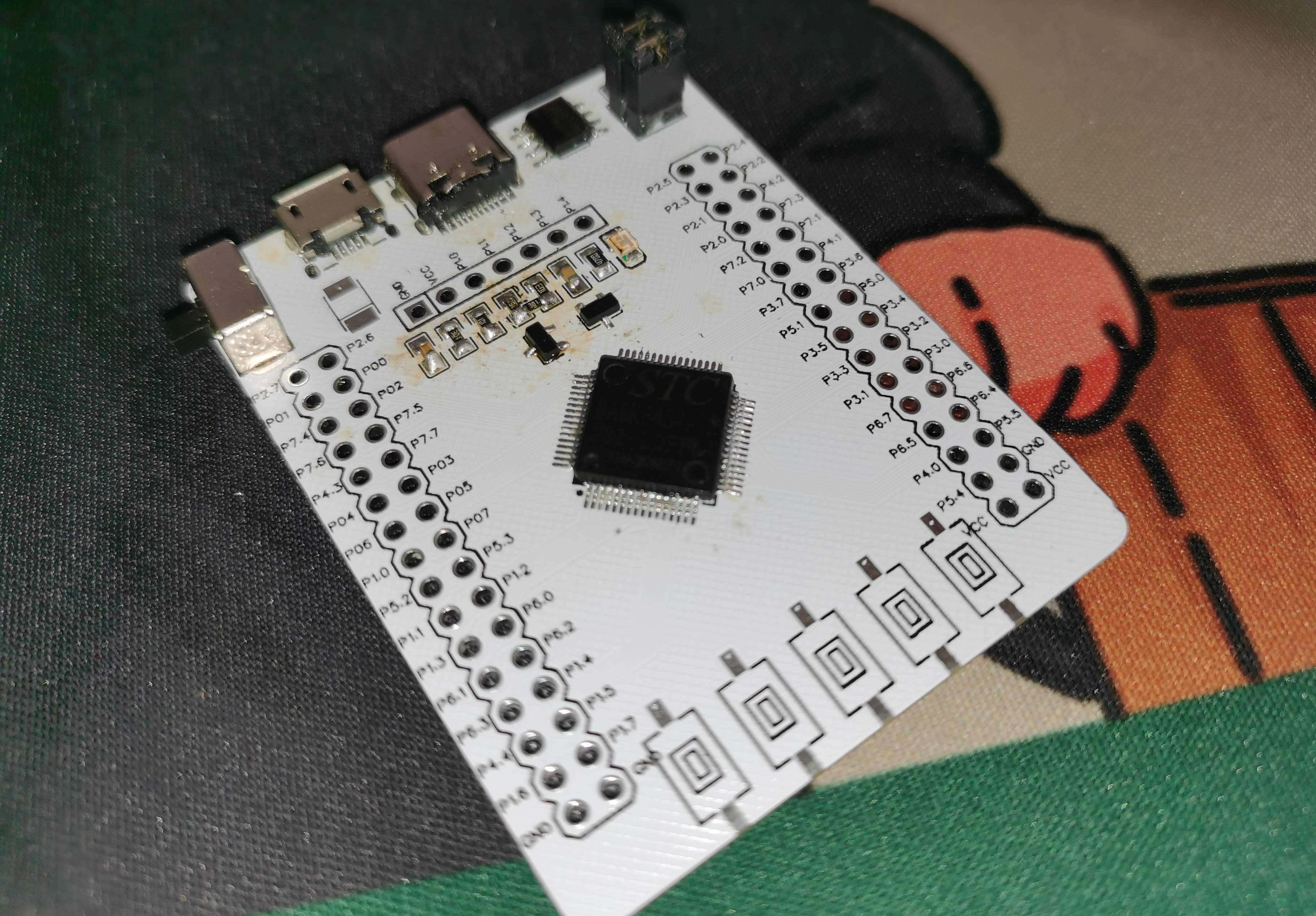

This project uses the smallest system board (with automatic download) made by STC8a8k microcontroller. All pins are lead out, and the interface of the SPI protocol OLED display and five buttons are reserved (P5.4 can be used as a reset button It can also be used for IO) ![Pin.png] ![Button.png] The download chip used in this project is CH340n, and two transistors are used to form an automatic download circuit:
![Auto download circuit.png] Because Considering that MICRO-USB data cables are often forgotten, MICRO-USB and TYPE-C were designed! [QQ screenshot 20220102142048.png]
