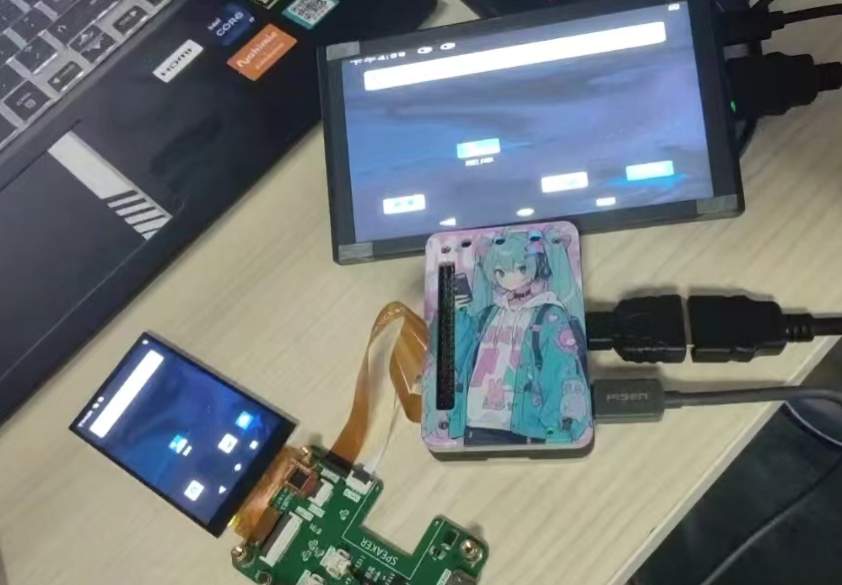

While waiting for the delivery, I tinkered with a small screen.
For the specific tinkering process, you can refer to the project of the expert [Taishanpai 3.1-inch screen expansion board](https://oshwhub.com/fengmoxi/tai-shan-pai-3-1-cun-ping-mu-kuo-zhan-ban).
The final result is also awesome.

### Screen porting
is similar to the adapter board, using a readily available 6-inch screen porting solution (the universal copy method).
Related materials have been open-sourced by a developer, see [Gitee](https://gitee.com/fengmoxi/tspi-stl6_0_1_2_a)
#### Patch file usage
// Download the patch file to the same directory as the SDK
wget https://gitee.com/fengmoxi/tspi-stl6_0_1_2_a/raw/master/linux-kernel-STL6_0_1_2_A.patch
// Linux SDK
patch -p1 -N -d tspi
- If you encounter a problem like `Hunk #1 FAILED at xxx(different line endings).`, please use `dos2unix` to convert the format of the corresponding file.
sudo apt install dos2unix
dos2unix tspi_linux_sdk/kernel/arch/arm64/boot/dts/rockchip/tspi-rk3566-dsi-v10.dtsi
#### Brief Description of Touch Driver
1. Set the content of the `gtp_dat_9_7` array in `/kernel/drivers/input/touchscreen/gt9xx/gt9xx_cfg.h` to
#include "GT970_Config_20240119_160927.cfg"
2. Copy `GT970_Config_20240119_160927.cfg` to `/kernel/drivers/input/touchscreen/gt9xx`.
