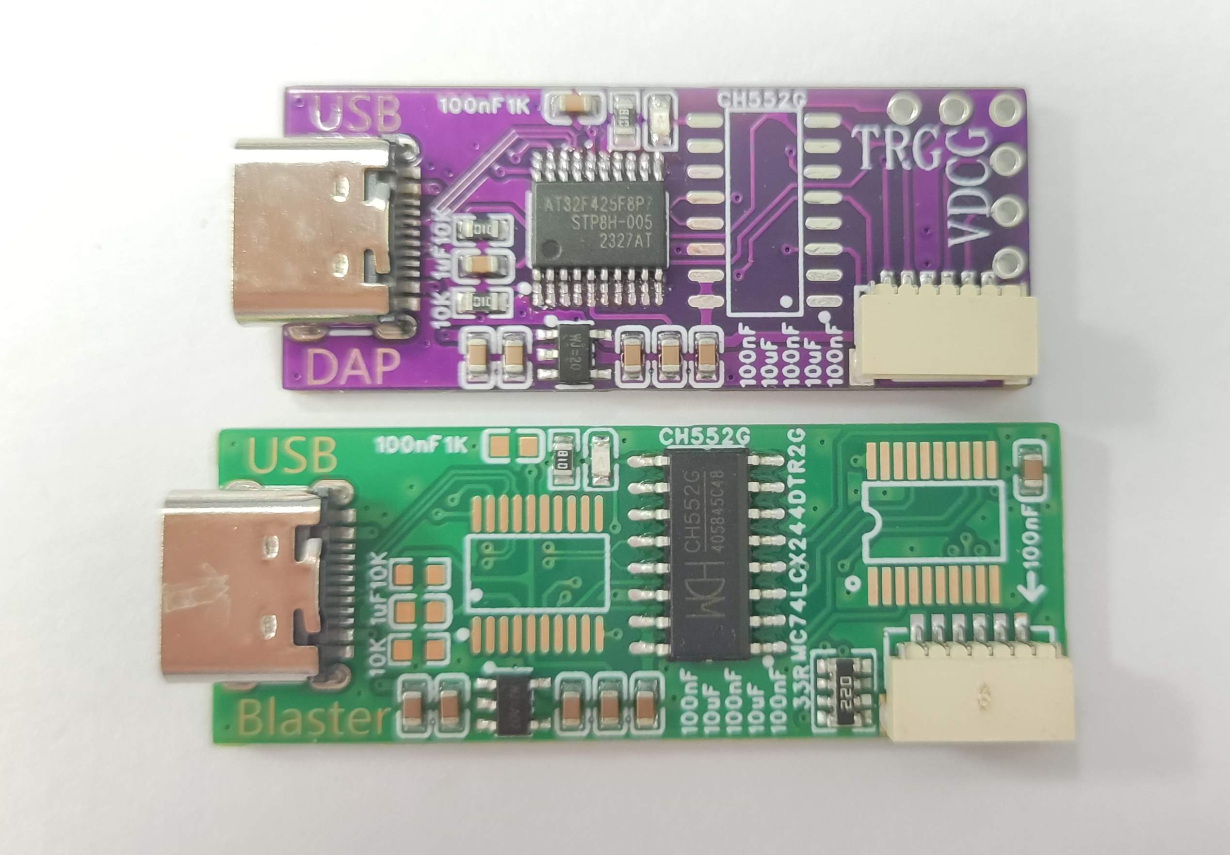

CMSIS-DAP
The CH552AT32F425 is compatible with the DAP solution; either one can be soldered.
Reference links: https://oshwhub.com/xivn1987/daplink, https://oshwhub.com/lengyuefeng/a7c57e6d86bd47789178df3fda9219dc
Firmware source code: https://github.com/XIVN1987/DAPLink
When using the AT32F425 solution, do not solder: U7, SW1, SW2, C23, C28, R8.
When using the CH552G solution, do not solder: U8, R6, R7, C26, C27.
Programming has been tested and works.
