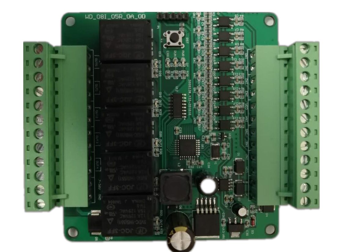

MODBUS Remote I/O Module
Features:
Multi-baud rate support
: Supports 9600, 19200, 38400, 57600, and 115200 baud rates.
Multi-station number support
: Supports broadcasting, with station numbers set from 1 to 255.
Dual watchdog timer
. Imported MCU
: Imported MCU main chip from a major international manufacturer, ensuring more stable performance. High
-quality relays
: Uses high-quality Hongfa relays for superior control.
Standard MODBUS
: Uses the standard MODBUS protocol, supporting Modbus Poll.
Intelligent host computer
: Intelligent host computer, easily handling function configuration and relay control.
Parameters
: Product Model:
WD_08D_05R_0A_0D.

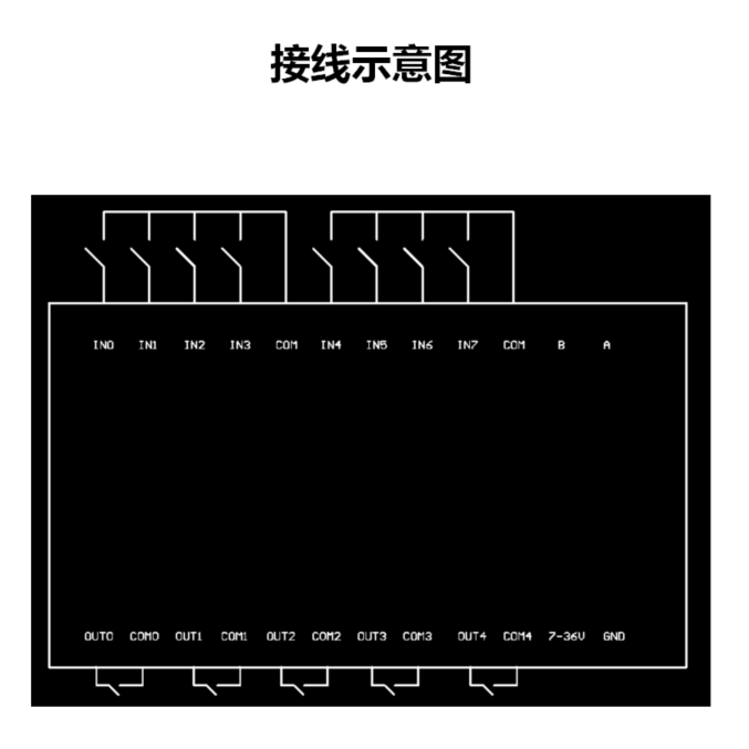

Input signals:
8-channel dry contact input.
Operating power supply
: Wide voltage DC 7~36V,
maximum power consumption
2.5W.
Output method:
5-channel relay output, maximum load per channel 10A.
Communication interface
: RS485 standard Modbus RTU communication protocol .

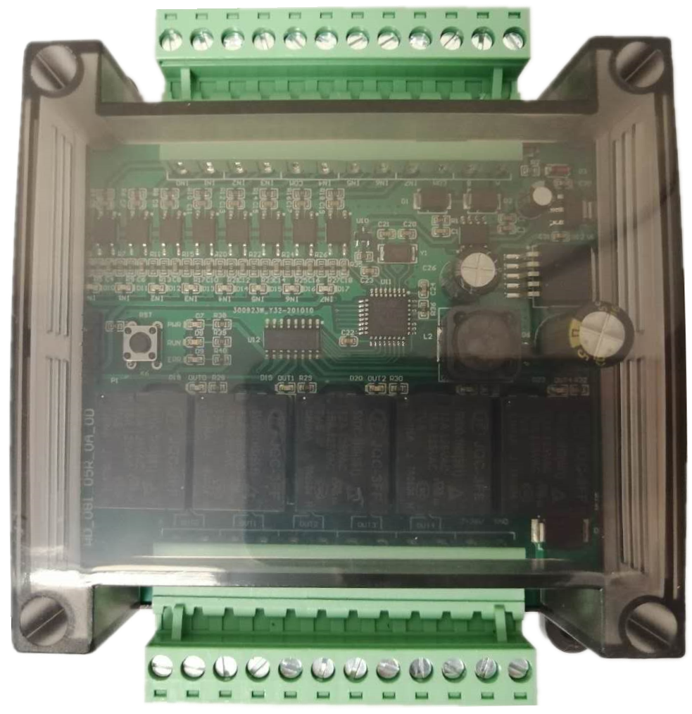

Product dimensions:
95*90*40mm (L*W*H).
Installation dimension:
35mm standard DIN rail slot.

Mode Description:
 Input
Mode: There are two input modes: normal contact and short contact. In normal contact mode, the input is ON when closed and OFF when open. In short contact mode, the state reverses once when the input is closed.
 Control Mode:
There are two control modes: remote and local. In remote mode, inputs and outputs are independent; the user can control the opening and closing of the output via commands
. In local mode, the controller's first 5 input points (IN0~IN4) and 5 output points (OUT0~OUT4) are interconnected; commands cannot control the outputs in this mode. In
remote mode ,
the status is read via commands
: IN0
IN1 IN2 IN3
IN4 IN5 IN6 IN7 . Commands control OUT0 OUT1 OUT2 OUT3 OUT4. In local mode , the status is read via commands: IN0 IN1 IN2 IN3 IN4 IN5 IN6 IN7 OUT0 OUT1 OUT2 OUT3 OUT4. (Applicable enclosure)
