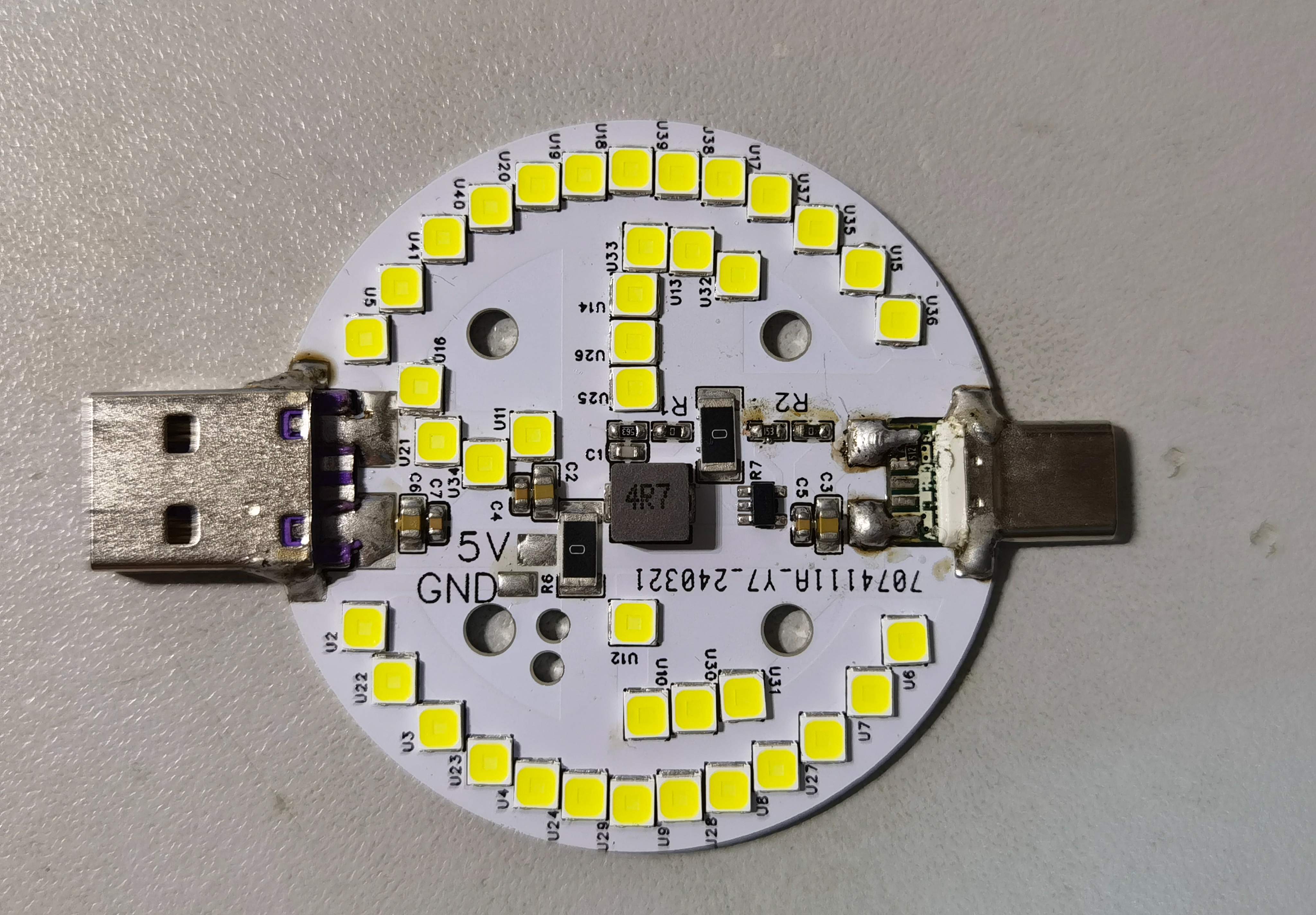

High-brightness, high-efficiency LED portable light with USB-A and Type-C ports

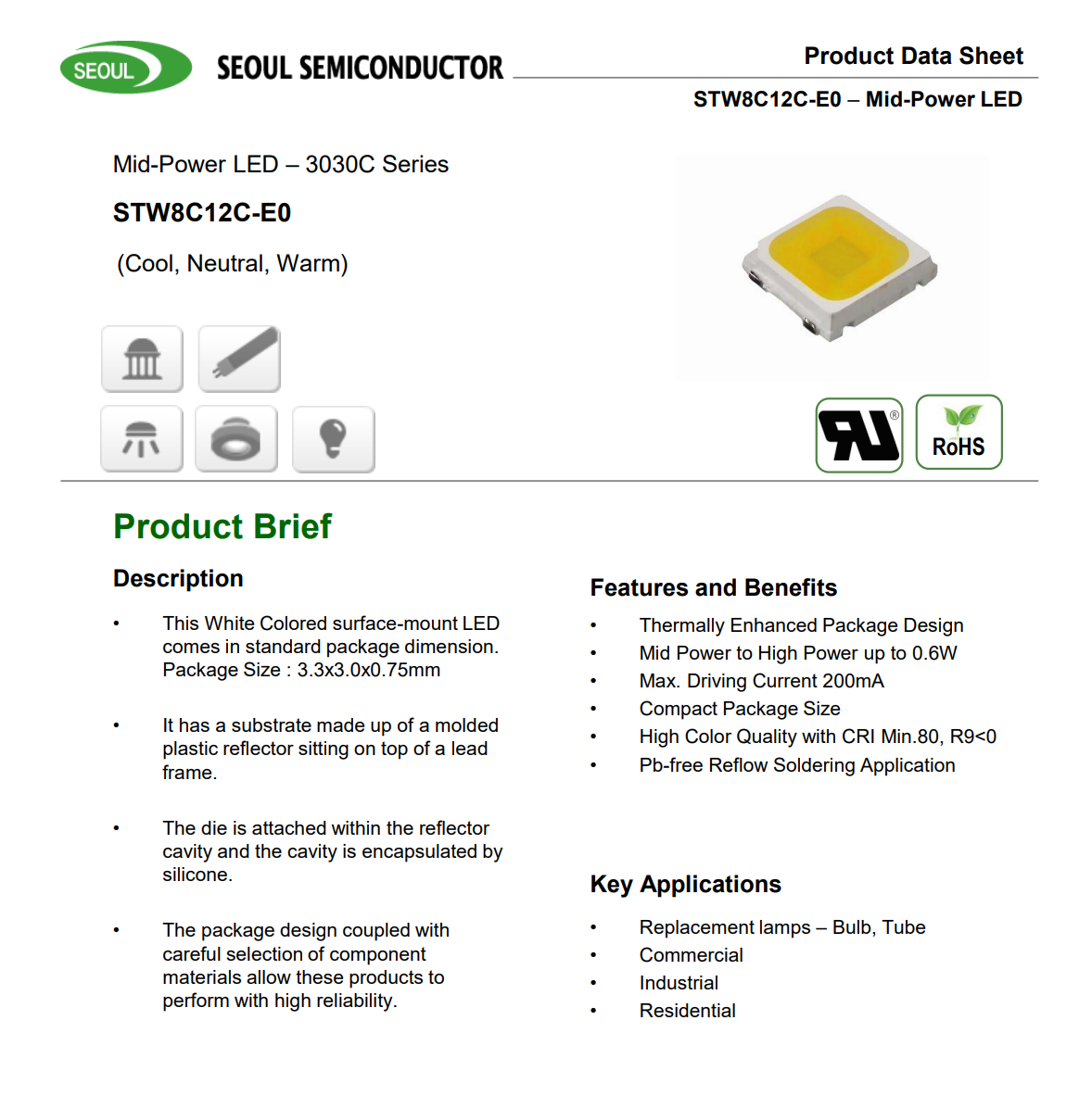

The LEDs are Seoul STW8C12C-E0, available on Taobao. Note the pin package shape.

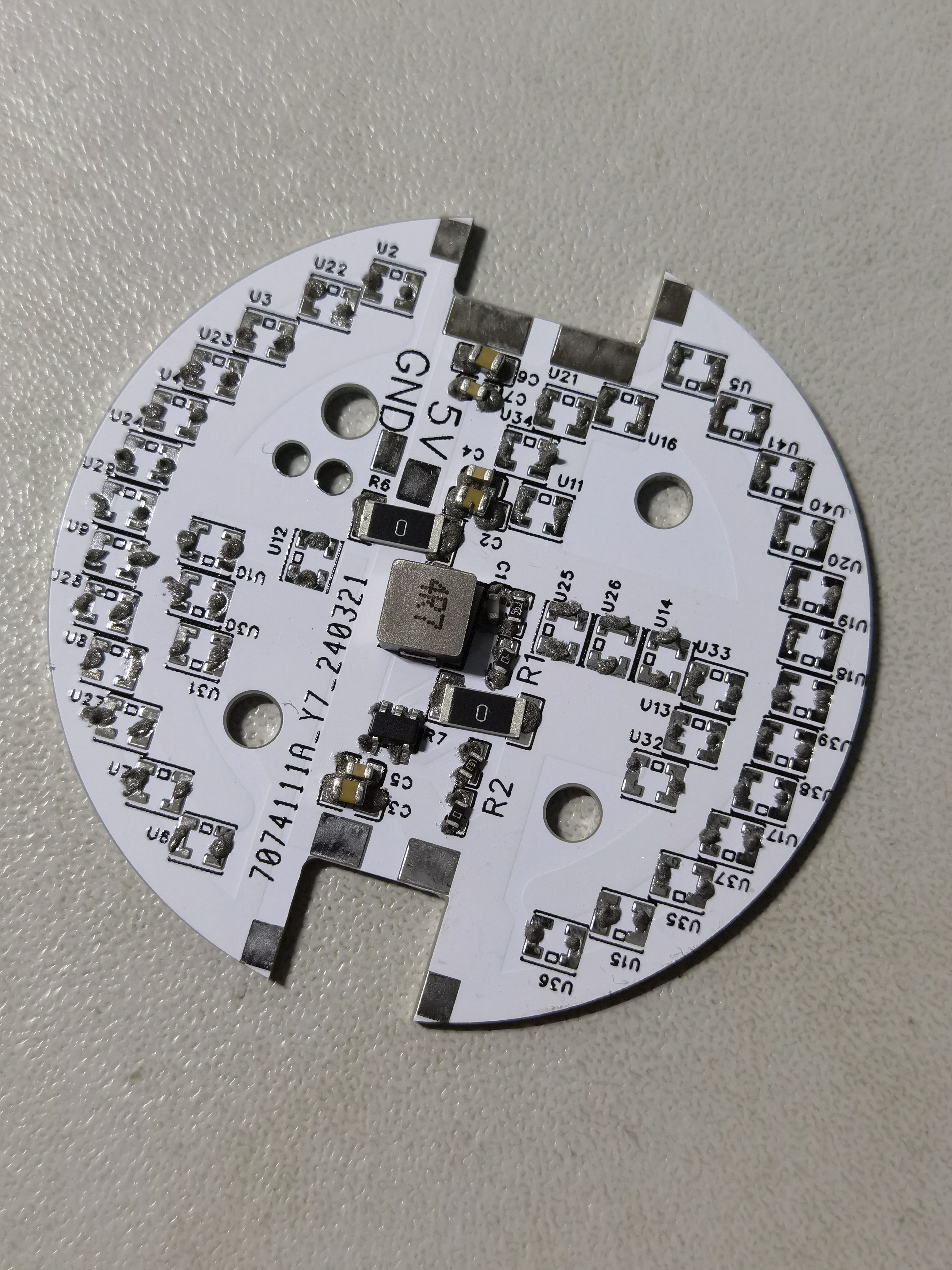

The power chip is a PW2053
Type-C with a built-in board and cc pins. Before soldering, solder a 5.1k resistor between cc and GND.
The USB interface has a convenient soldering shape.

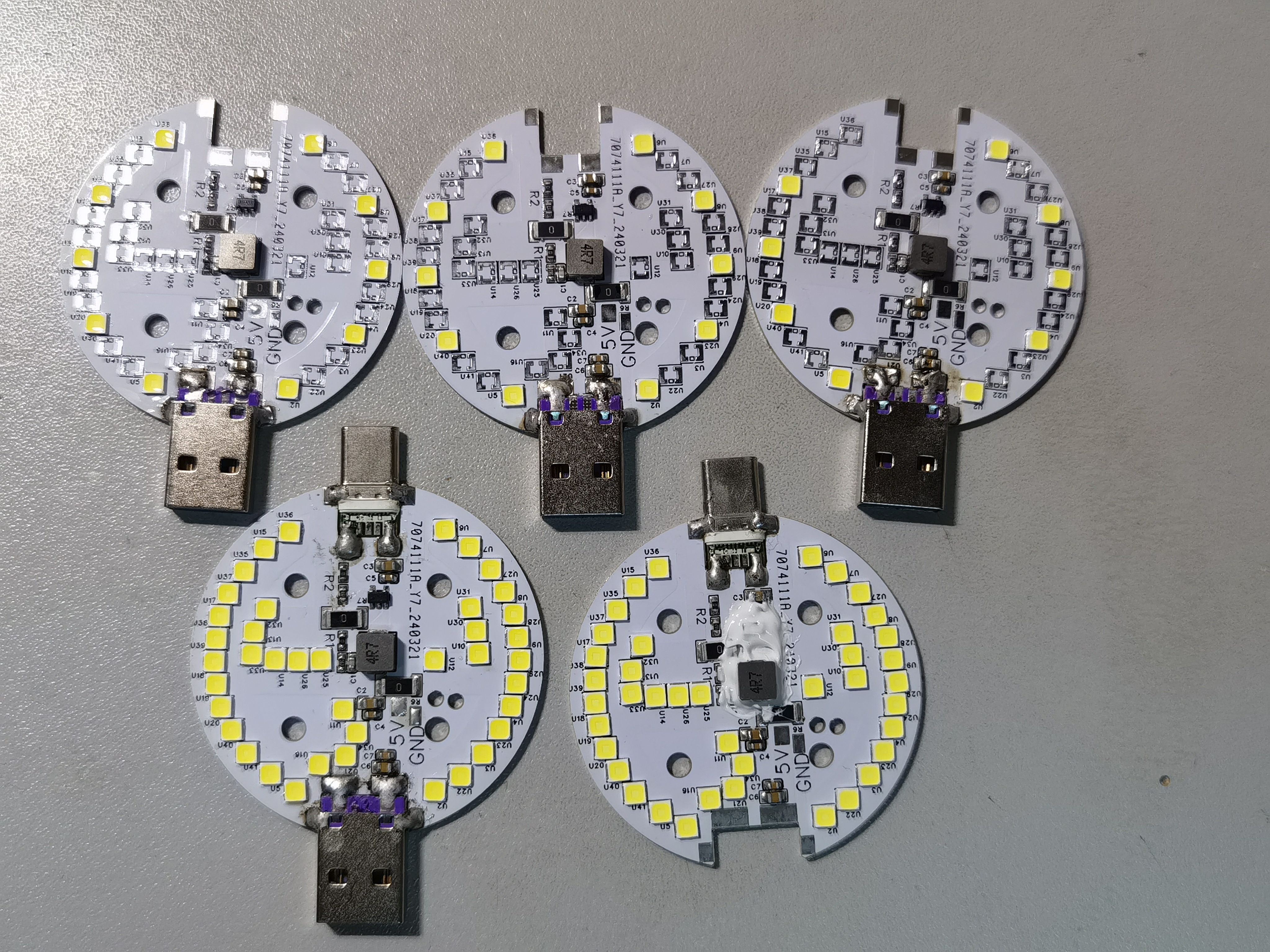

Actual product demonstration. ------------------------------------------------
Actual measurements: When R2=56k and R1=16k, soldering 40 LEDs yields approximately 2.8W.
When R2=56k and R1=15k, soldering 40 LEDs yields approximately 8W. Soldering 10 LEDs yields approximately 3W.
