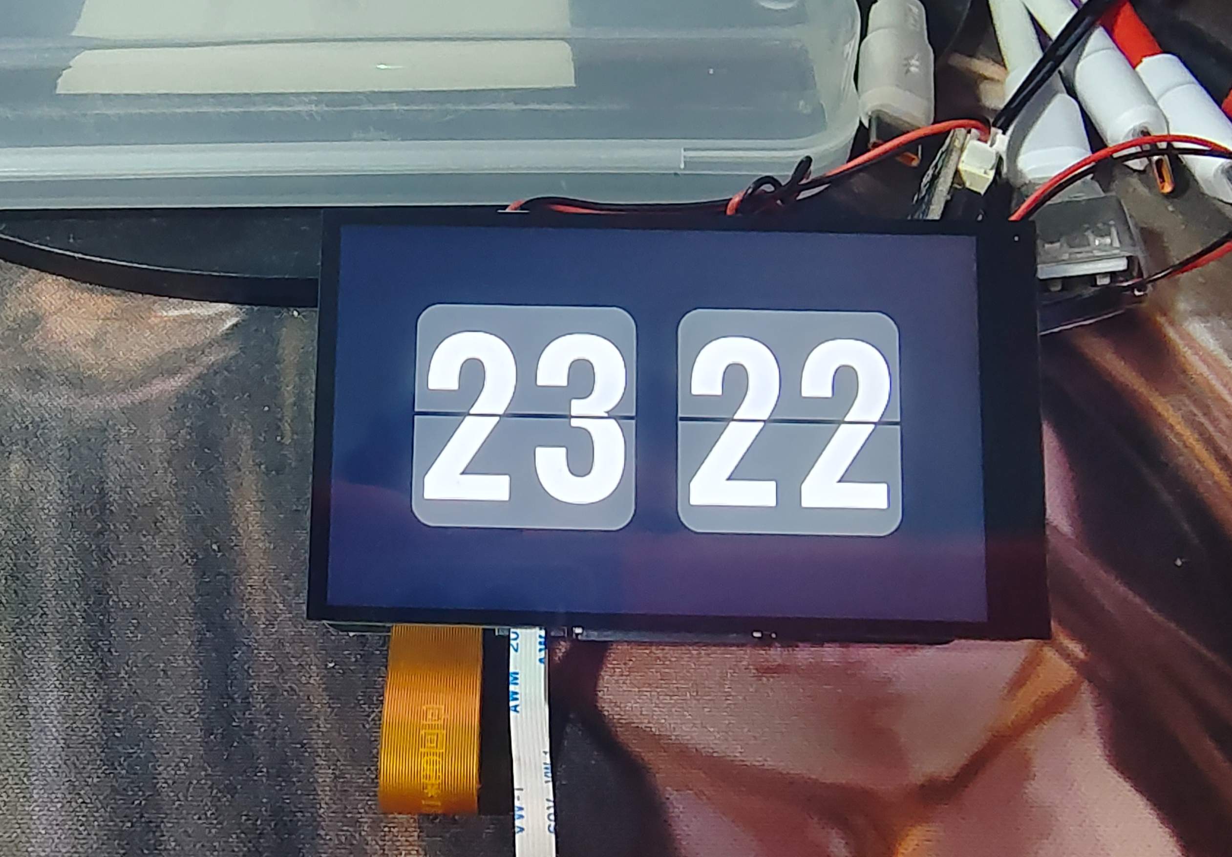

Taishanpai Expansion Board - MIPI Screen Display
This simple phone
expansion board, based on the Taishanpai (a popular Chinese design and construction organization) method, features a 3.1-inch MIPI display, microphone, and speaker ,
running Android.
Check it out on Bilibili: https://b23.tv/PhEOpSZ
**Important Note:
    ** In the spirit of thrift and ease of soldering, this expansion board uses a plug-in mic.
    Therefore, the mic pads on the back of the expansion board will be in close contact with the back of the MIPI screen
    . Since the back of the MIPI screen is a conductor, this can cause a short circuit.
    To prevent short circuits after soldering the mic,
    you can cover the mic pads on the back of the expansion board with a small amount of electrical tape.
