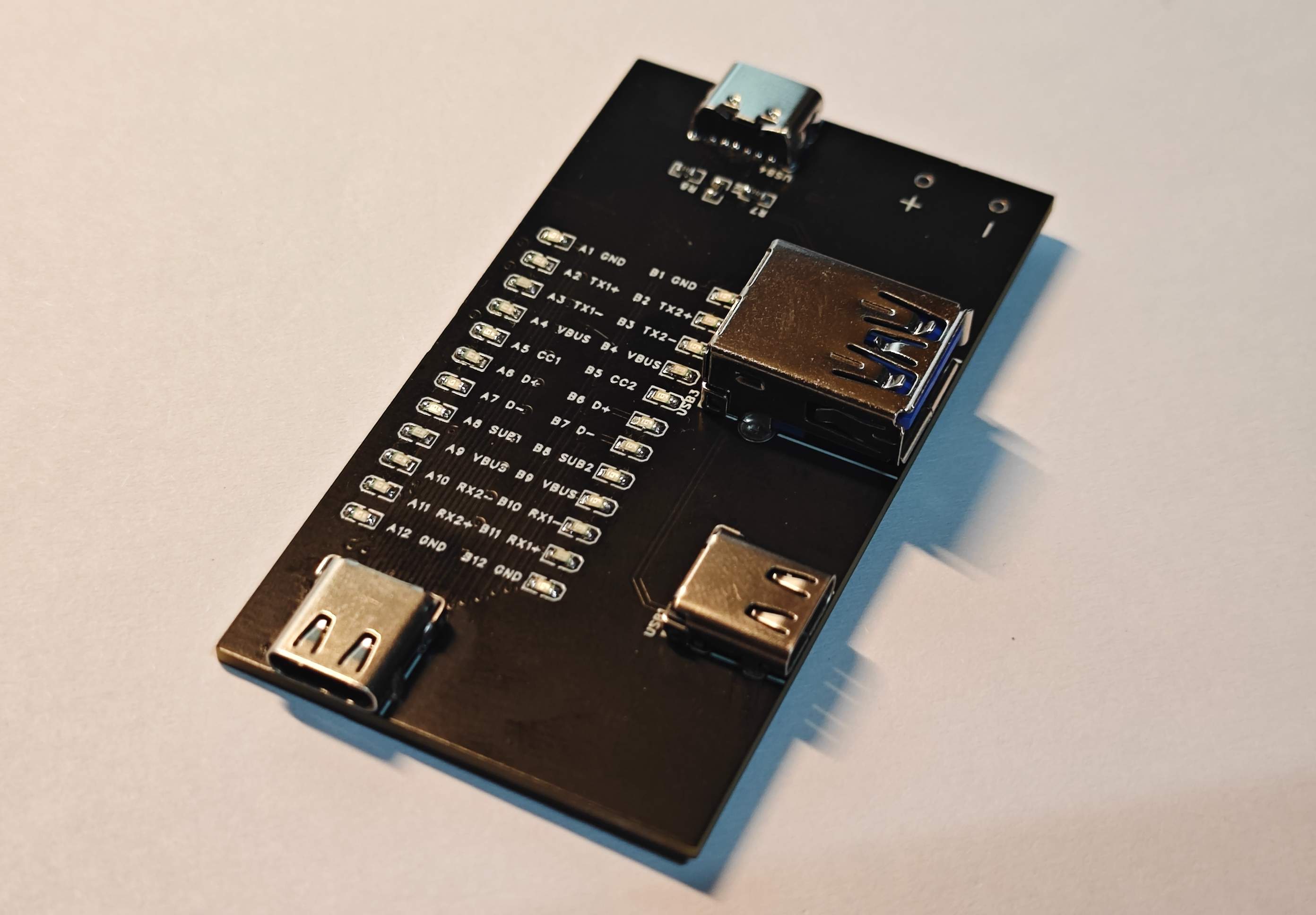

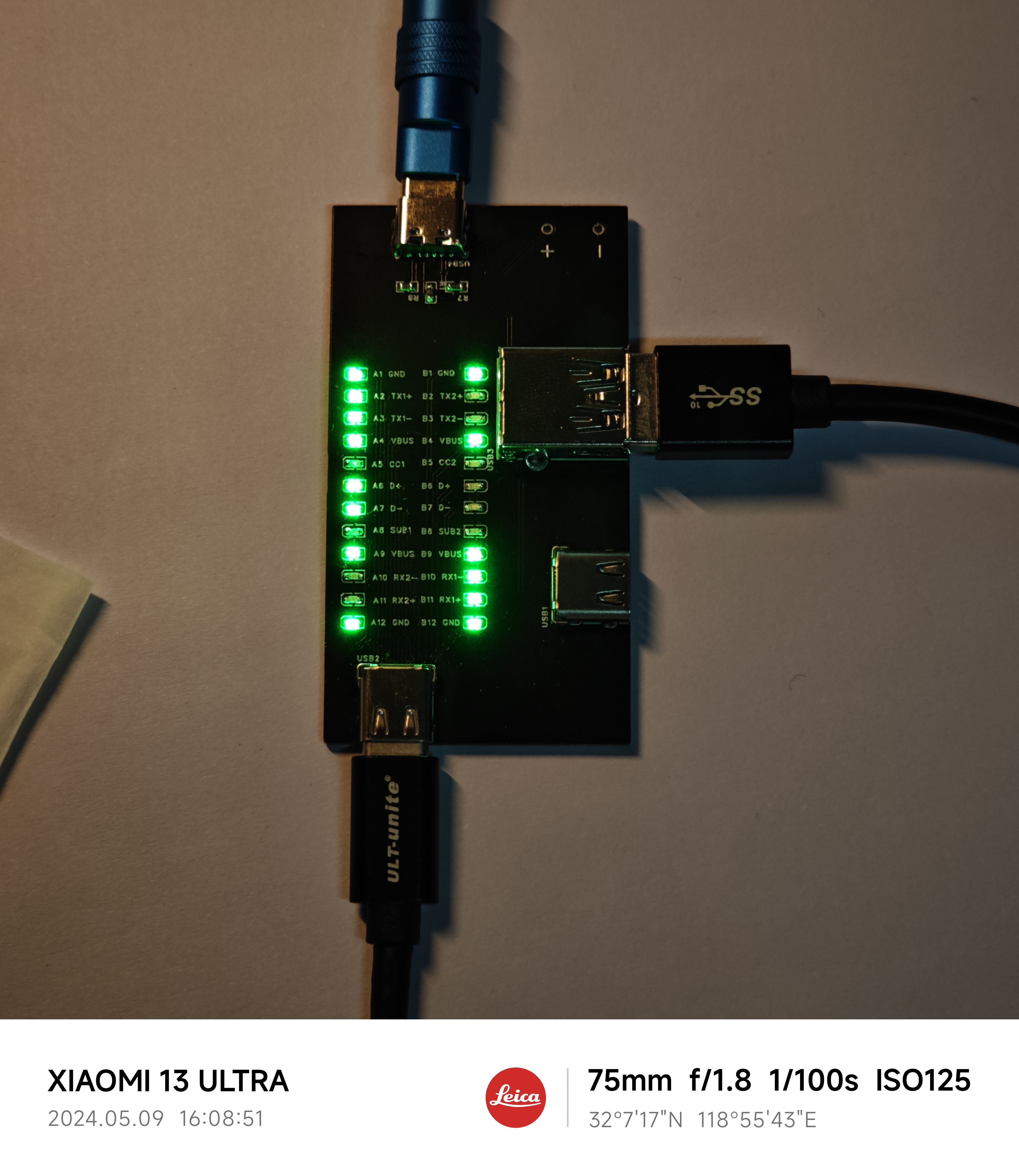

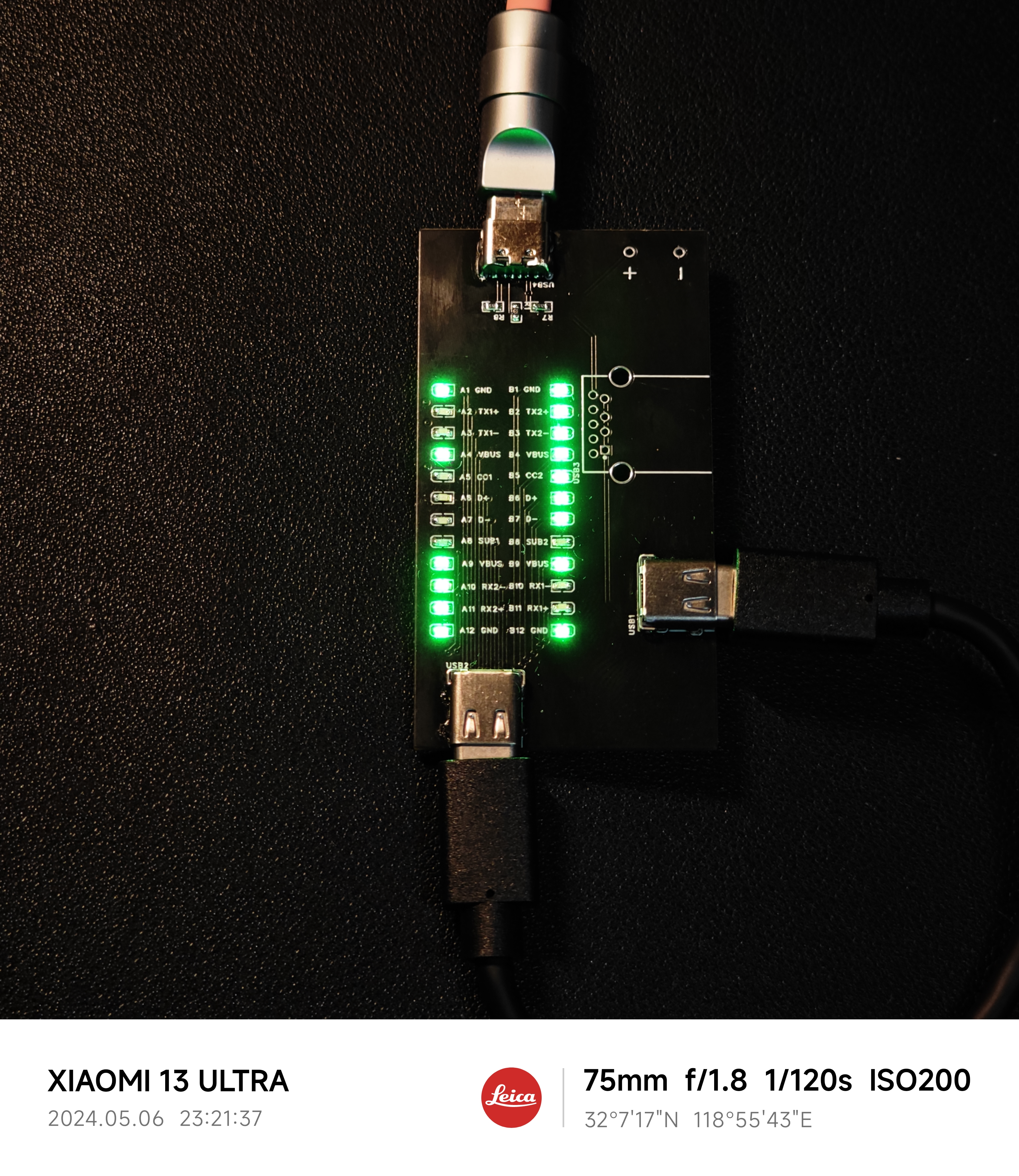

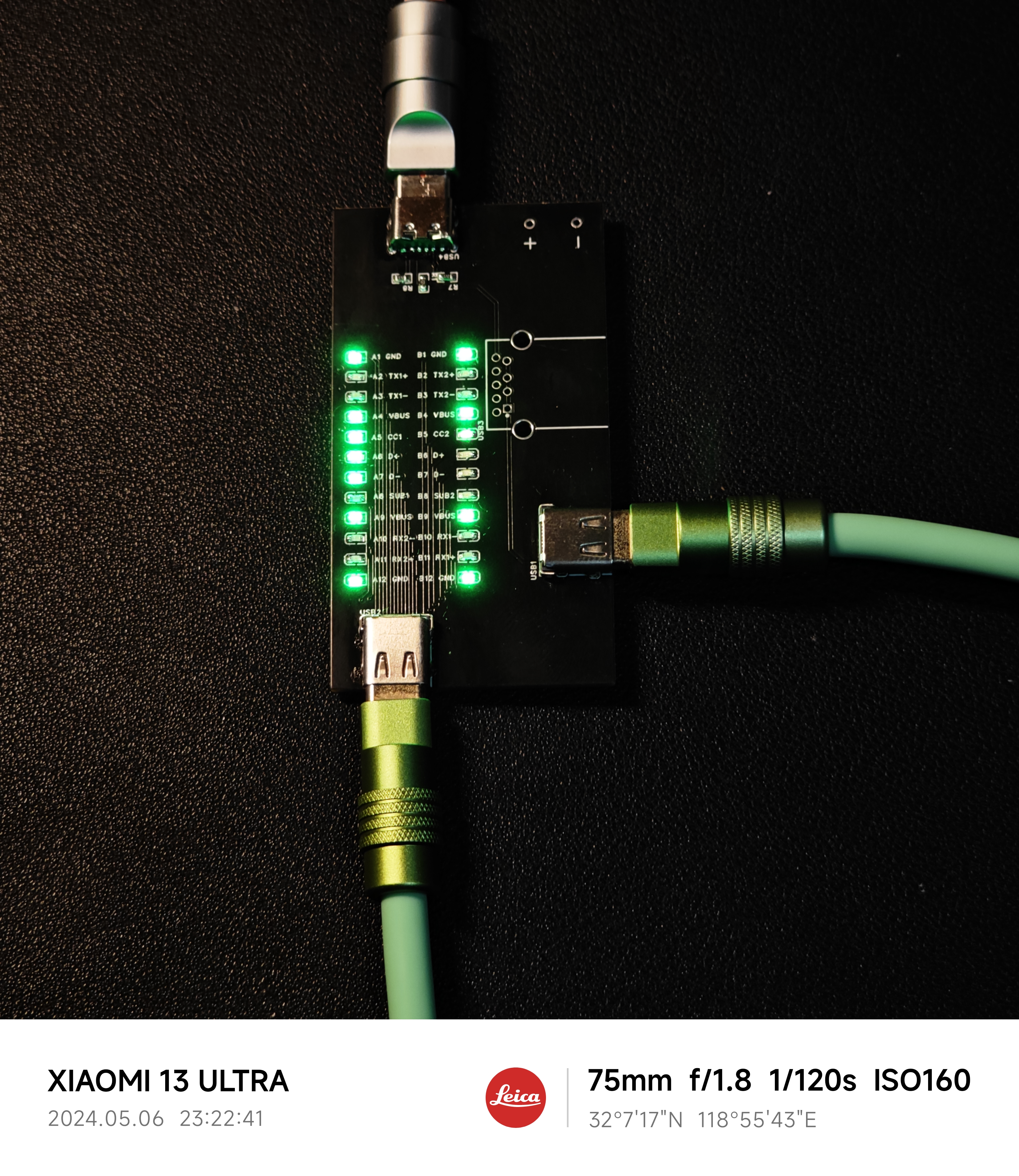

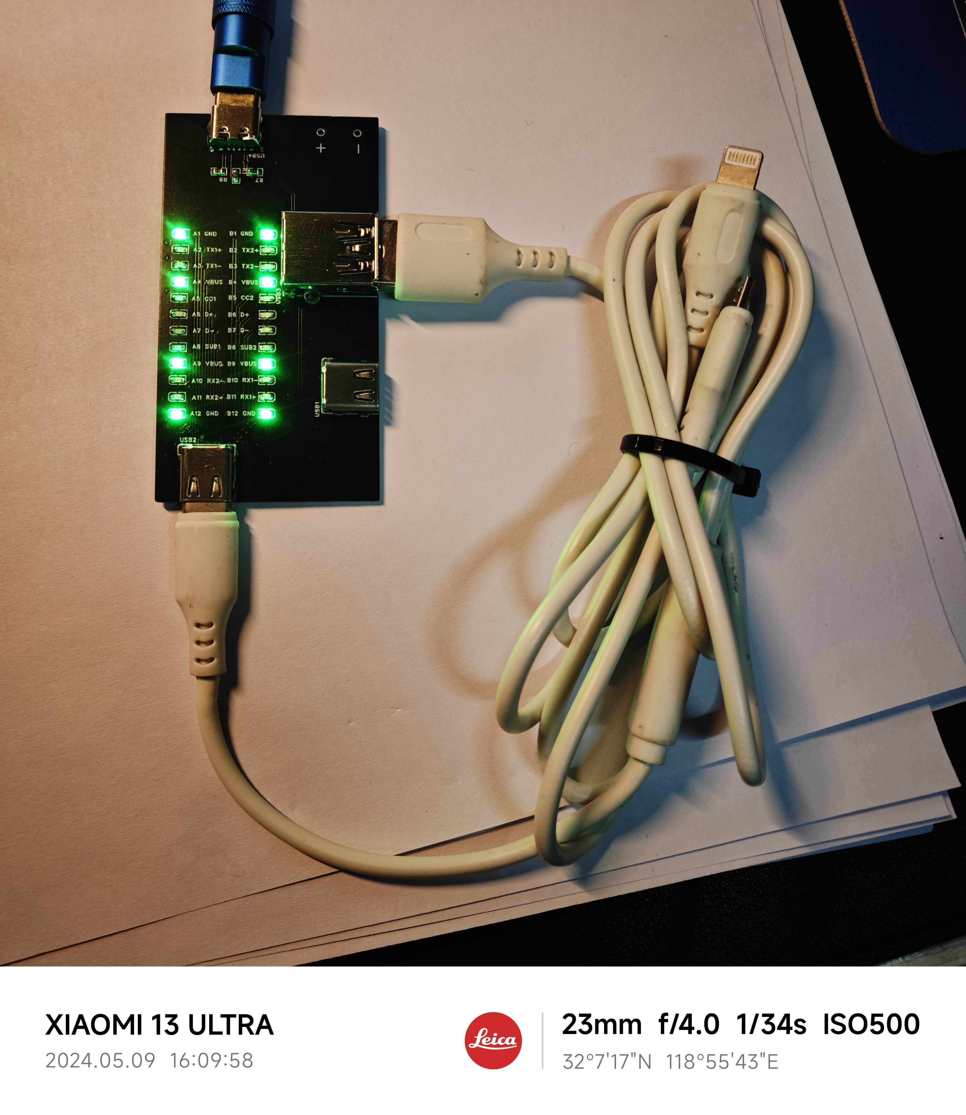

This is a personal project, simply implementing the functionality I wanted, mainly to identify whether a cable has the ability to transmit data or high-speed data transmission. Finished
products are as follows:
Xiaomi 20G cable,
a 10G cable included with a hard drive enclosure,
USB 2.0 CC cable, three-headed junk cable,
10G AC cable.)
