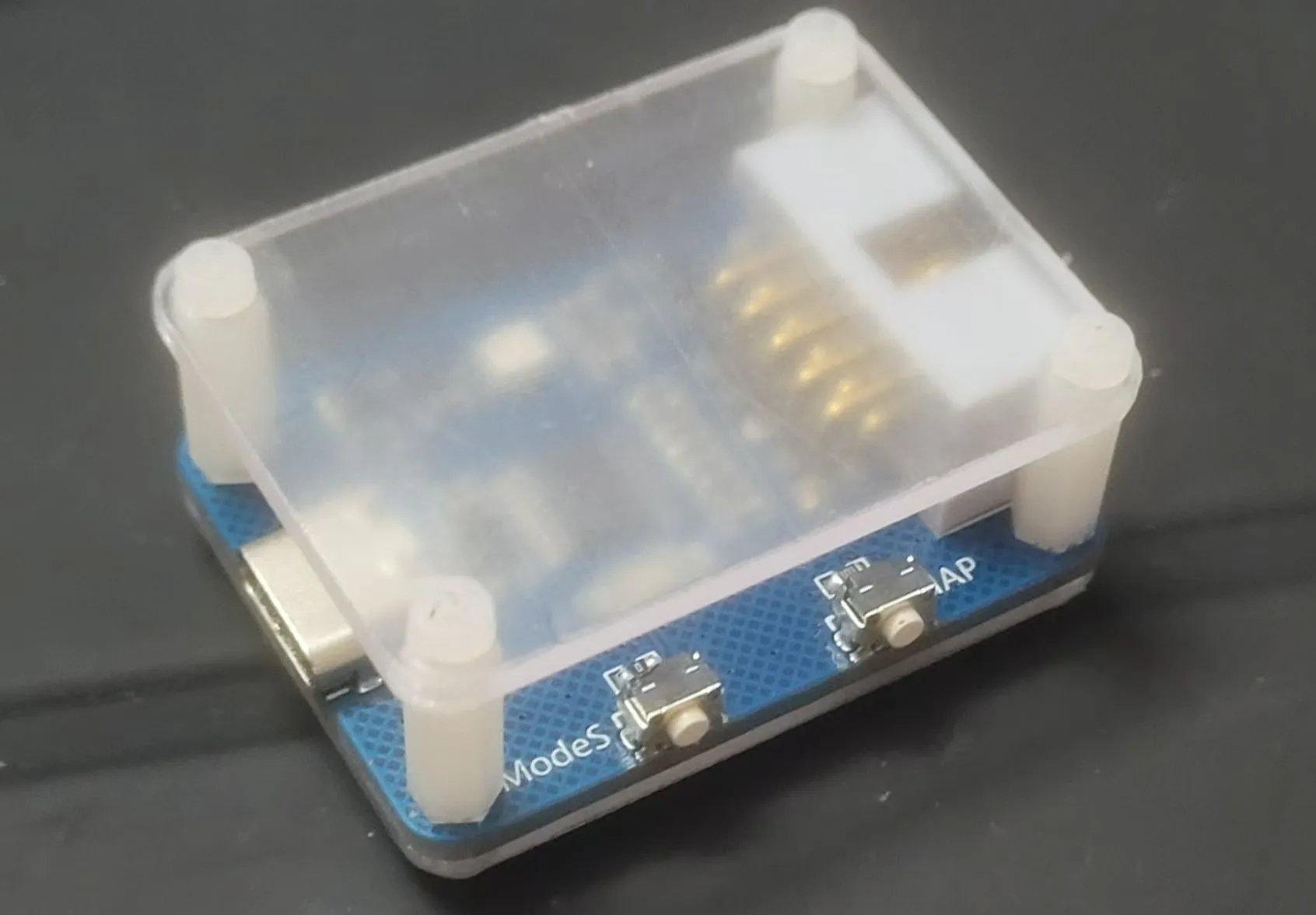

This WCH downloader is identical to the original WCH, but replaces the two independent LEDs with dual-color LEDs for a better visual effect. For
terminals, we recommend Zhengling Precision Machinery terminals, as they are of excellent quality.
It uses a CH32V305 main controller and is designed to work with debuggable CH series microcontrollers, which can also be used as a DAPLINK.
Press and hold the ModeS button while powering on to switch modes.
Super cute downloader! ❤
Firmware download instructions can be found in: High-Speed ​​DAPLINK Downloader Based on CH32V305 - LCSC Open Source Hardware Platform (oshwhub.com).
Design reference: High-Speed ​​DAPLINK Downloader Based on CH32V305 - LCSC Open Source Hardware Platform (oshwhub.com)
