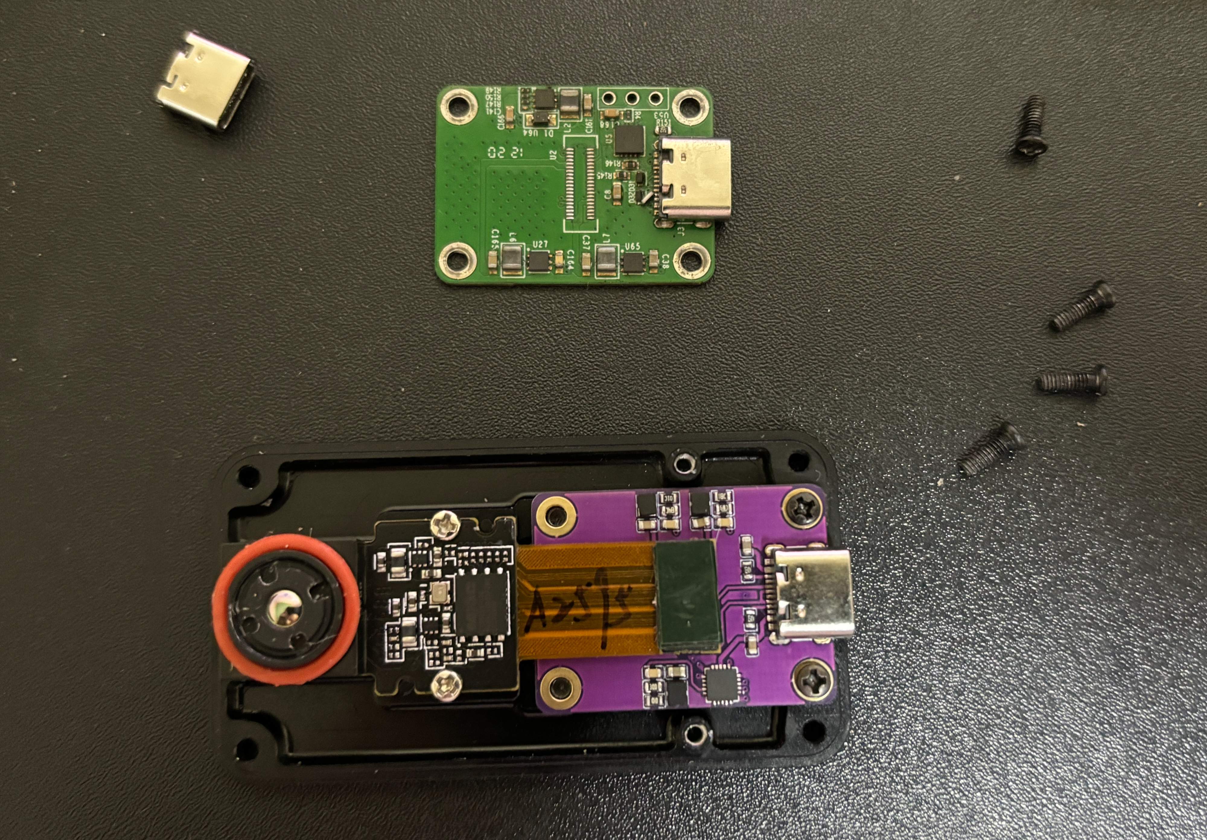

The original power supply module wasn't powerful enough, causing the shutter to fail and resulting in image ghosting. Replacing it with the RY1303 power supply module stabilized the current significantly, solving a major problem.
Note that the board is a 2-layer, 1mm thick board!
