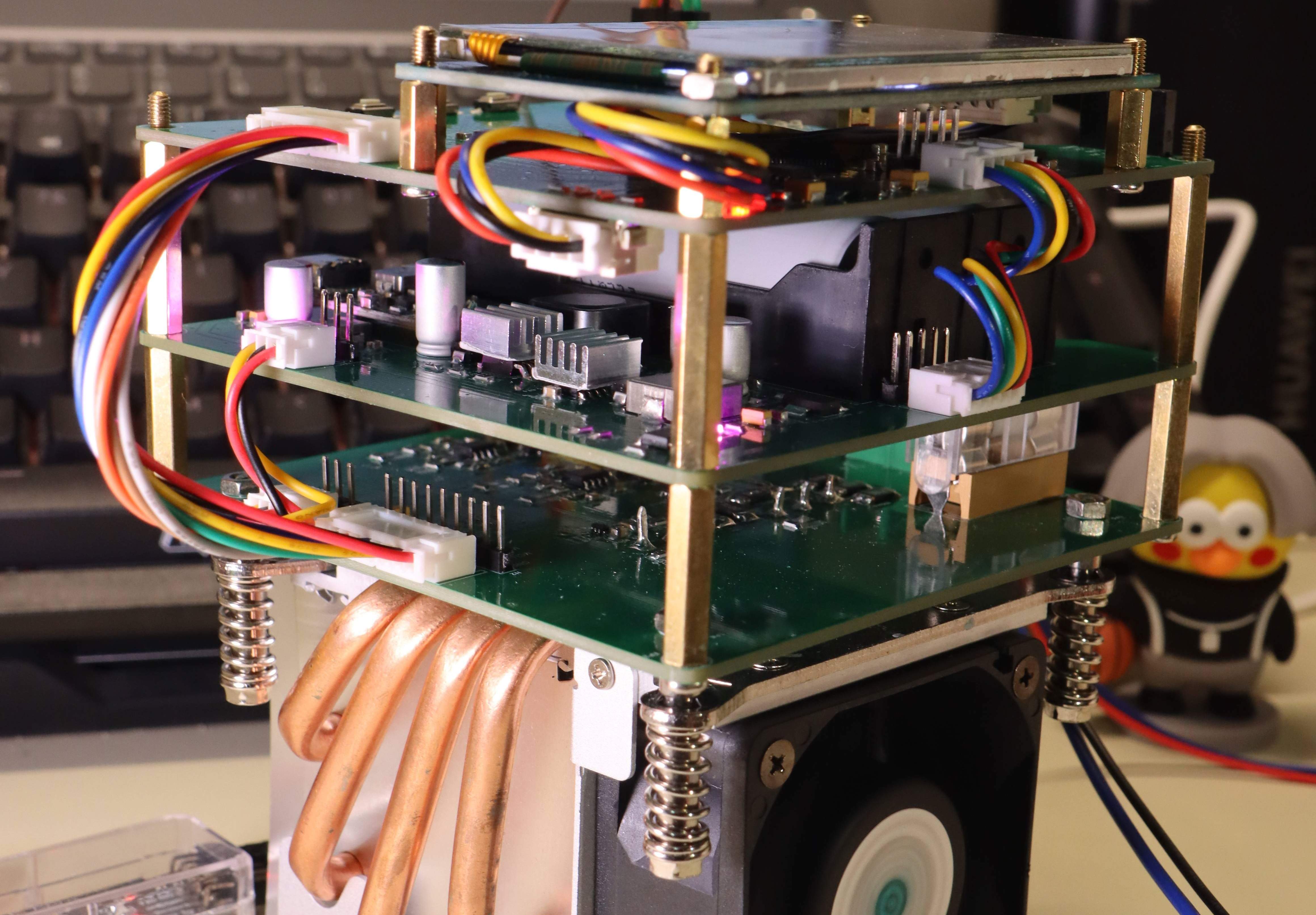

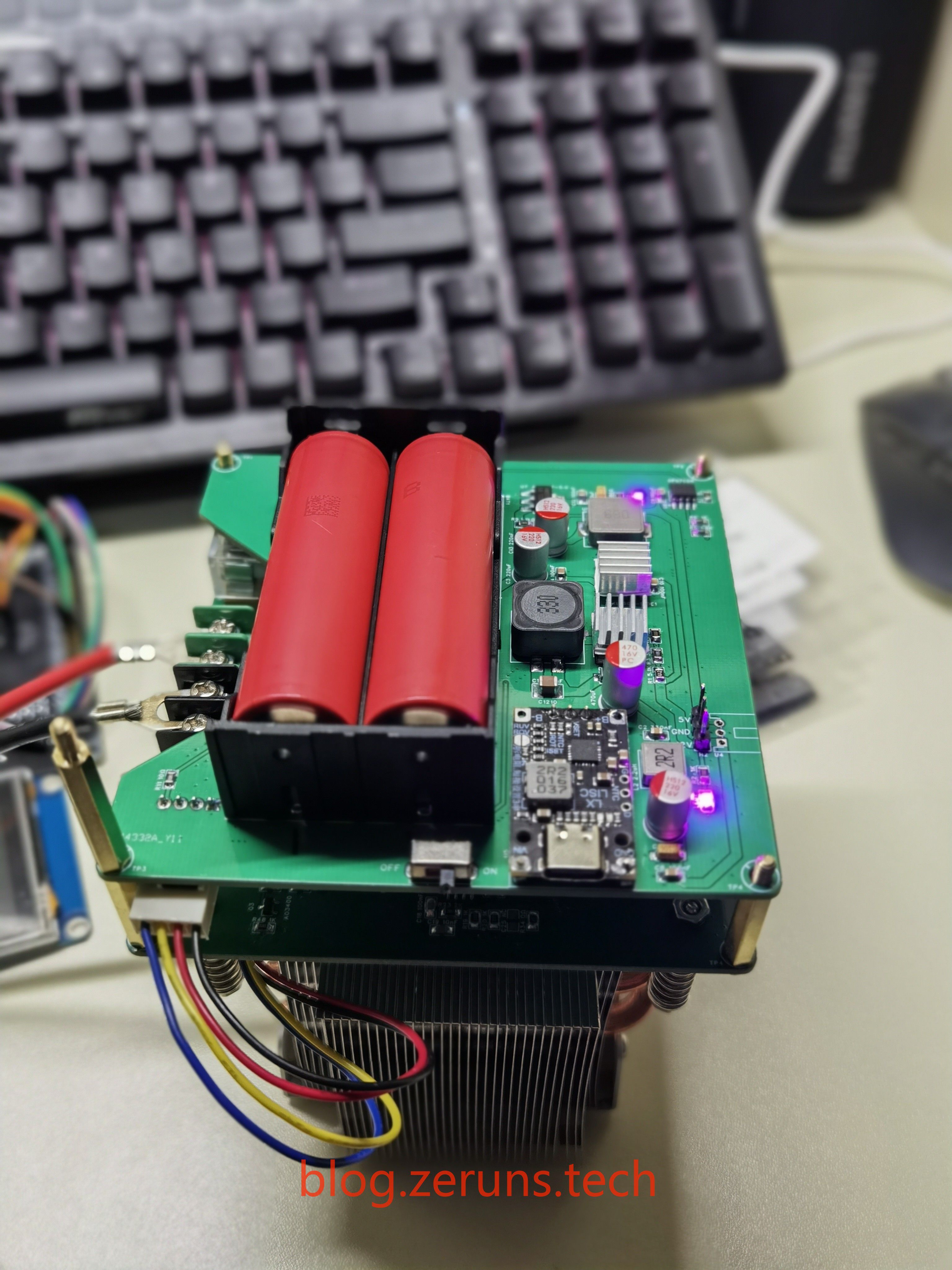

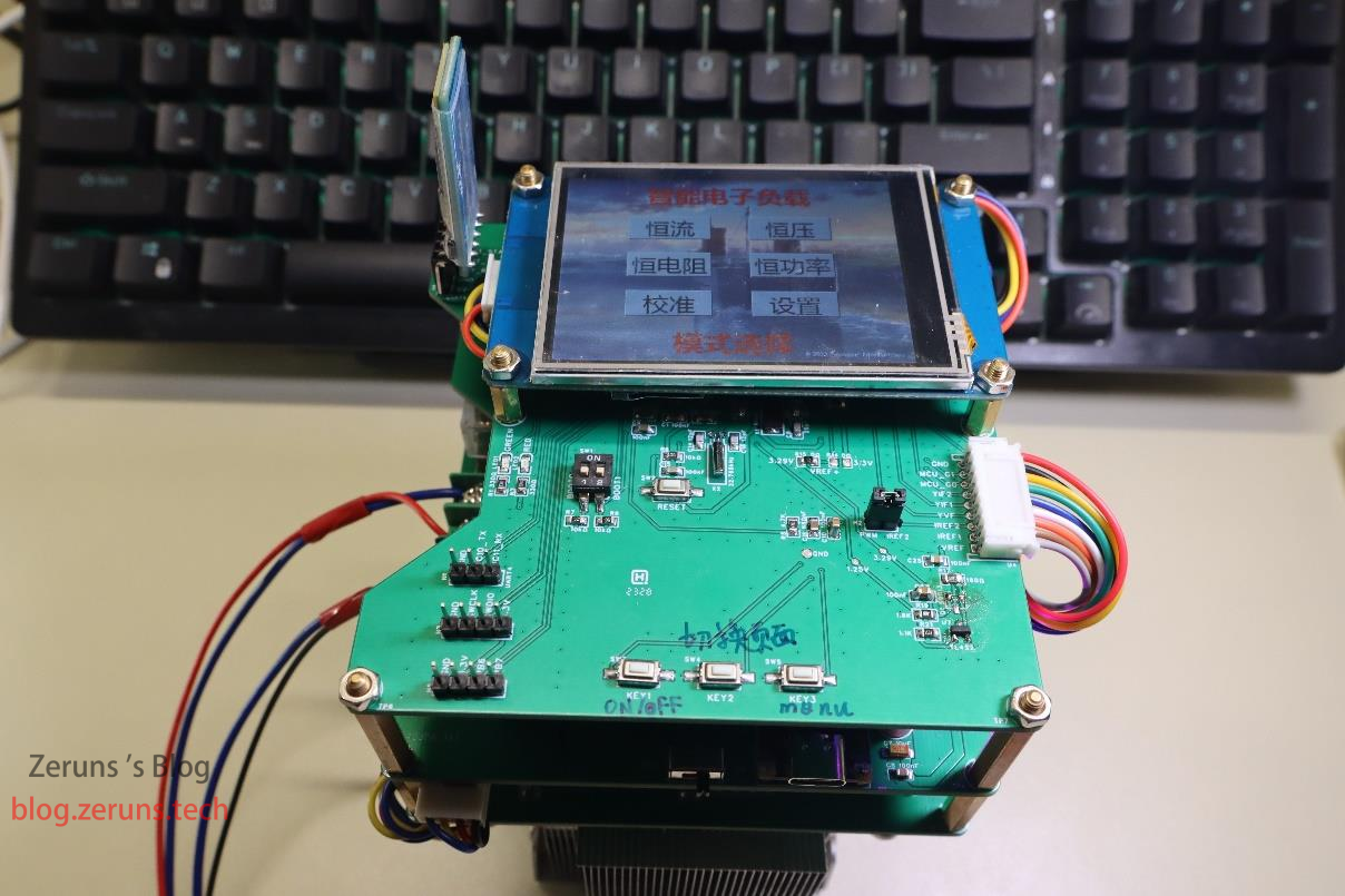

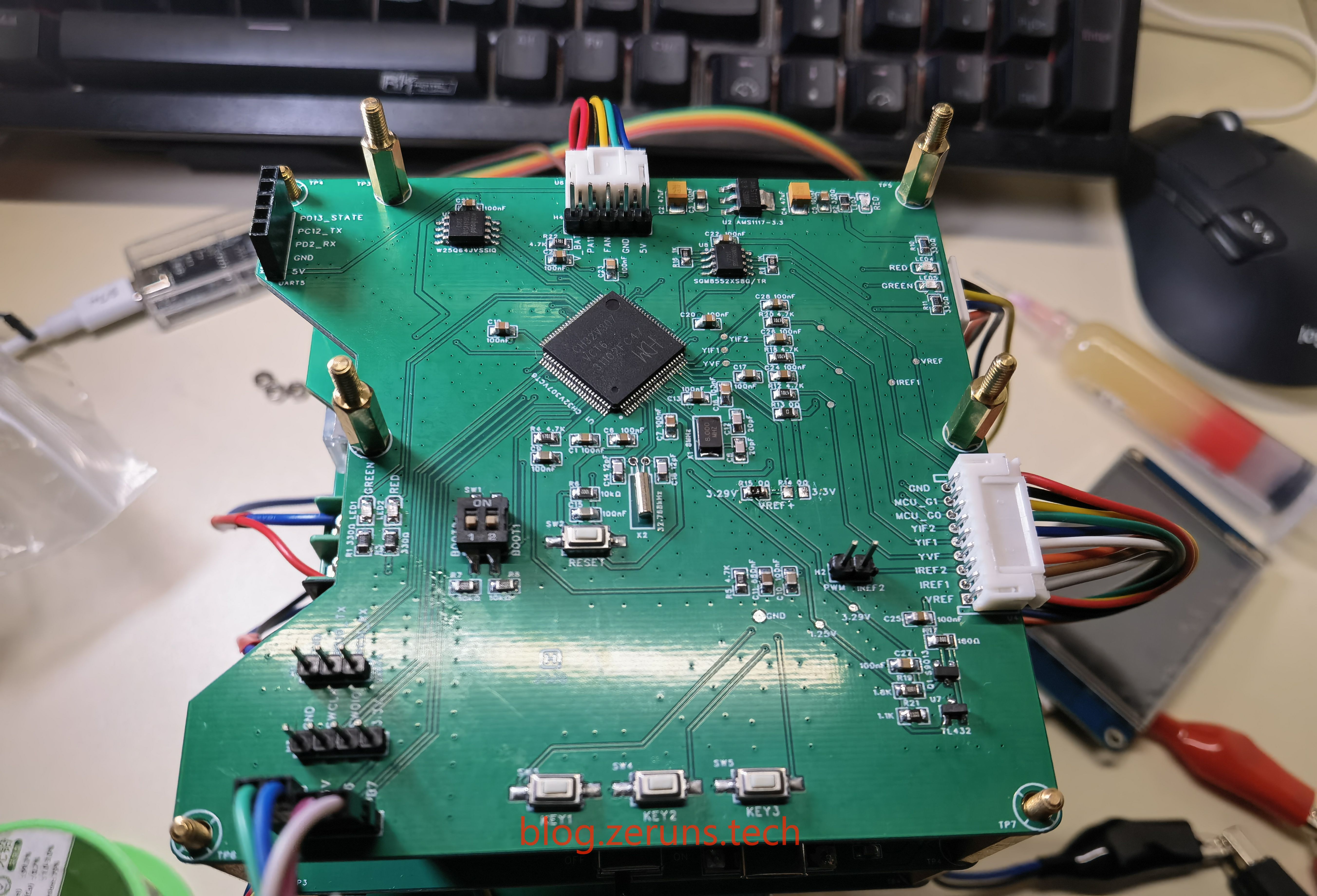

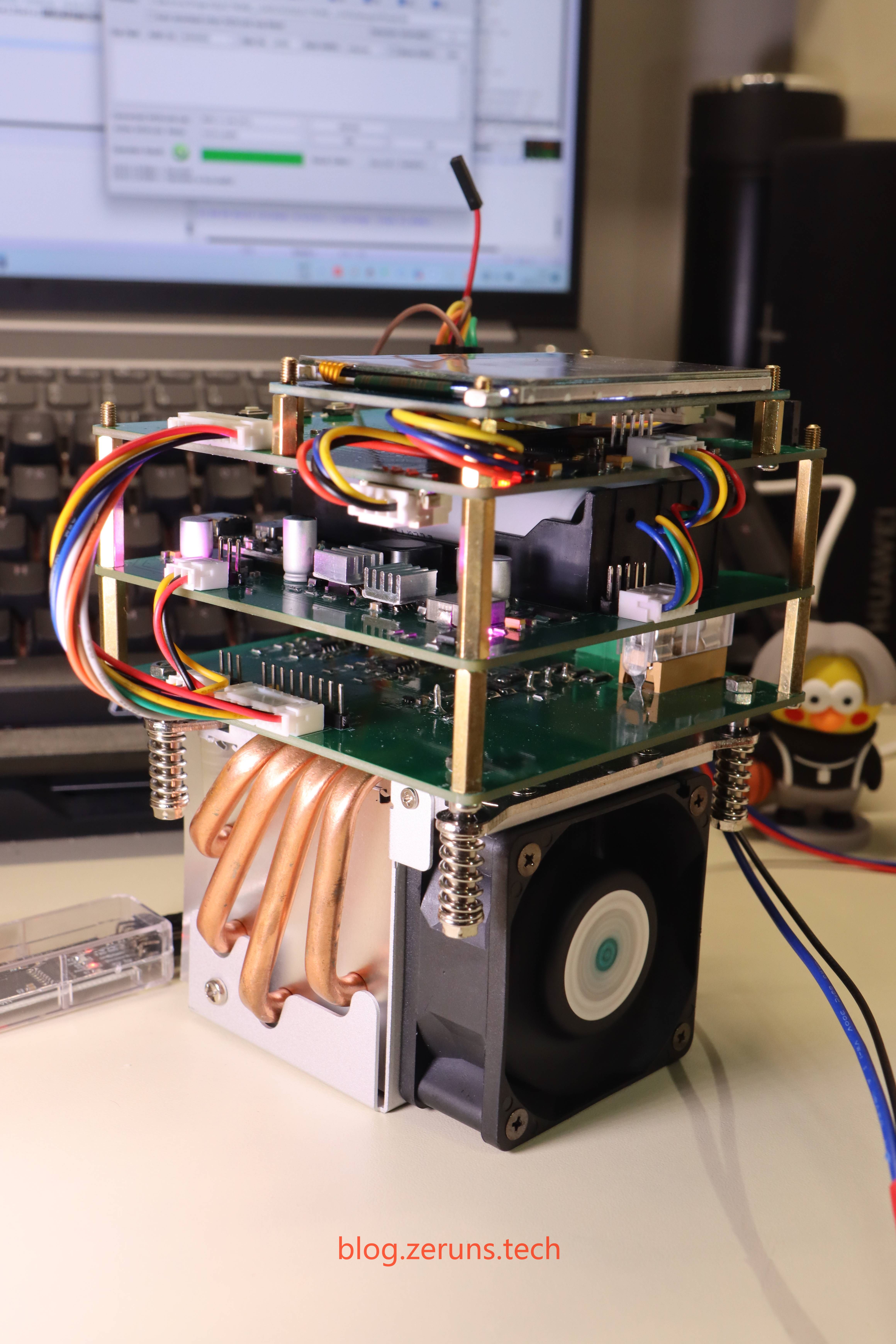

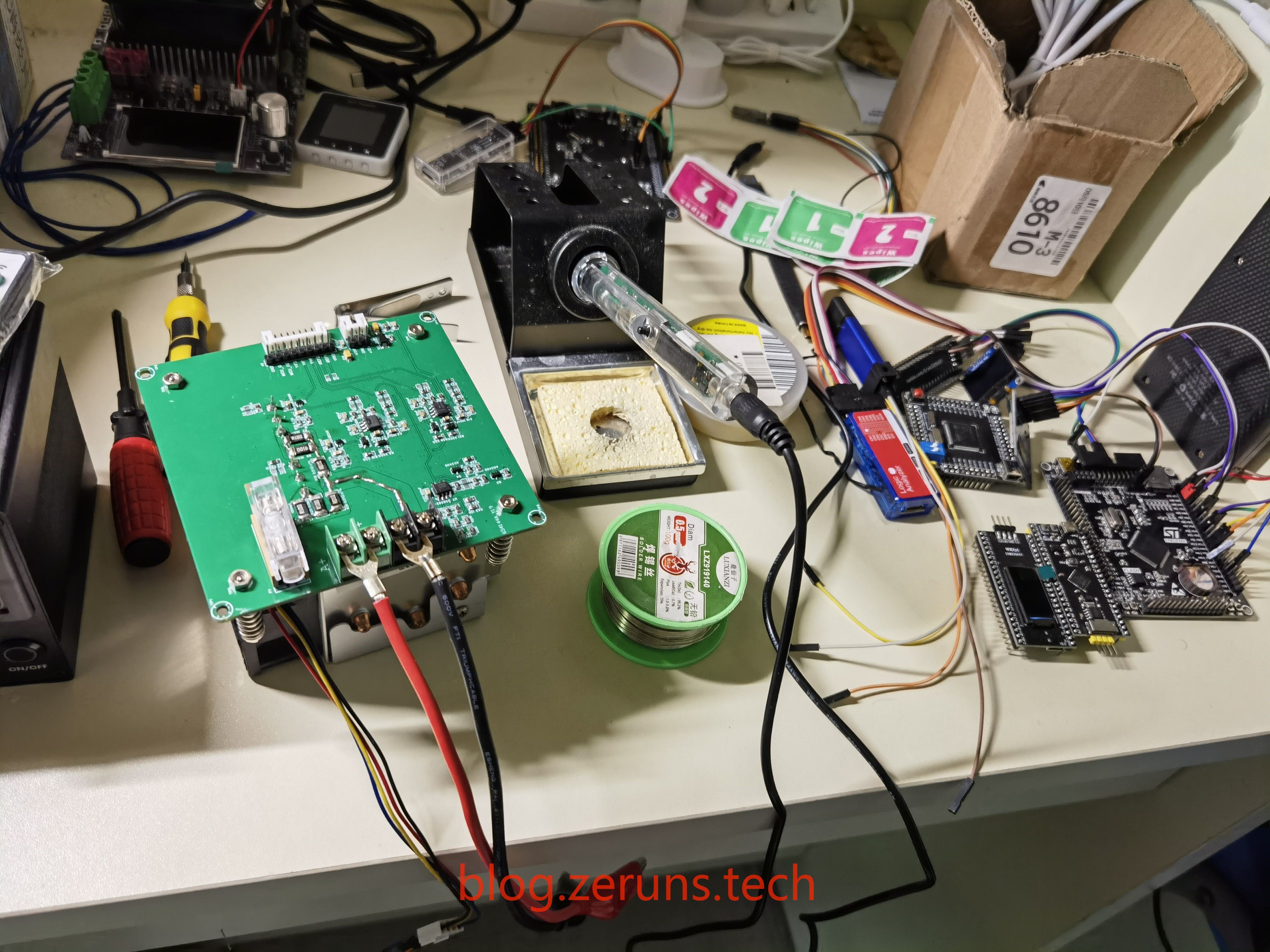

This project uses the CH32V307VCT6 Qinheng microcontroller as the main control chip for its electronic load design. It is powered by an 18650 lithium battery for easy portability.
The control method involves the microcontroller's DAC outputting a DC voltage as a reference voltage, which is compared with the voltage after current/voltage sampling and amplification by the operational amplifier. The operational amplifier output controls the MOSFET, thus achieving constant voltage/constant current.
The touchscreen is a 2.8-inch serial port screen from Taojingchi, model TJC3224T028_011R.
The heatsink is a 1356/1366-pin side-blowing heatsink from a 2U server.
The project program was developed using RT-Thread Studio. The circuit design used LCSC EDA software.
The maximum input voltage and current is 100V/10A, and the maximum power is 200W. I didn't take many photos
of the actual product
at the time, so I only found these few. You can check out the demo video.
