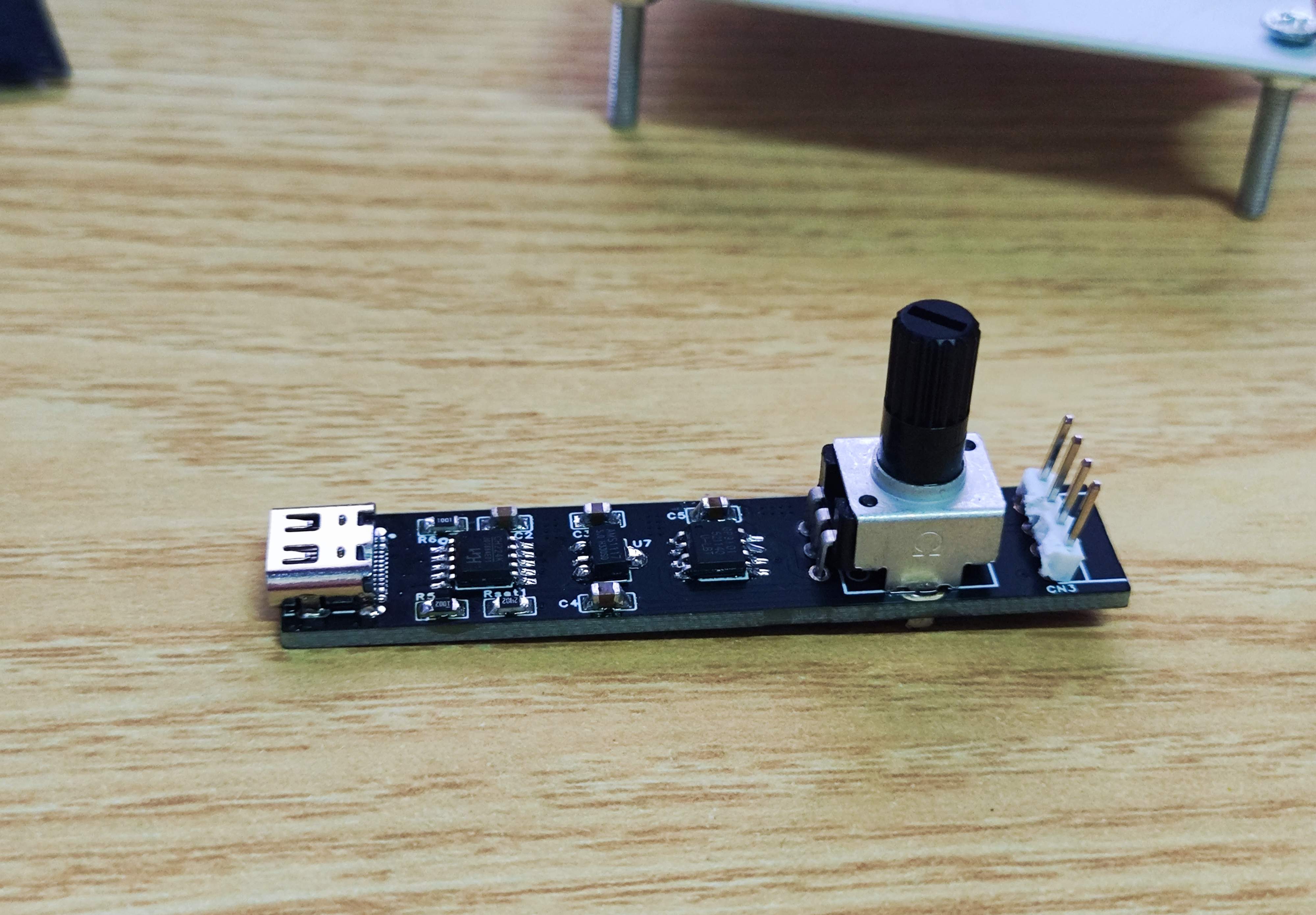

PD12V_PWM Fan Controller
Suitable for various high-performance 12V fans from Delta and other manufacturers. The cooling fan
uses a CH224K PD decoy chip to induce 12V
, a GP101 to generate a PWM signal
, and an AMS1117 to step down the voltage to 5V for the GP101 chip.
参考设计图片
