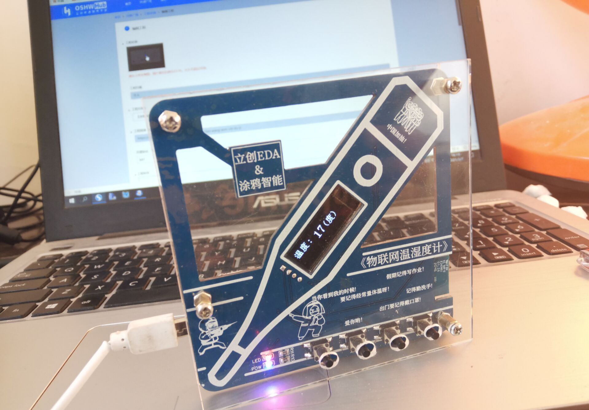

1. Introduction to the work
       The work uses MCU control to display the temperature and humidity on the screen, and uploads the temperature and humidity data to the cloud for display through the APP.
       I made two acrylic sheets myself to use as the shell (it was too difficult to drill holes with a drill, and they were a bit off)
       Because of the temperature and humidity meter, I mainly designed it based on the model of a thermometer. After I finished it, I found that the effect was average (hahaha, but I felt it was okay, and there was not much deviation)
      1. Main devices used: main control (stm32f103c8t6), display module (0.91-inch OLED display), Tuya WB3S module
      2. The actual object is as shown below:
            3. Serial port 1 is used for downloading, and serial port 2 is used for Tuya module.

             Temperature and humidity sensor: sht30 module, (this one is really small, it hurts my eyes when welding it, because there is only one, and I thought the bottom was not welded well, so I disassembled it once, and then welded it on again, but it was not broken, which was scary)
             Display module: 0.91-inch OLED, which is about the same size as the display screen of an electronic thermometer.
             Power supply voltage stabilization: AMS1117-3.3 (first time using it, it works well)
             Tuya WB3S: (This is so interesting. It looks so difficult. I thought about it for a long time but couldn’t get it done. Then I suddenly got the idea and can use it smoothly all the way)
             Main control (stm32f103c8t6): Because I have used this before, it is relatively easy, but I have soldered so many pins at one time. Hehe, challenge yourself.
