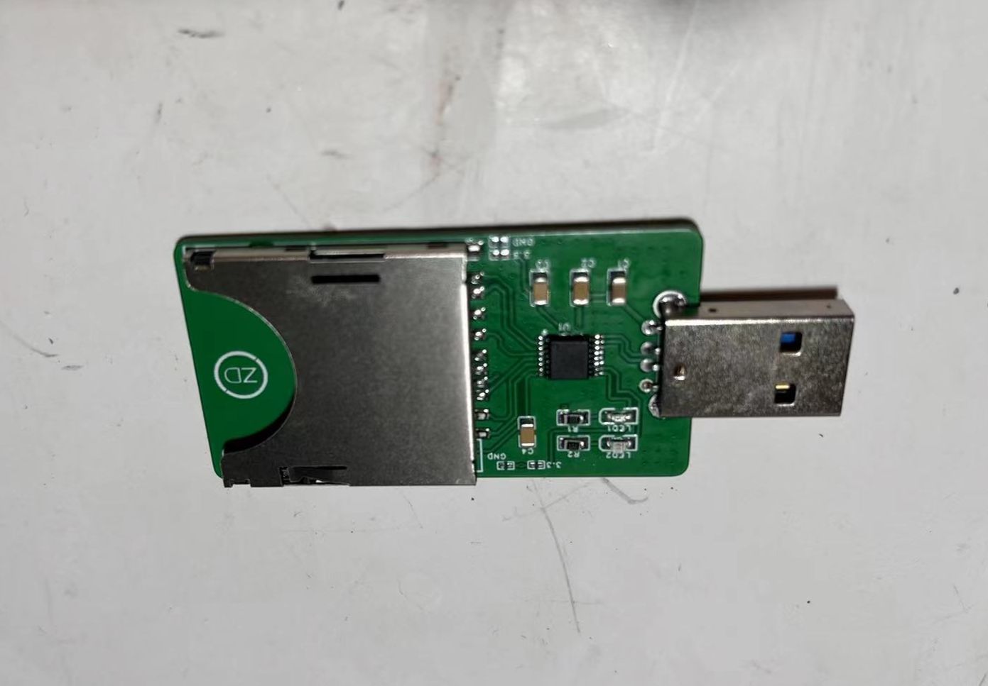

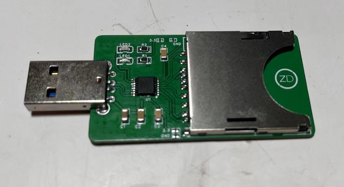

   Using a GL823K card reader to learn how to wire a card. Thanks to _Alexia_, whose project was referenced (link below): https://oshwhub.com/alexia0/gl823k-du-ka-qi.

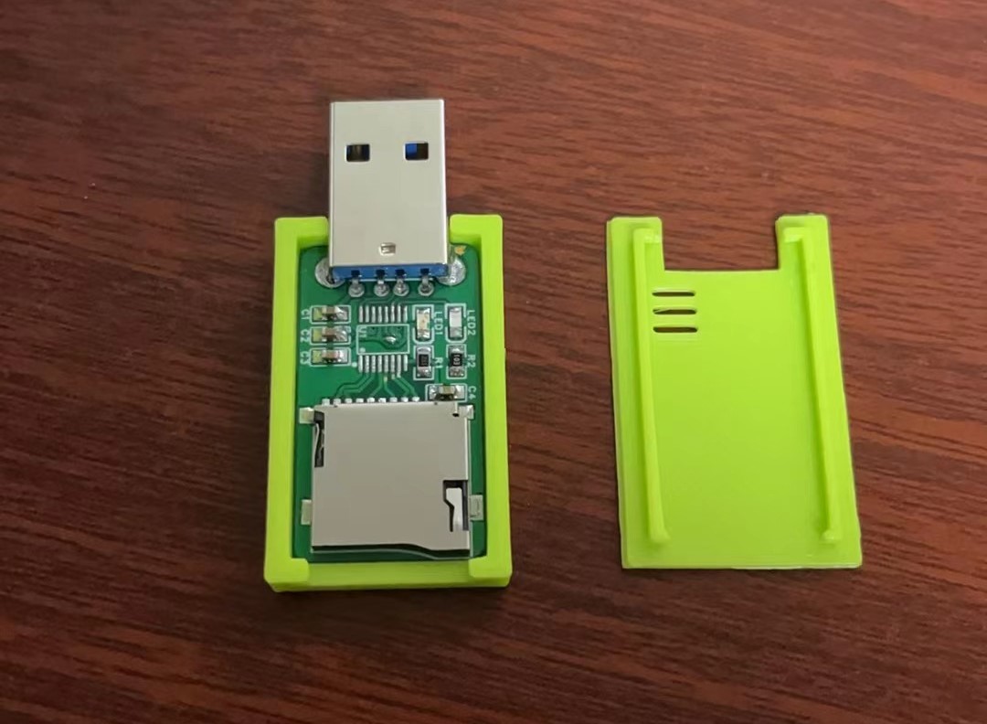

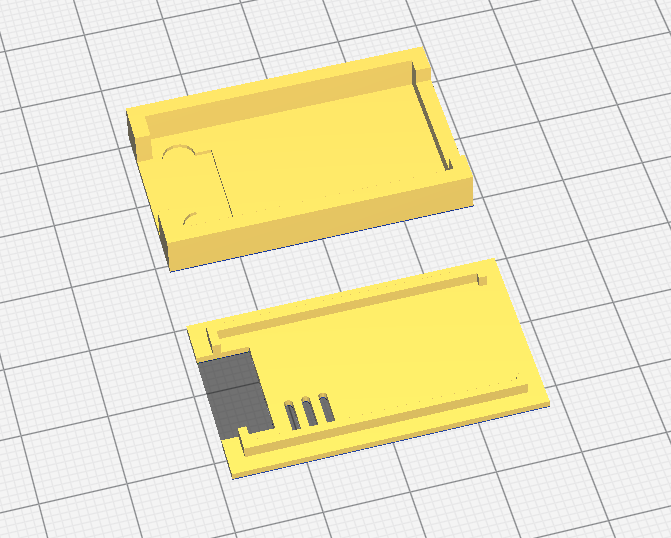

    The attached file is _Alexia_'s STL shell file for the GL823K card reader.
Purpose:

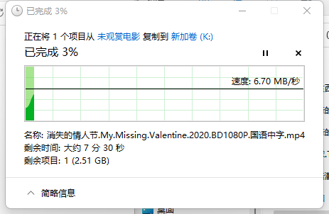

     The reason for modification is that my 3D printer uses SD cards, and my SD card reader is very slow, so I simply modified it. Testing was successful, and it works without problems. The shell hasn't been made yet; it will be added later .
Other:
      The purchased SD card slot has a write-protection switch and card ejection control; only a pull-up/pull-down interface was made for convenience when needed.
Actual product image.

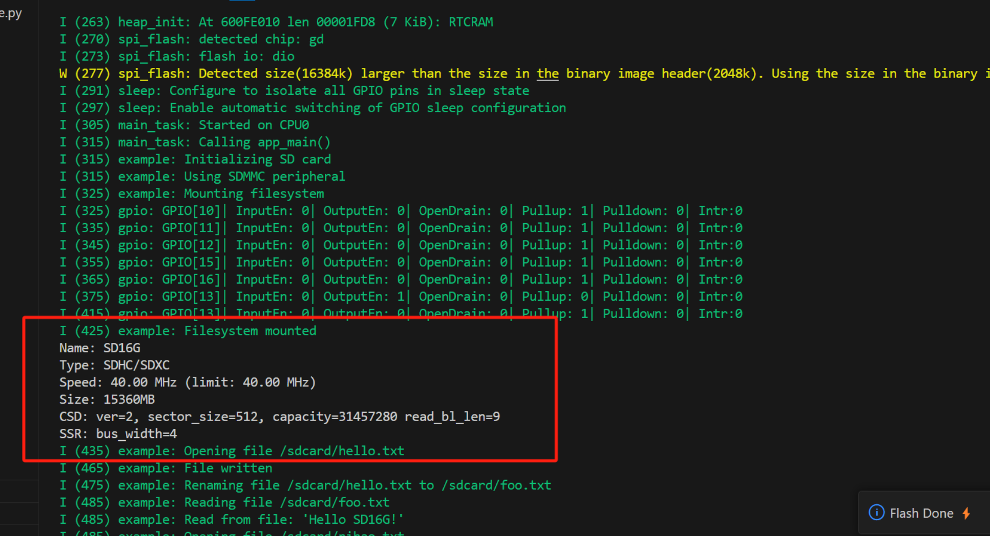

ESP32S3 development board OV2640 expansion board
Provides a stable OV2640 interface and SDIO SD card interface for the ESP32S3 development board.
It is installed as a baseboard on the bottom of the ESP32S3 development board.
The SD card interface uses the SDIO interface, and
the maximum communication speed of 40MHz has been successfully tested.
