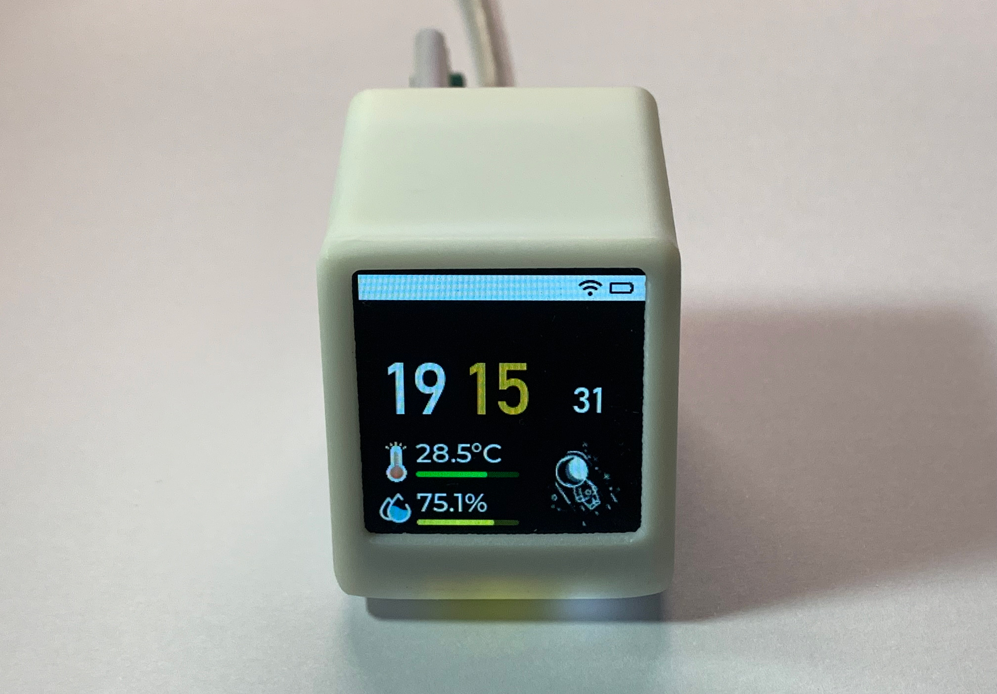

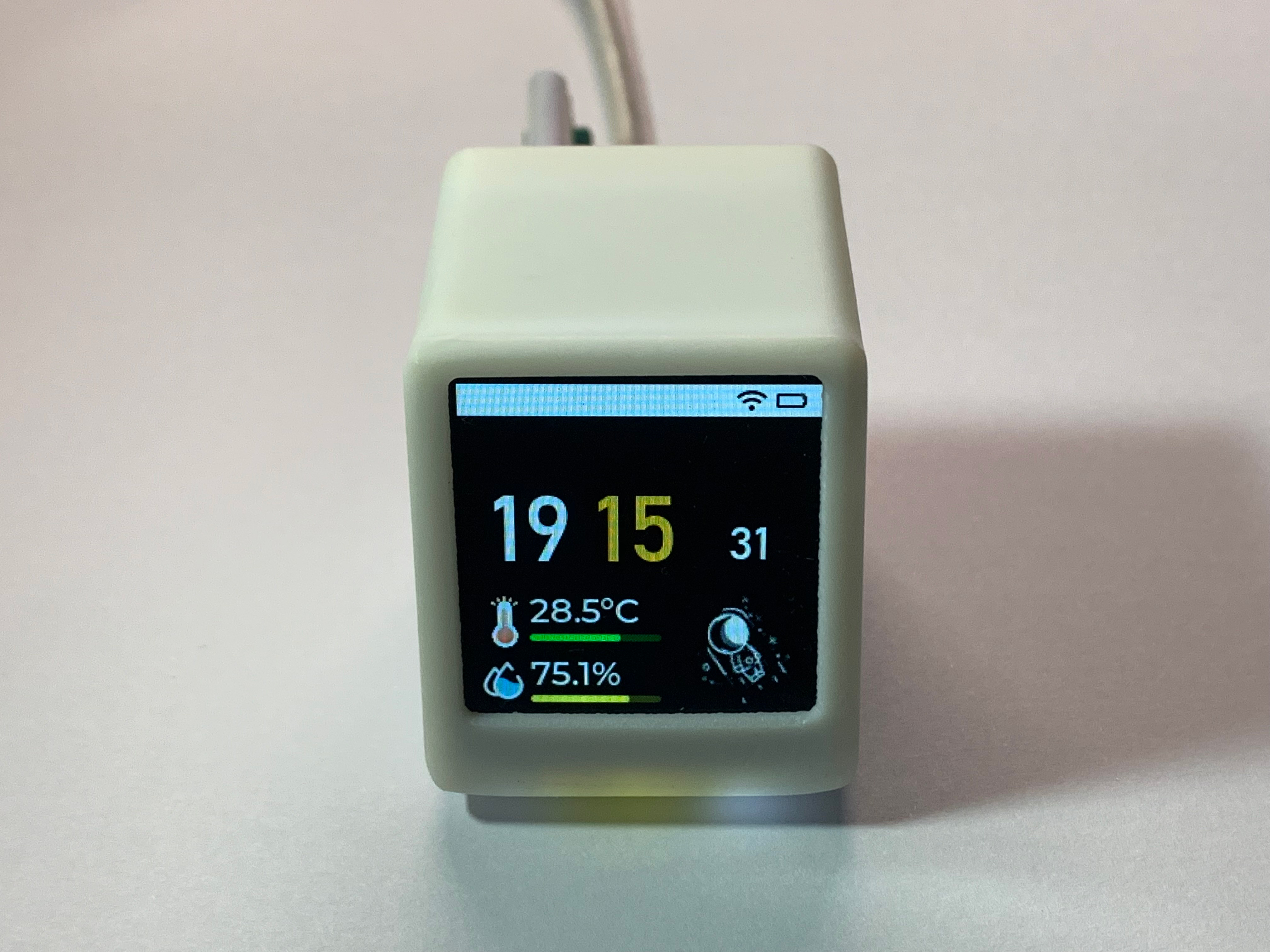

1. Function Introduction:
This project is inspired by the SD2 mini TV. The main controller is an ESP32C3, the screen is a 1.54-inch TFT color screen, and the temperature sensor is an SHT30.
Basic Functions:
1- Displays time, Wi-Fi connection, and battery level.
2- Displays temperature and humidity.

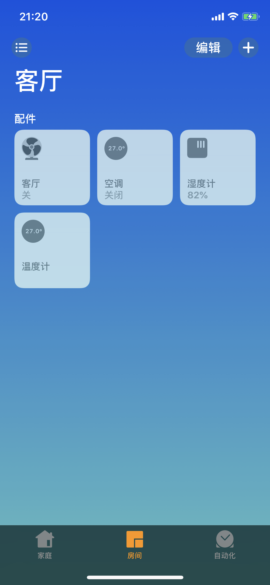

3- Directly connects to HomeKit, allowing users to view temperature and humidity via their mobile phones.
2. Hardware Description:
1- Powered by a 5V Type-C connector, it can be powered directly by a 1S lithium battery. A battery level icon is displayed, and a simple voltage indicator shows the battery level.

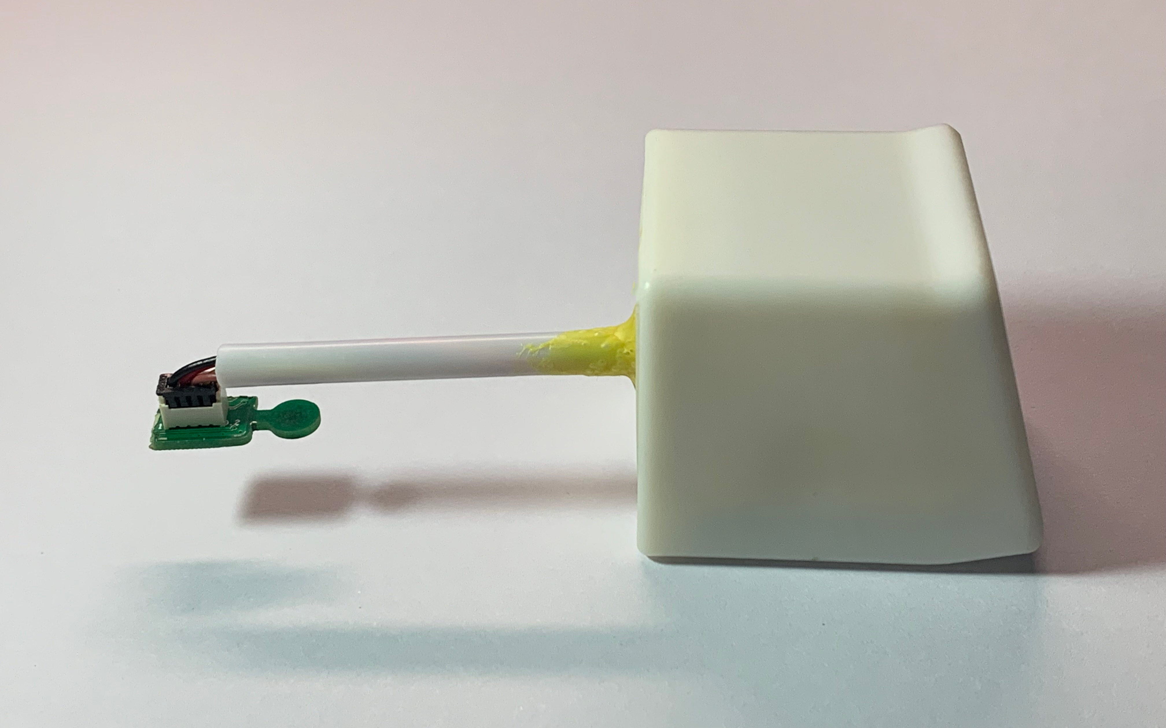

2- Due to HomeKit connectivity requirements and the high screen temperature, the temperature sensor is externally connected.
3- The casing is directly from the SD2 (https://oshwhub.com/Q21182889/esp-xiao-dian-shi), with a manual modification to add a sleeve to allow the temperature sensor wires to pass through. Glue is required.
4- The PCB board is 1.2mm thick.
3. Software Description:
1- This software is developed using ESP-IDF and comes with the ESP-HomeKit SDK to implement Apple HomeKit.
2- The graphical interface is implemented using LVGL.
3- The software is downloaded directly to 0x0000 using Espressif's flash_download_tool.
4- Thermometer_v1.0.0.bin will not turn off the screen. 5- Thermometer_v1.0.1.bin
automatically turns off the screen at 9:30 PM and automatically turns it on at 6:30 AM.
6- Supports over-the-air (OTA) pairing. It can be used with the Espressif App or the WeChat AirKiss (follow Espressif Systems' official WeChat account). It will automatically enter the pairing process after changing the Wi-Fi environment or router password. A Wi-Fi icon will appear after a successful network connection. Pairing will fail if the distance to the router is too far.
7- The network will automatically calibrate the time after a successful connection.
8- HomeKit connection: No code or cannot scan? Enter pairing code 11122333 to connect.

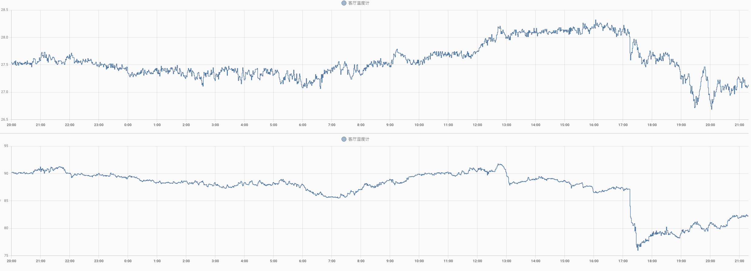

iOS 12 Effects -
Home Assistant History

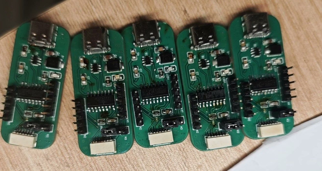

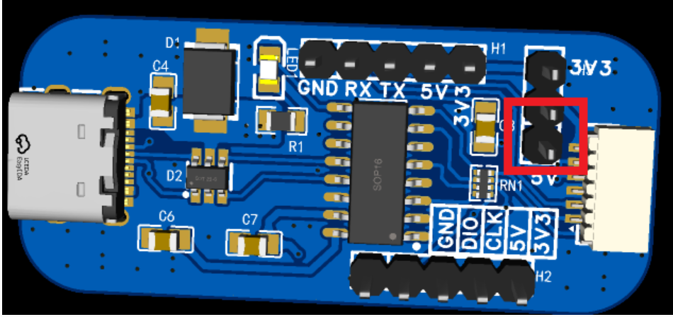

Self-made DAP_Link (based on LCSC)

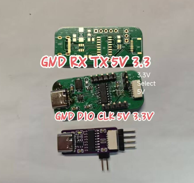

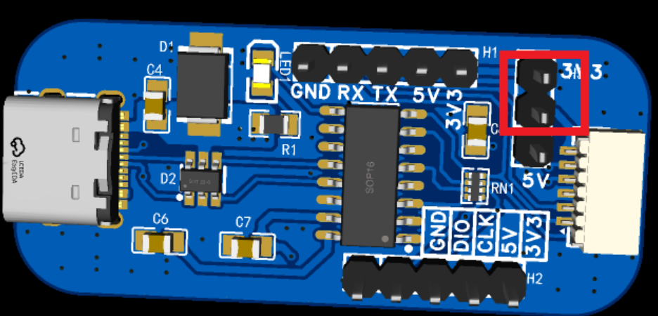

This is a modification of the JLCPCB DAP-Link, adding a 3.3V output. Users can freely choose between 3.3V and 5V output.
DAP-Link Based on CH552G (Modified from LCSC)
: This project modifies and
creates a
custom DAP-Link downloader (LCSC modified version) based on the JLCSC DAP-Link. [Video link:
https://www.bilibili.com/video/BV1ix4y187Ar](https://www.bilibili.com/video/BV1ix4y187Ar
Image of the actual product] (https://www.bilibili.com/video/BV1ix4y187Ar) [
Instructions for use:
Modified from the JLCSC DAP-Link, adding a 3.3V output. 3.3V and 5V outputs can be freely selected. This DAP-Link has a pin header interface and an SH1.0 1x6pin reverse ribbon cable interface. The SH1.0 1x6pin reverse ribbon cable interface allows selection of the output voltage as 3.3V or 5V.
] ( https://www.bilibili.com/video/BV1ix4y187Ar
) For firmware download instructions, please refer to LCSC: LSPIClink: LCSC Liangshanpai Development Board with DAPlink using CH552G as the programmer controller. LCSC Development Board Official Website: lckfb.com (gitee.com)

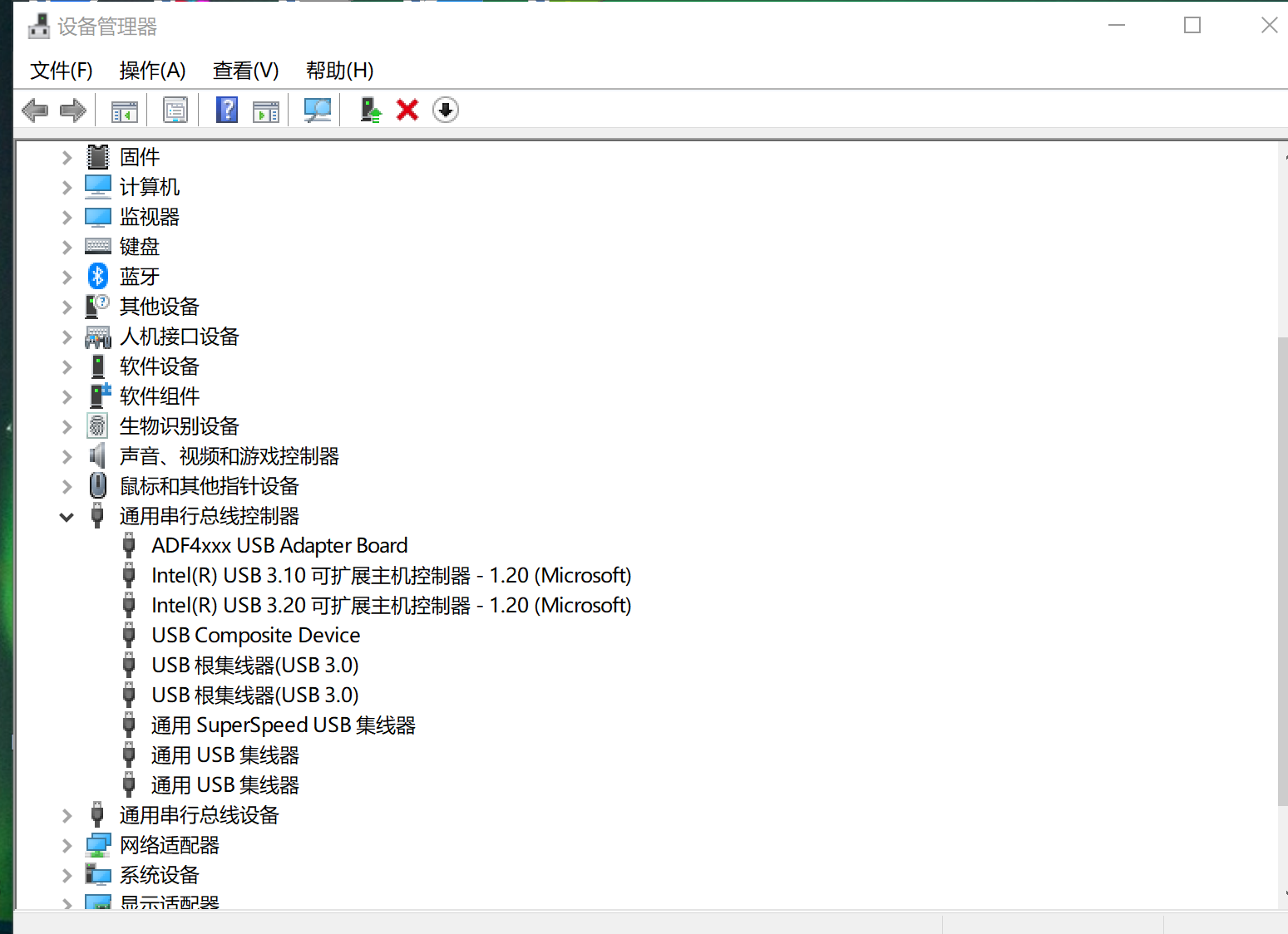

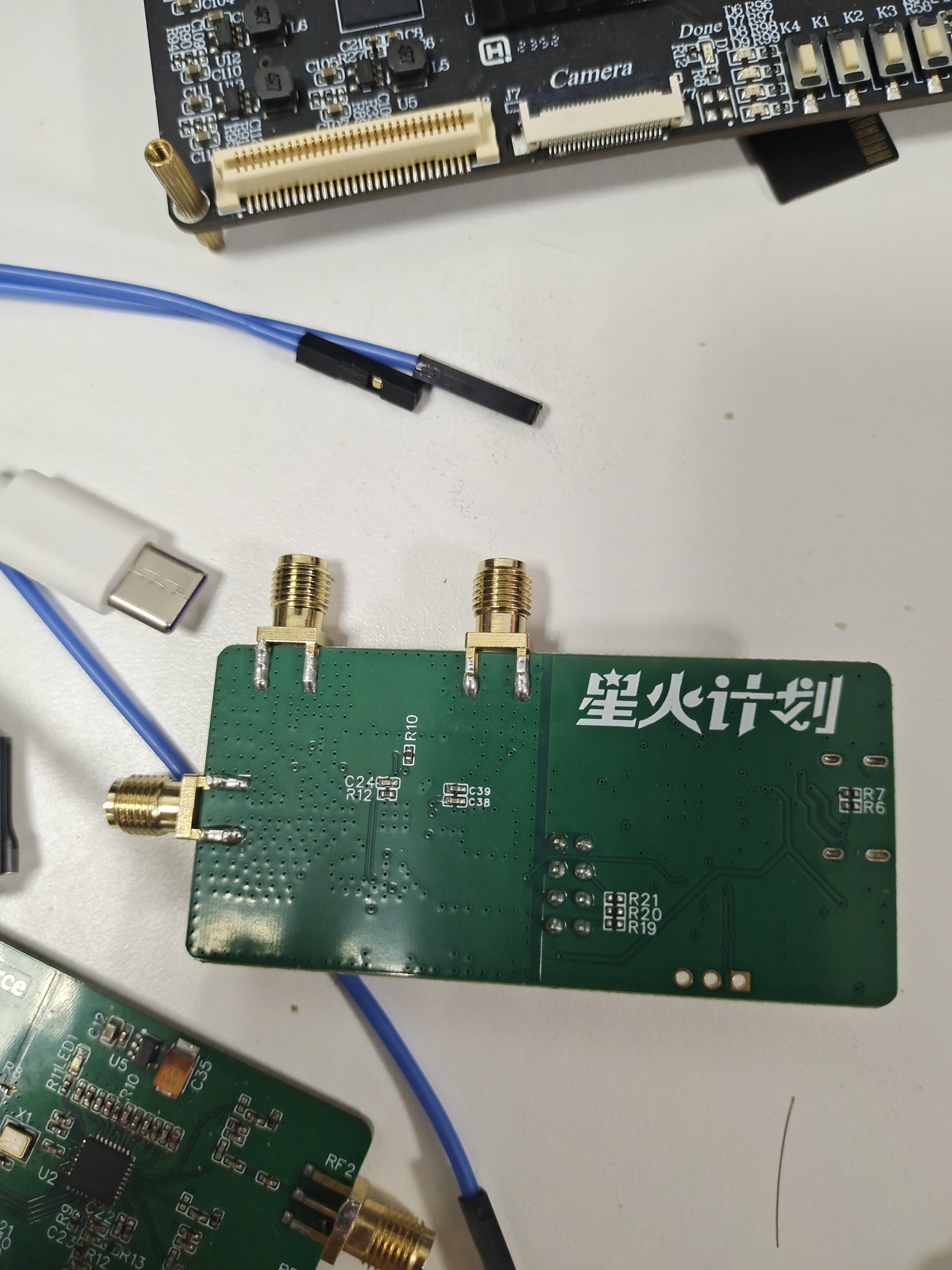

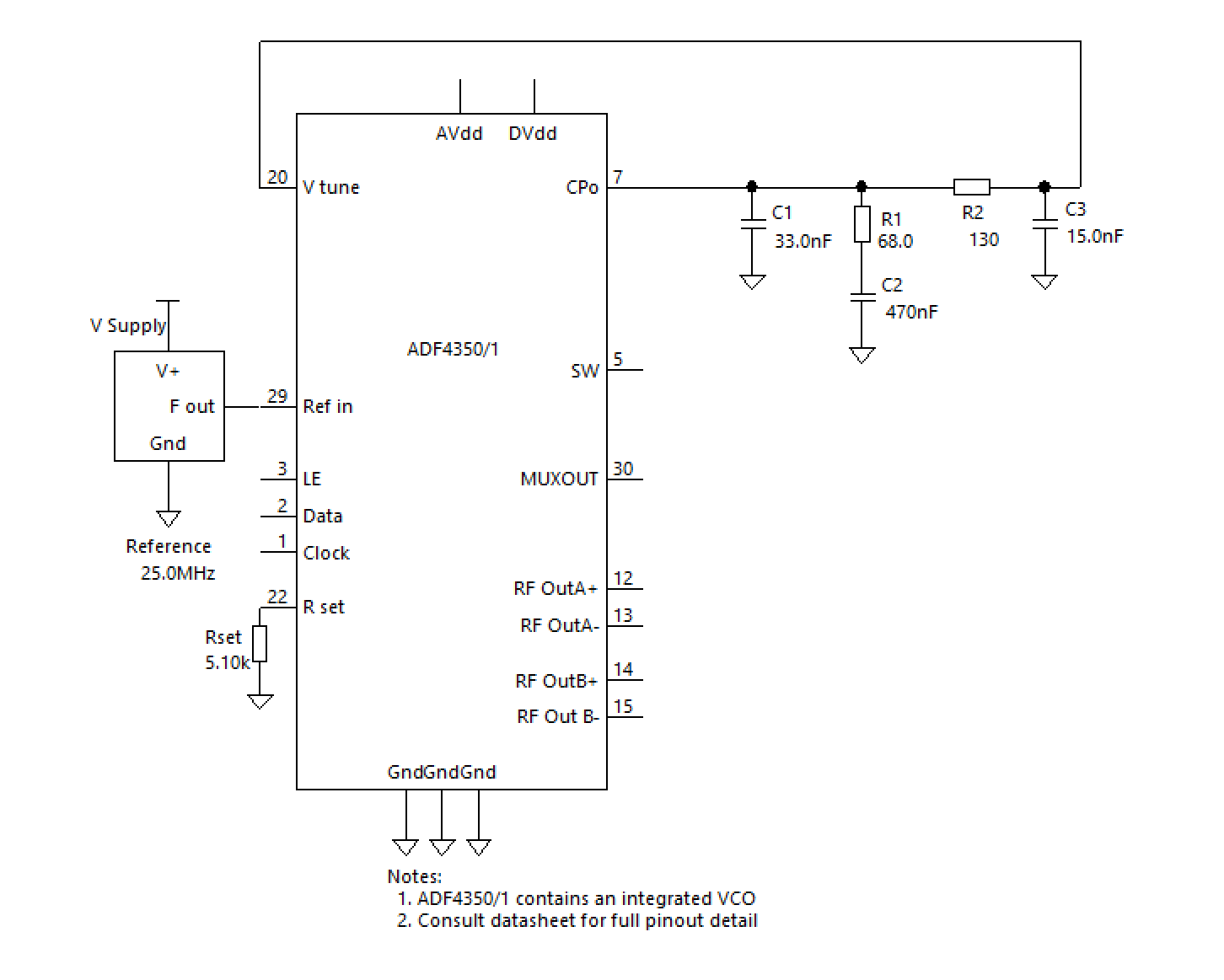

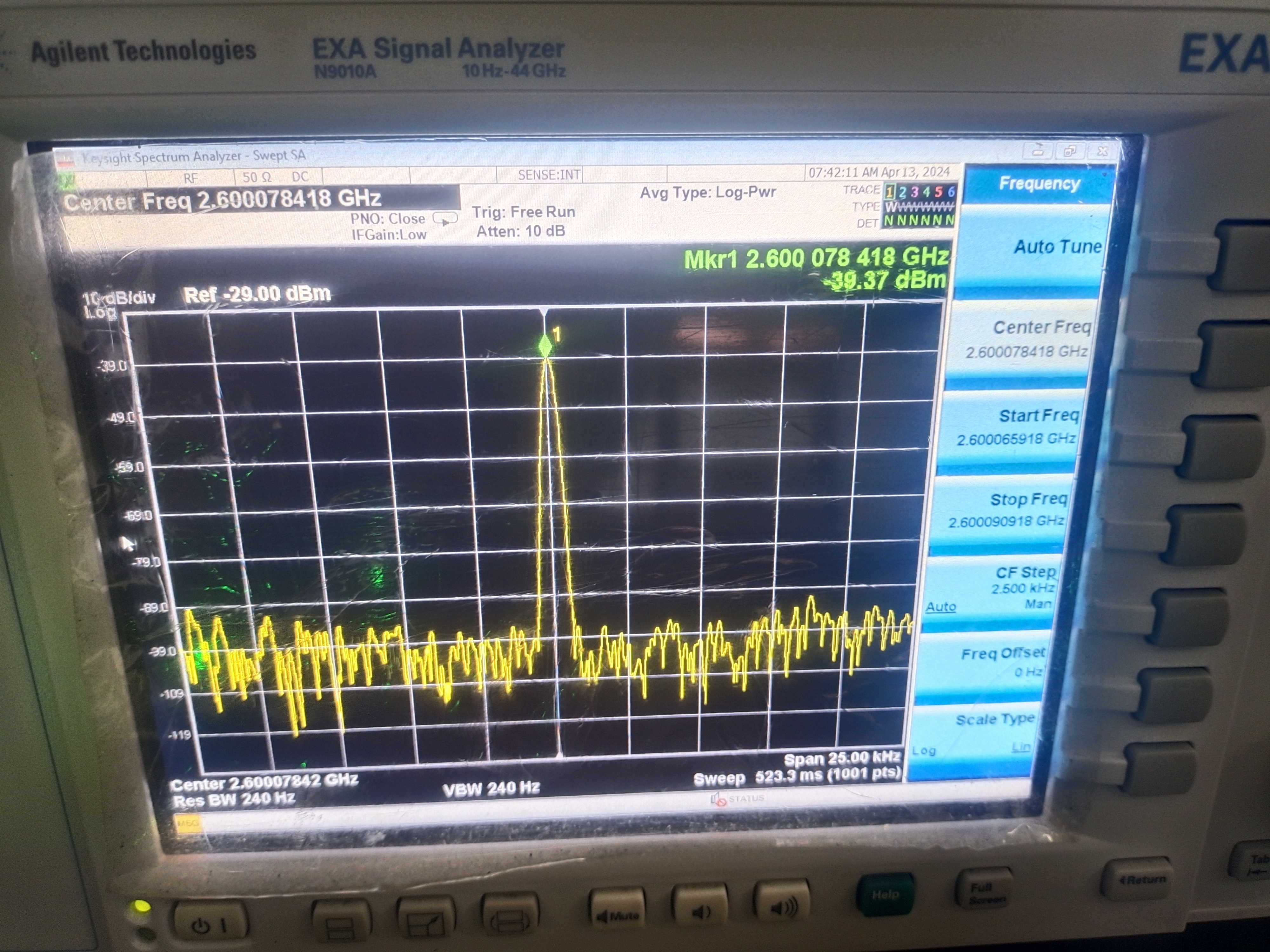

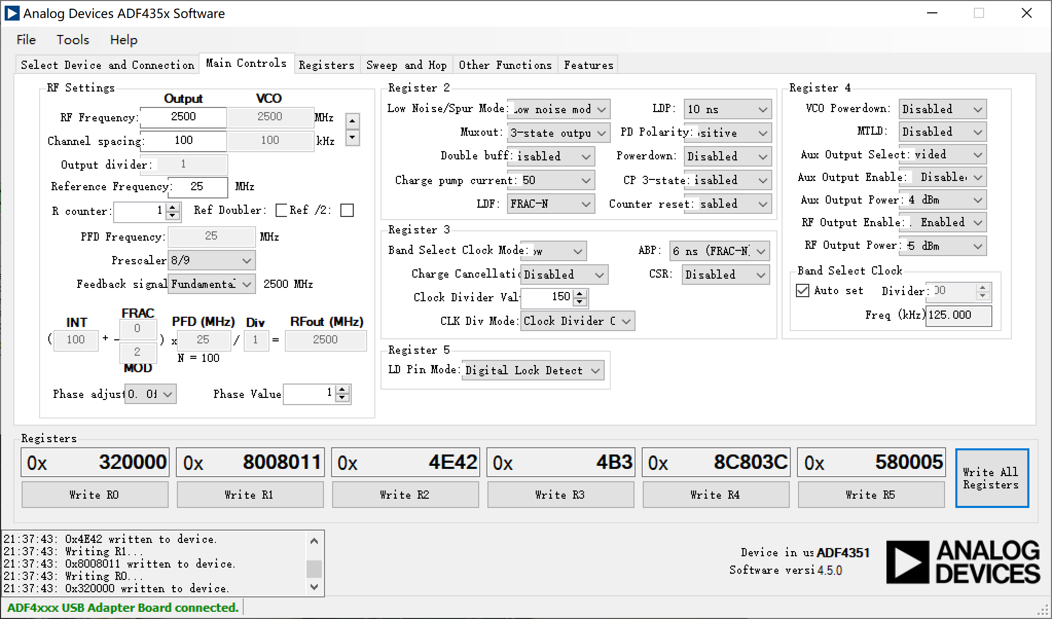

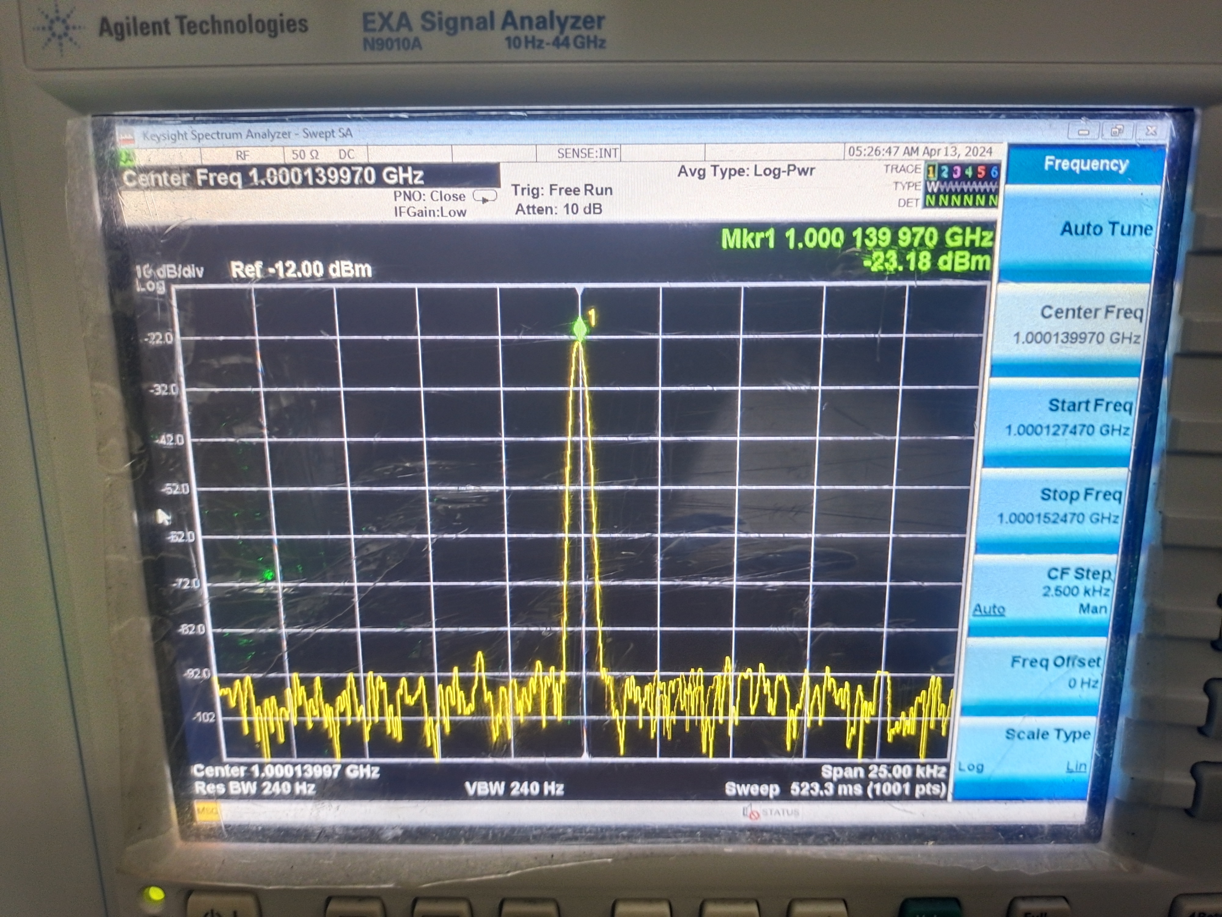

ADF4351 RF signal generator

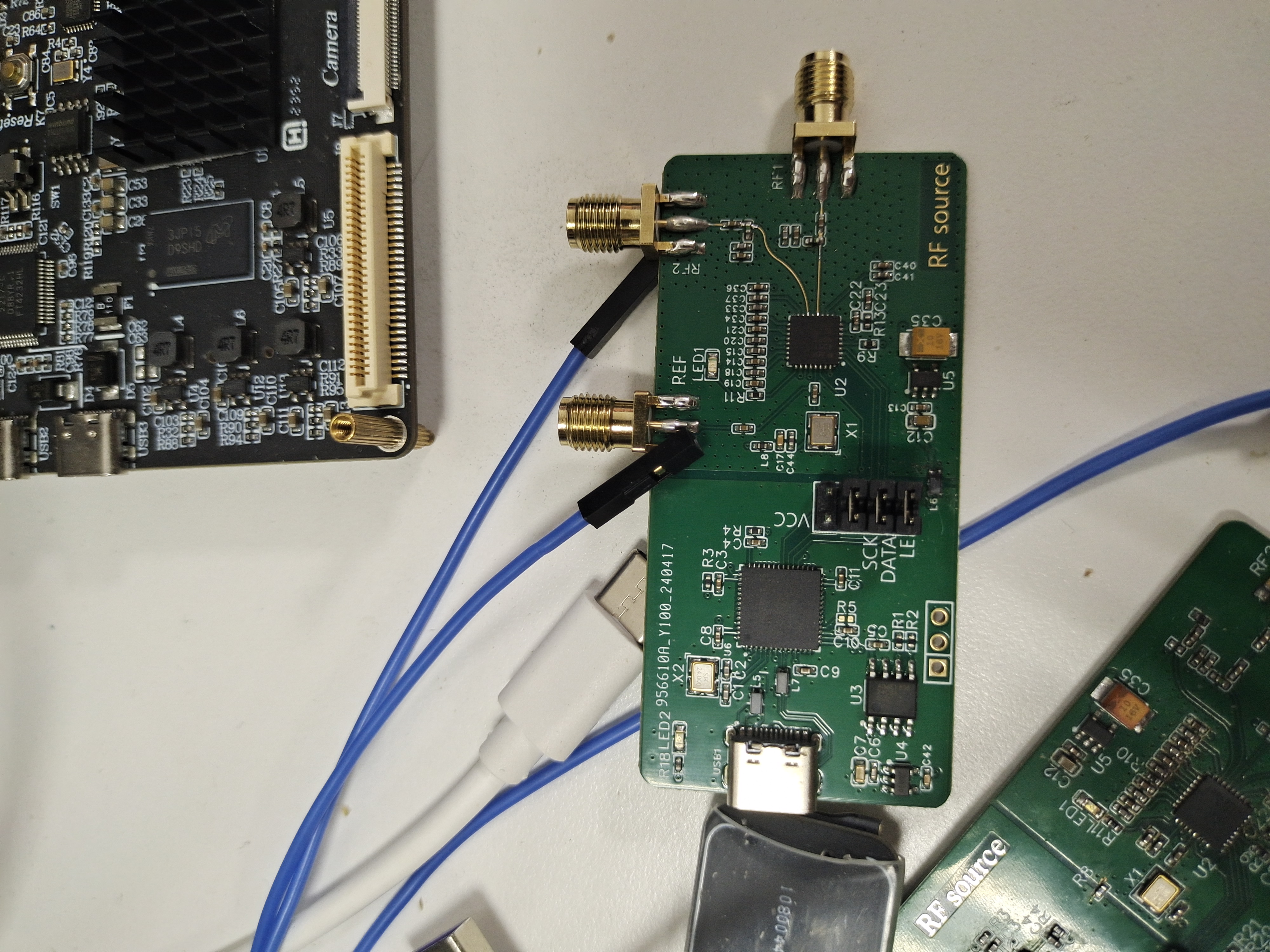

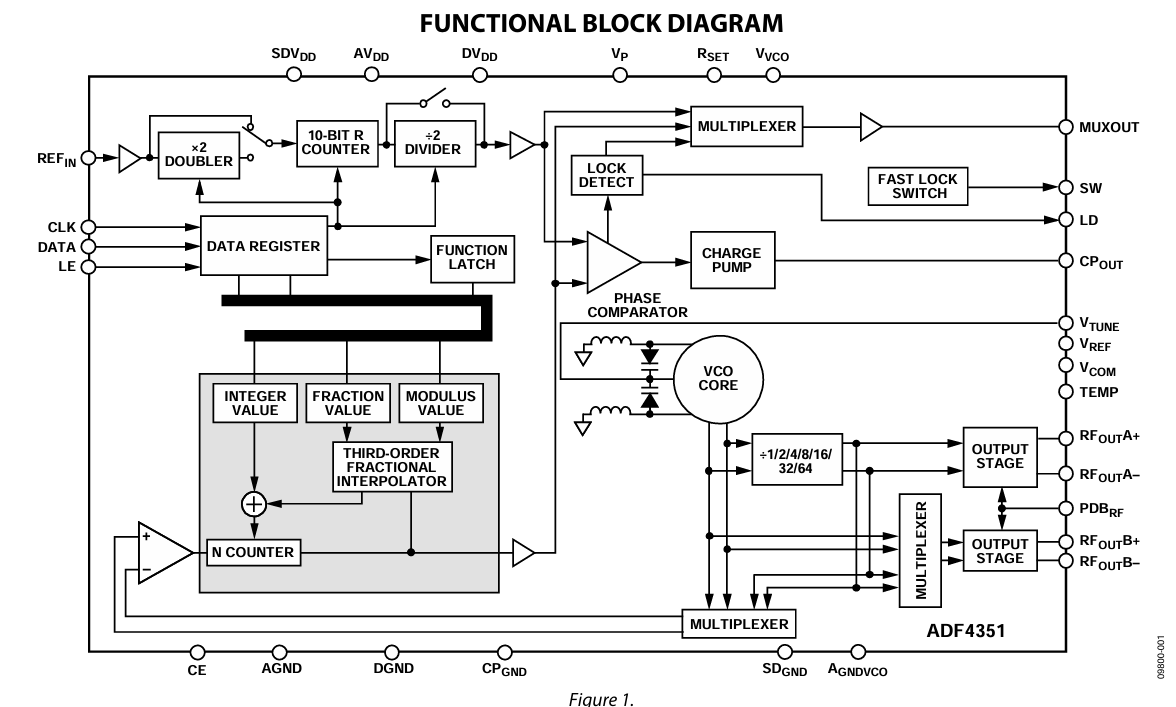

Using the CY7C68013A as the main controller and the ADF4351 phase-locked loop (PLL), it can provide RF signal sources from 35MHz to 4.4GHz, is compatible with ADI's official host computer software, and can directly control the output.
This project
uses the CY7C68013A as the main controller and the ADF4351 phase-locked loop (PLL) as the primary loop unit. It provides RF signals from 35MHz to 4.4GHz, is compatible with ADI's official host computer software, and can directly control the output under
the open-source license
GPL 3.0.
Project-related functions

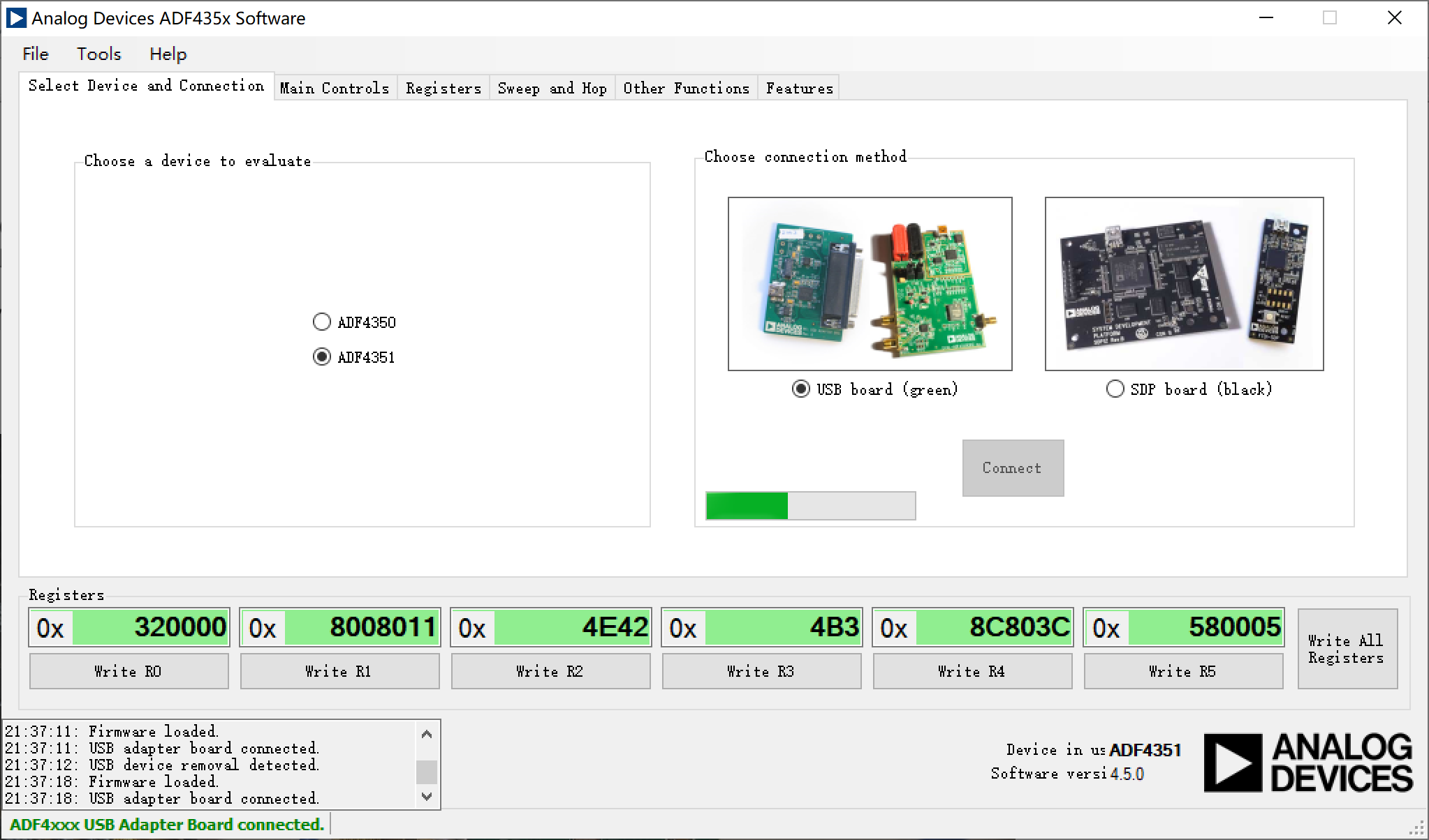

can be developed by writing your own program, or the firmware can be burned to the EEPROM via the provided binaries and used directly with ADI's official host computer software.
After flashing the firmware, the computer will recognize it as an ADF4xxx USB Adapter Board. If there is no firmware in the EEPROM, it will be recognized as a serial device (exclamation mark) .
Project Attributes:
This project is being publicly disclosed for the first time and is my original work. This project has not won any awards in other competitions.
The project

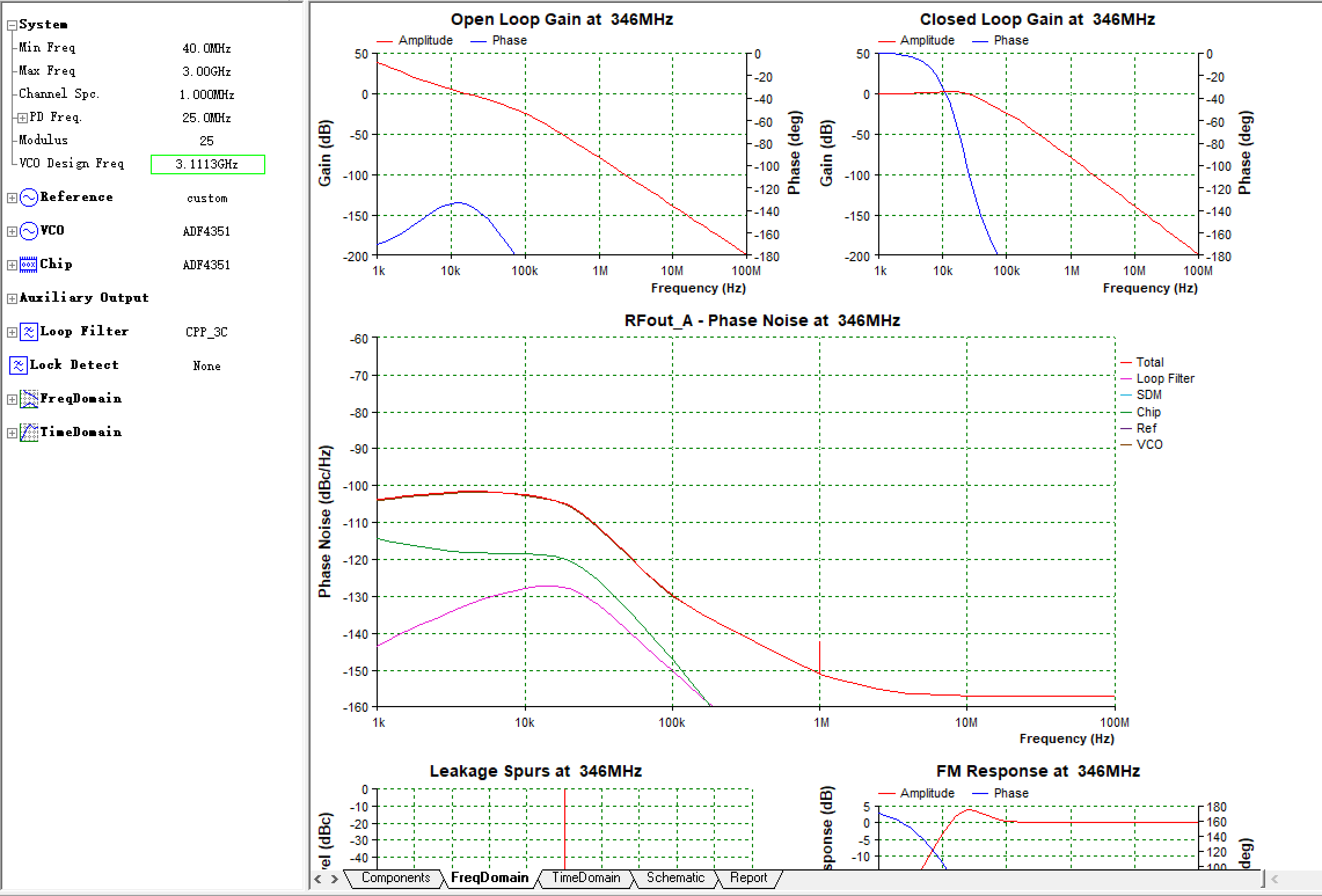

is complete with ADIsimPLL simulation
of the design principles
. The files are attached:
ADF4351 functional block diagram,
software description, and

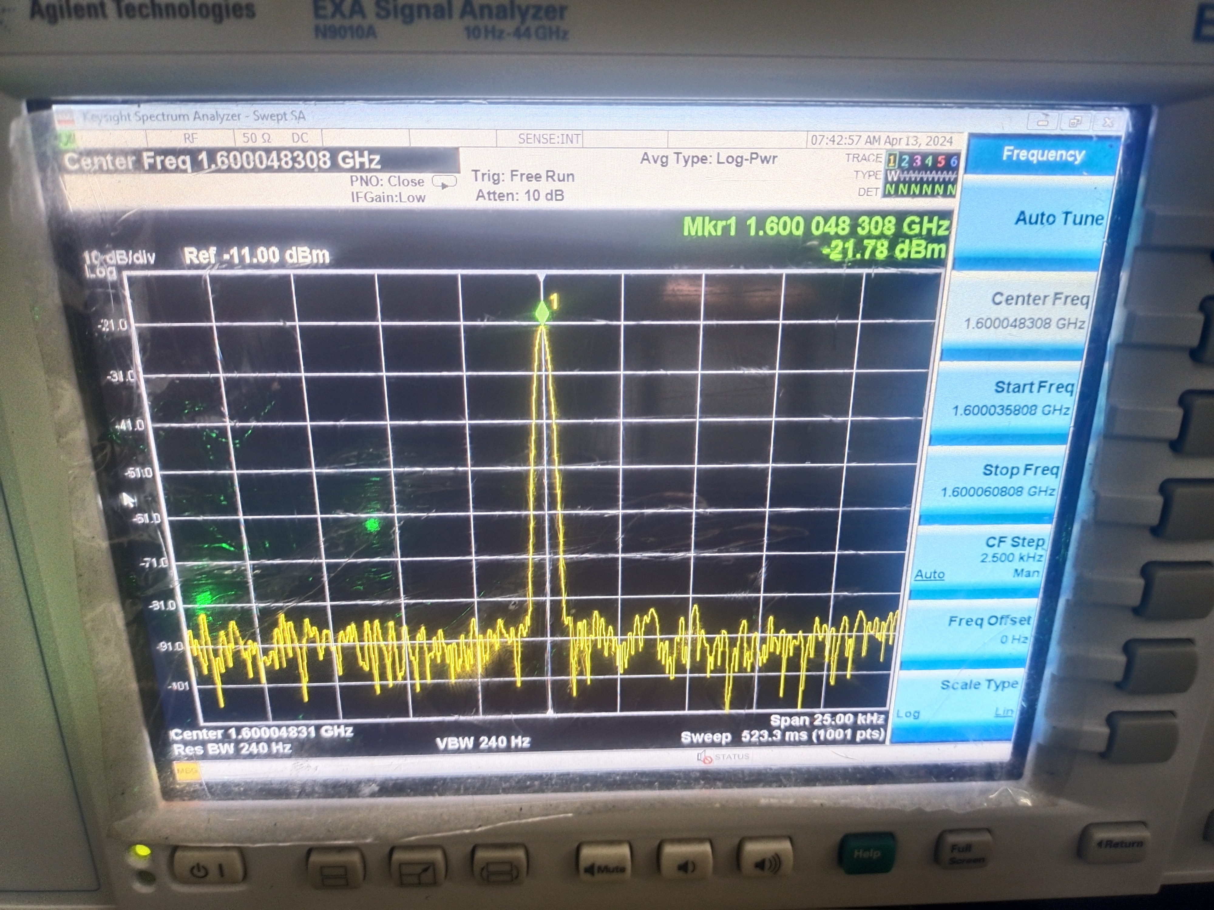

BIN file. Write the following values ​​sequentially from address 0x00 :
0xc0, 0x56, 0x04 , 0x03, 0xb4, 0x00, 0x00, 0x00. I'm using a Linux development board with i2ctools, so no programs are used. The official ADF435x host computer is shown in the physical demonstration (1GHz, 2.6GHz, 1.6GHz) . Design considerations (cy7c68013a): If the computer doesn't respond or displays an "unrecognized device" message, the chip is not properly soldered. There are three jumpers on the header; the top one is for VCC and GND. Do not short-circuit them. Other demo videos: Demo videos can be uploaded as attachments. Attachments can only be 50MB in size. Files larger than 50MB can be hosted on other cloud storage services or video websites; simply include the link here. Project attachments: Entries participating in the event must upload the relevant program attachments to an open-source platform or personal code storage cloud. Attachments can be uploaded up to a maximum of 50MB (please do not upload to the LCSC workspace, as there are limitations).

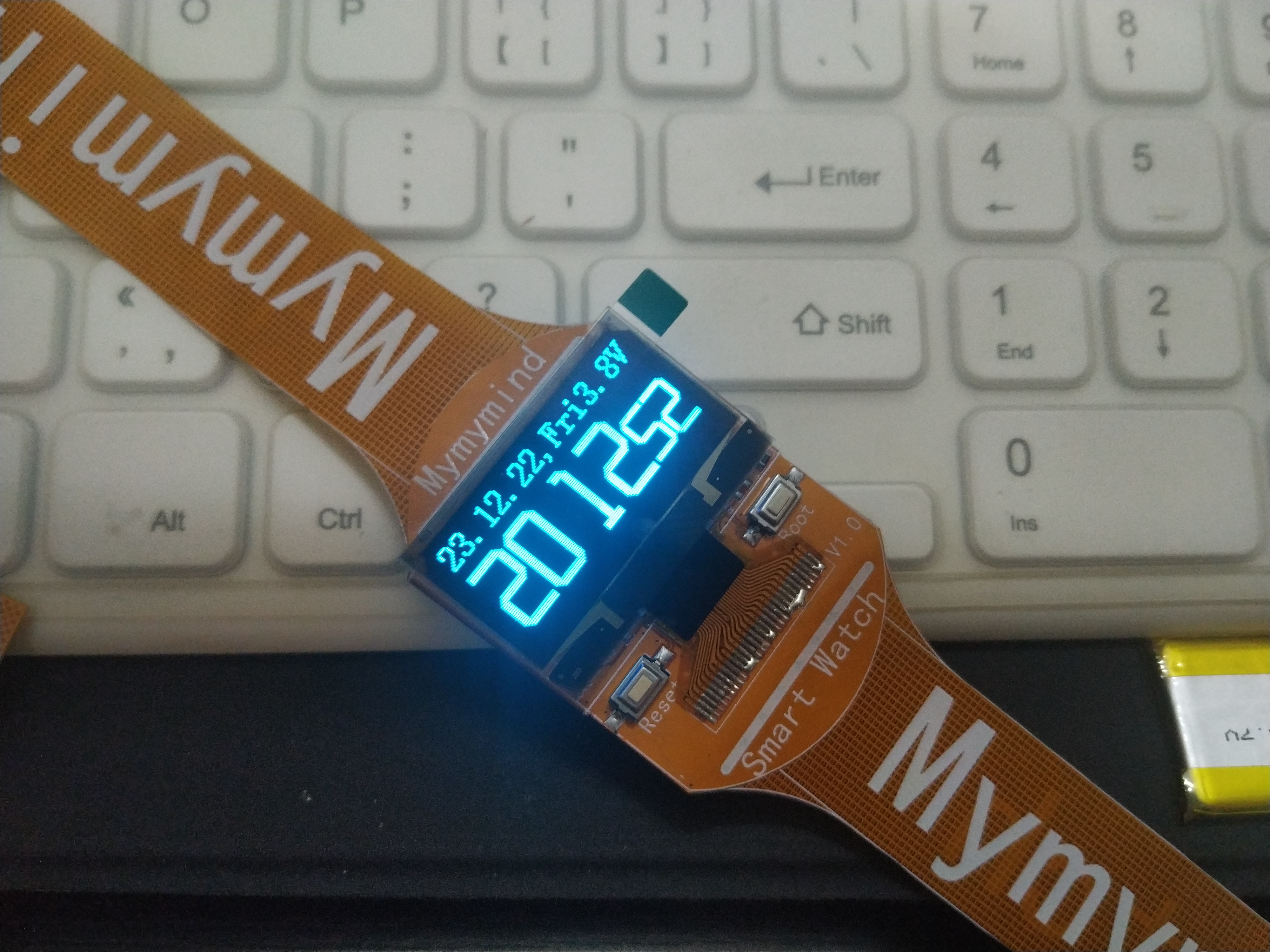

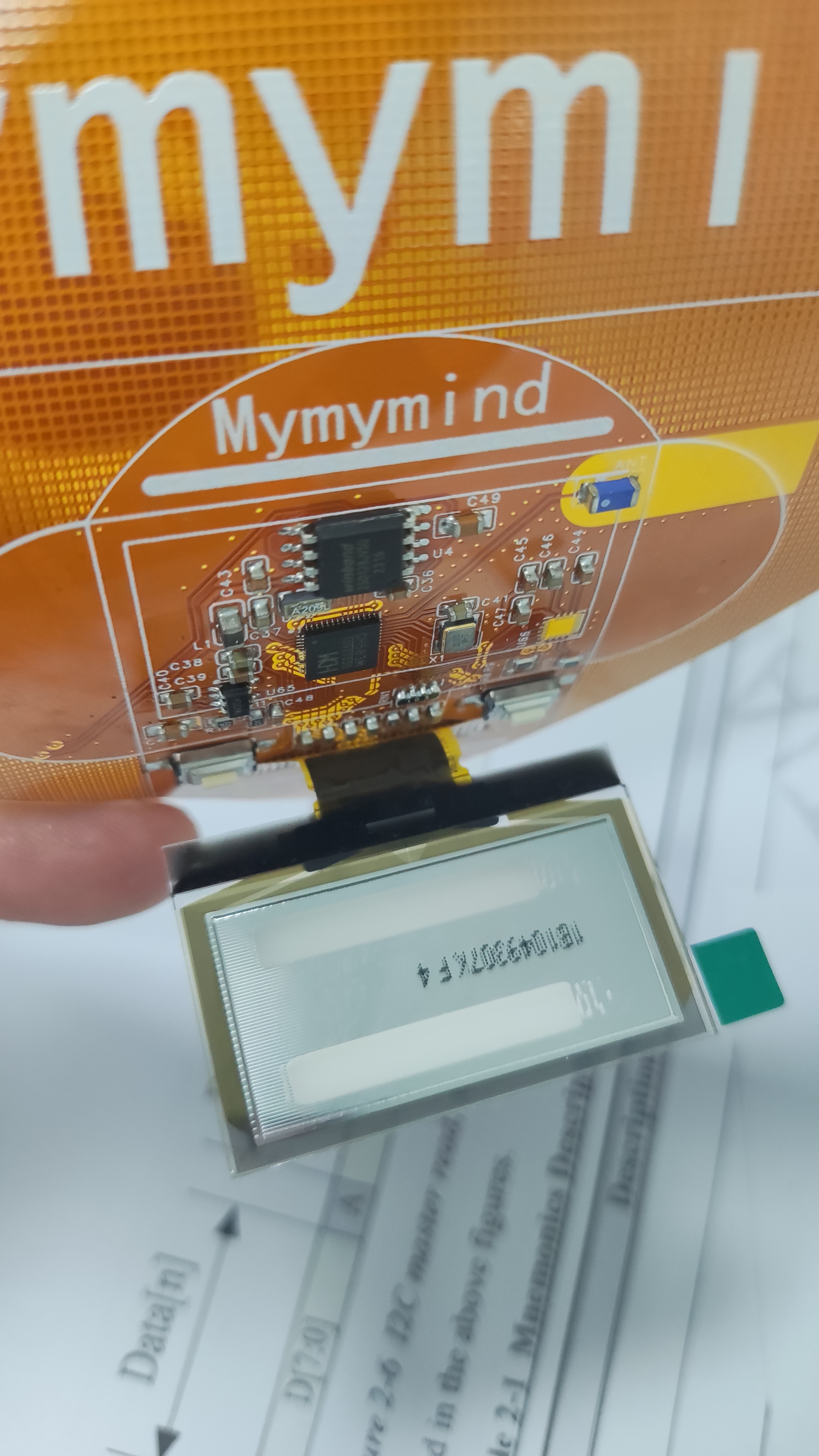

FPC Watches

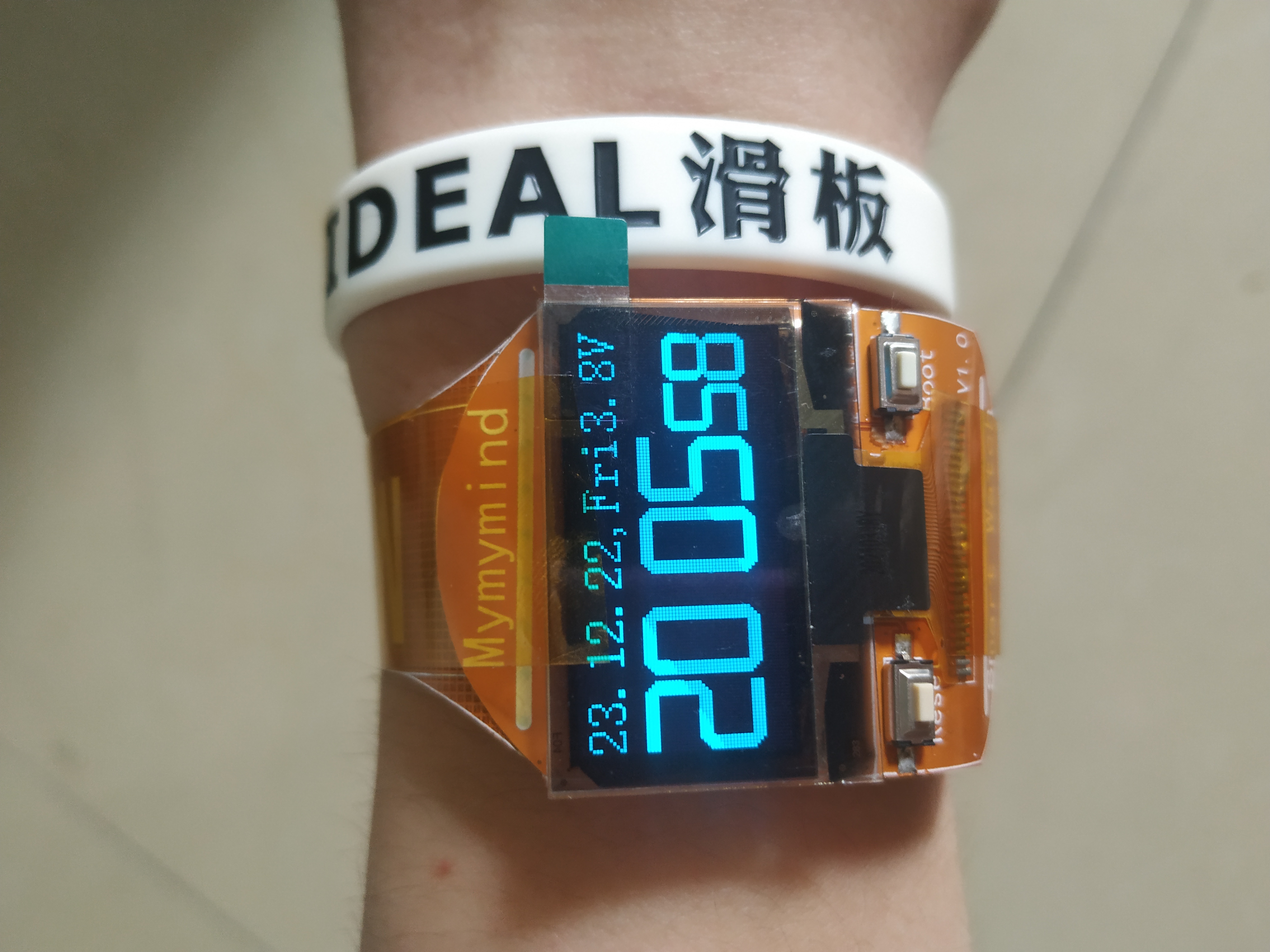

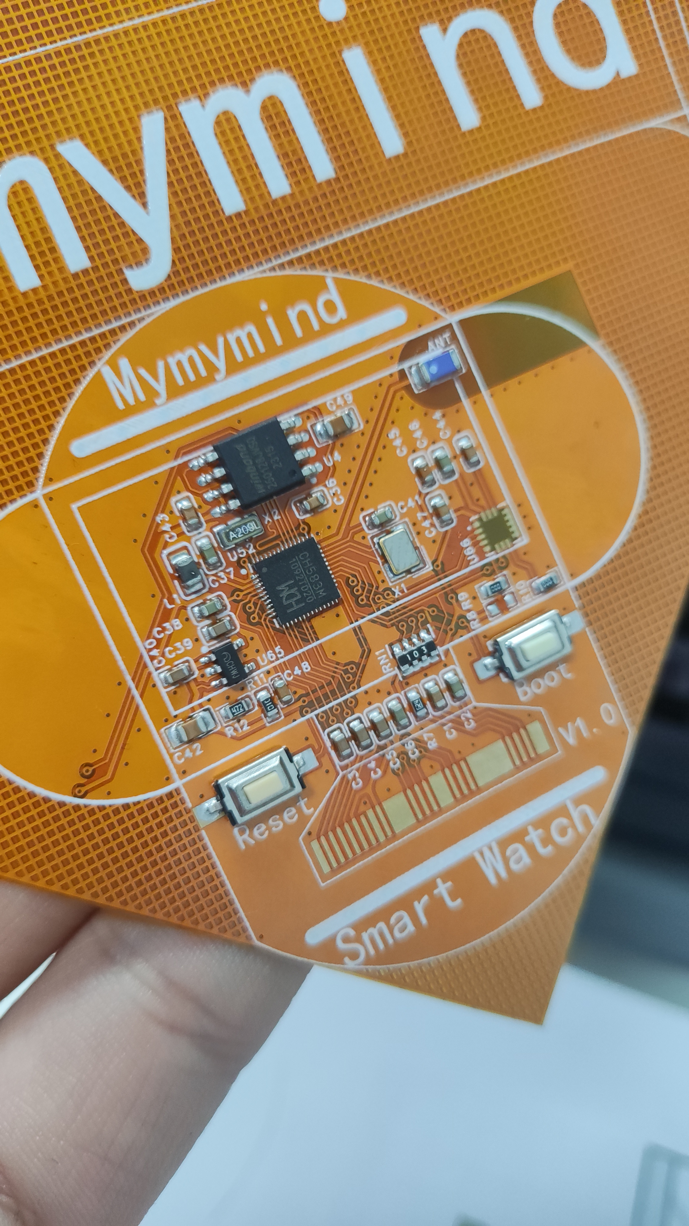

Based on the CH583M OLED watch, it uses FPC material and is easy to fold and wear on the wrist.
Main controller: CH583M, 60MHz main frequency, 512K flash, 32K ram, with Bluetooth 5.0 BLE;
Screen: OLED 12864, 4-wire SPI interface
; Gyroscope: ICM20608, SPI & IIC;
Independent buttons: 2
; ADC: NTC temperature measurement, battery voltage measurement;
Development environment: Mount River System
MAH00626.MP4
PDF_FPC Watch.zip
Altium_FPC watch.zip
PADS_FPC watch.zip
BOM_FPC watch.xlsx
