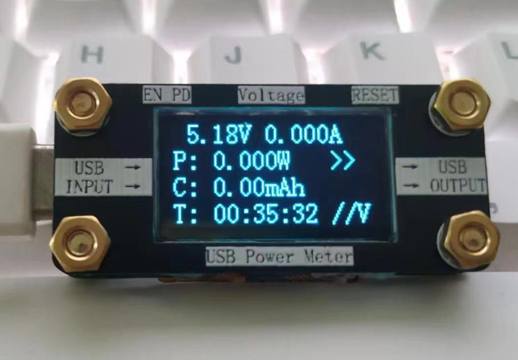

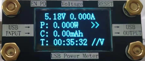

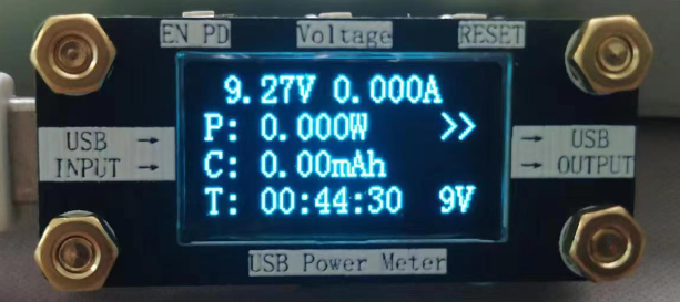

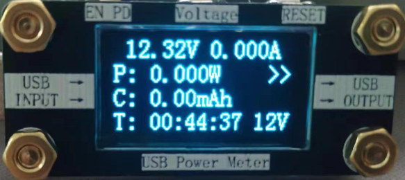

An LDO is used for buck conversion; however, voltages above 12V have not been tested as the LDO may overheat. The system is based on an STM32F103C6T6 main controller, and can be directly programmed using a GD32F103C8T6. Currently, it is tested to be compatible with GD/ST chips of the same series. Due to its simple functionality and software-implemented protocols, it is expected to be directly compatible with other domestically produced chips.
